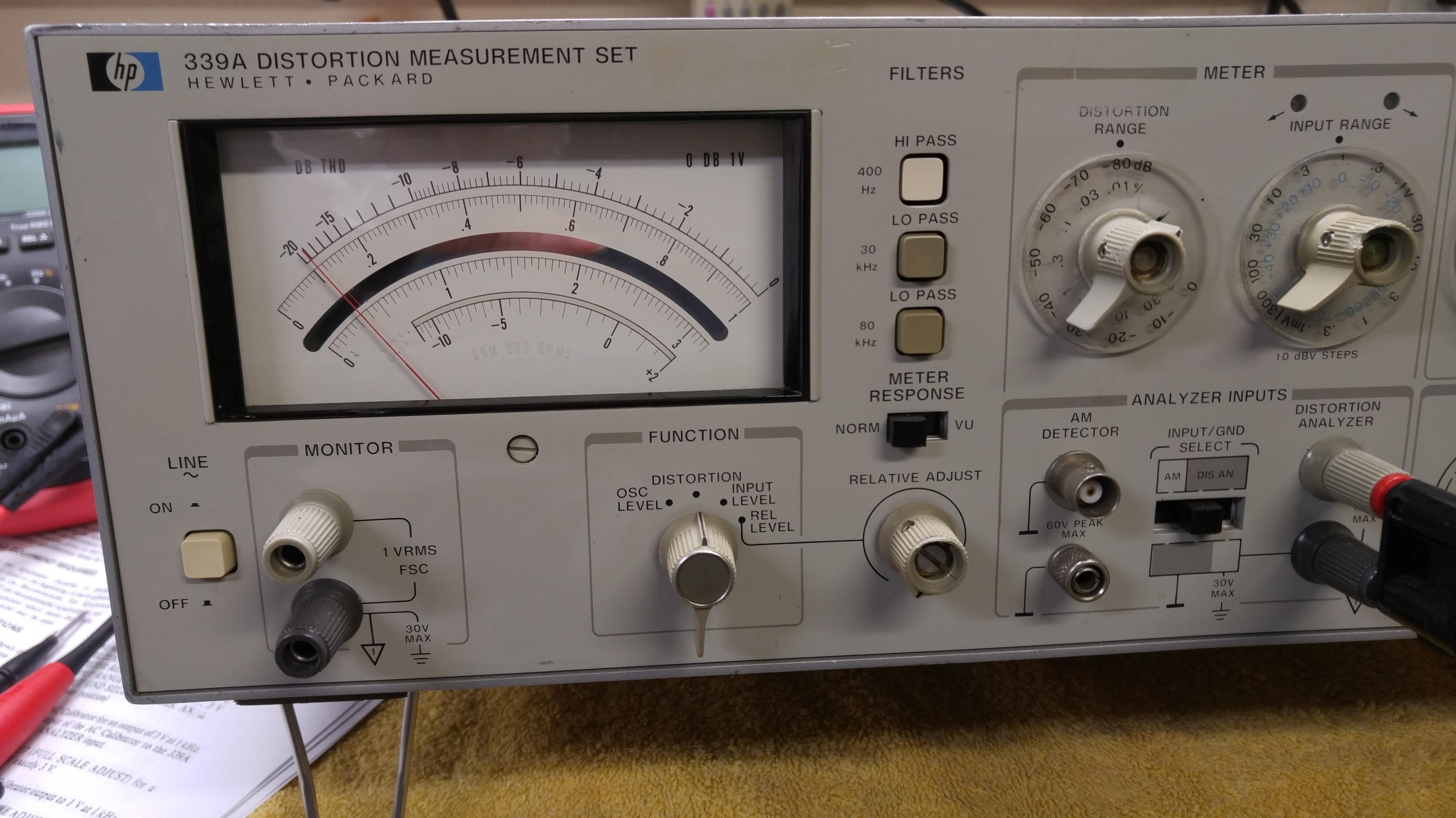

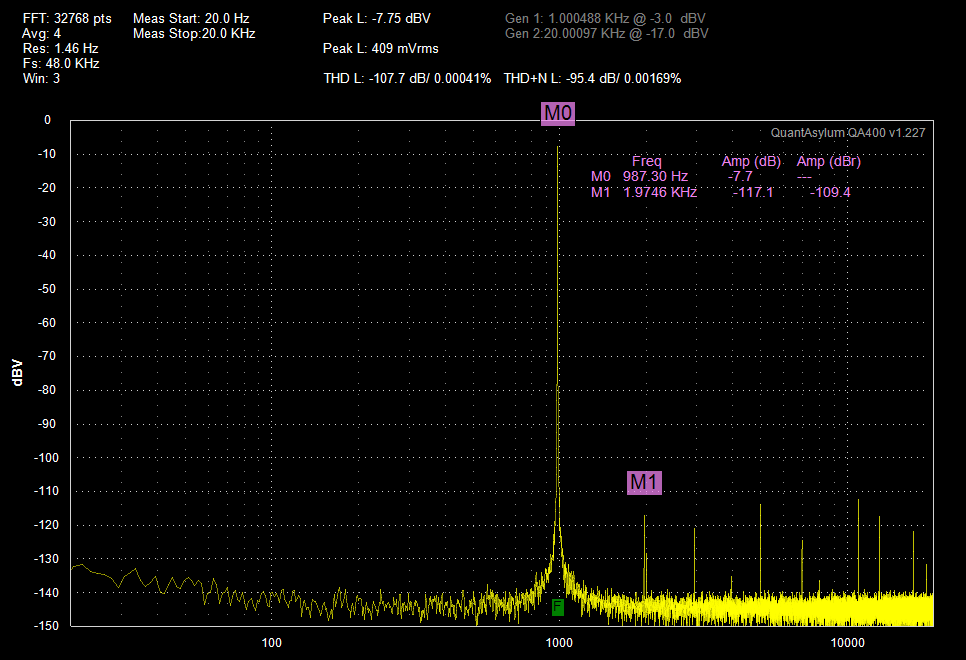

I finally decided to join the ranks of the HP 339A owners. I picked one up off the big auction site for a really good price. I received it this week and the faceplate and meter are in great shape but as is typically the case, the knobs are torn up.
When testing it had a bunch of quirks in operation. I finally tore it down and carefully cleaned ALL of the rotary switch contacts. I went through about 50 q-tips soaked with alcohol then deoxit. I found it best to remove some of the internal shields to be able to fully access some of the switch wafers. I also took the oscil. output pot apart and blasted it out with deoxit. While I had it apart I replaced the 4 large power supply electrolytics with some 1500uF caps I had in my drawer, but other than that I haven't replaced anything else.
After the major cleanup its now working great. I went through the setup procedure in the service manual but really didn't need to change much of anything. In its current configuration the meter is displaying .0011% THD when measuring a 1V/1KHz signal from the internal oscillator and that rises to about .0012% at 3V of output. I also included a quick scan of the oscillator hooked up directly to my QA400. Not too shabby... I may go ahead and do a few of the tweeks you guys have mapped out. Namely replace the output pot and install the pot to the Oscill control FET to adjust the 2H but I hate to put much more money into it as I got it so cheap. 🙂

Good to hear another succes story. Its been a while ince I joined in, but I stillnwant to revive my HP339 and your post gives new inspiration.
what symptoms did you experience before you cleaned it?
> Occasional lack of meter reading when powering the 339a on and checking the internal oscillator level.
> Occasional loss of voltage reading on the meter (with input set to Osc Level) when connecting a cable between the Osc. output and the Dist. meter input. And by loss I mean total loss, the needle would drop to zero.
> Varying 339a meter readings, usually by 50 - 150mV, when switching between Osc. Level and Input Level. This was with the Dist. meter input in loopback with the osc. so they should always read the same.
< Varying distortion levels when measuring the 339a osc. Sometimes 1V/1KHz might measure .002% then the next time it might be .0025% then .0017%, etc.
I haven't seen any of the issues others have reported of the front and rear switch wafers becoming misaligned. The electrolytic caps I replaced in the power supply had 35th week of 1984 date codes on them so my 339a appears to be a somewhat later production model. I do not know if that's a factor in the switch couplings coming loose or not.

The 339A is a great start. Our friend the late Richard Moore did some amazing things with the 339A. Richard found that if he placed his Twin T notch filter in front of the 339A analyzer he achieved a better than 1 magnitude increase in measurement performance.
Instead of the usual 0.0018% THD+N he was able to get 0.0001% THD+N on a stock 339A.
You can also achieve this using Bob Cordel's distortion magnifier. Both of these methods Twin T and Bob's DM fit a DIY budget.
Using the 339 as a front end for a QA400 is a great way to extend the QA400 and address its limitations. I would look at the 339's internals and figure out where to tie a QA400 to it. The 339 gives the QA400 the wide dynamic range and high CMRR differential input plus taking advantage of the 339's output attenuator addresses that limitation of the QA400. Maybe not ideal or pushing the SOTA but very good for a reasonable and modest investment.
