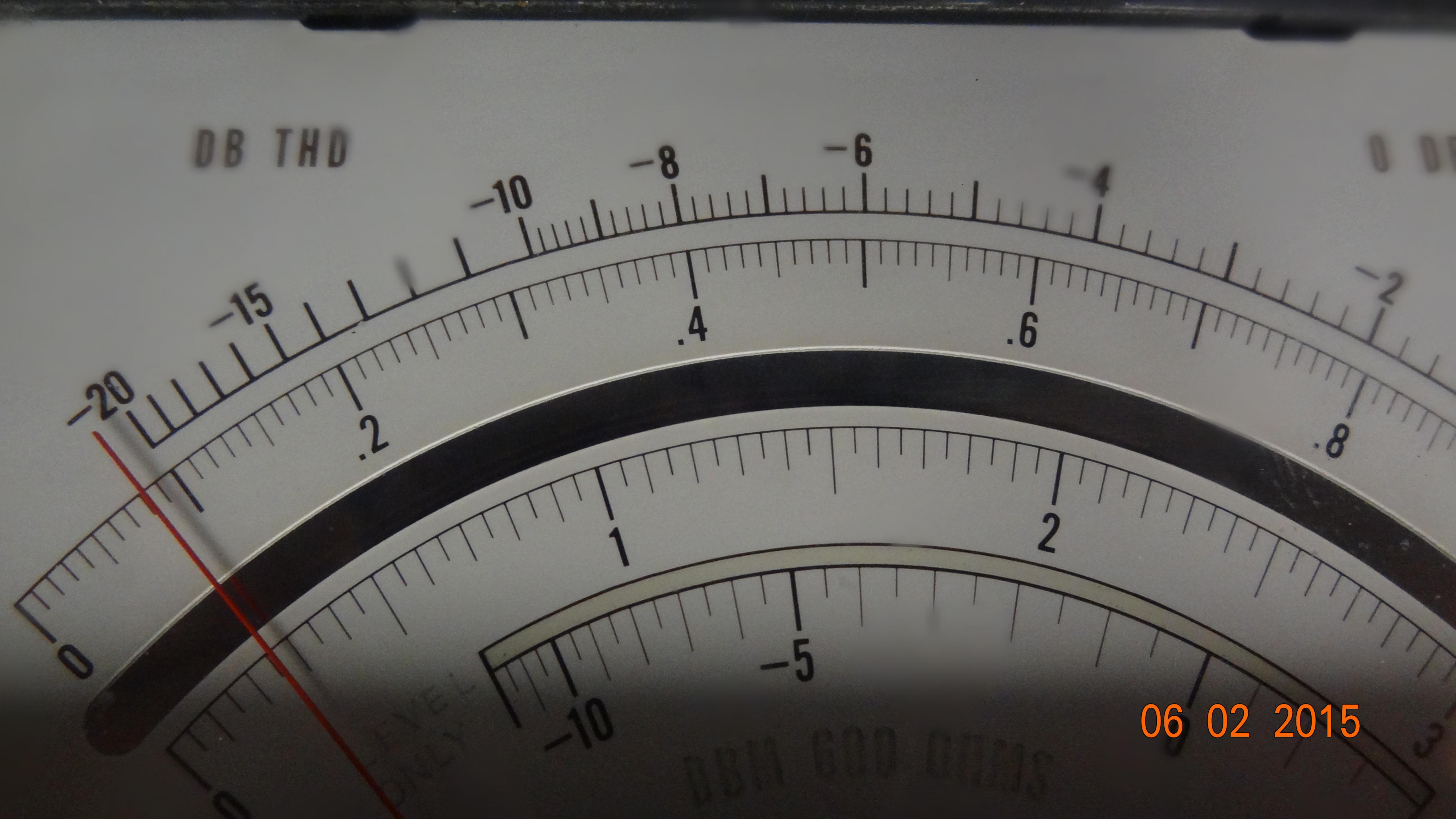

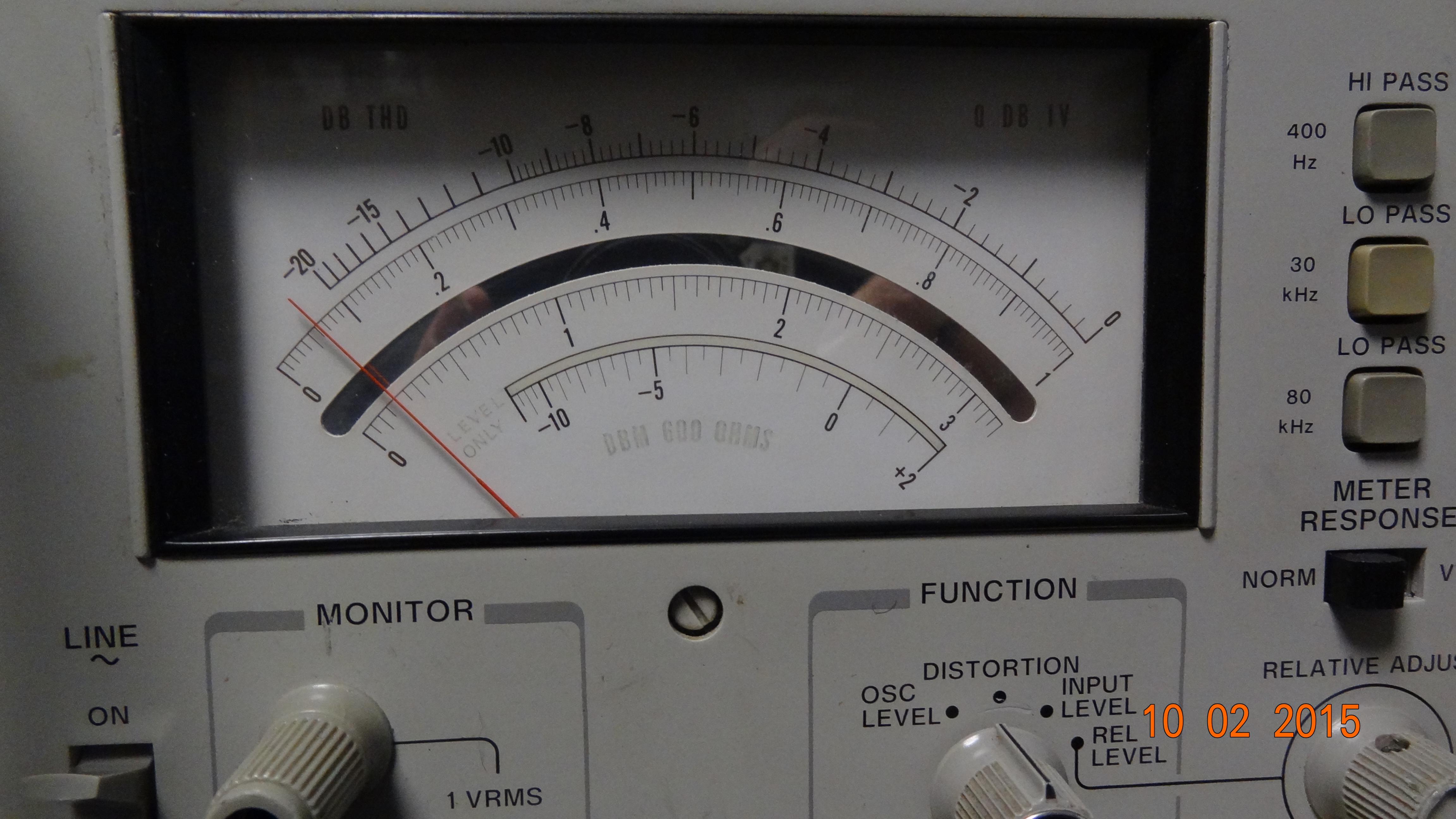

I was ready to ship it back to you.... but i was so certain from the symptoms and my experience that you had a short under the U1 quad opamp that I just removed that socket. I found the short for you between pin 4 and 5 on the top side under the IC.... removed short and put the socket/IC back in. The 400Hz filter works fine now.
I'll ship it back soon. Attached is the new 1KHz result with all filters IN. It measures well below -100dB. Your 339A is measuring residual of about .00065% THD+N (BW = 400Hz - 30KHz). 🙂 The generator is still lower than this, however.
THx-RNMarsh
THx-RNMarsh

339A, Back Home Again
Richard,
She made it back safely. Had a long and storied voyage.
Plugged her in and she's just humming along a tad better than
you showed in your last pic of the meter. Very stable : )
I had one or two short bouts of the ground issue...
makes me wonder if the HP339a IEC sockets might
be just a bit under sized, at least I now what to look
for when the symptoms reappear.
You given me more relief than you know from the on
going waterboarding that I've suffered through.
The short you found cleaned up the a lot of the
meter, Now I can finish what ever is left t o do on the
meter output.
As my little girl say's with the joy of a 22 month old:
"WWWWWhhhhhheeeeeee ! "
