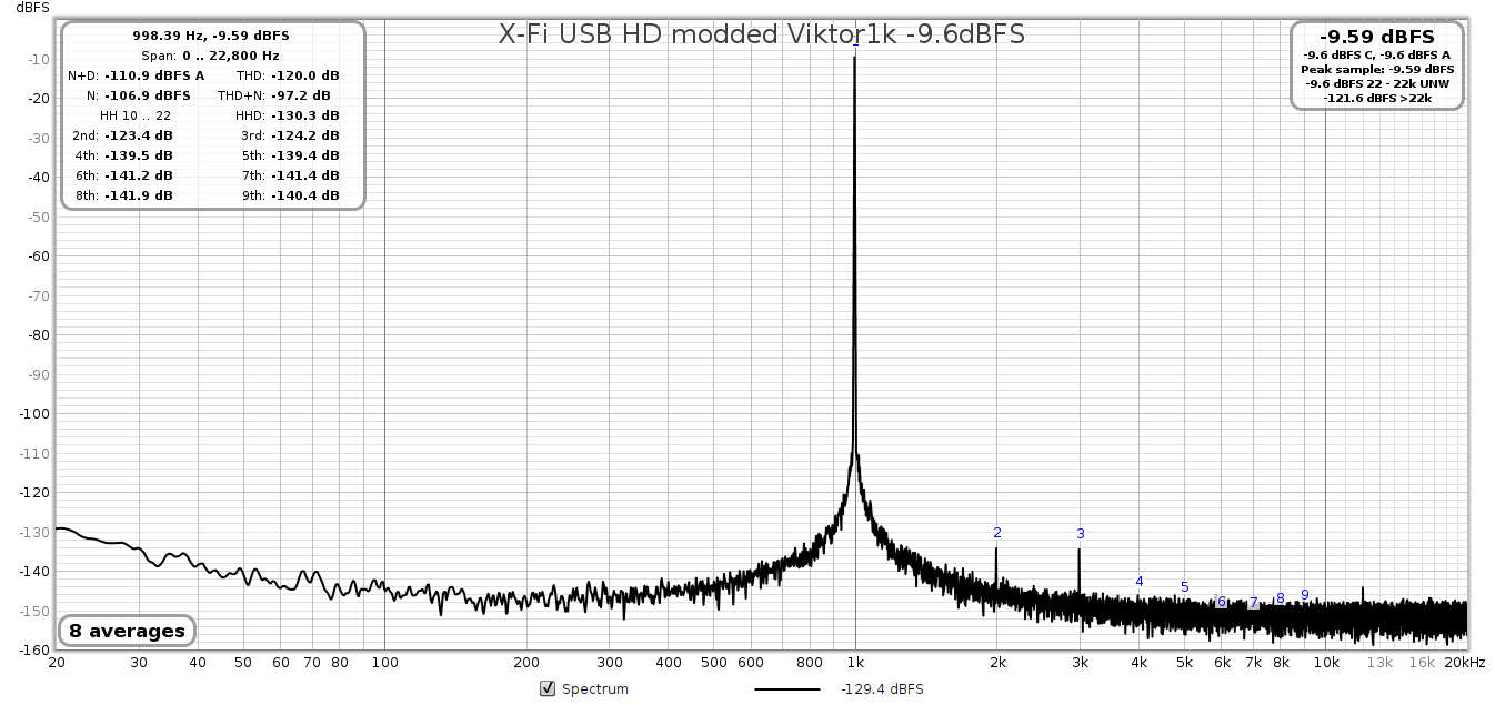

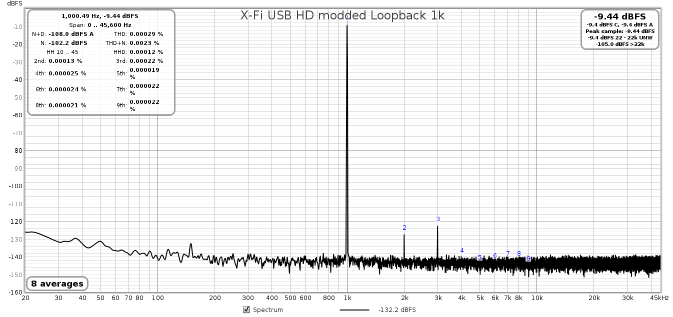

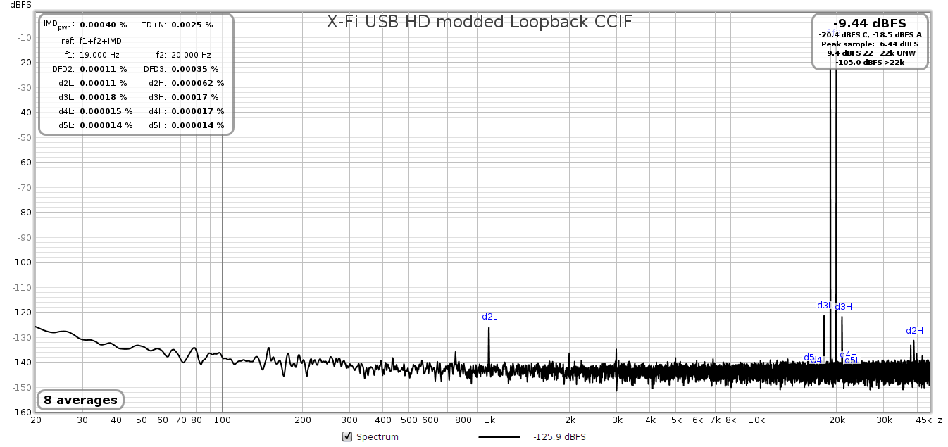

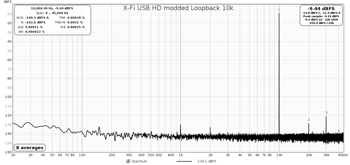

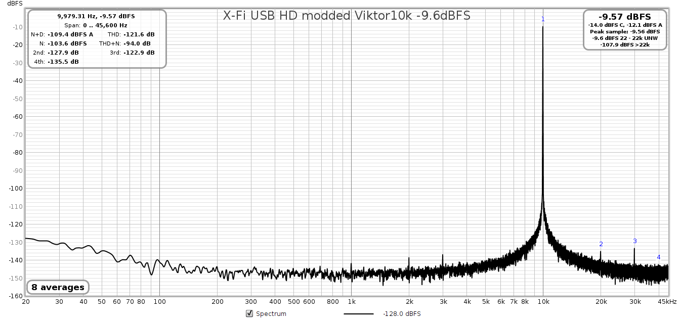

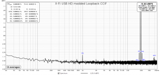

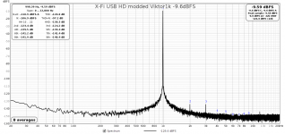

As I see my old modified usb card SB1240 is better than many newer ones.

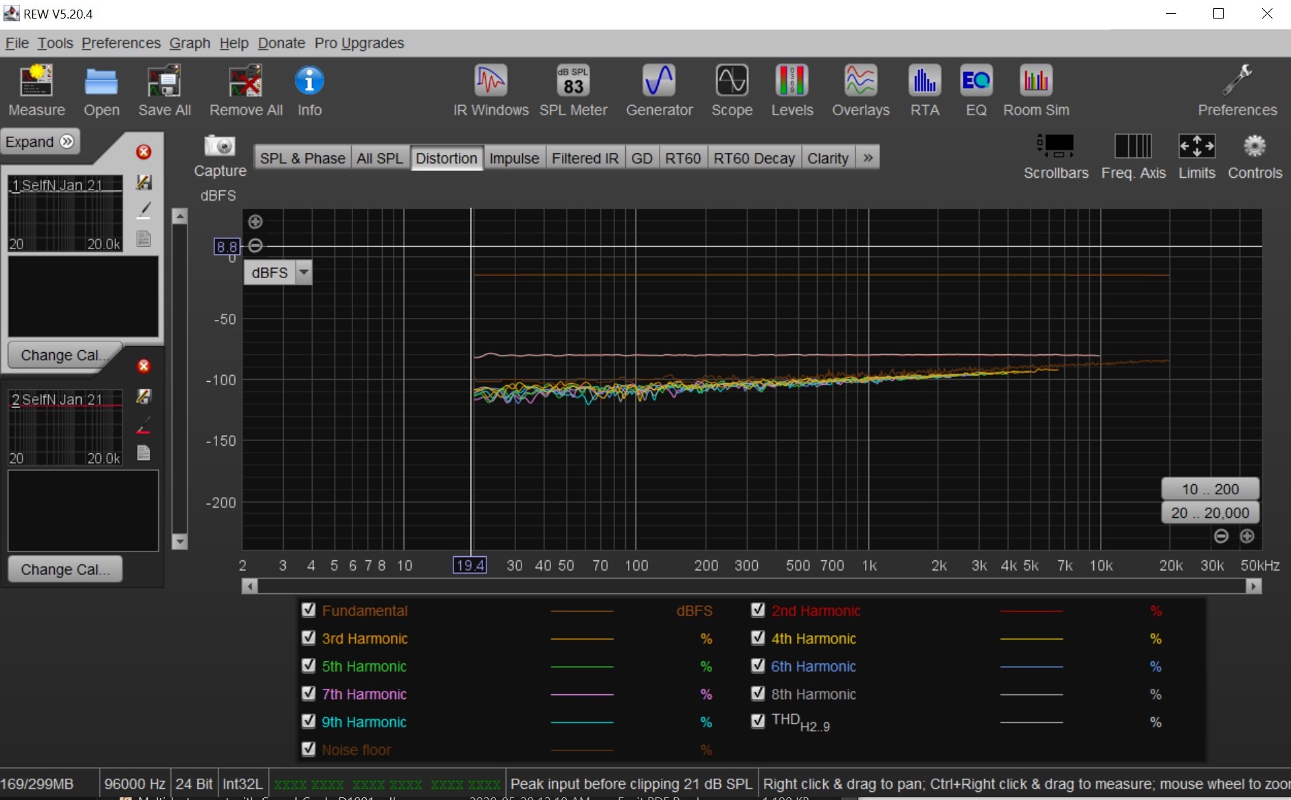

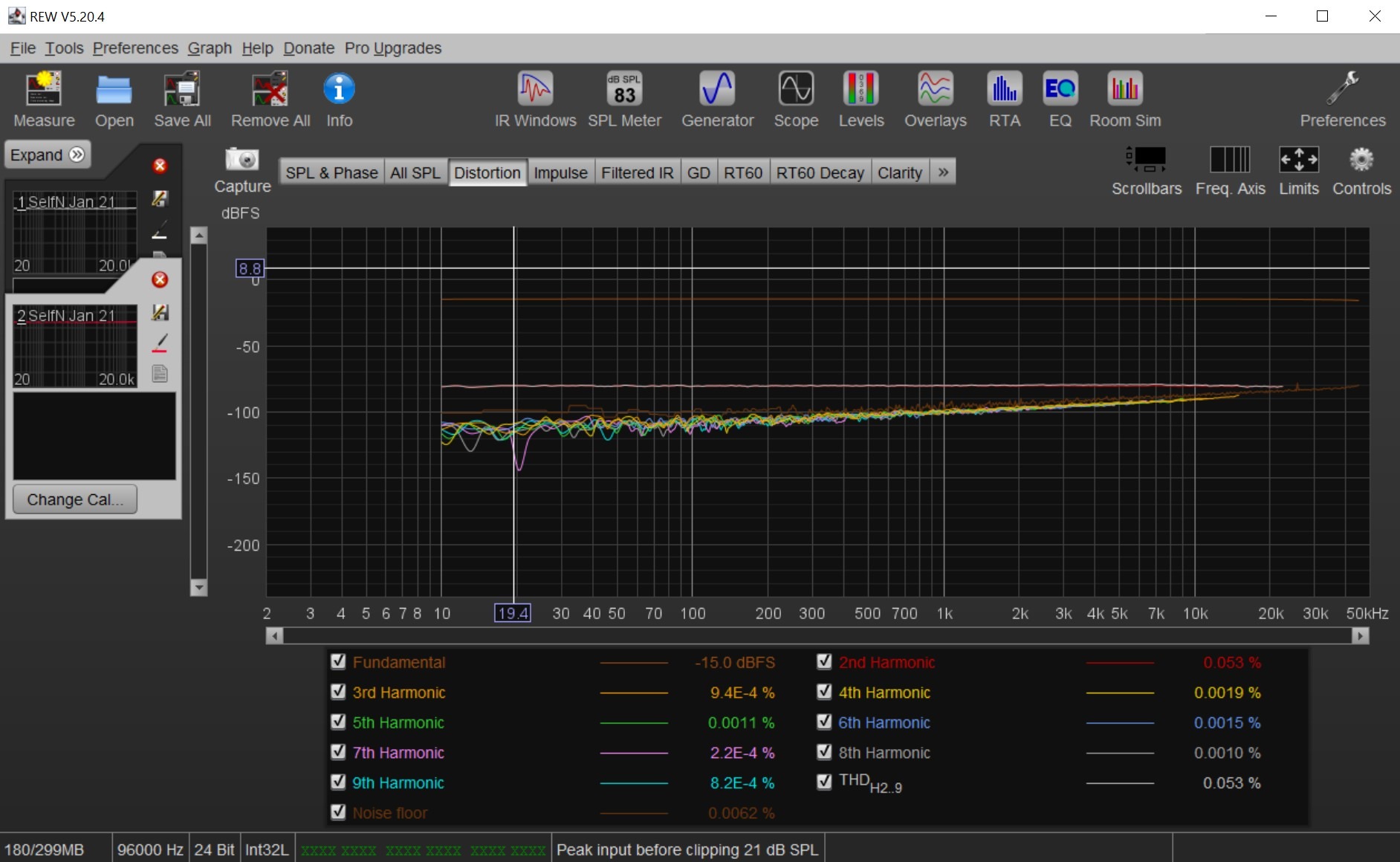

To check whether measurements with a smaller frequency range can provide less THD in calculations because my card has some spurious high-freq spikes, I did two measurements: first is 20-20kHz in the measurements window, and second is 10-48kHz. Both are with the card set at 96kHz using the ASIO driver. The respective measurements are below.
Does anyone know why I don't get any calculated figures in the Distortion window for the smaller range of frequencies?
You can see above that the table below the graph, with the Fundamental, Harmonics and THD has no numbers at all.
Now here is the larger frequency range:
Here, we do see the measured and calculated numbers for each entry.
Do you sometimes get these missing numbers? Is it user error?
Your graph cursor is placed before the data starts - it is at 19.4 Hz and your measurement starts at 20...
Thanks John, indeed user error and I didn't notice until later last night. I was puzzled for a while because another two set of measurements did show both tables with figures as I hadn't move any cursor that time and that initial set of measurements on reloading didn't show any figures anymore...
