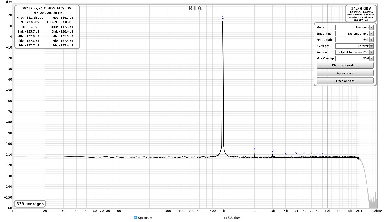

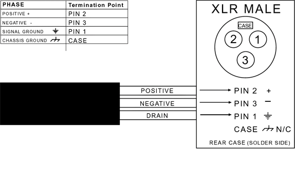

I've seen that but I'm getting terrible results and wanted to see if I'd connected it wrong, so again to connect the phono output from the oscillator the signal (+) goes to pin 2 that much I know is correct, signal ground goes to pin 1 yes but do I then connect pins 1 and 3 together as the input to the xlr is single ended.
reddish75 here is my M2 with RickRay's suggested pin out. This is using Akitika's 2ppm osc. The grass around 20khz seems to be coming from the laptop. The M2 is so sensitive even moving the laptop away by about foot makes a difference to the noise floor. As does disconnecting all other usb devices.

Triplej, you may be able to lower the noise floor by using a larger FFT.

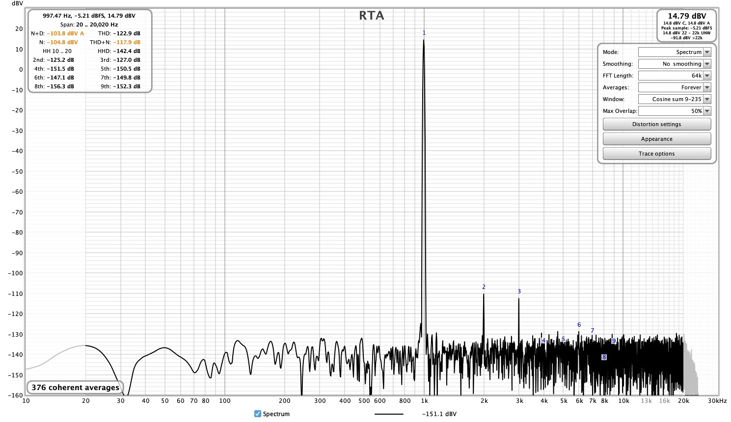

Thanks trobbins, FFT length? setting to max makes no difference its around 116 dbfs with inputs unplugged. looped back using REW's osc. i get a similar 00016%. I tried cancelling the harmonics with limited success. Yes the Akitika is limiting the measurement here hence I'm keen to see what reddish can achieve!
I usually find that for external sources, setting FFT length higher (eg. 2M or 4M) along with max averages will lower the noise floor noticeably - the downside is it takes a longer time to make every measurement and then average, so plot updates can take a long time (perhaps depending on the PC grunt).
If you do a loopback then you can turn on coherent averaging, and lower FFT length to circa 64k, and max the averages to get an even lower noise floor. That typically allows the harmonics to be more discernible, which can help when trying to null harmonics by adding REW harmonics. Also it can take a while to work out a technique to lower each harmonic - which I find requires first iterating magnitude to where it just has an effect, and then adjusting phase (+ or -) to get a minimum, then going back to iterate magnitude by 1 or 2 dB to try and detect a minima, and then iterating phase by a few degrees either side to find a minima, and iterating again to confirm you can or can't get a better null. Those iterations are best done with a low averaging number otherwise it can take ages to get each refresh.
PS. I just looked at your plot again - the THD reported level appears to be including unrelated signals - which can avoided by using suitable low and high filter frequencies in the Distortion settings control box.

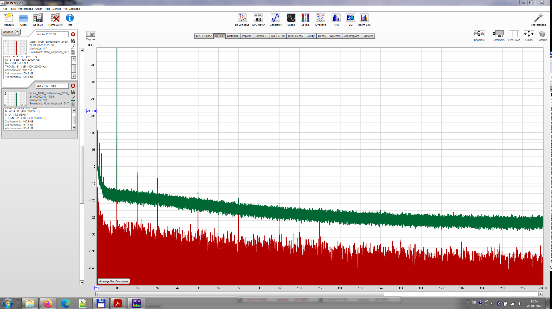

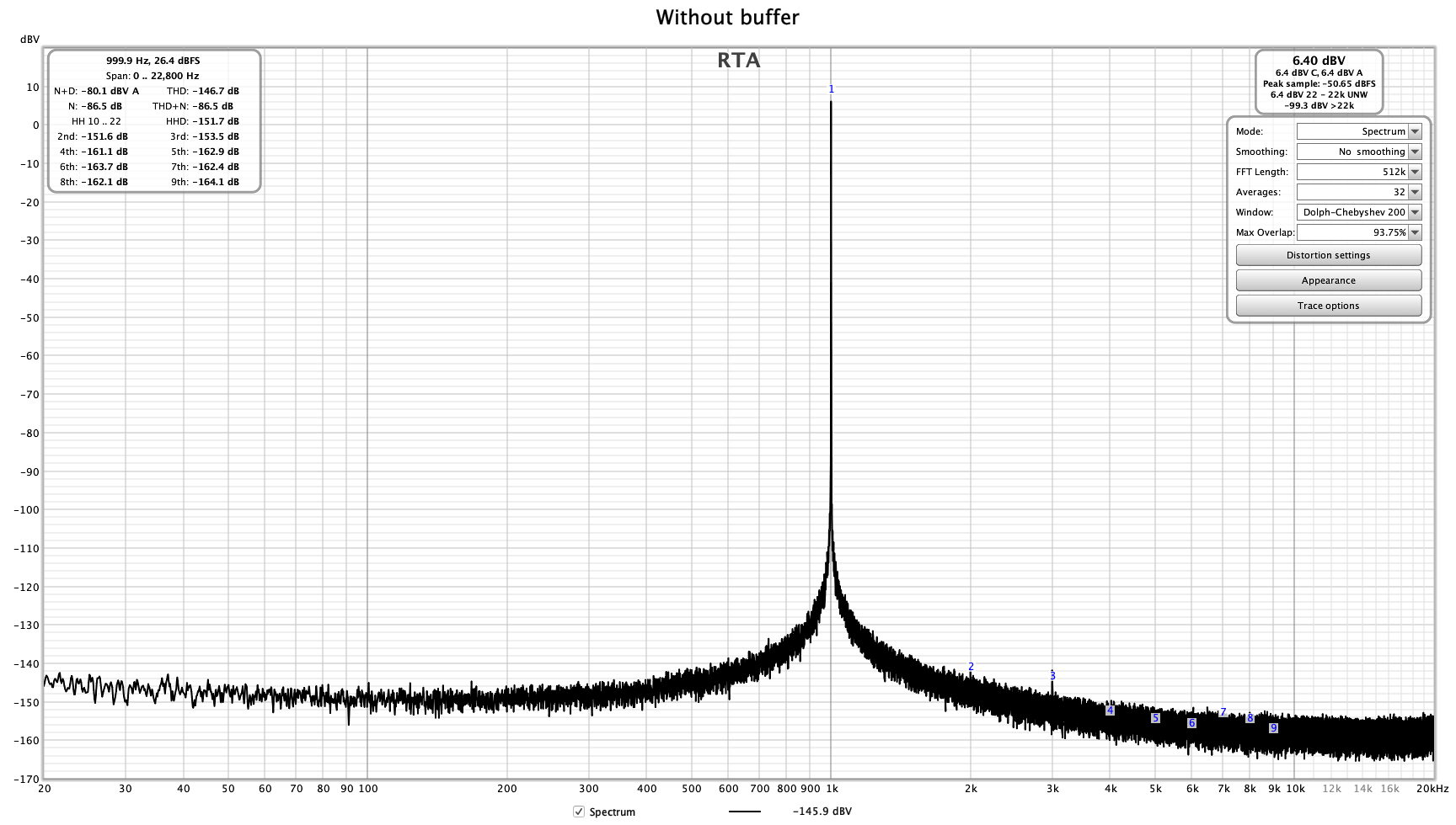

FWIW, here is a result obtained with a modified Motu AudioExpress sound card.
The setup was Victors's at 2.5V followed by a unity-gain 1656 buffer in the same box, feeding a notch filter whose output was amplified by a 60dB Wurcer's LNA from this forum. The FFT had a length of 512k, spectral window was Blackman-Harris 7, 100 averages.
The green spectrum refers to the standard, i.e. linear averaging, the red one to the coherent averaging.
Comparing the harmonics in the respective THD result boxes, the 2nd harmonic is practically the same at about -106dBFS, but the 3rd one is higher by 5dB when averaged coherently. The other odd harmonics are also much higher in the coherent version, but of no concern here since their true level is much lower due to the notch filter residuum having been amplified by 60dB. For example, accounting for the notch filter attenuation and the LNA gain, the 2nd harmonic lands at -156dBc (standard caution as regards possible distortion cancellation applies).

NicMac, afaik Victor has steadily improved his oscillator over the years - the most credible measurement I've seen is in this link ( https://www.audiosciencereview.com/forum/index.php?threads/e1da-cosmos-adc.27038/page-2#post-946458 ) which shows 3HD as the highest level harmonic at -150dBr. It may be that the measurements in #1173 are displaying harmonics generated in the RTX6001 and soundcard setup - if that was the case then a notch filter would be needed to suppress the RTX6001/soundcard generated harmonics (which was a recent topic I went through with my EMU0404 in https://www.diyaudio.com/community/...adc-and-dac-side-harmonic-distortions.381839/).
I looked up John's notes for coherent averaging on the REW forum - https://www.avnirvana.com/threads/coherent-averging.7001/#post-51899
So when measuring an external oscillator, REW can determine the fundamental frequency and go from there, or the fundamental frequency can be measured (eg. by REW) and REW's tone generator can be set to generate that exact frequency and that will then force REW to that fundamental frequency.
The spectra I showed really just show the harmonic distortion of the RTX ADC.
I well know Victor's oscillators can be as low as -150 dB for the highest harmonics.
That is also what I find when using notch filters and a bunch of very nice REW features.

Ok, so it seems that the Motu doesn't like xlr input, or I continue to wire it wrong, signal to pin 2 and ground to pin 3? This way gives pretty terrible noise results. Any how now its wired up by Trs and this is the result I get,
