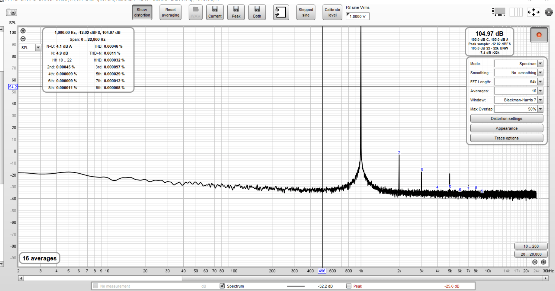

I don't think it looks so bad. Harmonics below -120 dB.

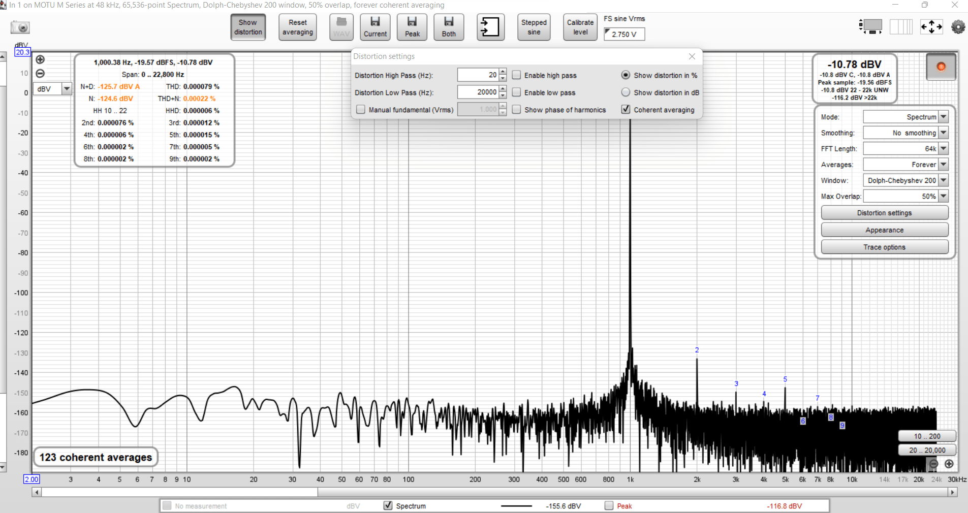

You should really change the Y-axis unit (from SPL to dBV) and tell RTA what the input level is (in the top box labeled "FS sine RMS") if you want sensible numbers for noise.
Now we're getting somewhere. 000079% THD / 0002% THD+N ! I find the motu is easily over driven. You may get even better THD figures around -30 dBFS

Noise related numbers are not valid when using coherent averaging. That is why they are displayed in orange.Now we're getting somewhere. 000079% THD / 0002% THD+N ! I find the motu is easily over driven. You may get even better THD figures around -30 dBFS
Calculate or us a web converter like this.
How did you determine that the FS sine Vrms is 2.75V?
I used my dso scope with rms readings but used a 1x bnc to phono wire first with the scope set to 10x so ignore that reading.
Here ive used the correct 10x probe to measure 1vrms from the oscillator then connected it all back up, this is what I have now,
From memory it was only about 150mV RMS before the THD started to creep up. I guess the easiest thing is just reduce the level to optimum THD reading. Also saw somewhere the Vic Osc. has a minimum output of 300mV ?
The link in #1177 indicates it may be important to keep Victor's oscillator output set to max, and attenuate externally if noise level becomes a concern.

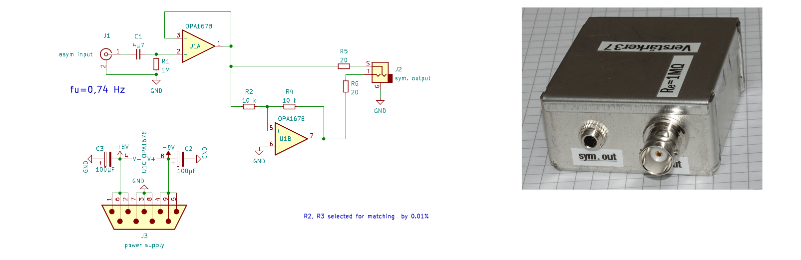

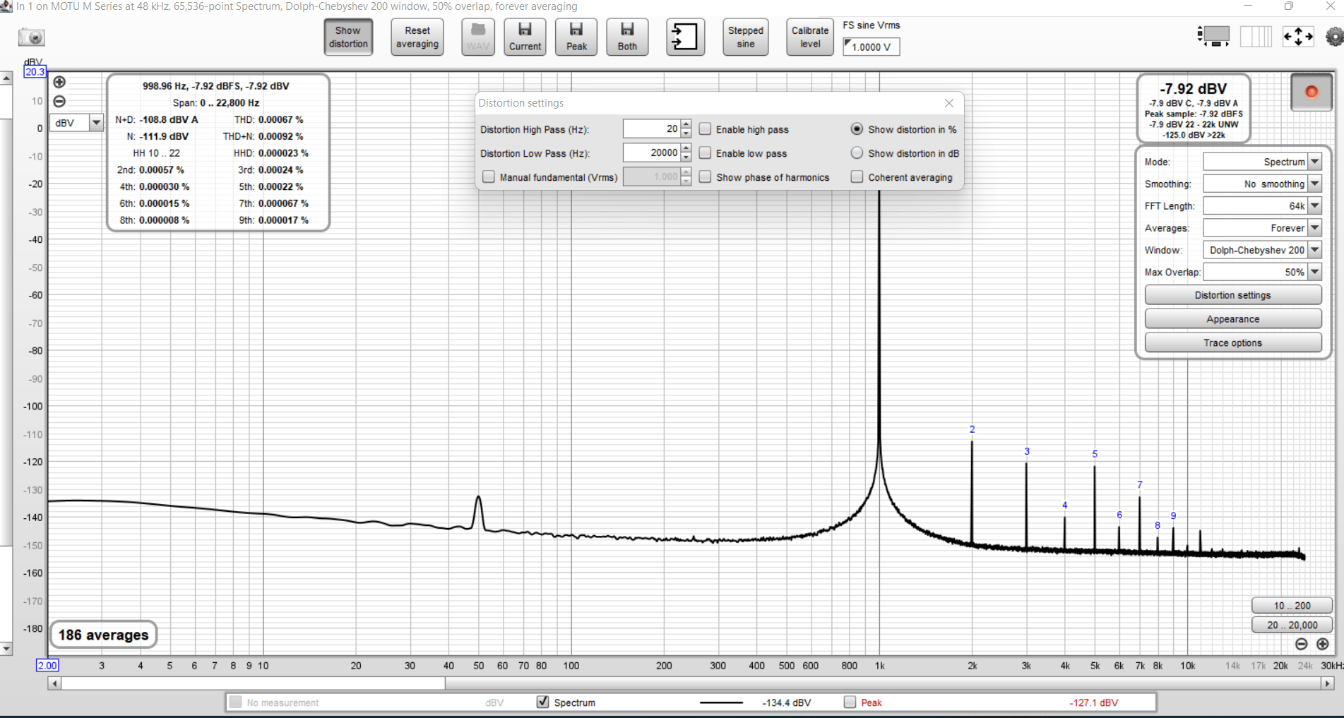

Have a look at Wtnh's diagram in post one. This utilizes the balanced input of the MOTU. I can't get rid of the last bits of mains noise (probably needs to be shielded, 0.1% resistors etc.) but gets readings down to ~120dB THD. Xrk how about a nice little active unbal to bal converter with input attenuation and output clamping to protect our sensitive sound cards!
I use this one. It converts any bal/unbal input to bal output.Have a look at Wtnh's diagram in post one. This utilizes the balanced input of the MOTU. I can't get rid of the last bits of mains noise (probably needs to be shielded, 0.1% resistors etc.) but gets readings down to ~120dB THD. Xrk how about a nice little active unbal to bal converter with input attenuation and output clamping to protect our sensitive sound cards!
For the Motu, such a converter is really a good recommendation. Asymmetric signals show high THD. I use a similar converter to measure asymmetric signals.
Shielding is important, as well as a potentail free power supply, therefore i use a LiO battery pack to operate it. OPA 1656 may be better in terms of noise and THD, but i did not test that.

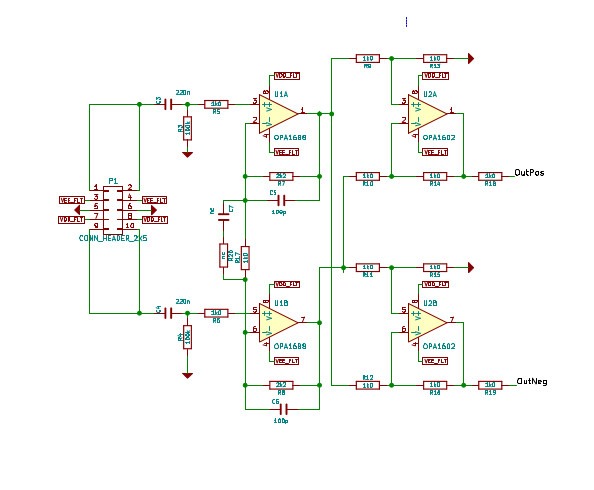

Might give that a go. I wonder if running the 1656 @ +/- 2.5v would protect the soundcard input?
lower supply voltage increases distortion and affects other parameters. If your soundcard has proper input protection that should be sufficient.
