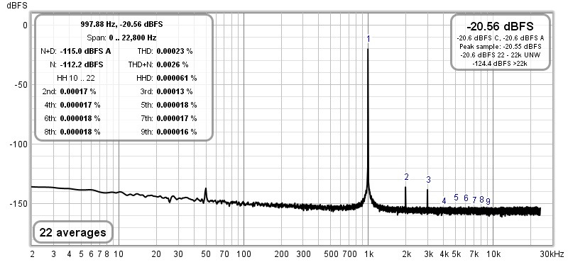

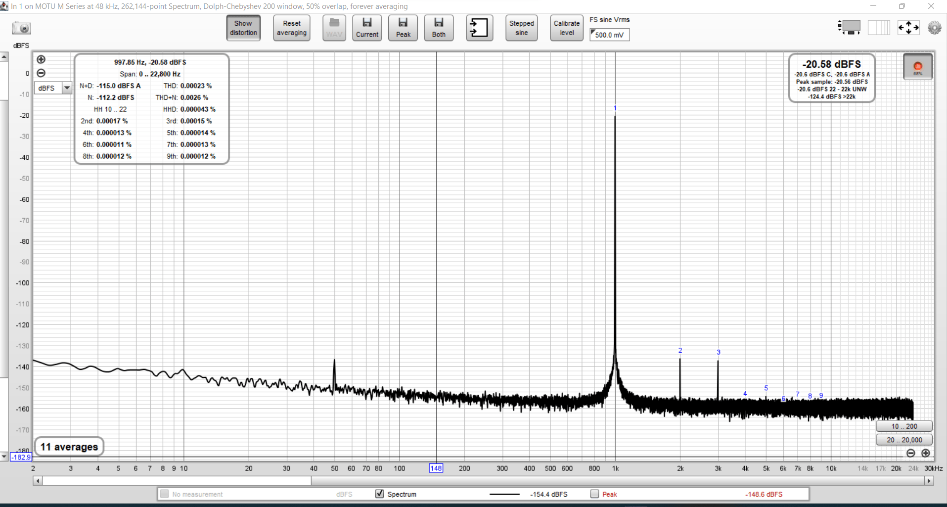

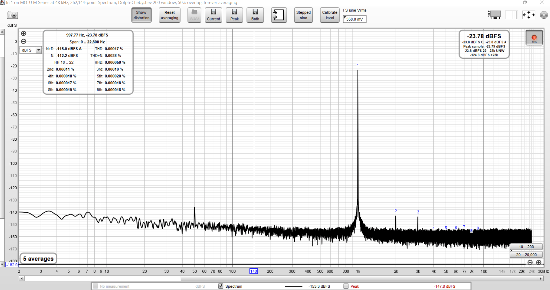

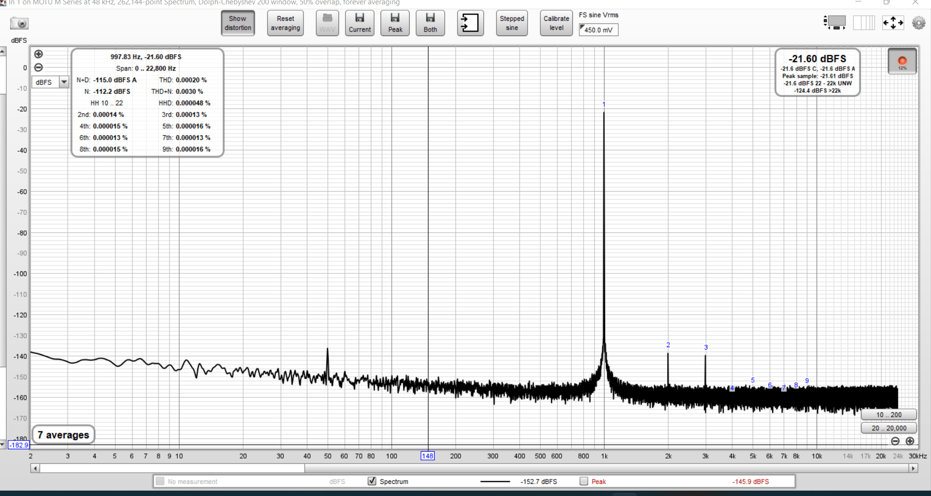

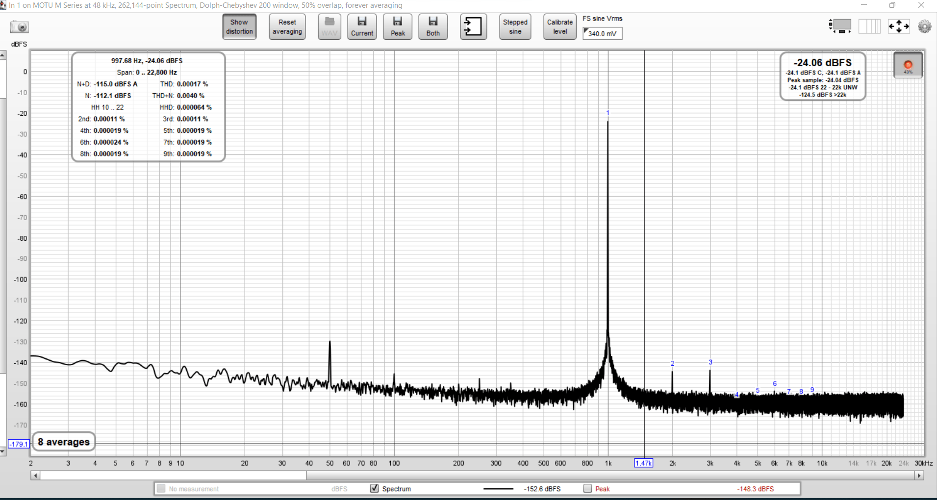

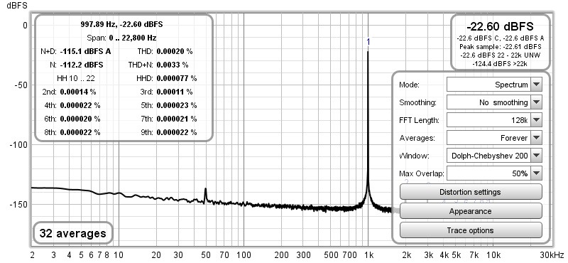

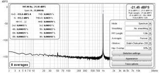

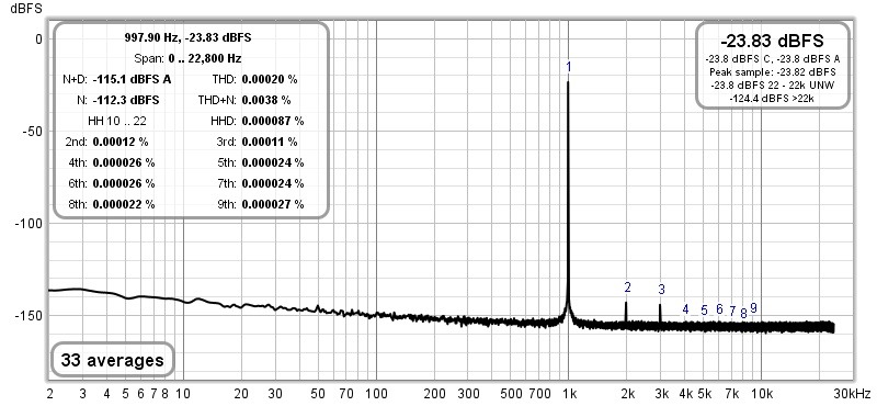

Ok folks seems my Autoranger now works and this is the setup I will use I thought I'd post some measurements. Note that Victors Oscillator isn't in its case and I'm using this psu to power it - http://tolisdiy.com/2019/03/11/low-thd-oscillator-power-supply-and-pcbs-as-case-panels/ both the autoranger and Victors are powered by battery powerbanks. The output of the Autoranger is set to 0.5v and I'm using the balanced input/output. Voltages out of victor are 0.5v, 0.7v, 0.8v 0.9v, 1v and full output 2.77v in order.
Some more detailed pics, voltages from Victors 0.34v, 0.4v, 0.5v, 0.6v, 0.7v, 0.8v, 0.9v. 1v and again full output 2.77v, Autoranger output to Motu in order 0.34v, 0.4v, 0.5v, 0.6v, 0.35v, 0.39v, 0.44v, 0.5v, 0.34v, pics are labelled

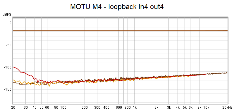

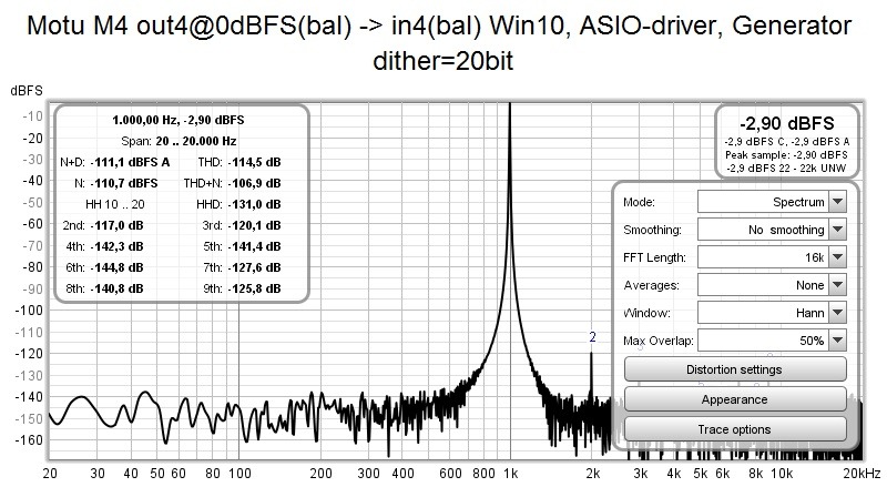

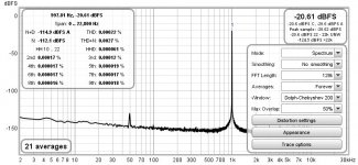

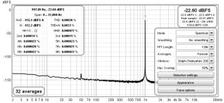

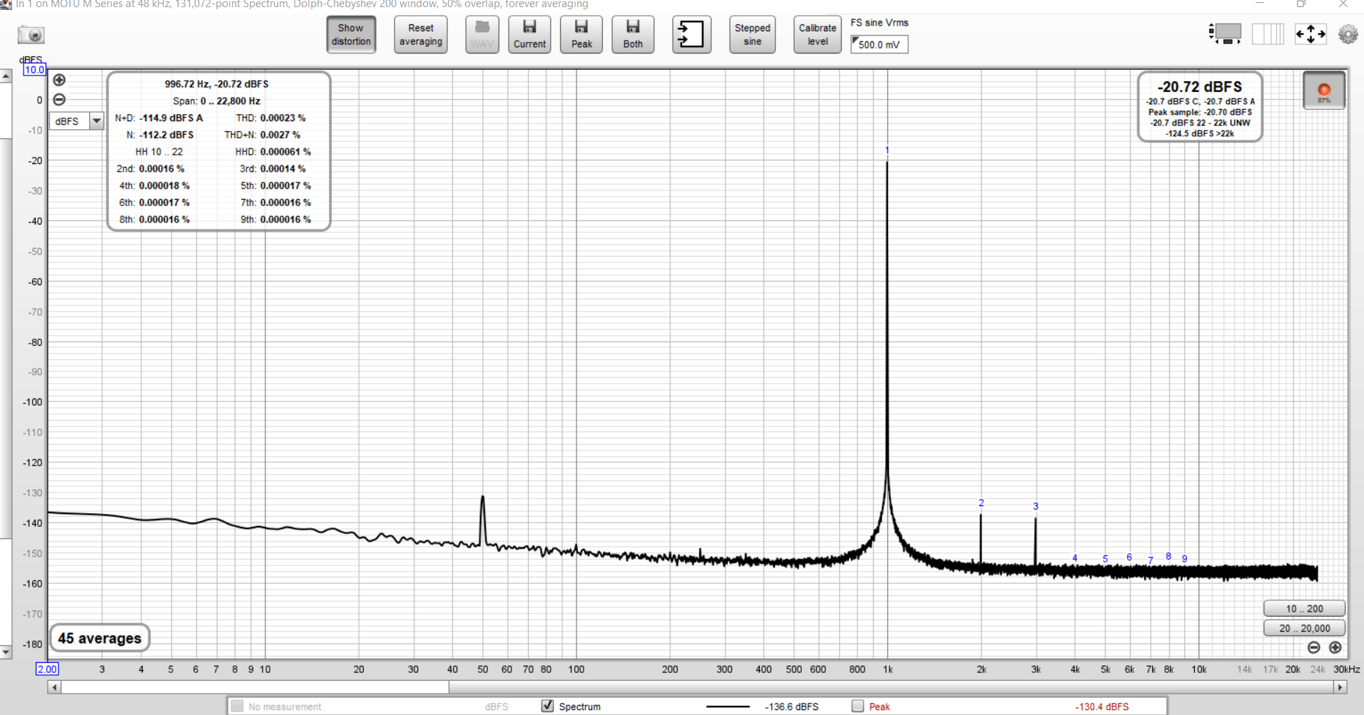

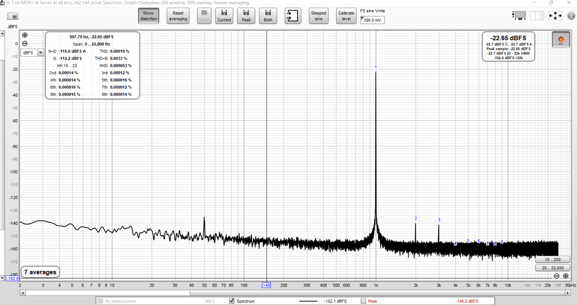

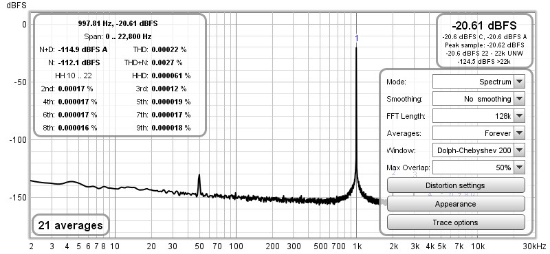

Today I received my brandnew MOTU-M4. After fiddling several hours with Linux I gave Windows🙁 a try, and after playing with the setting and some support from the internet.
https://panther.kapsi.fi/posts/2020-02-02_motu_m4I am happy to achieve a SINAD >100dB as expected
To make this work with windows installing the MOTU driver is mandatory - despite the "class-compliant USB", Haha!😛
What setting did you use? output levels, gain, etc.
You find this info in the graph of #1210. Input4 is line input and has no gain setting at all. Actual input level is shown by REW as well.What setting did you use? output levels, gain, etc.
I also have a MOTU M4 and I am able to replicate your setting. I was using input1 which has the gain. I have moved to the input4 now.
I think you set generator output to 0dB to get input to -2.xdB?

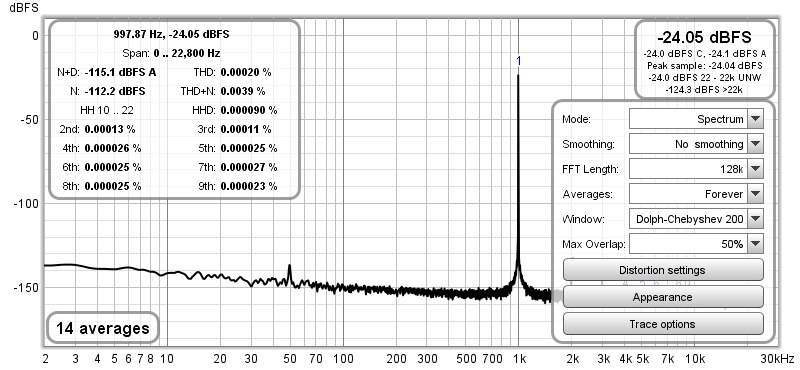

I was playing around with the windowing. Hann has the fattest main lobe. Audio Precision default is apparently similar to Dolph-Chebyshev which is much narrower.
I do not think so, as long as the amps you measure are worse...
Yes, output was 0dBFS. Until now I did not focus on the main lobe but on the total SINAD. Besides I think it is a good idea to come as close as possible to AP as this is the standard we have to compare to.I think you set generator output to 0dB to get input to -2.xdB?

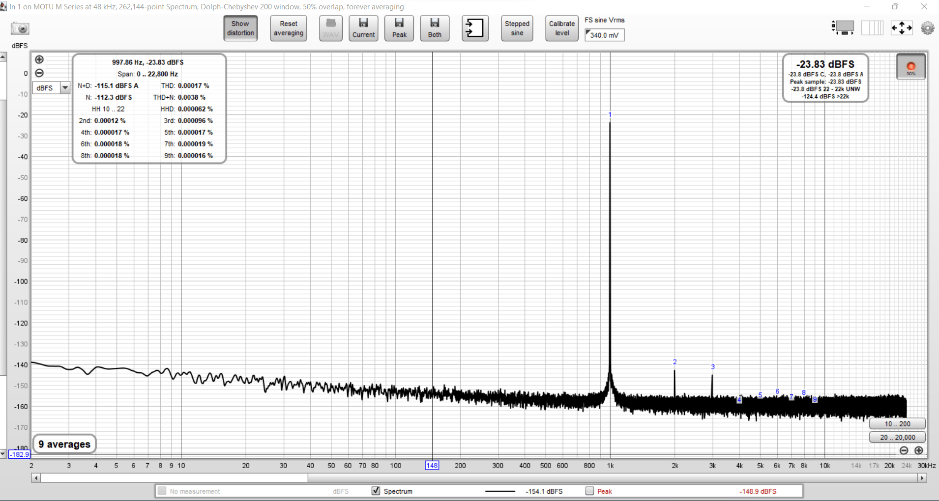

It would be interesting to have settings for FFTs depending on use cases.
Increasing FFT-size lowers the noise floor making harmonic distortion better visible in the graph. You may play with all these parameters, and most of the time, you will try to "beautify" the graph. For that reason, FFT-graphs are a questionable way to compare things.Makes sense for looking at audio band.
While playing, look at numbers, do they change? Most of the time they do not, and it is the numbers we will compare at the end, just as Amir does.
I think 16384 FFT bins is a good starting point.

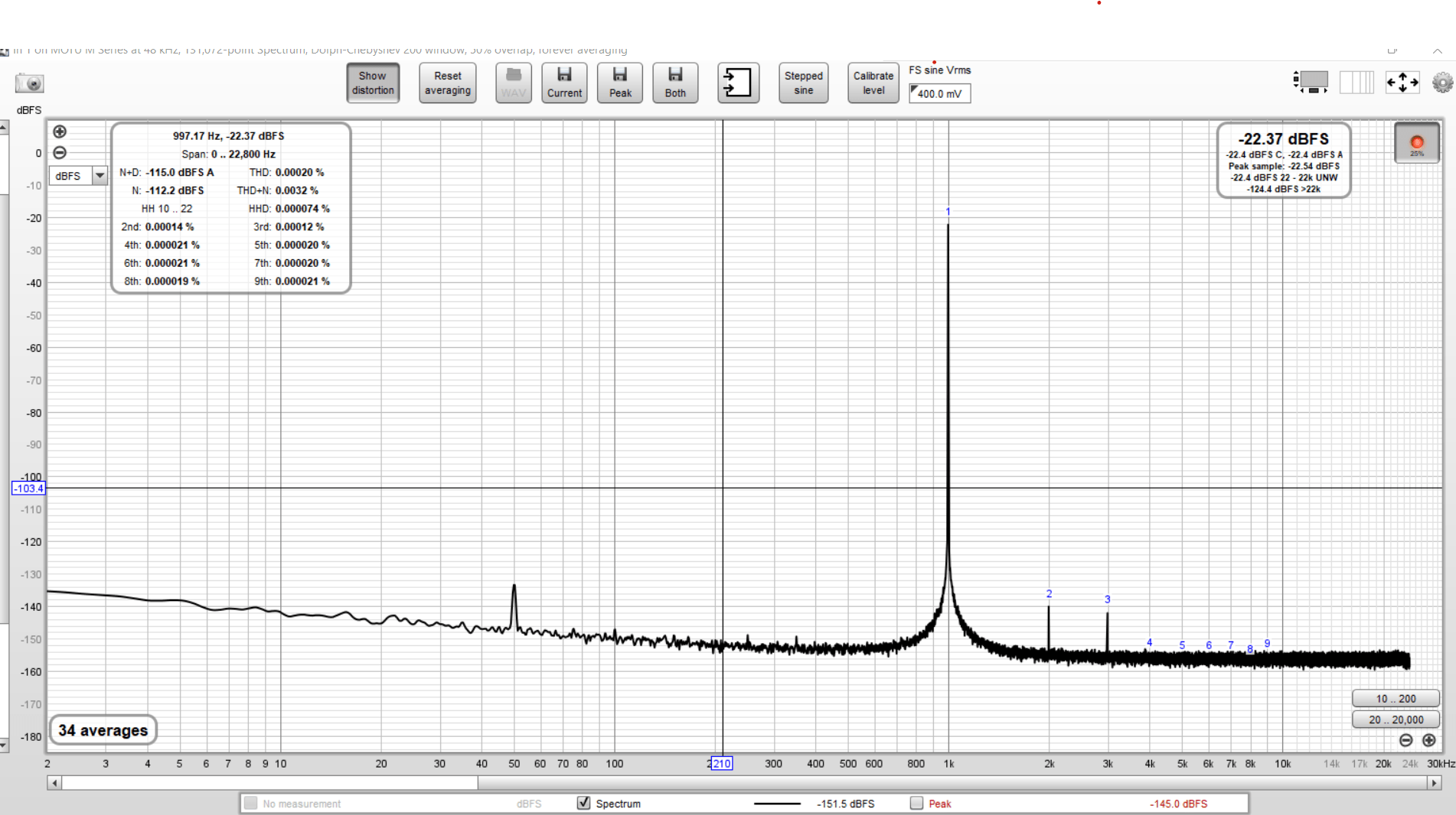

As you will never achieve a broader acceptance of a set of common FFT parameters, best practice is to focus on documenting the settings completely imho and have a look on what the pros do. And play with all of them to get a feeling of their relevance. In the real world there even exists no general accepted procedure to specify output power of audio amps, so how can you expect general rules for FFT-plots?Which is why some standard way of settings things up for more realistic figures and comparisons and depending on use cases is a necessity.
