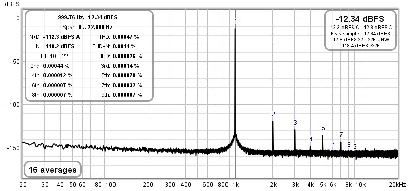

After some more tests today, I now know I have a glitchy UMC202HD: check the spikes at around 24k and another smaller one at 48k.
If anyone has an idea of where to look to fix this, I'm game to open it and try it.
Yes, loopback performance first. You may vary digital output level somewhere between -10 ~ -1dB FS for best THD+N.

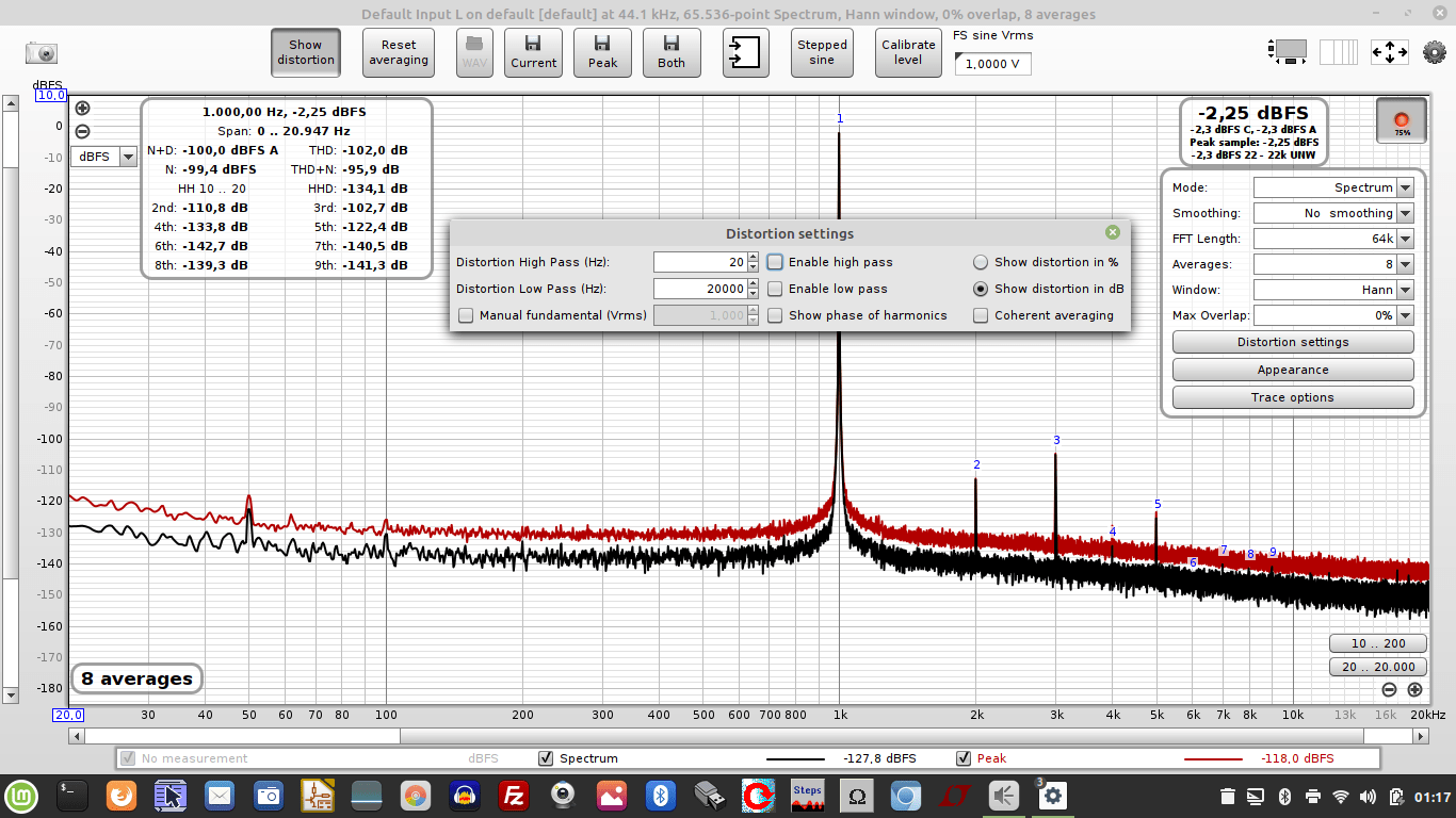

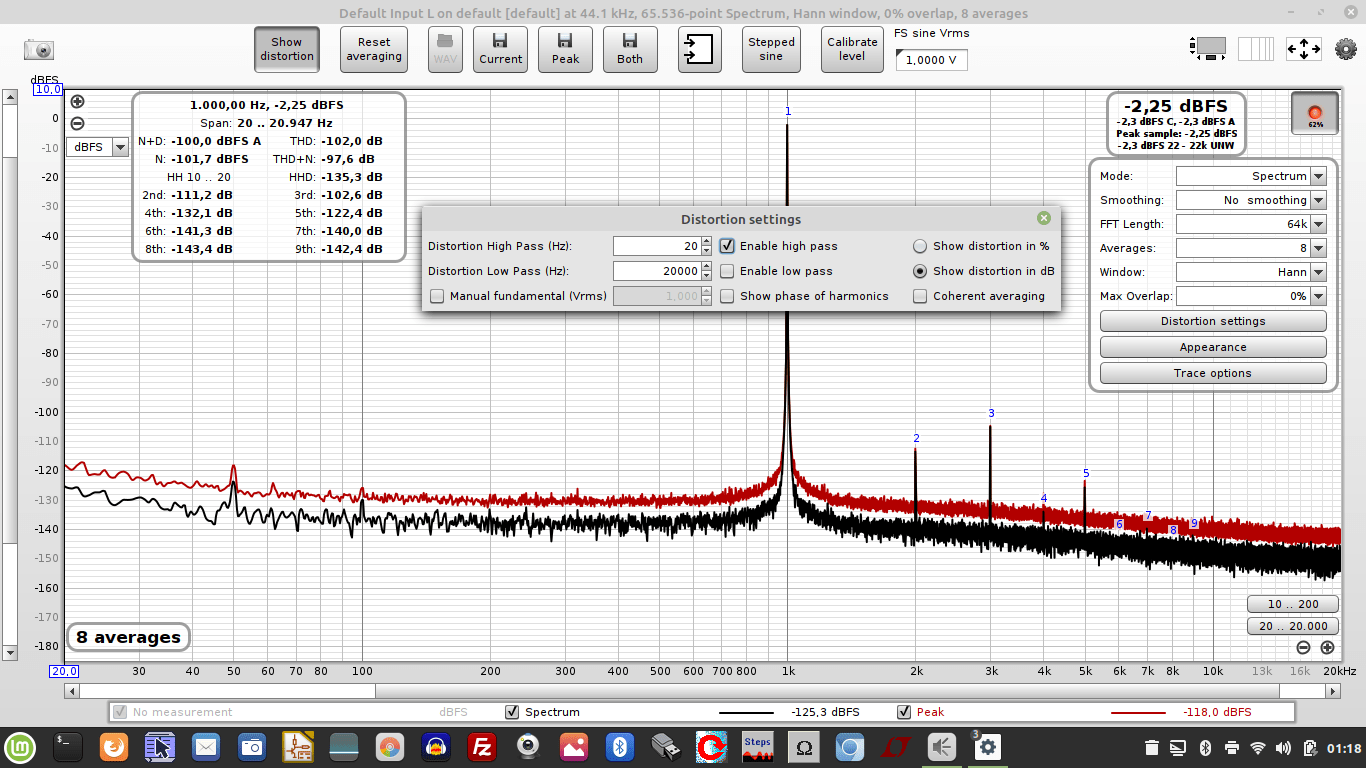

Being a long time user of ARTA I finally installed REW on my Linux/LMDE laptop. Installation was not glitchfree - as expected. Output heavily distorted, I checked the output with the intrinsic scope and so discovered periodic disrupted output. Increasing buffer size from default 32k to 64k fixed that. Rectangular FFT-windowing looks pretty useless so I choosed hanning. Compared to ARTA the REW sw offers a bunch of additional knobs for customisation. I append 3 loopback screenshots. The first without bw-filter, the second with a 20Hz hi-pass and the 3rd with 20Hz HP & 20kHz LP.
It is interesting that the 20Hz HP improved THD+N, whereas 20kHz LP did not show significance.
You may have noticed the noise floor decreasing vs frequency - this is due to a LP between output and attenuator set to about 1.5kHz.
Output noise of this soundcard is significant and could be improved by more filtering.

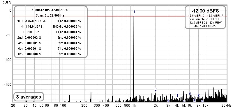

Try reducing the input to around -12dB, use Blackman-Harris window, and 128K FFT length. The important thing with REW is to be consistent with settings, otherwise, you end up all over the map.
I agree with the need for consistance. There are many knobs in the chain to play with in REW, much more than in ARTA.
Comparing bandwidth with published data is a general issue because often not specified explicitly.
Best input level depends on your specific sound card.
The THD+N sweet spot of my EMU-Tracker is close to -3dB FS but THD sweet spot is close to -12dB FS.
A filter centered around 1kHz between sound card output and amp input will reduce generator noise thus improving the overall SINAD of test setup.
Displaying the settings in the spectrum plot improves documentation...
