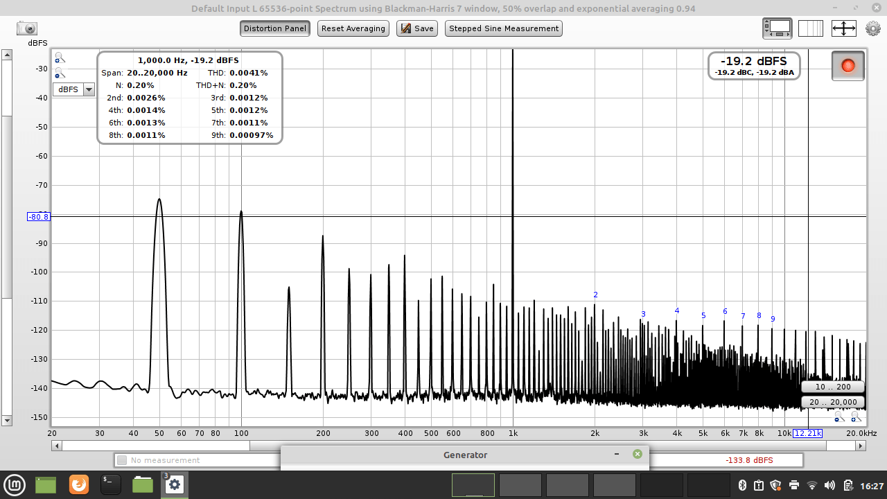

I tried this now, and when setting output-level to ~0.05v rms and input line to just before clipping (same as without pin 3 connected)...For using single ended to balanced you need to connect pin 1 (GND) and 3 (-ve) together and make that the RCA sleeve, pin 2 (+ve) to RCA center. Without the ground reference in SE mode it is very noisy.
There aren't much difference... I will try to use XLR pin 2 & 3 for "balanced" input, and "tip" & "ring" for the output, to see if it will make a difference.
When turning both output and input to "zero" i get the same picture as before.
I can't seem to find anywhere howto adjust levels/RMS to make the loopback test, can some tell me the correct procedure ?
Jesper.

For best performance always use MINIMUM input gain setting at the soundcard. Then close the loopback and set output driving voltage for minimum THD+N reading.
I would expect something between -4 and -10dB FS input level as a sweetspot.
Ahh... i got it...For best performance always use MINIMUM input gain setting at the soundcard. Then close the loopback and set output driving voltage for minimum THD+N reading.
Thank's for clearing this out for me.

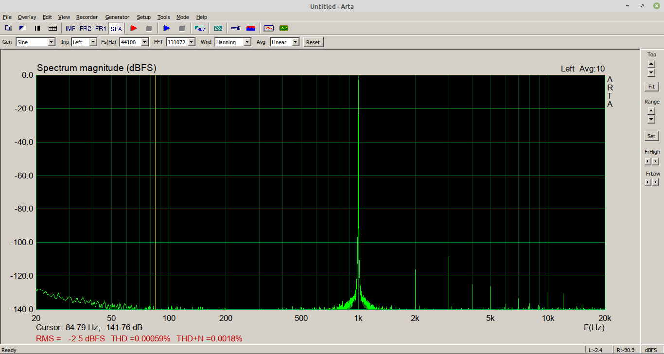

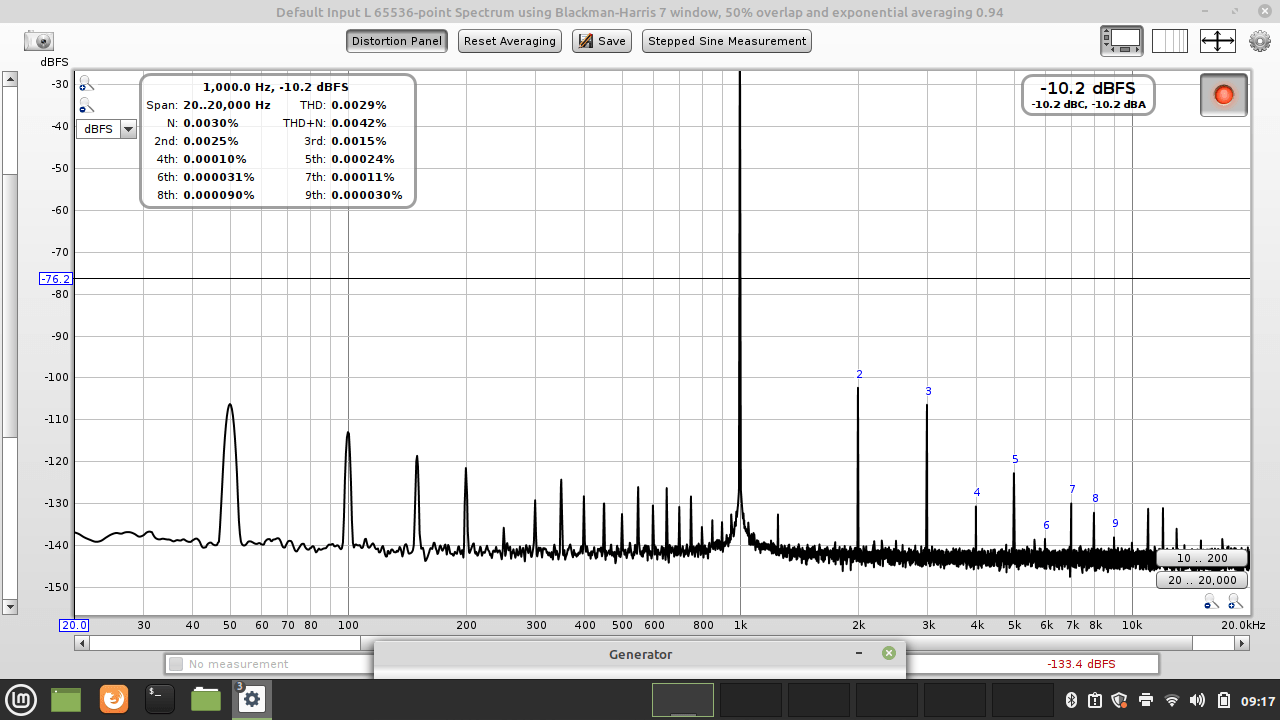

It appears to be the superposition of all signals causing a much higher peak-peak signal to occur than one would expect from just the peak magnitude of one of the tones. That then causes background clipping and hence a rise in the apparent signal floor. REW identifies when signal is clipping at digital full scale, but it is likely the level needs to back off a fair bit more for the floor level to go right down to where you expect it to be. The scope can be used to see the amplitude fluctuation.
Hi again here guy's 🙂

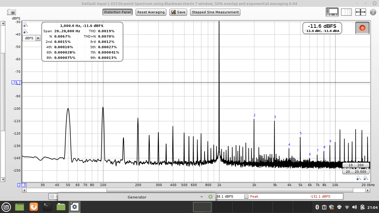

So i figured out, that the best performance doing loopback is with line-in level at "zero" and line-out at around 2 O'clock (100mV).
Plugs are still singleended (will try balanced later) for all 3. measurements here.
While i was at it i loaded my DCG-3 preamp(50K potmeter) with 10K on the output RCA's, and took some measurements at unitygain (E.g. 0.5Vrms input / 0.5Vrms output. inputlevel starts indicating clipping at around 0.750Vrms btw...)
It look's like they perform equal, which is good.
Laptop batterypowered, but measurements is taking on my lap., which i guess is noisy (50Hz Denmark)
Jesper.

Well done, this is what we were looking for. My loopback sweetspot using EMU-Tracker pre is around 0.002% THD+N corresponding to a SINAD of 94dB.Hi again here guy's 🙂

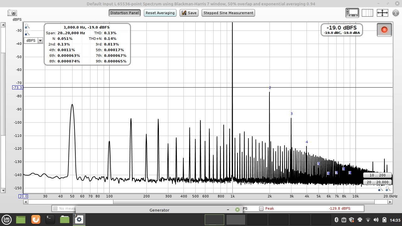

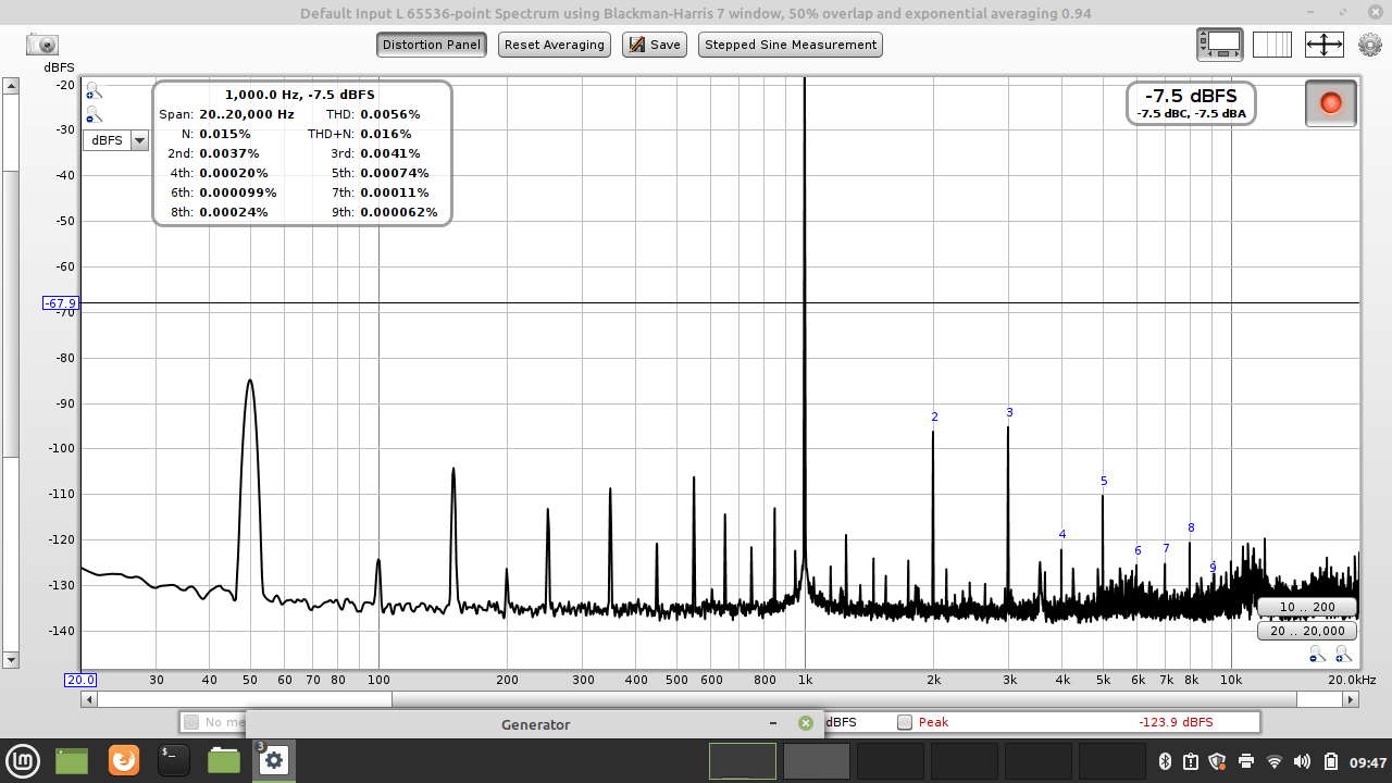

I did take measurements on my AlephMimi (Scaled down Aleph J), my GainClone and the 300B tupeamp i build 2019.
I post here the 3 left channel measurements.
All of them have the 50, 150, 200 etc... Hz spikes, but it looks as the 300B giving the most silent setup that is.
Also it looks like the 300B's giving the most 2.harmonic (what i also expected)
I must say through that either the Aleph & the 300B are giving any speakerHUM, even at highvolume and ear close to my +91dB speakers.
I also don't know if i will have the same 50Hz noise at livingroom? - The 50Hz is also down -70dB ---> -90dB on all 3 amp.'s
Jesper.

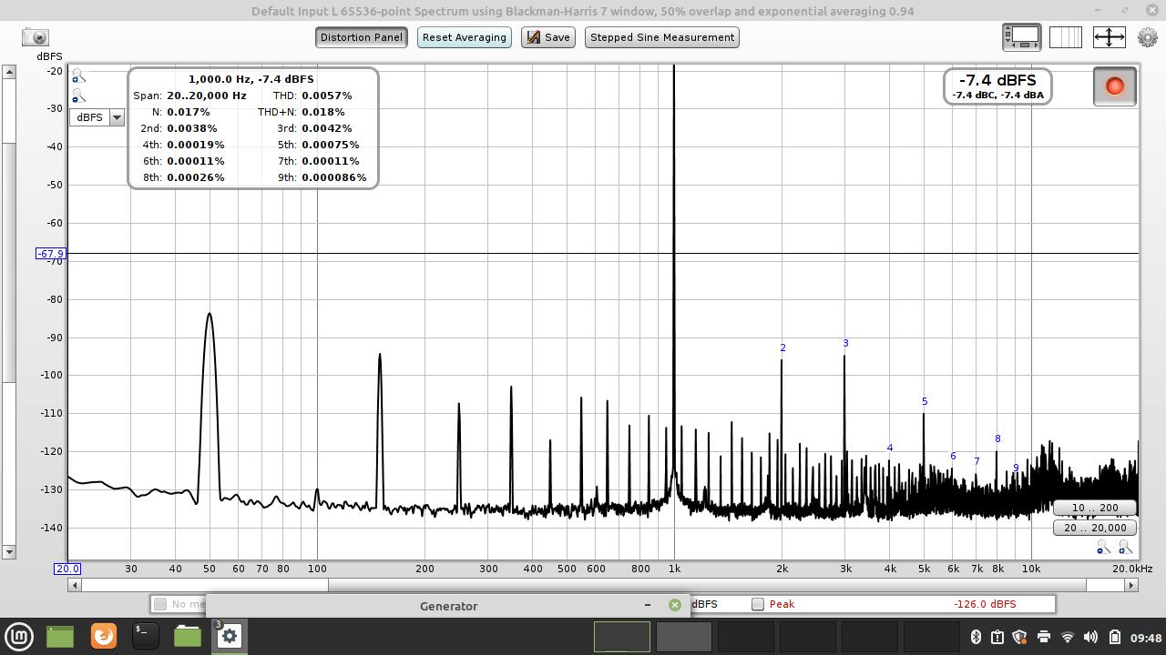

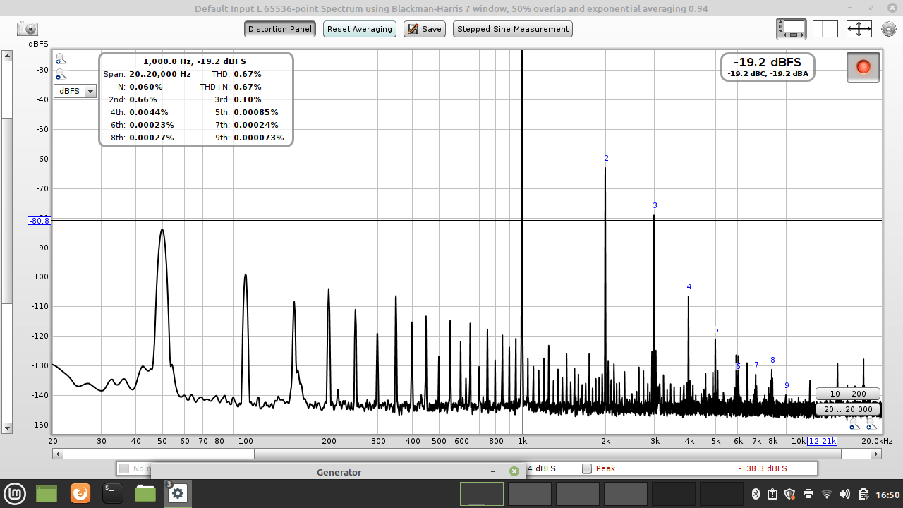

I tried every possible connection, and figured out that the input & output can be used as balanced.
Nomatter what i try, making this loopback connection allways comes up with the big 50Hz bump.
I have a feeling that it's the USB supply from my laptop.
I don't have a nice clean 5vdc supply right here, if i had i would try splitting the USB cable, making the data+ / data- and GND go through and supply a clean supply on the vcc connection on the cable going into the Behringer.
Jesper.

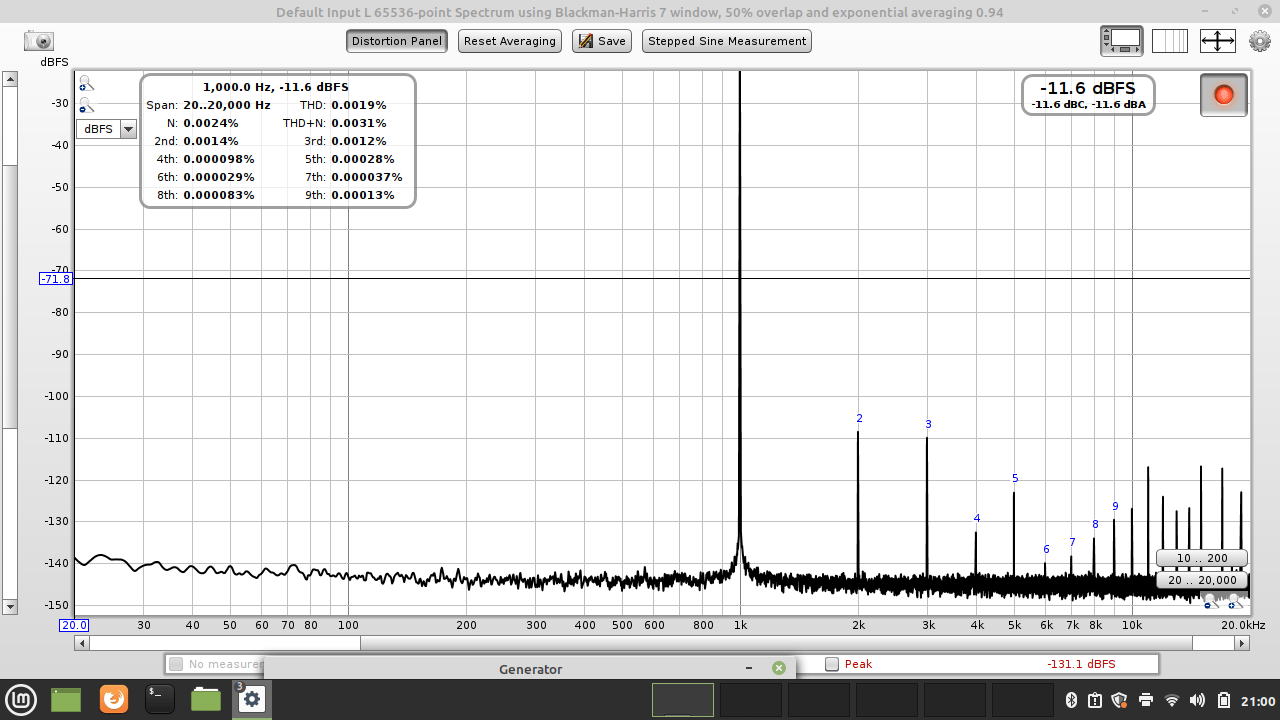

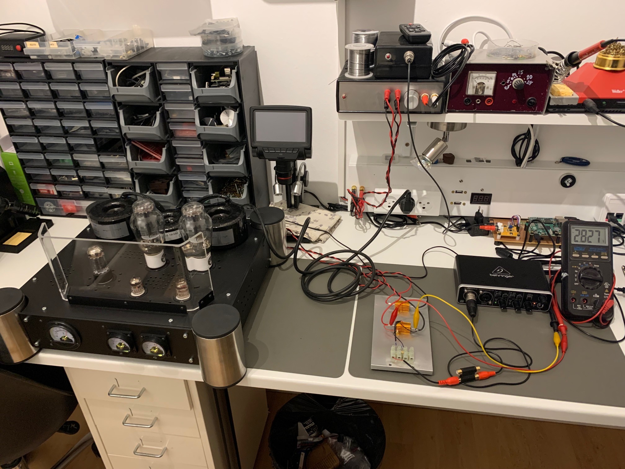

lesson learned today.
The problem i had with the 50Hz and 2x, 3x, etc... spikes was actually it was placed on my lab-desk 🙄
I took two new loopback test's showing how much a few meters away from noisy enviroment gives!
It's really something, you can actually hold the Behringer onto the walls and find the wires inside the wall.
So next time i will measure my amp's, it's going to be far away from wires and plugs... 😊
Jesper.

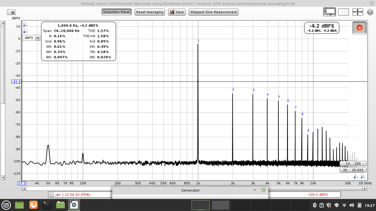

Your first hum spectra showed a fundamental of 50Hz. 5V supplies and noisy wall-warts produce rectified ac with a fundamental of 100Hz with harmonics at 200Hz, 300Hz etc - but not at 150Hz. For that reason I would suspect air pickup along some coupling capacity from your wiring inside the tube amps - or even the wiring inside your soundcard - as you discovered meanwhile. Are you sure your interconnects are shielded?
