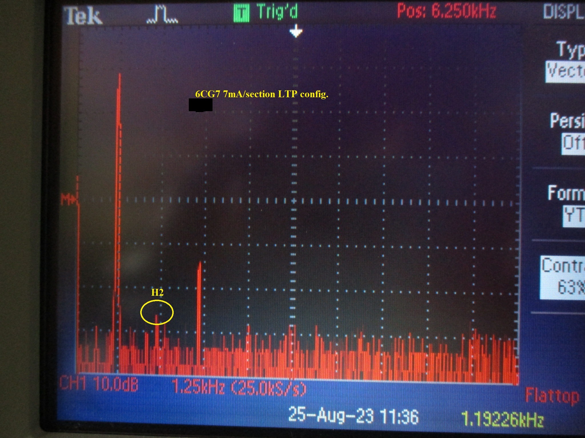

Wouldn't ac balance issues show up in THD (namely 2nd) measurements? Or use the trim pot to minimize THD ala PMillett?
The trim pot is okay with the one out of three tube variations. Yes, H2 would null out using top notch matched sections, i.e 6CG7#6SN7 as front end with 22K anode loads #350V B+ and common cath anchored by neg -15V LTP (7mA each section), provided the following spectrum below. Same spectrum up to clipping.
Note with near perfect section matching H2 has dropped to insignifigance. I can thoroughly recommend this as a starting point. For those without digital FFT scope access, a clue to the degree of matching between sections is to monitor the common cathode with a scope, when one should see a diminitive amount of H2 with best balance.
When this is feeding a highish gain power diff driver also with LTP in common cath to force balance with cathode to grid feedback, one can expect a superlative performance. Finally, a power stage finalized with modest amounts of global NFB will deal with H3. The rest should sound good.
Simple ain´t it.
Bench Baron

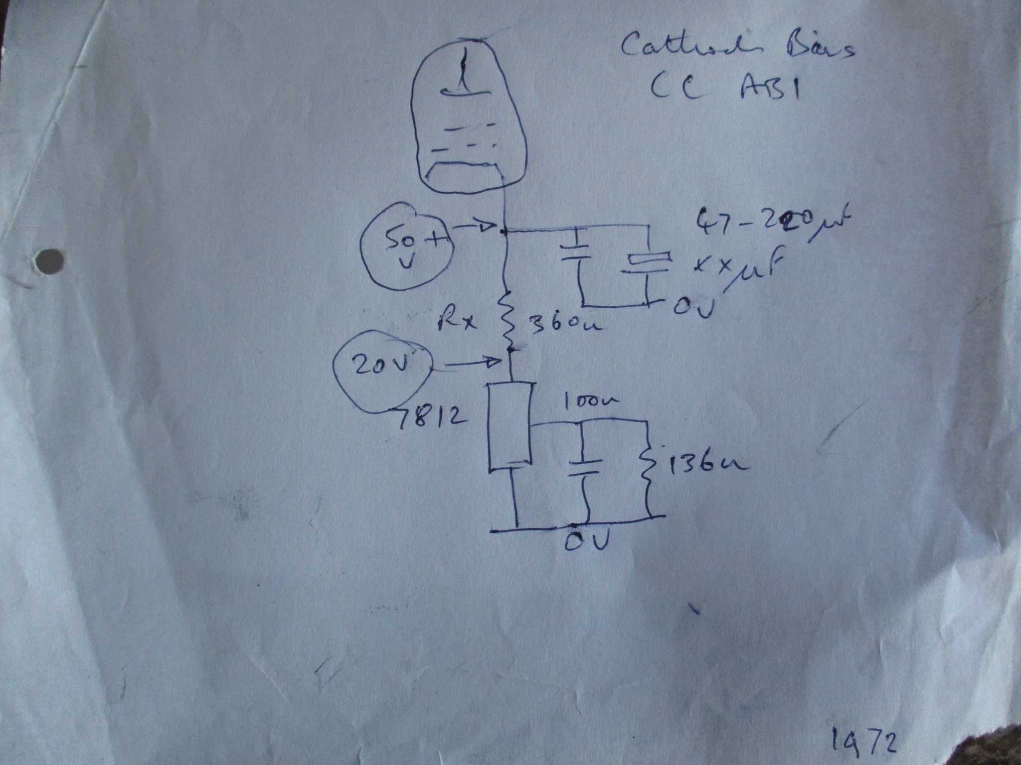

What about "hybrid bias"? Cathode resistor + cap and negative bias, enough to have some of the benefits of self bias, but reducing heat dissipation?
Taa, ...........Deep in my old notes I might re-visit this config again. Could be a candidate-
As 6A3 mentions Loose some power. Sacrifice 50V so Power output would drop to 100W (parallel pairs) with 500V B+. How awkward, as I am currently using 500V electrolytics with a B+ of 450V to give 120W. (I hate doubling up electolytics, it wastes space just to get headroom voltage conform).
