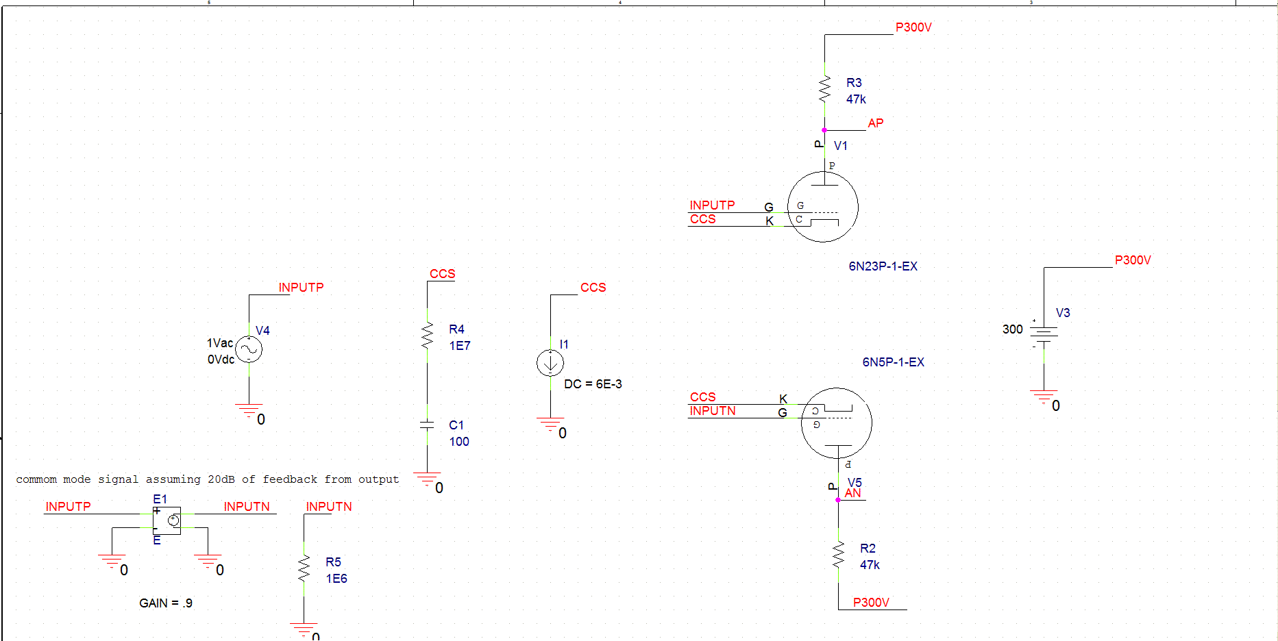

This is a very interesting discussion. I admit it makes my head hurt a bit.
Instinctively I feel that the match between the two triodes must make a difference in the output signal balance.
But spice says my instincts are wrong.
With a perfect current source even with grossly mismatched tubes spice says the output stays in perfect balance at lower frequencies.
Balance starts to decline at 10Khz as stray capacitance affects that so important current source.
Again with a perfect current source, with grossly mismatched tubes and a large common mode signal on the input grids the output still stays in perfect balance at lower frequencies.
My brain is objecting but spice is telling me I am just wrong, balance is still maintained.
Lower the quality of the current source to for example 1Meg ohms and the balance starts to degrade quickly with mismatched tubes.
So my take is...
1) The quality of the current source in the cathode circuit is where it's at.
-Given a CCS impedance of 10meg ohm or more the tube balance does not seem to matter in a meaningful way.
-With a CCS below 1 meg tube match begins to seem worthwhile.
2) Stray cathode capacitance
-The stray cathode capacitance becomes a key issue in maintaining balance at high frequencies in the presence of tube imbalance.
Keeping this as low as possible is important to a wide bandwidth amplifier's high frequency balance with tube mismatch.
3) Common mode input signal.
With a perfect CCS common mode input signals seems to have no effect on output balance even with grossly mismatched tubes.
However the quality of the CCS becomes very important in the presence of a common mode signal with mismatched tubes.
So the quality of the CCS seems the key.
Given a sufficiently high AC impedance across a wide enough bandwidth on the CCS with matched plate load impedance little else seems to matter in maintaining LTP balance.
My head is still objecting but that is part of the learning process.
My thank you to everyone for the opportunity to discard some dogma.
