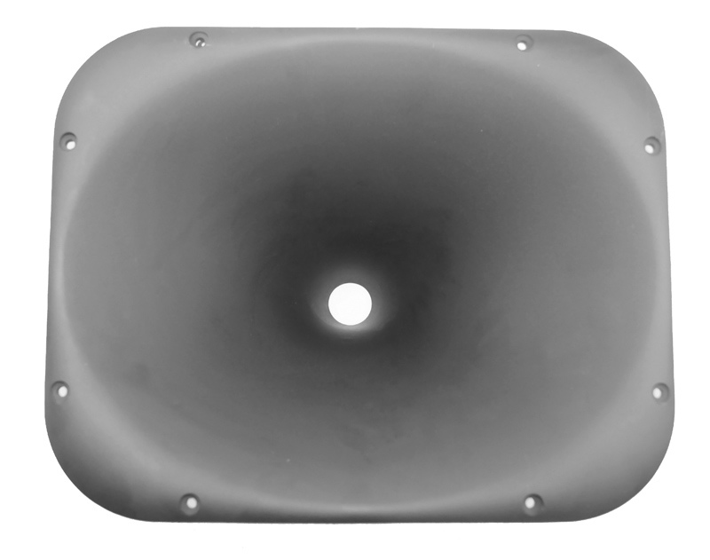

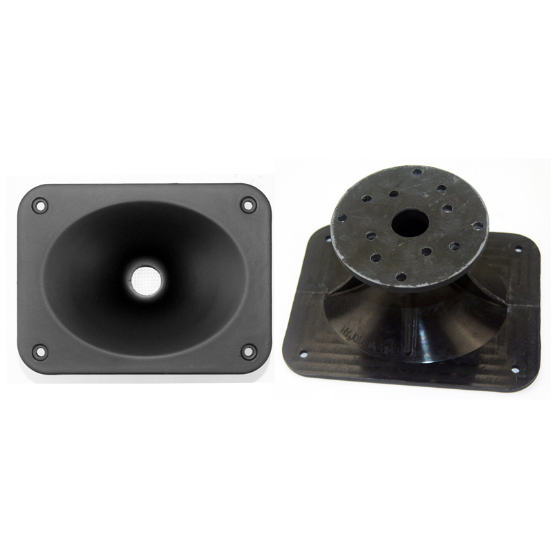

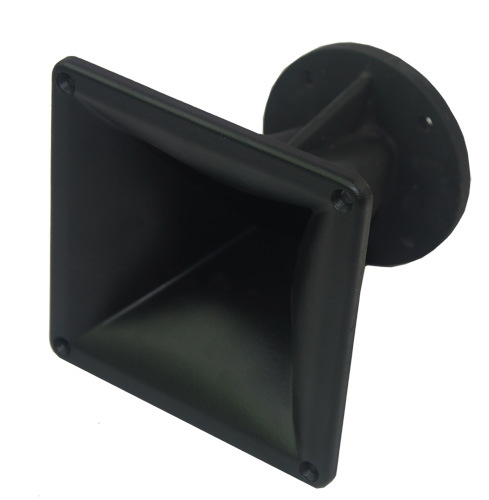

Tiny and cheap, about 3 bucks each.
It's rather deep (130Lx130Wx120D) and though not visible on this image, it's completely smooth towards the throat.
And another take on the biradials.
Not sure about the quality of the throat area.
If it is so important you can sand it.

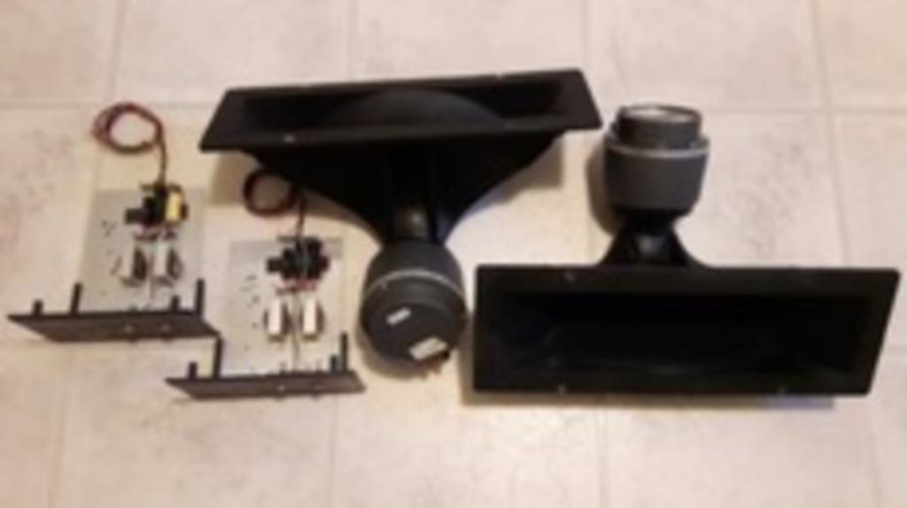

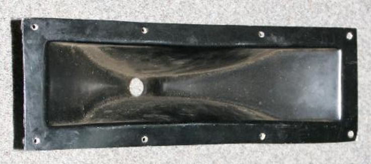

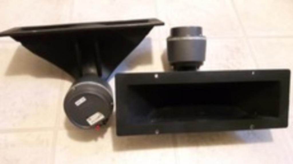

That's an ancient diffraction slotted EV/JBL derived design, full of HOM's.
In general (read the works of Dr. Geddes): you don't want to use such a horn in your room.
This is an interpretation of the classic Manta Ray horn with a smoother throat/diffraction slot, which is likely to produce (somewhat) less HOMs.

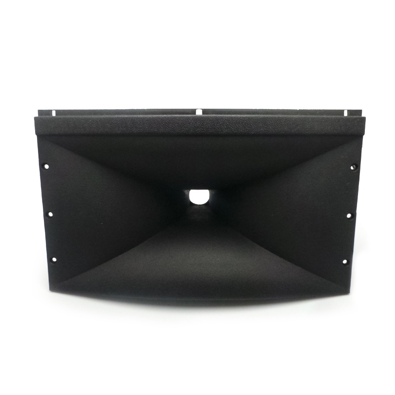

Which model is it ?
Do you have the datasheet?
How about something like this? The fiberglass clones are easily obtainable in Europe, which allow for some tweaks of the throat area. This WE/Altec-32b derivative is 120x100 degrees -6dB and has a cutoff frequency of 500Hz. In real life you'll want to XO closer to 1000Hz.
It's this one
The one I showed is from the manufacturer.

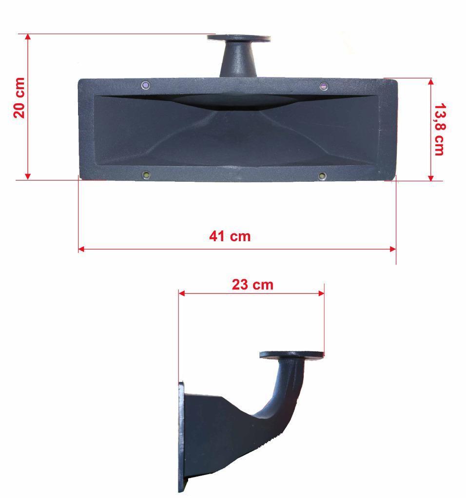

Too long, the maximum overall deepness should not exceed 240mm and i need a wide horizontal dispersion (more than 60°) for a near field listening.
Edit : the XT1464 is also too long.

The original WE/Altec was indeed angled, with a bent throat, but the engineers at Western Electric Laboratories already knew a thing or two about pressure acoustics, so they made the bend with a gradual curvature. There are no further discontinuities in the horn path. According to many people, who have owned or listend to these horns, they are quite decent (which might be an understatement). These horns are highly sought after and often change hands for ridiculous amounts of money.

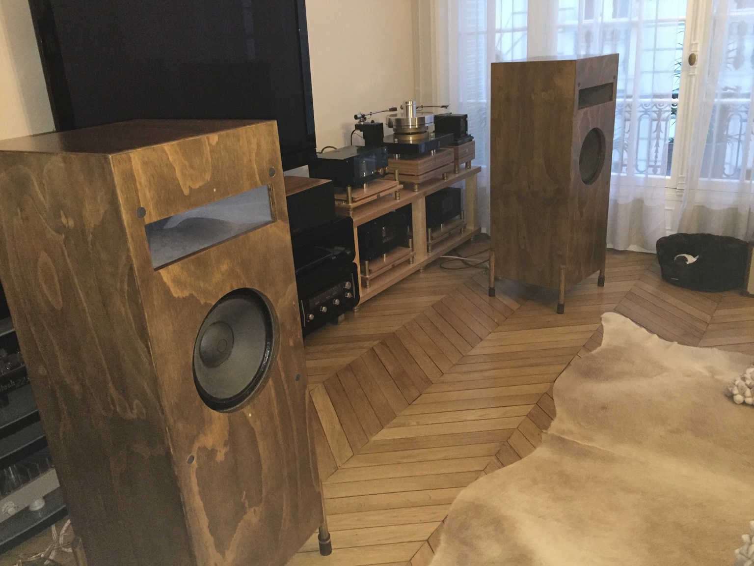

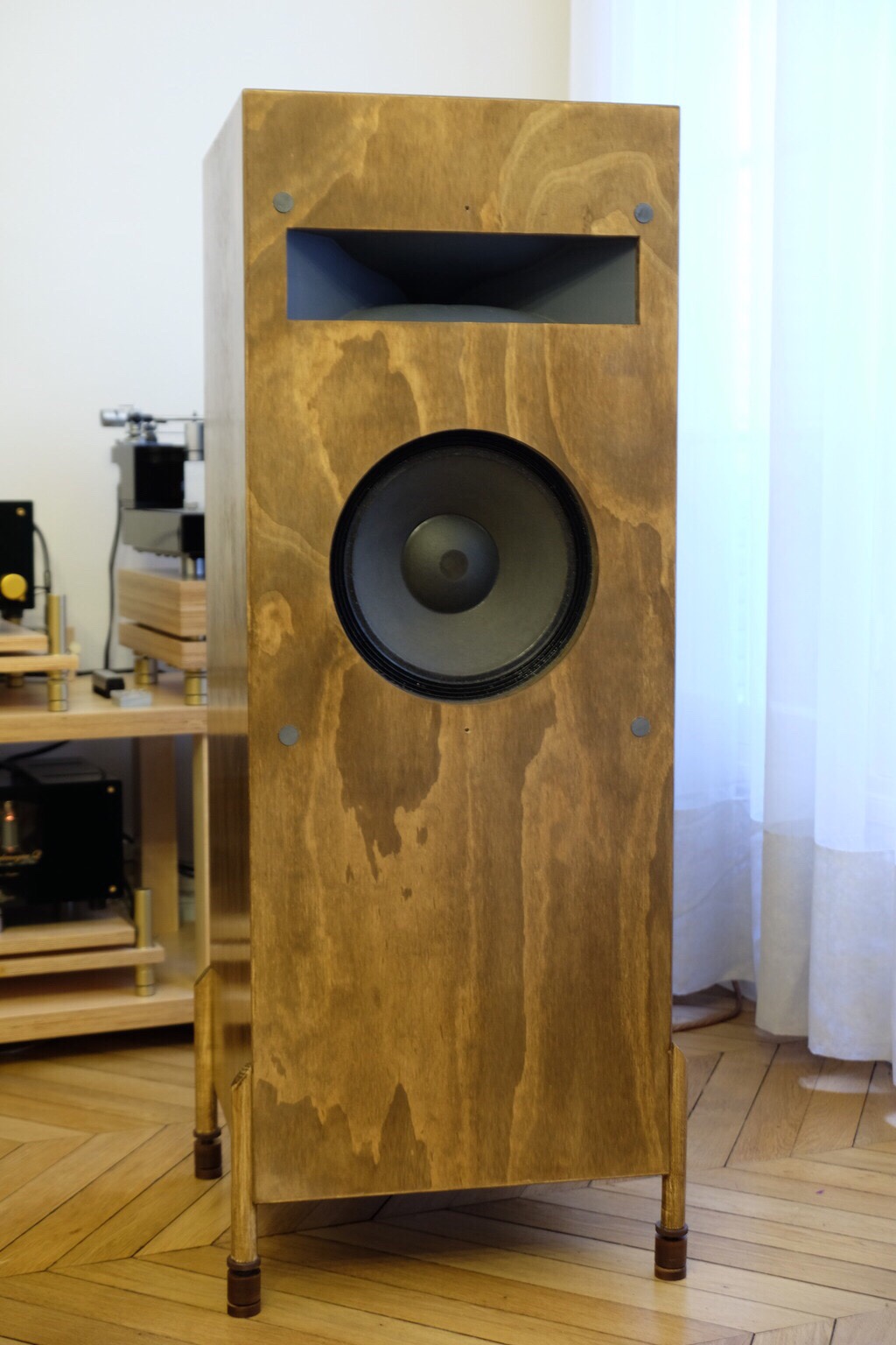

I was tempted to make a bid on a pair that was recently for sale in my tiny country for only €500 including Altec 808-8b drivers, but they were gone within the blink of an eye. I included an image of the items and a nice project based on these horns and Altec drivers from a French artisan who built a clone of the Shindo Petite Latour for about €6000 instead of the $34.000 of the original. According to the owner, they beat his Harbeths M40.1 by quite a margin.

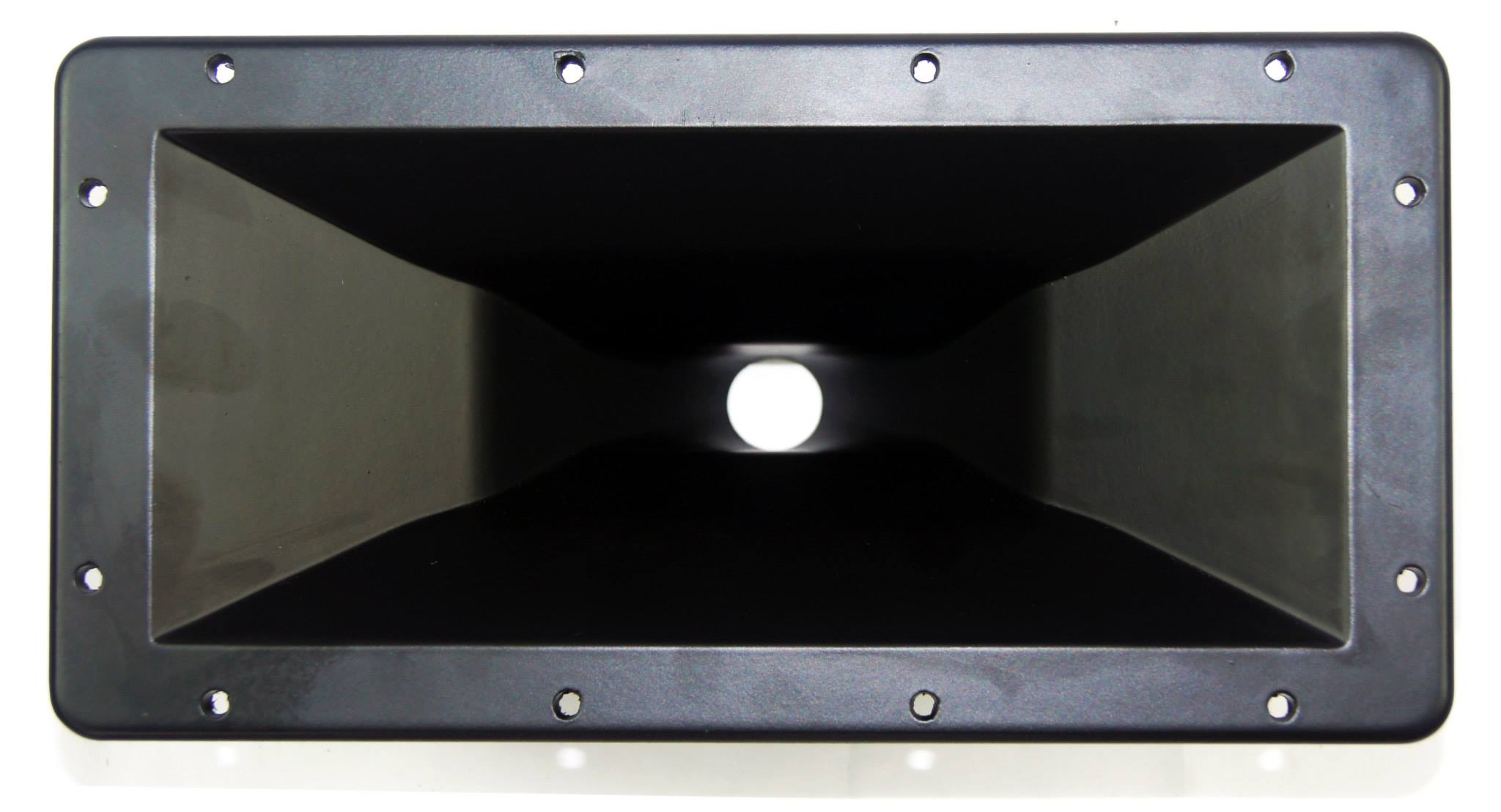

Something like this looks like a pretty good alternative, short and looks like a simple shape (no sharp angles / low HOM?). I like the flat front, which means one could possibly rear mount it + chamfer the baffle to get a smoother mouth edge, (and have less black plastic on view).
Seven dollars.
