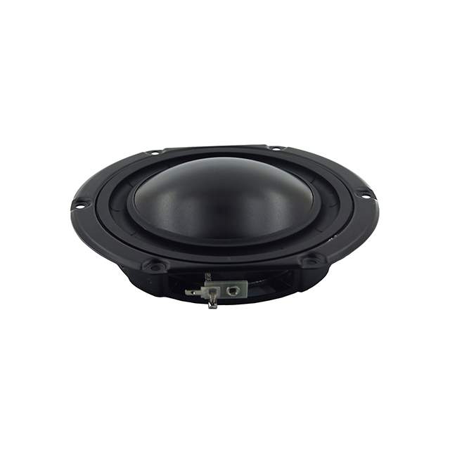

The last picture in post 4 looks like a flat-walled conical horn (like a Synergy) that has 4 spherical caps stuck onto it.
...so, what if you did exactly that?
Start with a flat-walled conical horn, but instead of directly cloning the Synergy (mids that fire through a port), you mounted some appropriately shaped midwoofers into the walls.
Would the HF off the tweeter "see" the surface of the woofers as solid?
Pic is of a Tymphany GBS woofer.
