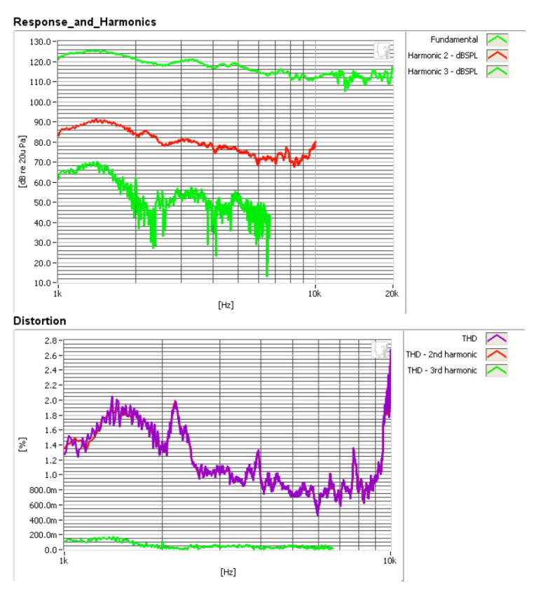

Test Bench: Eighteen Sound ND3ST 1.4” Compression Driver

You mean these plots? :
Very good, but not unusual I would think.
Did you notice distortion skyrocketing towards 1K?
They seem unusually low compared to another 1.4" (B&C) that is presumably measured the same way. The 18 Sound is around 0.25% THD above 1kHz whereas the B&C is 1-2%

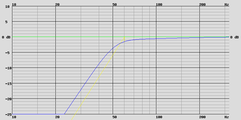

PS : the Gedlee designs are not able to maintain a good efficiency at 100Hz, i still don't understand
I don't understand this comment either. A NS-15 has incredible efficiency at 100 Hz - something like 96 dB. I let them roll off naturally below about 70 Hz because that blends better with multiple subs. They could be ported and go down to 40 Hz or so, but I would never suggest that as it is just not the right thing to do.

Still, I wonder how you manage to get 96dB from this driver in a tuned cabinet. Are these drivers built to your specs?
I might be missing something here, but according to the B&C website the above response curve represents a 97dB 15" woofer (the 15NBX100).

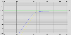

Ok, I did a quick and dirty sim and got: VB = 72.1 L, FB = 48.0 Hz, 0 dB corresponds to 96.1 dB/2.83V/m.
No doubts here anymore about 96dB 😉

This design argument is valid with passive crossovers, in an active configuration with a very steep crossover slope the cone breakups seems not as problematic, will you recommend the same unit with an active filter ?
