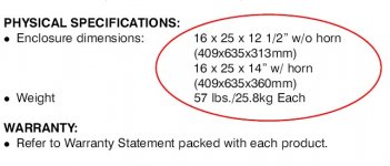

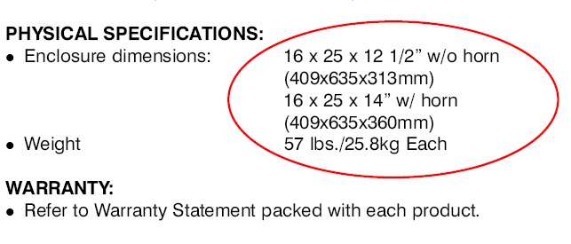

Besides, I also happened to find some discrepancies in the 4425 MKII tech manual (below) in which, only 25", of all dimensions, seems to be correct. It is, thus, very probable that the 4425mkII data is fictitious.

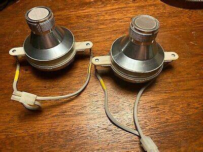

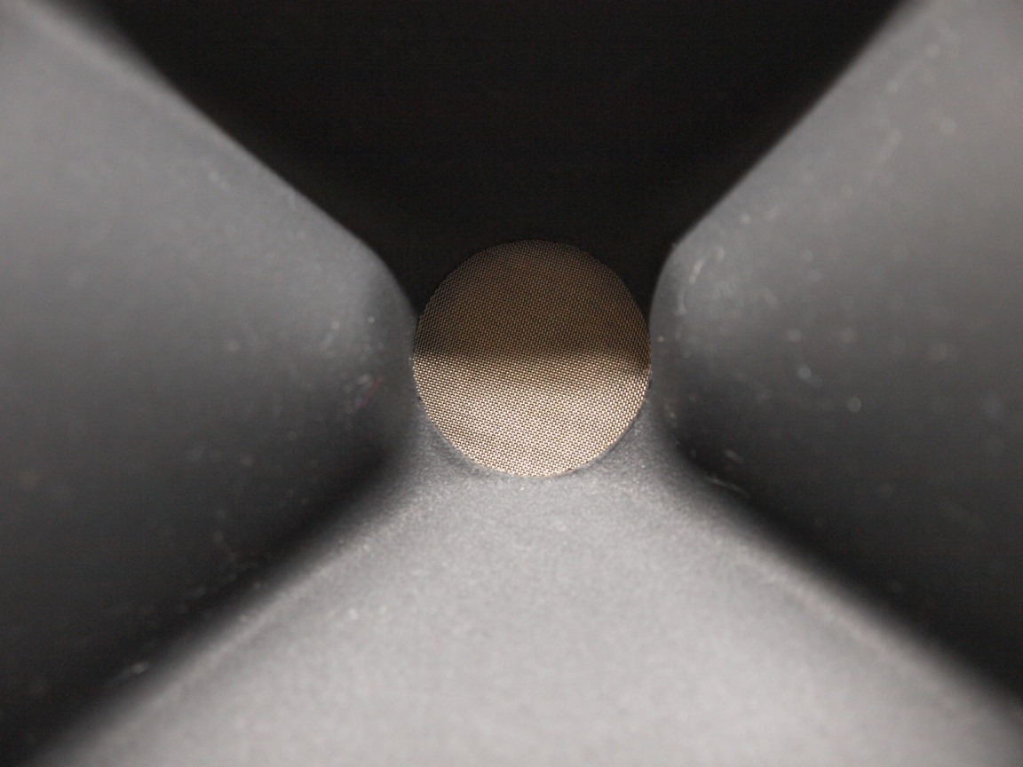

Though the diffraction horn seems to have good coverage, I strongly believe that people these days are more interested in ones without a slot, and thus the mention of the 4425 MKII horn / waveguide. It is quite unfortunate that there's no data on this part, as opposed to the diffraction-based models.
However, from the dimensions (in mm, not inches) in the technical datasheet (post #281) and photographs of the horn, baffle and driver, my best guesses are the following:
1) The 4425 MKII baffle is 3/4" thick.
2) The "ears" seem to be project about 2 inches (47mm) out.
3) The driver (175Nd) seems to have a 2" pipe built into it, giving a minimum effective depth of 4.75" from the diaphragm.
4) The crossover frequency is 1.1kHz, that matches (more or less) the above.
5) The polars in the 4425 MKII user manual (post #275) seem to be too similar to those of 2344 and may therefore be unreliable.
