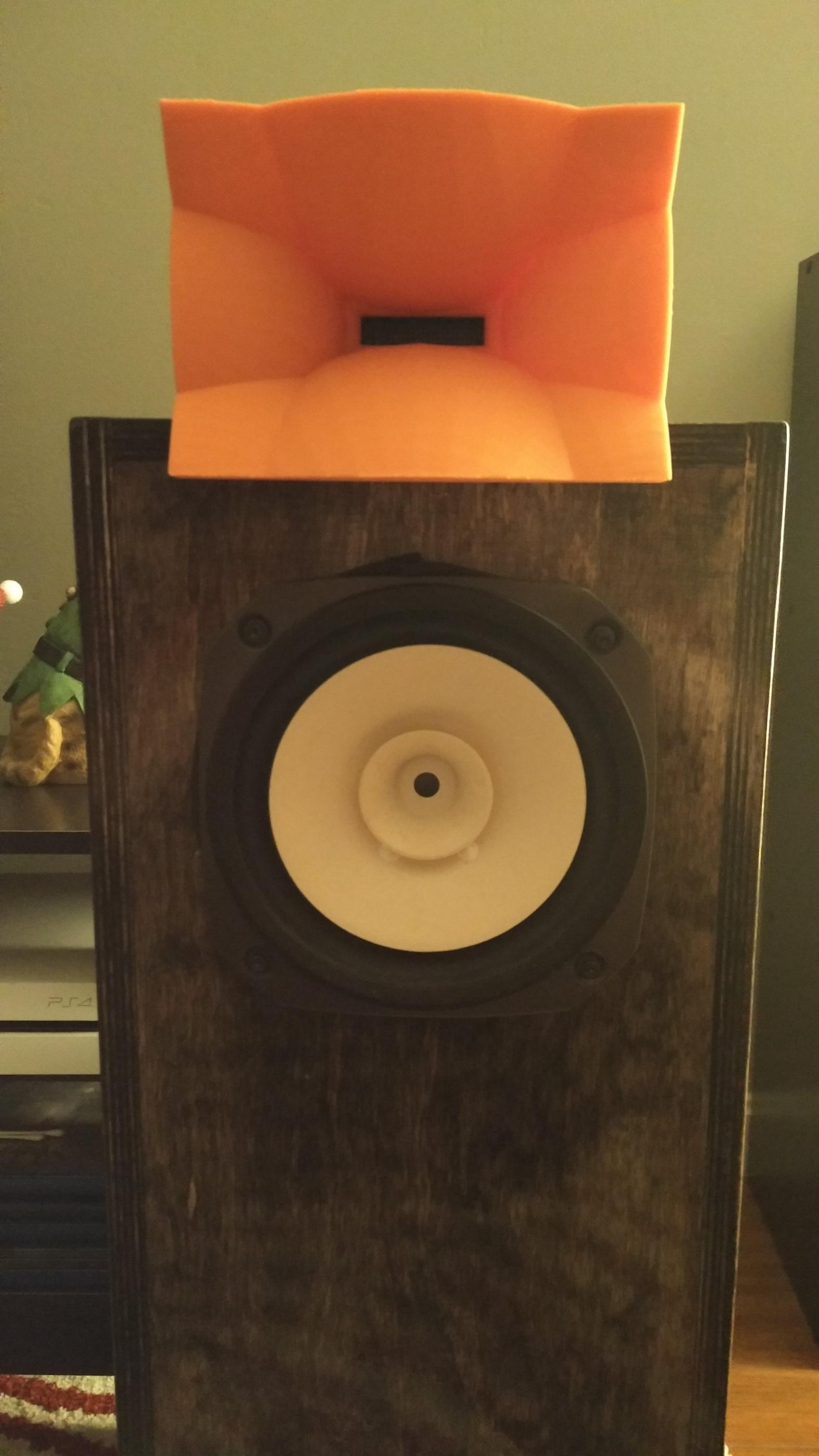

Is that 3D printed? And an AMT/ribbon in there?
Yep, each horn took about 17 hours to print in PLA with a 25% grid infill and 3 0.45mm perimeters to make it plenty sturdy. The transducer is a ribbon from a Fountek NeoCD3.5H. I replaced the stock CD horn with the printed one for a little experiment, works surprisingly well. It's currently used very high up (~15k first-order) and fills in the upper treble where the Fostex driver wanes in response, so the next order of business will be a full 2.9kHz two-way third-order Bessel crossover to see how the horn behaves with the current loading.

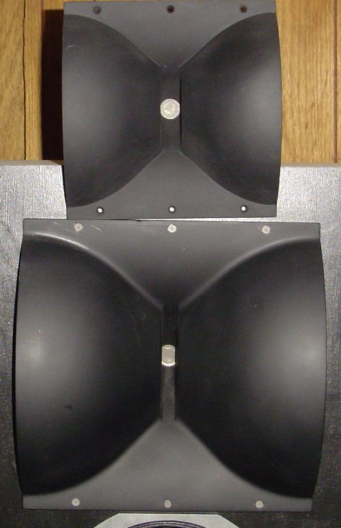

You could leave it at this, and have something similar to the older biradials:
That is a 4425 MKII that was built exclusively for the asian markets. The absence of a hard diffraction slot in a JBL model seems to be both surprising and attractive. From the numerous youtube videos on this model, its off-axis performance appears to be fairly good.

Patrick Bateman, what kind of polar performance can be expected from the blue slotless bi-radial horn shown in the post#3? It would be nice if it could rival the JBL MKII. I ask this mainly because this kind of horn appears to be reasonably easier to build, when compared to many others.
