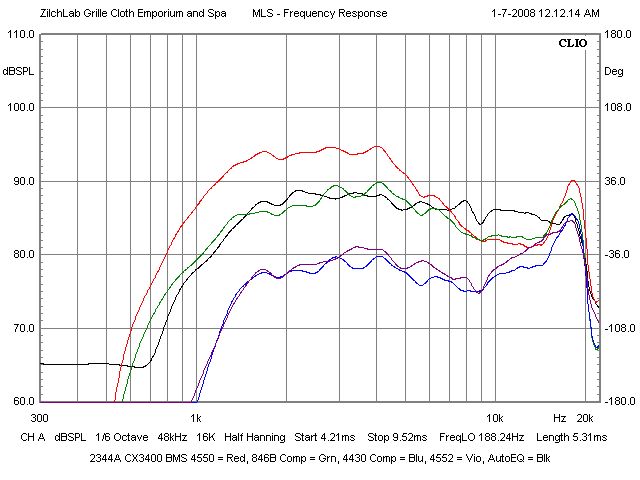

As Marco said, it's the 2344 that's the problem ( as far as having linear response goes ) / though the ( BMS ) 4550 does fare better in its mid-band response ( as far as diffractive suck-outs go ).
Here's an ancient trace ( from Zilch ) that shows what a challenge the 4550/2344 combo would be ( to design for ) .
Of course, one can actively EQ almost anything flat / but creating a workable passive network to fix what's seen in the red trace below would test the best network designer.

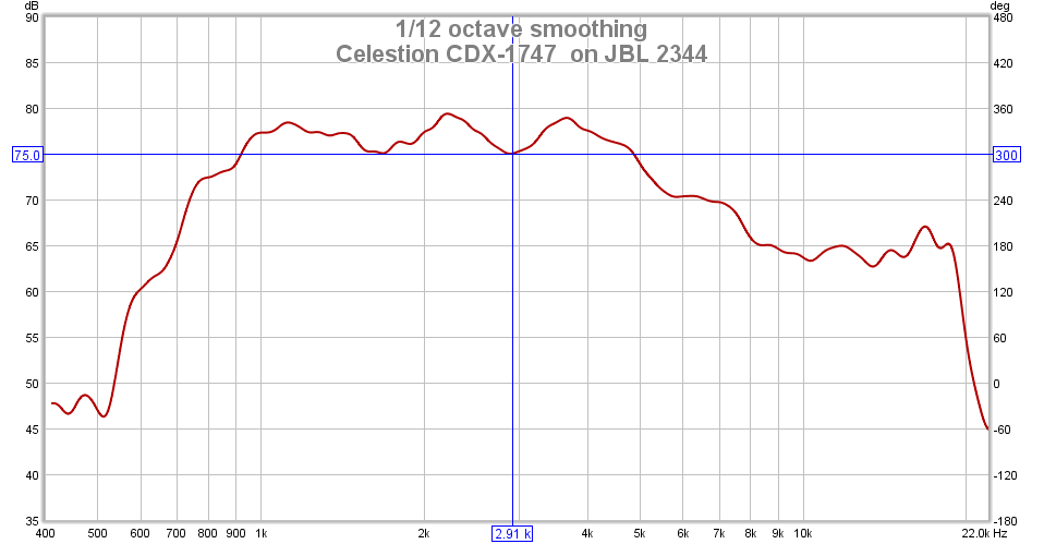

The following Celestion driver doesn't fare much better ( IMO ).
Mind-you, I suppose those ( above ) are still better ( 1-5K wise ) than the raw response of this 2425 on the 2344.
With the compensation filter in place, response will eventually look like this;
The above trace ( intriguing to me at least ) is flat enough to support the love-in going on ( over at AudioKarma ) over the 4435 speaker.

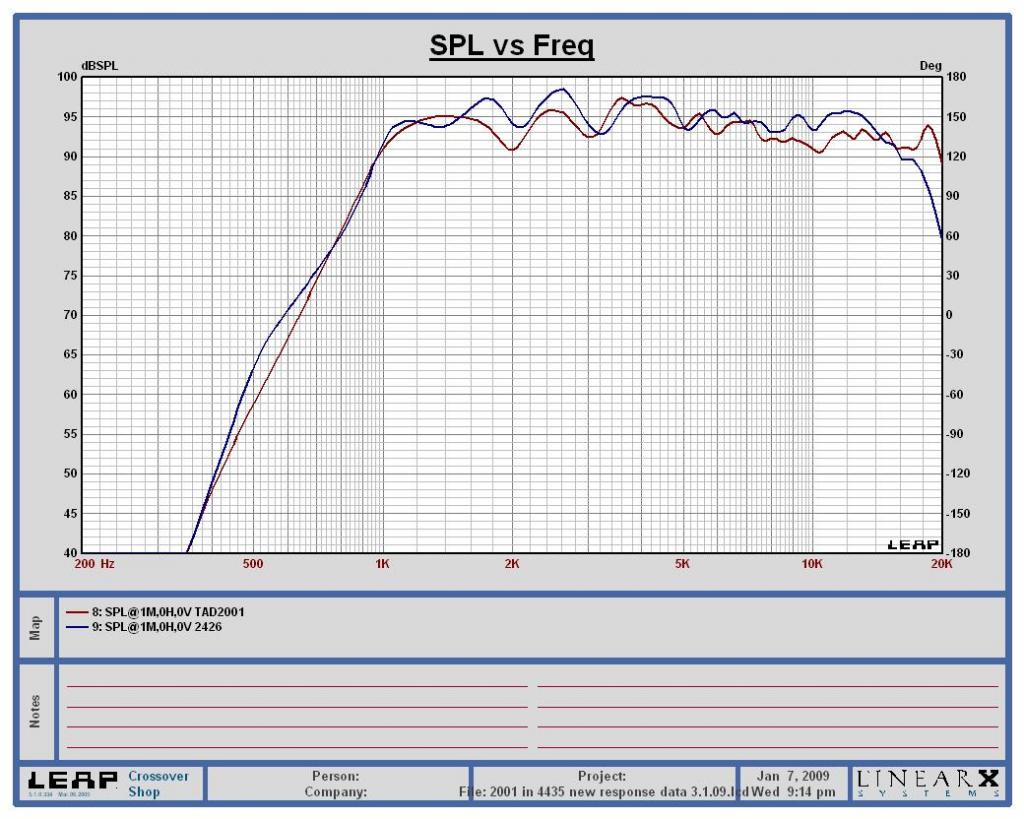

Some new 4435 devotees are really driving quite a renaissance over its capabilities.
The TAD 2001 is not immune to the negative effects ( on FR ) of this horns builtin diffraction problems.

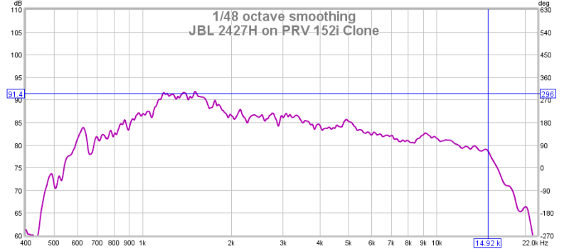

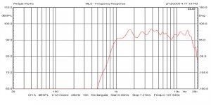

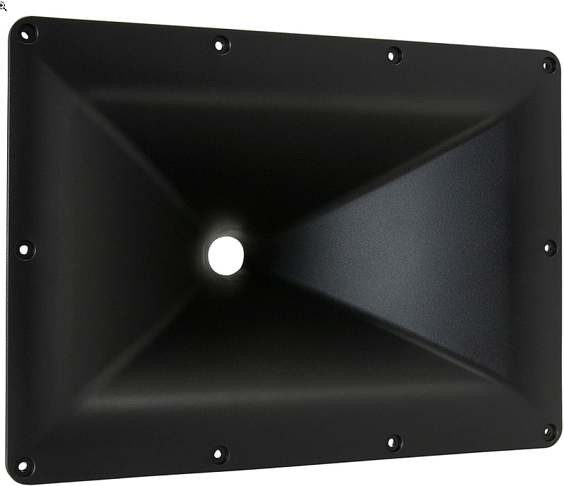

This is a good waveguide ( previously mentioned by Patrick ) .
PRV made a clone for a while.
Both ( the QSC 152i & the PRV clone ) are NLA unfortunately .
I'd seriously consider this w-guide driven by a JBL 2425/6/7h.
Response seen below ( 1/2 meter testing distance ).
This is a well behaved ( raw ) response and is easily compensated for ( within a passive crossover ).
Unfortunately, these wave guides are no longer sold .
Maybe Patricks version will work out for you.
PS; the SEOS 18 would be worth a look at ( they are available over there in Europe ).
