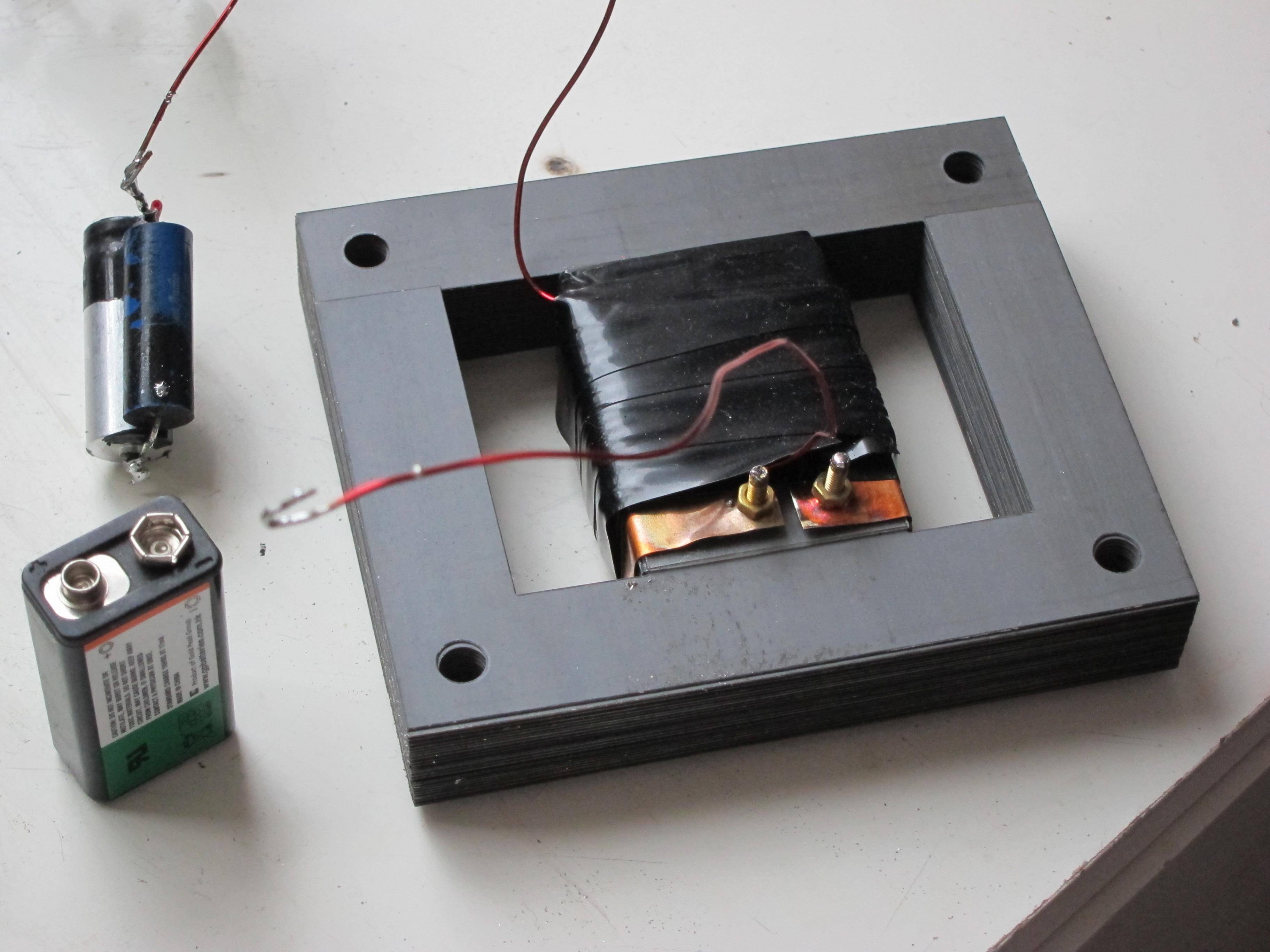

How to make a good transformer for ribbon tweeter?

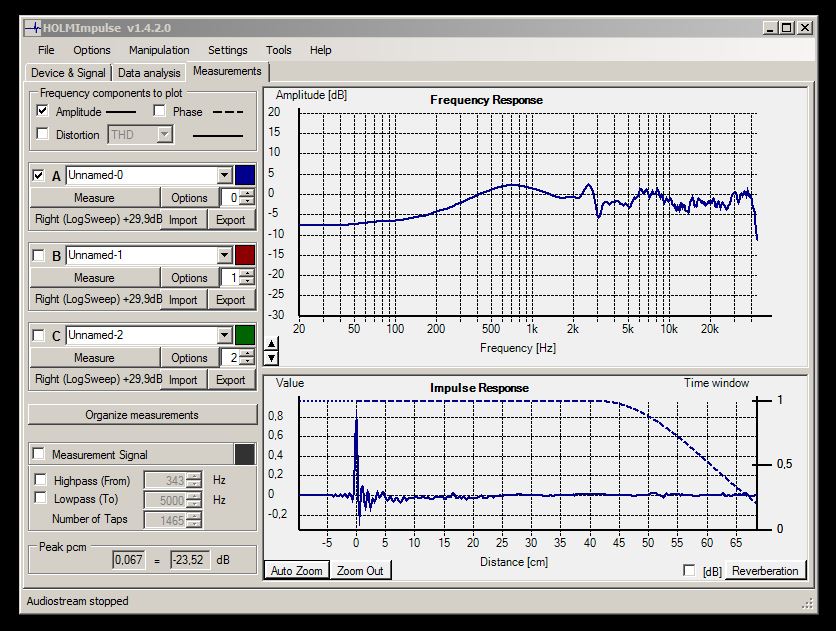

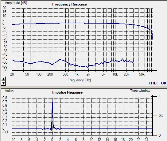

Here's a picture on my trafo, 2 windings foil and 20 windings of prim...
And the resulting freq curve...

In powder cores you'll have lower amount of magnetic material per volume/cross section thus lower Bs. Losses and coercivity are really high. Low permeability means higher primary turns count. With small signal (like tape recorder heads) it does not matter.
To Jonas. Self inductance of strip 2 cm wide and 100 cm long is around 1 uH.
Driving force in speaker is proportional to current.
Time constant of 0.4 Ohm strip resistance and aforementioned inductance is 2.5e-6 thus 63 kHz -3dB.
In regard to your setup with apparently single turn and frequency > 3 kHz leakage inductance will be 100 times lower... and below 1 kHz probably around 10 times.
If you connect to the secondary wire loop equal to the one in real setup the results will be quite different, again, current wise.
Which was exactly my point why make x-former with no parasitic inductance and then connect wires with "huge" inductance. Simple wire going through the winding window will do the same.
Being not so keen on motor and/mechanics of strip can't really deliberate on the second chart
On the other hand you can run one driver with ribbon up and another one with down connected in series thus employing return wire for sound production 🙁 Not sure if it's proper way of doing it.
On the yet another hand 50 cores stacked with single turn secondary and 5 turns primary is indeed silly and expensive solution.
Since the magnets are of oriental origin the cores of the same origin are cheap as well.

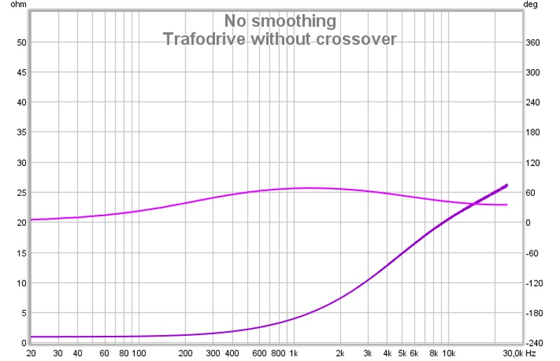

I enclose an impedance graph of trafo driven without crossover and driving a 0.14 ohm resistor. Top curve is phase..

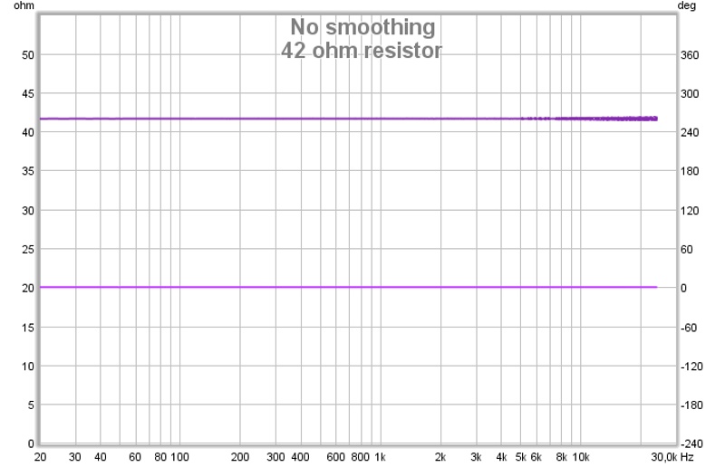

Also a reference graph of a ordinary 42 ohm resistor. Lower curve is phase.

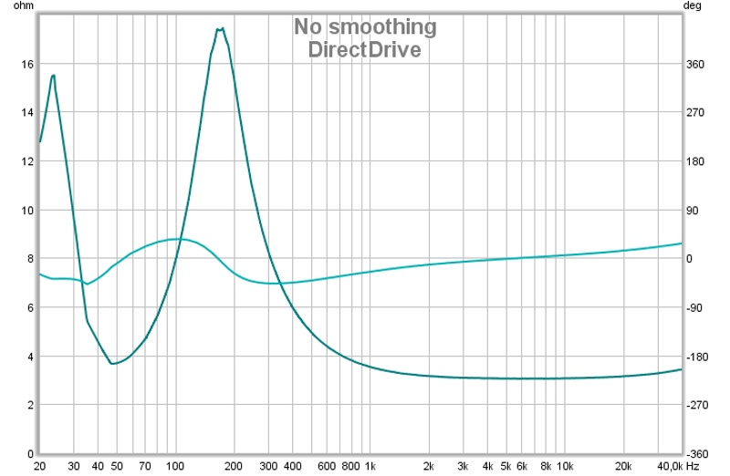

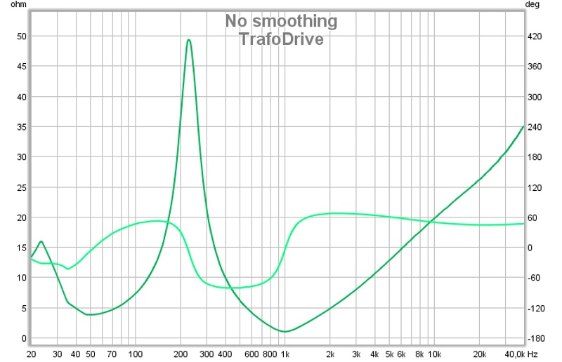

the two pics in post151 Claim to show the difference between using the impedance matching transformer and direct drive.
How come a crossover filter has been added and not declared?
If you read post 151, you can see in the text that the measurements are taken of complete speaker, with bassdriver and then also of course the cross over included...
I just wanted to show the different impedance characteristics of the two drive methods..🙂
