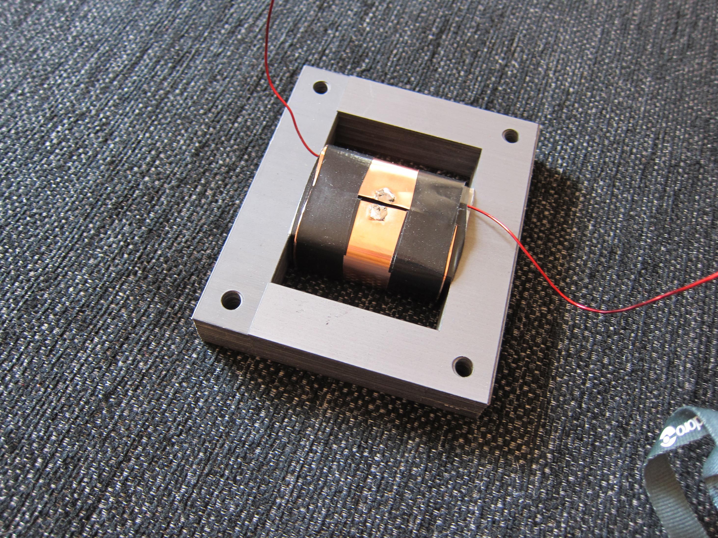

I've done some practical experiments with "one turn" transformers, inspired by alexberg . Very good bandwidth and low distortion. One funny thing happened though. When I measured my speakers with HolmImpulse, all of a sudden, the speaker returned a inverted pulse!
Once every 3:rd or 4:th measurement, the measured impulse was inverted, and you could also see the phenomenon on the phase curves.
Could this phenomenon be a result from when you make a transformer winding with one turn, where the ends of the turn doesn't meet, the one turn winding
cannot be called a clockwise or anti clockwise turn?
Have I invented a new kind of binary random generator?
It might be HolmImpulse pulling my leg, so I shall do some further experiments and measure the signal directly from the transformer...

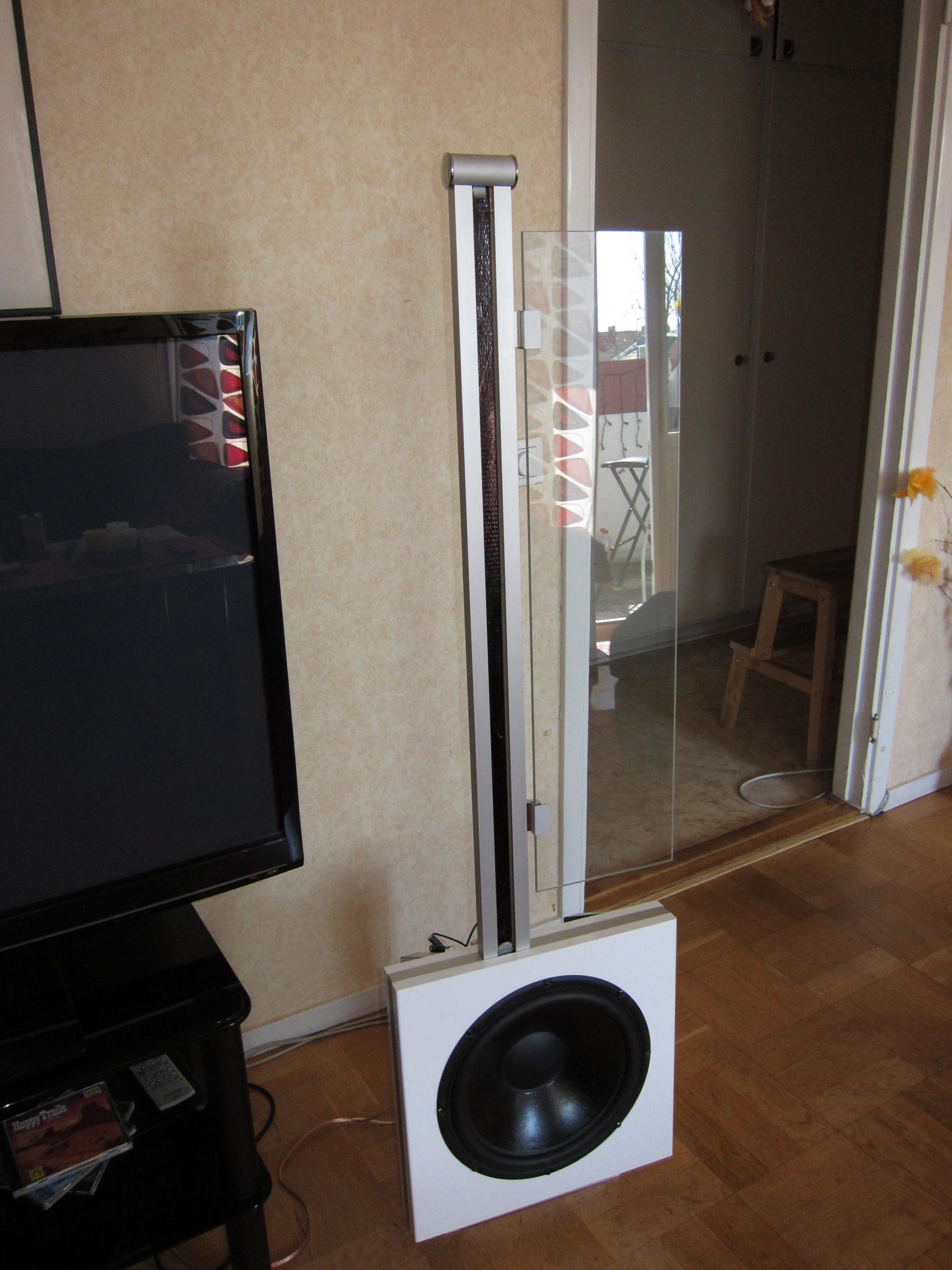

I have problems with my ribbons, see avatar.
When I play loud, there happens something at the ribbon connection points.
The volumes goes down, and the only remedy is to dismount ribbon and polish the connection copper plates.
Maybe I must change the copper for gold?
Maybe the copper near the connection could be tinned or gold plated.
Or, is the connection just getting loose - could it be soldered instead?
Alu. has an oxide layer on it and this layer is highly insulating.
Have you tried scuffing up the Alu, at the connections as well.
As this may be a bit difficult to do depend on the thickness of your material you can also try removing the oxide layer with a weak solution of Sodium Hydroxide at the connection ends.
I have had similar issues before when using Alu window screen for for my ESL stators as well as connections to the diaphragm using Alu. tape.
So now I soak the screens in the solution (Etching) as this guaranties a positive connection to all of the wires in the mesh before I coat them using only a few wires for connections from the woven mesh.
This works good and I use good ole steel wool to scuff up the Alu. tape parts, these connections have now lasted for at least 10 years or so without any issues as tested.
I few of my panels would not even work at all at First try or just worked for a little while and intermittently , until I had removed the oxide layer and that was at very high voltages too!!!
