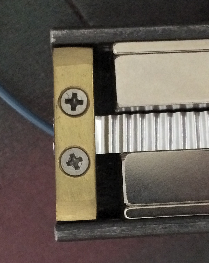

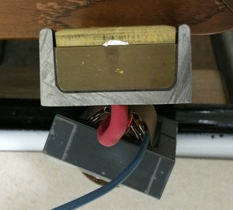

The connections have to be very good. Heavy copper or brass, and surfaces very flat. I used cover part of 1/4 inch thick stock. Screws should be as close to ribbon as possible and tighten carefully so same pressure on each side. Also put a VERY thin coat of silicone oil on the part that goes under it. No more corrosion. Wires for smaller length ribbons have to be large, around # 8. And a good transformer is a must.

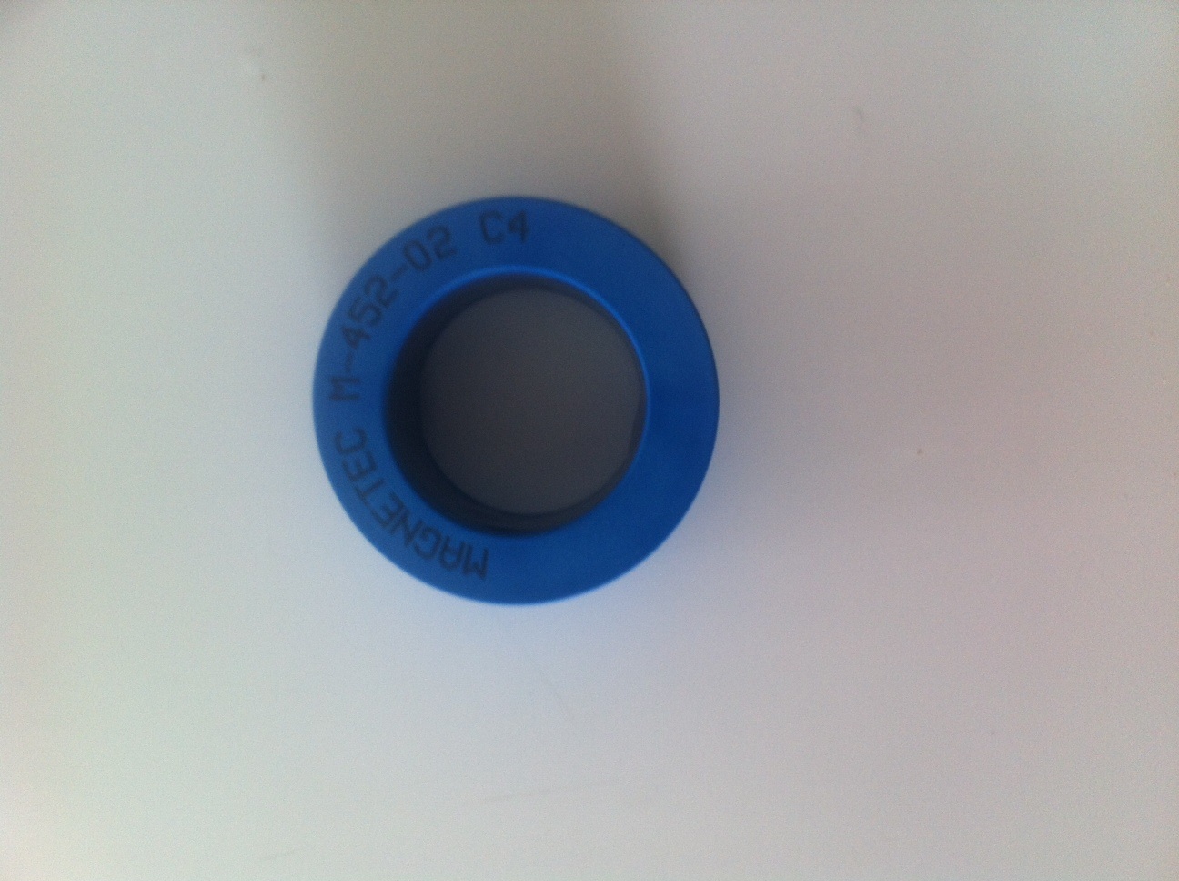

Bought two magnetec cores. they are iron powder in a plastic case.the iron can be heard if the box shaken.Having trouble finding the right data, to the number of winding an approximately 0.4 ohm => 8 ohm crossover 300-500 hz.
Let's see. What you've got is tape wound cores.
If you stack two cores you've got, then
having Fcross=300 Hz it yeilds 11 primary turns. I would not apply more than 4.5 Vrms to the primary.
On the other hand since you want sqrt 8/0.4=4.47 it yeilds 2.5 turns secondary, which is not doable. Then there are two ways.
First round 2.5 to 3 which means 3 turn secondary and 13(14) primary. That would work @ 300 Hz or you could round secondary down to 2 which means 9 turns primary, but the min X-former operating frequency would be 22% higher.
Finally the assumption I've used to calculate was equality of the x-former primary inductive impedance to the one to match i.e. 8 Ohm.
Sure it's the very minimum number of turns you need. So feel free to increase number of turns, keeping transformation ratio (4.47).
I do not know what is the power level you need to transfer to the ribbon.
Knowing that I could tell more.
On the other hand having magnetizing current equal to the load one, even @ crossover frequency is probably not wise.
Anyways I would keep primary (and secondary as well) @ single layer i.e. approx 40 turns primary @ 1 mm magnet wire. The latter would work up to 15 Vrms and about 2 Amp thus giving you 32 W of apparent power, again @ 300 Hz.

Almost forgot: Do not wind too tight. If you apply mechanical stress to the core itself i.e. warping the container you will kill the core. It is not wise to rattle the core as well. Rattling is kinda weird core is usually fixed inside the by a bits of soft silicone or foam.
Look, I do not know how much power you were planning for the ribbon? 5...10....50 watts
Neither I know the sensitivity i.e. dB per W (sound pressure you stated in dB).
Otherwise the core will saturate before you reach the sound pressure level you expected
And yes one core will be fine at 2 times lower voltage i.e. 4 times lower apparent power for the same number of turns and wire dia
