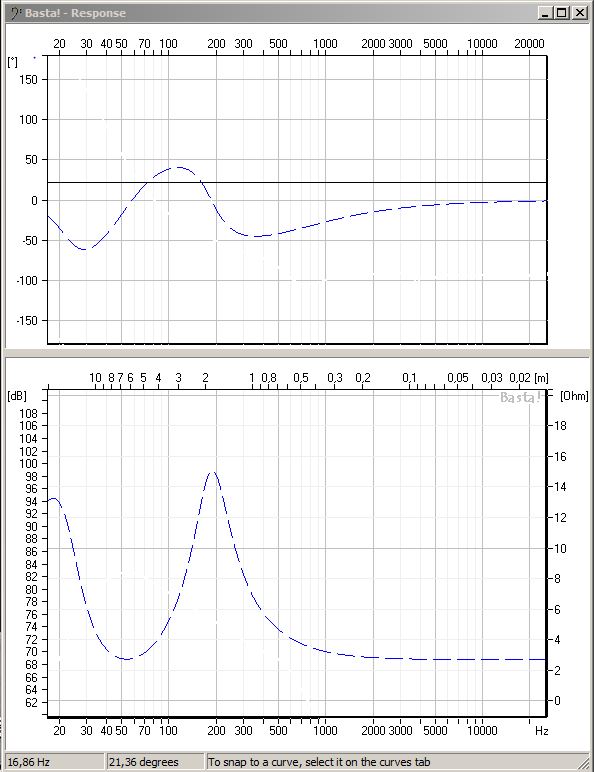

When I simulate the actual circuit in Basta, I get results that pretty much correlate with my impedance measurements.....

which of those two pics has the filter in place?
Is the filter before or after the transformer?
If you read post#151, you can see in the text that the two measurements are taken of complete speaker, with bass driver and then also of course the cross over (filter) included in both post#151 graphs...
Again, I just wanted to show the different impedance characteristics of the two drive methods..
