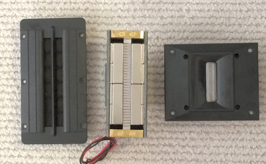

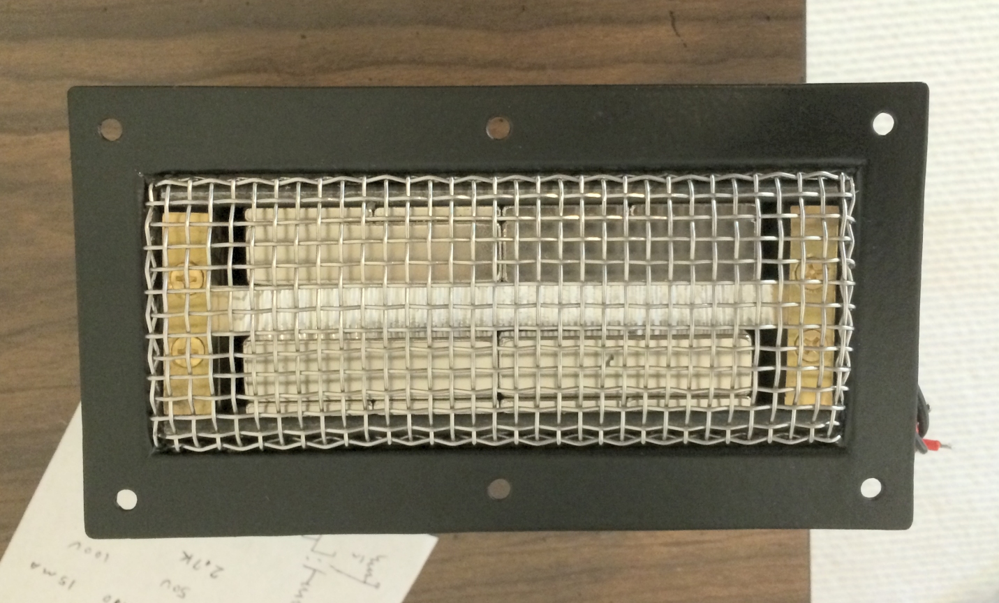

Finally finished tweeters!
I finally finished the 4 inch ribbon tweeters. I figure 4 of them is enough! They were a lot of work to make look good. They are over twice as loud as any tweeter I have bought and a lot clearer.

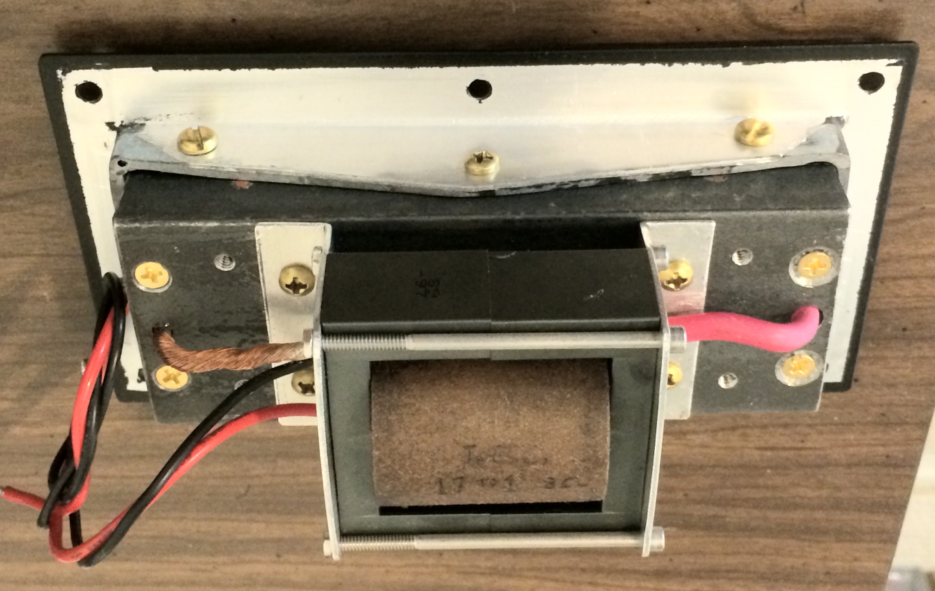

Hi Guys,
I need some assistance I have recently built a transformer for a ribbon tweeter. I measured 4.57 mh on the primary with the core without the core 0.57 mh wire resistance. The question is do I calculate the xo on the primary wire resistance or the core and wire resistance?

Often unless you really know what your doin the calcs dont always give what you think they should.
I would just start with anywhere from 3 to 5 turns on the secondary and wind the primary till ya get whatever Z' your lookin for.
For smaller ribbons I often end up with around 3 turns secondary and about 40-50 turns primary. This of course is ballpark and you can add/subtract pri. winds till you get Z you want.
What size is the ribbon? width /length/thick? and what freq range and system power do you want to handle

Lowpass,
I am building a super tweeter I have calculated the correct ratio but I am just not sure if the inductance of the core and wire are taking into account with the xo? It's a 6mm wide by 50mm long but it only needs to work from 15khz. I build big Apogee planar ribbons so I dont really bother with transformers normally.
If You are planning to use the transformer primary inductance as a part of a second order high pass filter you must calculate with the core in place. The resistance of the wire doesn't play any role when it comes to x-over frequency...
I am not planning on incorporating the inductance of the core but the question do I need to factor the inductance in the xo. The ribbon measures 8 ohms after the transformer and sounds good with a single 3uf Cap but is the inductance playing a role in xo frequency and lowering it with the high inductance?
