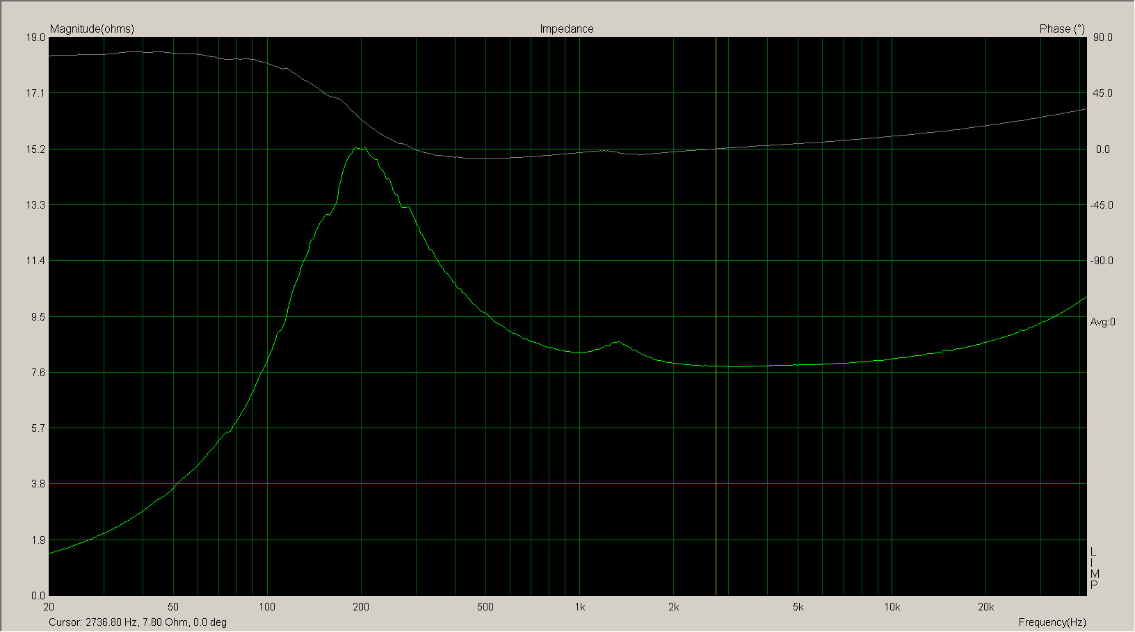

I have to ask, does the ribbon develop an impedance to an HF drive signal?
How much is this impedance related to the DCR of the ribbon?
I strongly suspect that the impedance seen by the drive will be quite a bit higher than the DCR, is it 50% higher @ 3kHz and what about @ 20kHz?
Could it be 150% higher @ 3kHz? and enormous @ 20kHz?
Actually most ribbon tweeters have extremely flat impedance curves compared to other types like domes, at least above about 1Khz, below which the step down transformer has a large effect.
I've attached a copy of the impedance curve of my Aurum Cantus G2 - the curve is a wee bit noisy due to having to measure full spectrum at a very low drive level, but it illustrates the point.
Minimum impedance in the operating range is 7.8 ohms at 3.3Khz, and it has only risen to 8.6 ohms at 20Khz. This suggests that the inductance of the foil reflected back by the transformer is very low relative to it's DC resistance. No big surprise there I think.
it's a dynamic driver, just like a Voice Coil in a magnetic gap. The mass of the cone mimics the reactive impedances that alter the DCR and the "sum" is presented as a load.
A ribbon has mass and it is moved in a magnetic gap.
It also has inductance.
Both of those must result in some impedance/s that will "add" to the DCR.
A ribbon tweeter does exhibit a mechanical resonance peak in the impedance curve, but it's very mild. In this particular example the peak occurs at 1.3Khz, but it's only 8.6 ohms. Compare that to any non-ferro fluid dome tweeter and the difference is huge.
(In fact the impedance stays between 7.8 ohms and 8.6 ohms all the way from 720Hz to 20Khz, flat by any standards...)
I'm not entirely sure why the resonance peak is so minimal. One possibility is that because the foil is so extremely thin and light relative to it's surface area, the effective mass loading of the air (especially in a wave guide loaded design like the G2) far exceeds the mass of the foil itself. In a more conventional dome tweeter the mass of the diaphragm dominates the air load mass.
Regarding the number of turns on the primary and secondary, I've often wondered exactly what kind of transformer is built into the G2, it's clear from the rapidly falling impedance below 200Hz that it has very few turns, if I had to guess I'd say that the secondary is a single turn or a straight link, with the primary having the number of turns necessary to reflect an 8 ohm input impedance. (Impedance near DC on the primary is well under 1 ohm)
Fewer turns does increase the lower cut-off frequency, but on the other hand if it's a cored transformer a lower number of turns will reduce the flux in the core for a given power level and therefore reduce distortion...
