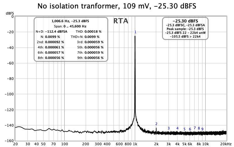

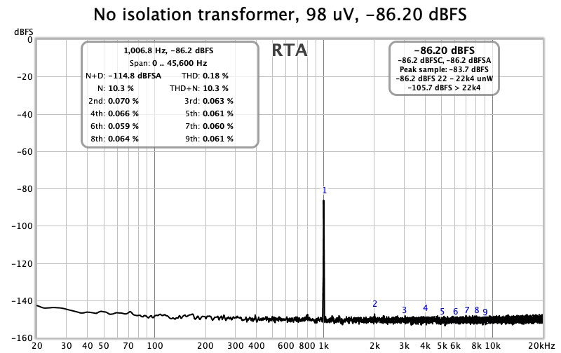

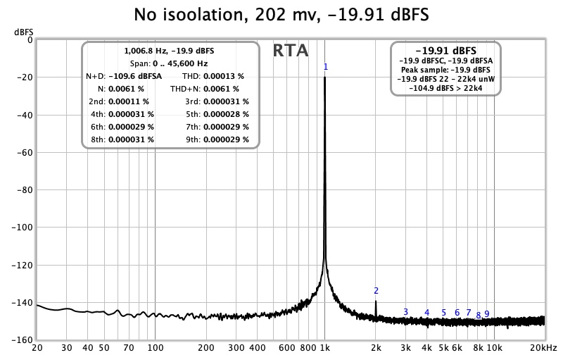

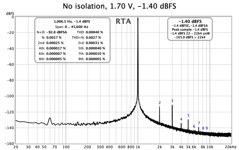

Reran the RTA plots
The scaling may be easier to read, and it shows THD as a percent.
The Akitka does not have the range of output in my system. Minimum is above -90.3 dB, and wide open is not 0 dB. Plus wide open the plot shows some harmonics of the 1khz signal. The REW does not show this, just a higher noise floor.

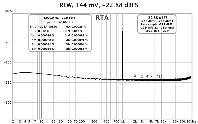

What is the load impedance? Are the voltages shown Vpp or Vrms? And voltages input or at the load?
These were loopback tests using the Clarett. The voltage is RMS.
The Akitika 2ppm generator is plugged into one pair of line inputs, the looped back line output into another.
These loopback tests were just to see where REW and the Clarett 4Pre ended up as far as resolution and noise. The DUT’s are low noise amplifiers.
Still sorting out REW and the capability. The computer is a late 2012 Mac Mini. There have been several upgrades implemented in the audio cards.
From the AP tests the REW and Clarett are right about where the amplifiers measure. This is a noise floor at -140 - 145 dB. Would love to see the RTA noise floor down another 5 - 10 dB.

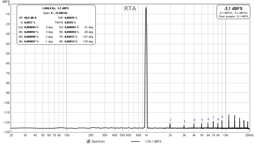

Is this 16 or 24 bit signal?
I assume you are using the REW signal generator. Is it set as 16 or 24 bit?
This is what I could achieve with a modest Sound Blaster Audigy SE.
Great thread, xrk971 !!!
I will start playing a little with the amplifiers that I have.
16 bit. Internal signal generator.
