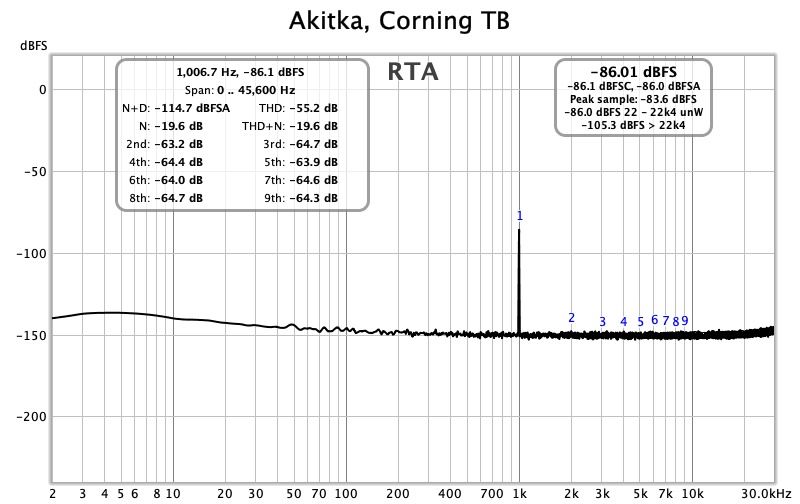

I wanted to update those who tried to help me. Main issue was Apple related. Focusrite does not plug and play with Mojave OS.
But getting great measurements now. BTW the Akitika 1 kHz generator dropped the noise floor 10 dB in my setup.

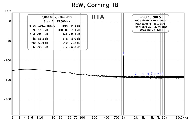

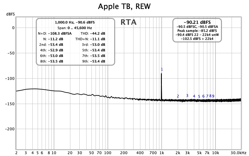

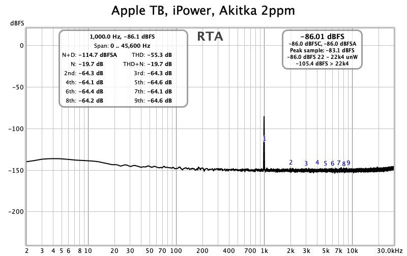

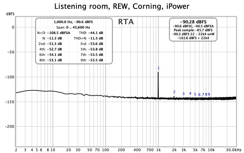

Mine is sorted out. System used is;
Late 2012 Mac Mini
iPower 12 volt supply for interface
Focusrite Clarett 4Pre interface - one out of box 1 hour, the other well used maybe 1000 hours
Played with REW signal generator and the Akitka 2ppm.
First ran the test around -20 dB, later reran close to the -90.3 dB level used by Stereophile.
Varied the generator and the cable, one copper TB cable and a Corning fiber optic. Hoped to see something from the Corning, but at least with my resolution the two cables seem identical.

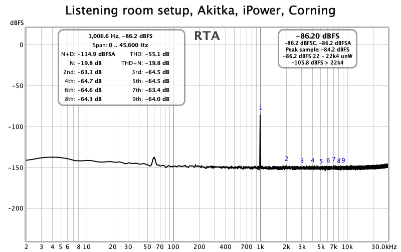

Did find one issue. When testing the listening room set up tyhe test show a 60 hz bump around -140 dB. Suspect it is the 500 VA isolation transformer positioned a few feet below the interface. Will eliminate this.
Late 2012 Mac Mini
