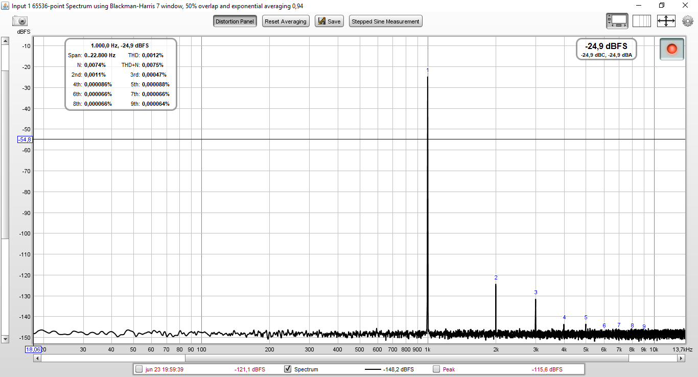

So I installed REW followed the instructions and came up with the attached plot. This is using the internal signal generator.
I found the results greatly depends on the input amplifier and output settings. Which is probably quite logic (less gain less distortion, and also less noise). The input gain of my Focusrite 2i2 is set at min while the output is at max.
One question: when I click the camera icon in the top left I'm able to save the current plot. But that doesn't show the distortion panel. Is here a setting somewhere I need to modify? (the attached picture is a screenshot generated by the prtscrn button).

There is a checkbox when you save the image of the screenshot to show distortion panel. It works. The only thing that doesn’t show is the settings panel - which is useful for showing what the averaging is, number of points, window used, etc. for that you need screen capture of window with print screen button.
Your result looks very good.

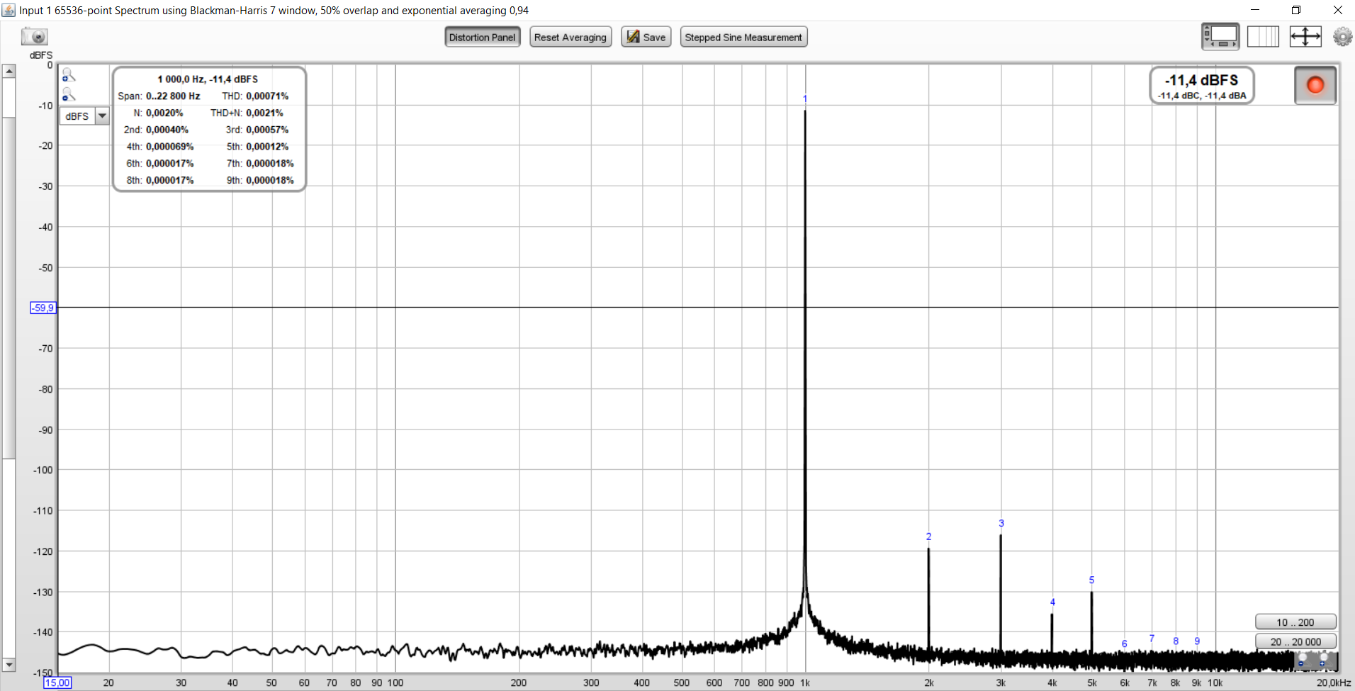

I had to purchase me a brand new Focusrite Scarlet 2i2 and attached is my loopback measurement result with -3dBFS digital level and 2,08Vrms analog level using balanced in/out connections and REW signal generator.
I think I’m good now to proceed to amp measurements too...🙂

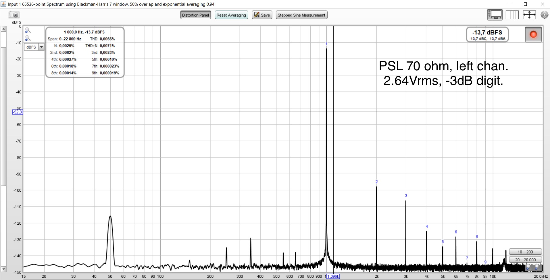

...and here is the measurement of my Pioneer Super Linear headphone amp @70 ohm load on the left channel and pushing 100mW of power (2,64Vrms). The digital level of the REW signal gen was -3 dB.
The results seem to be reasonable and it is nice to have this kind of sanity check for the build. 😀

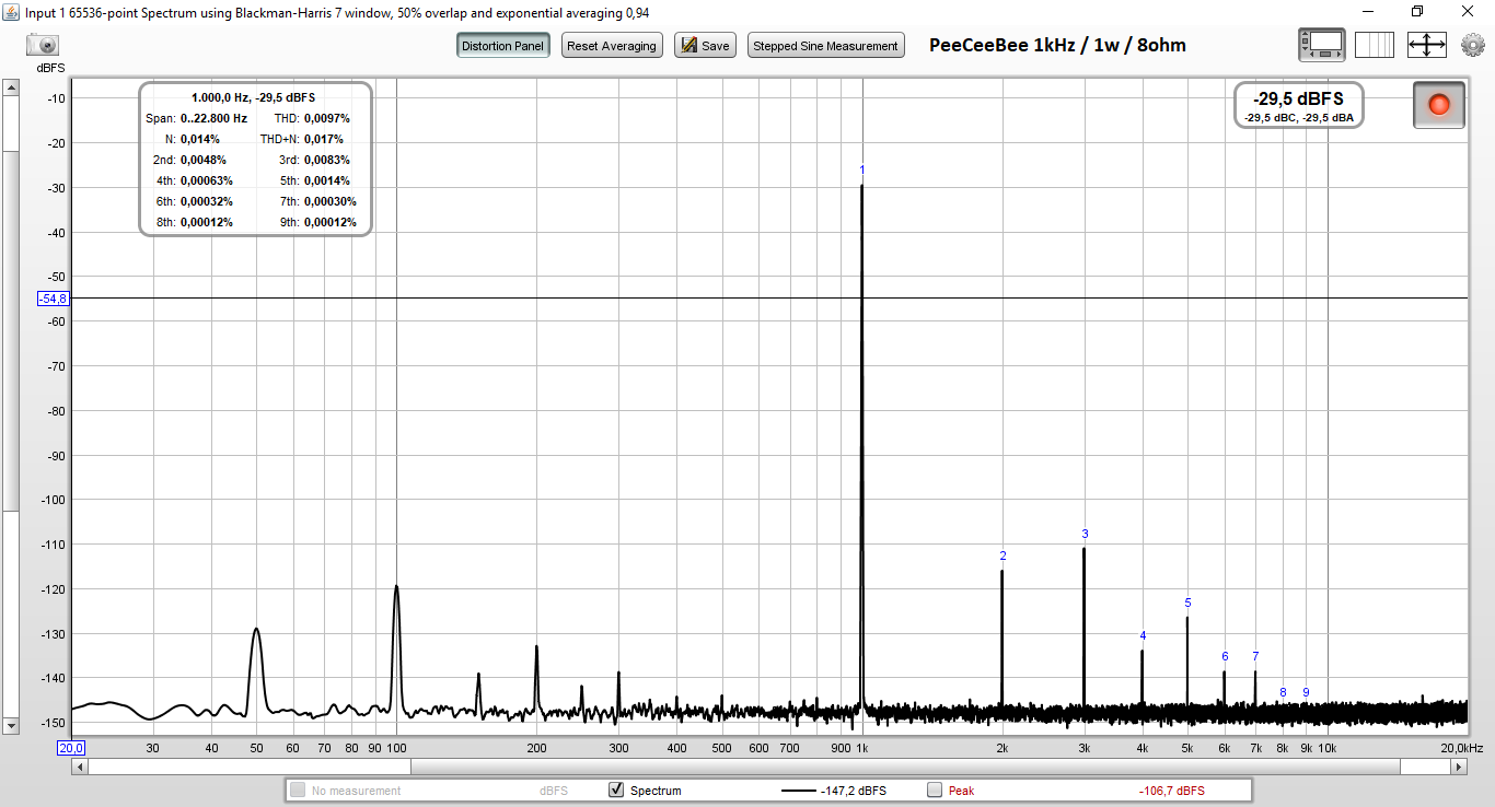

Okay, so I measured one channel of the PeeCeeBee V4H amplifier. This is with the amplifier running with an output voltage of 2,83 volts into 8 ohms (dummy load). I used REW as the signal generator.
The plot is attached. The author has far better measurements, so maybe I'm doing something wrong?

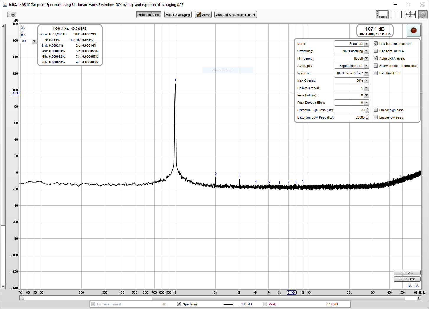

X, thanks for the great guide.
Attached are my results for an internal PCI ESI Juli@ loopback. On your recommendation, I built an Akitika 2ppm oscillator. What an easy and simple kit!

Edit: Noise seems a bit high... I'll need to dig into that, maybe because its a noisy desktop PC next to my AC unit?
