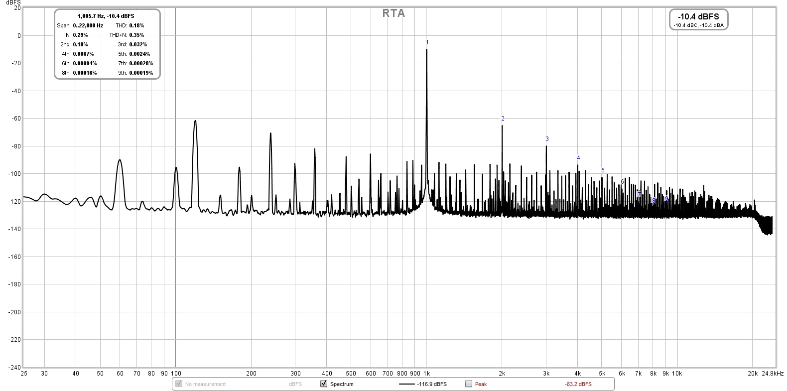

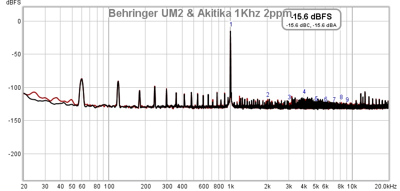

Hi Elwood,
Thanks for posting - please use 10dB/DIV scales next time so we can see more clearly. Also limit range to 0dB to -150dB. I am not sure why you have so much mains noise? Try running laptop on battery?

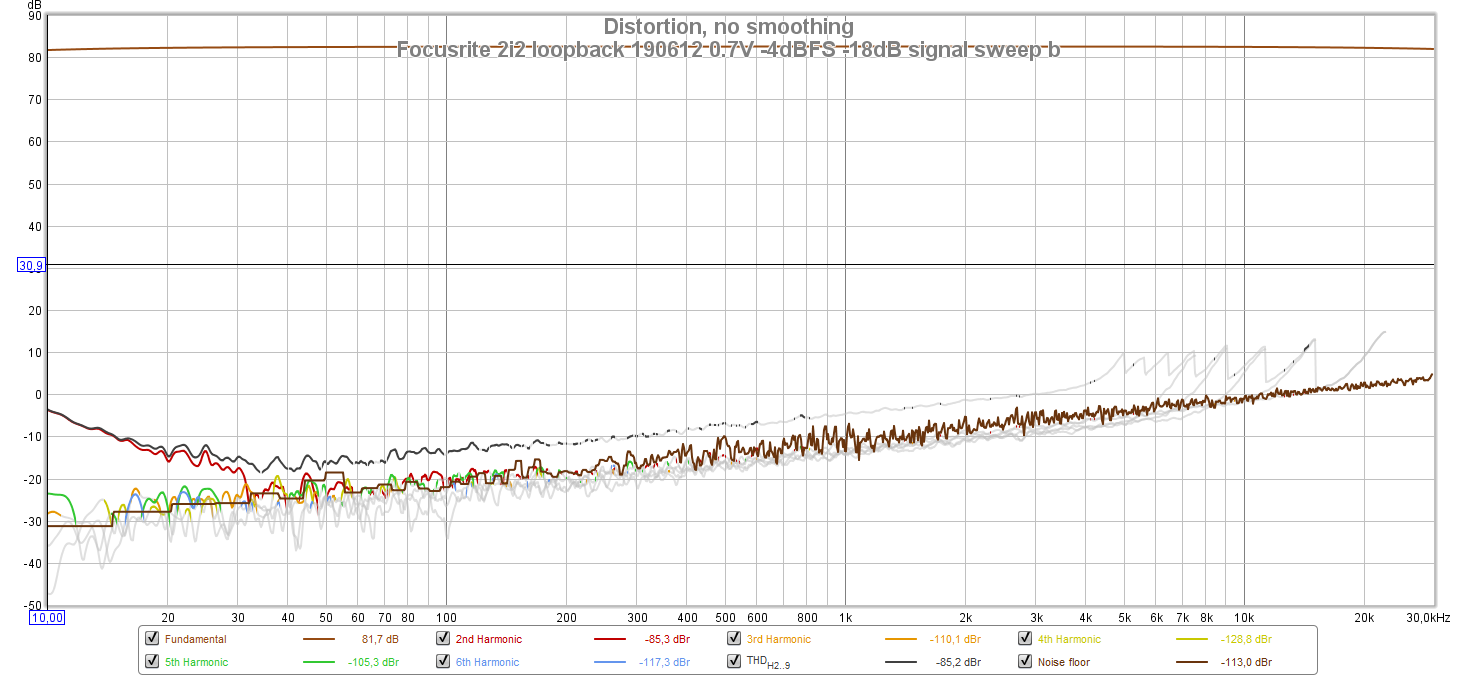

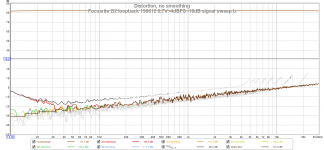

The plot thickens ...
Win7 laptop, Focusrite 2i2 used both as signal generator and analyzer.
In the earlier measurements, the signal generator had been set to -3 dbFS level and the Monitor level set to approx. 0.7V RMS analog output level. The gain of the Focusrite input had been set so that the peak was at -4 dBFS in REW's RTA. This setting has been found to produce the lowet THD and noise figures.
The sweeps done with these settings produced the ominous low-frequency 2nd order harmonic distortion hump.
Now look what happens if I set the sig gen to -18 dBFS level, input gain adjusted so that the peak is at -4 dBFS in the RTA again. (obviously, analog out is now much less than 0.7V RMS).
No more hump ! 😛
When I adjust the analog Monitor level setting to max, I gain 4.4 dB in level ... and the hump starts making an appearance again. So I still don't know if it's the Focusrite's DAC, or its analog output section, but it doesn't look like it's on the input / ADC side.
Regards, Claas

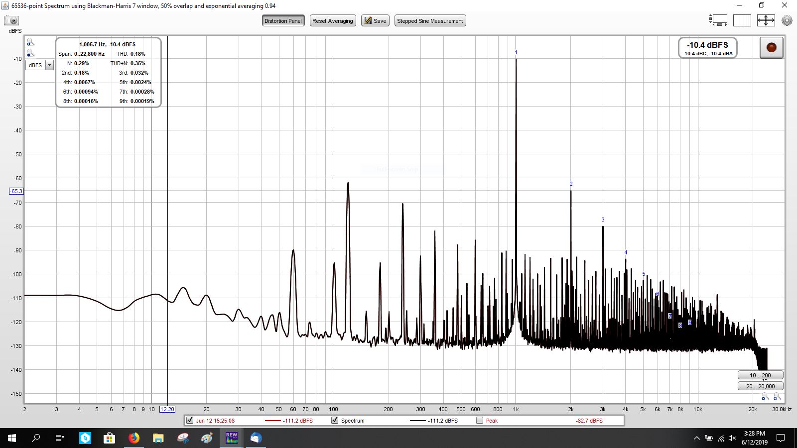

Like this?
Yes! Click on the 4 arrow cross to adjust the span.
Your PSU looks like what mine used to look like when I reported the “Forest of Noise” issue. Couple things may be going on here: you have power trafo EMI interence being coupled into the Edcor and amplified, your power trafo may be saturating due to dirty mains having DC component, and/or there are ground loops. Having 120Hz mains component only -55dB below your signal is quite audible.
But THD and profile looks consistent with what I recall.

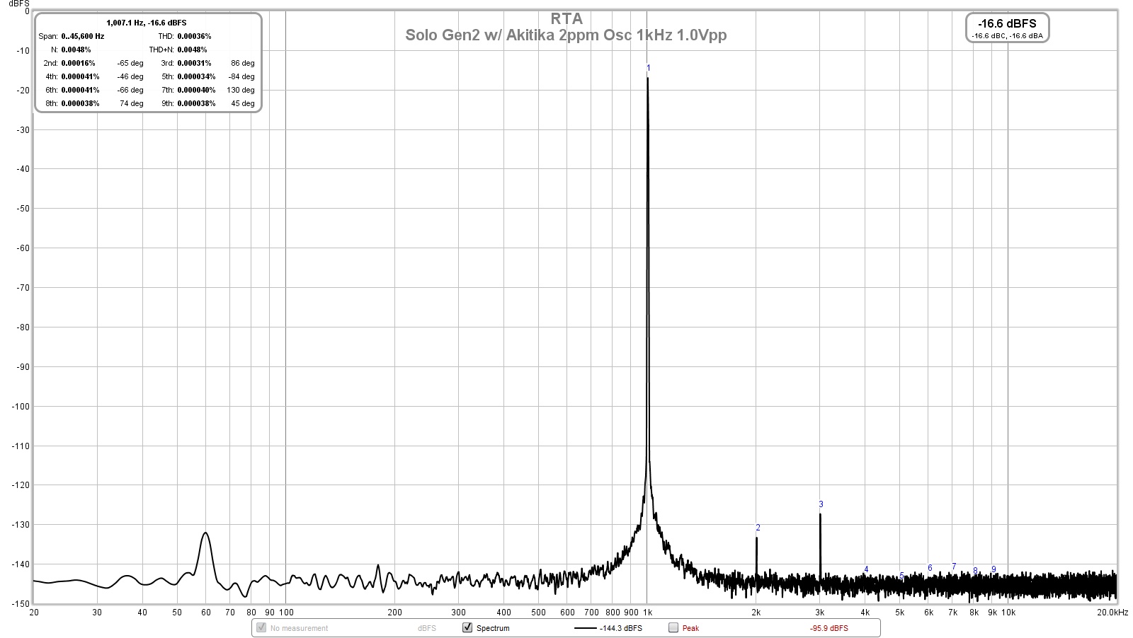

Update June 3, 2019: Here is a loopback using Focusrite Solo gen2 and Akitika 2ppm 1kHz oscillator at 1.0Vpp into 10k:
How is it possible to get 0.00033% THD when the Solo is spec'ed at 0.003%?
Using a Victors oscillator I am getting 0.0033% THD using a 1st gen 2i2 which has a THD spec of -91dB (about the same as 0.003%) at minimum gain 🙁
I've followed the instructions and settings carefully but wonder if I am doing something wrong?
The amplitude that the oscillator has to drive and the output impedance of the oscillator has an impact on the value. Make sure you are not asking an opamp of to drive a low impedance load at too high of an amplitude. 1Vpp is 0.353Vrms.

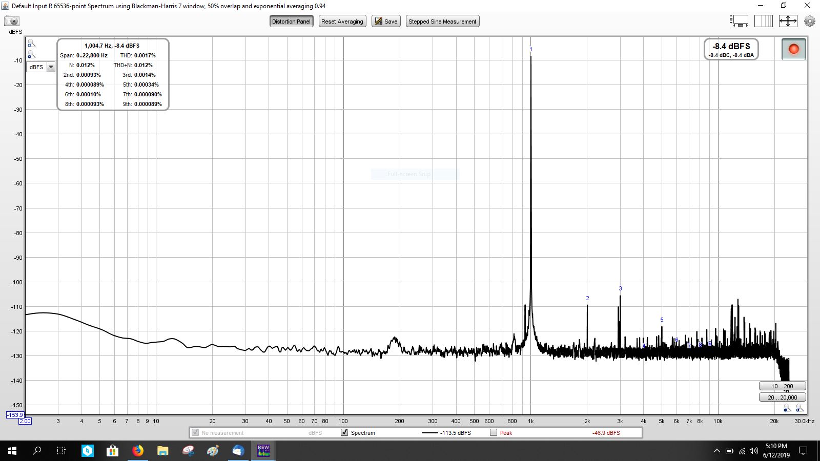

How I got a number better than factory spec? Lucky unit?
Maybe it’s not just all luck? I measured 0.00061%THD with my 2i4 and this was a headphone amp driving 47ohms - not a loopback.
Careful attention to good quality cabling, clean connections, a quiet laptop (mine has a SSD). Mostly, make sure you are not driving any more amplitude than needed from either the oscillator or the Focusrite front end preamp.
