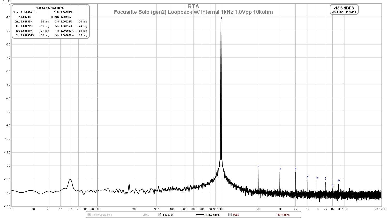

Focusrite Solo gen2 Loopback Performance

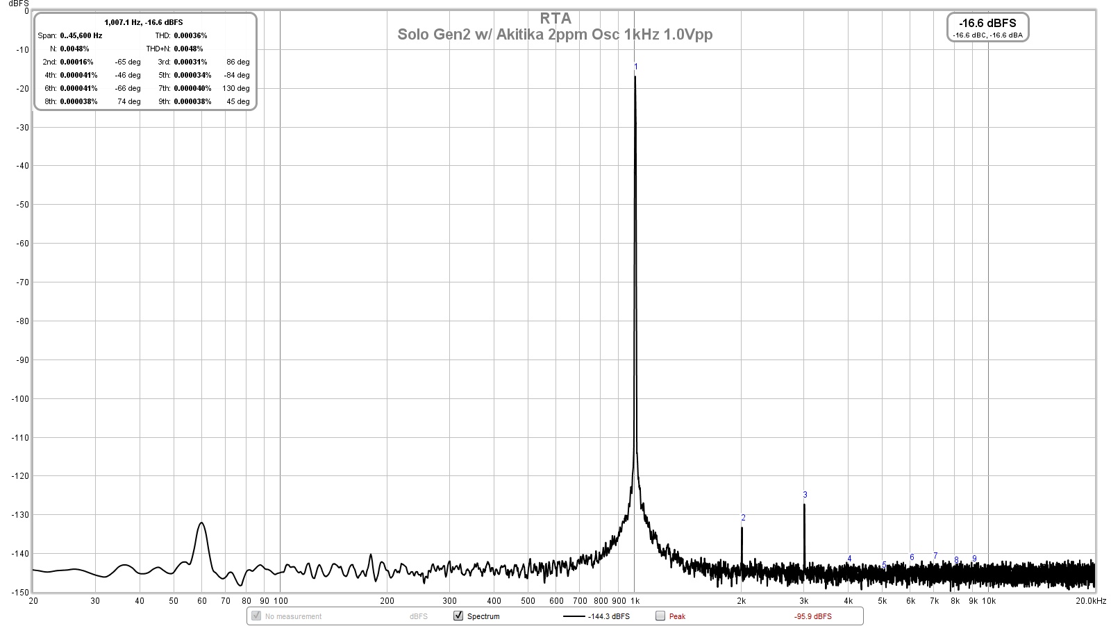

Here is Focusrite Solo Gen 2 with internal oscillator (in REW) and also with external Akitika 2ppm 1kHz oscillator. Both at 1.0Vpp into internal 10kohm impedance of audio input. Both tests performed with PC laptop connected to mains via SMPS brick and external monitor.
Internal oscillator achieves about 0.00058% THD and has dominant 2nd order harmonic and some higher orders:
External Akitika 2ppm oscillator is 3rd harmonic dominant (specs say should be 2nd order) and no higher orders, THD is about same as 2i4, at 0.00036% given same DAC is used. However, the mysterious 100Hz comb is now gone:
So it looks like the less pricey Solo 2nd gen is quite capable.

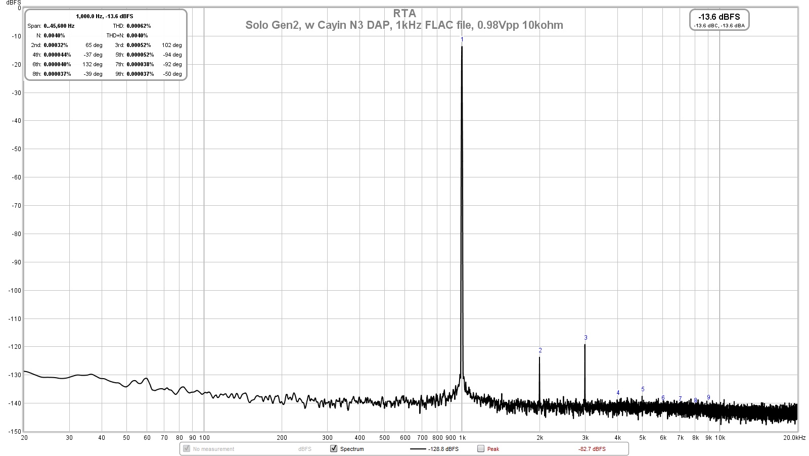

And here is using the Cayin N3 DAP with internal AKM4490EN DAC and OPA1688 output driver playing a high res 1kHz FLAC file (generated in Audacity), it achieves THD of 0.00062%, but look at the purity of the 1khz oscillator linewidth (narrow spike vs broad shoulders of the above oscillators), however, it has a mildly rising DC level perhaps generating some low-level broadband rumble?:
Use of the Cayin N3 is certainly better than the built in DAC for the Solo and internal generator - but the 2ppm linear oscillator seems to beat them both - so a good tool to have on hand if you want lower than 0.0006%THD loopback.

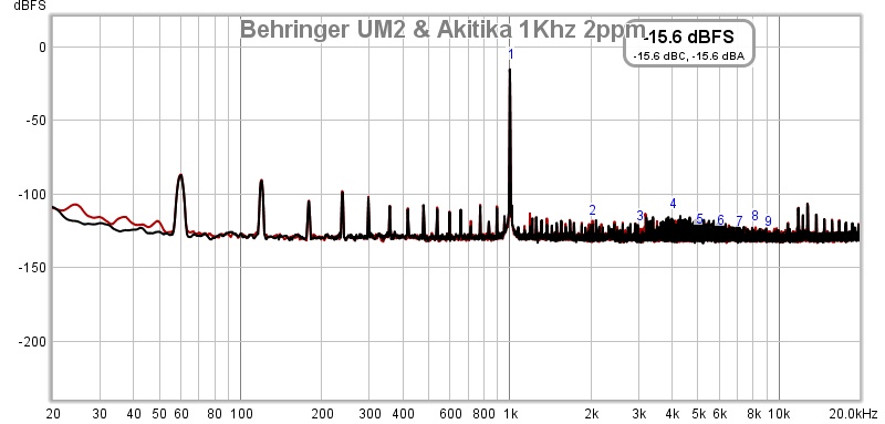

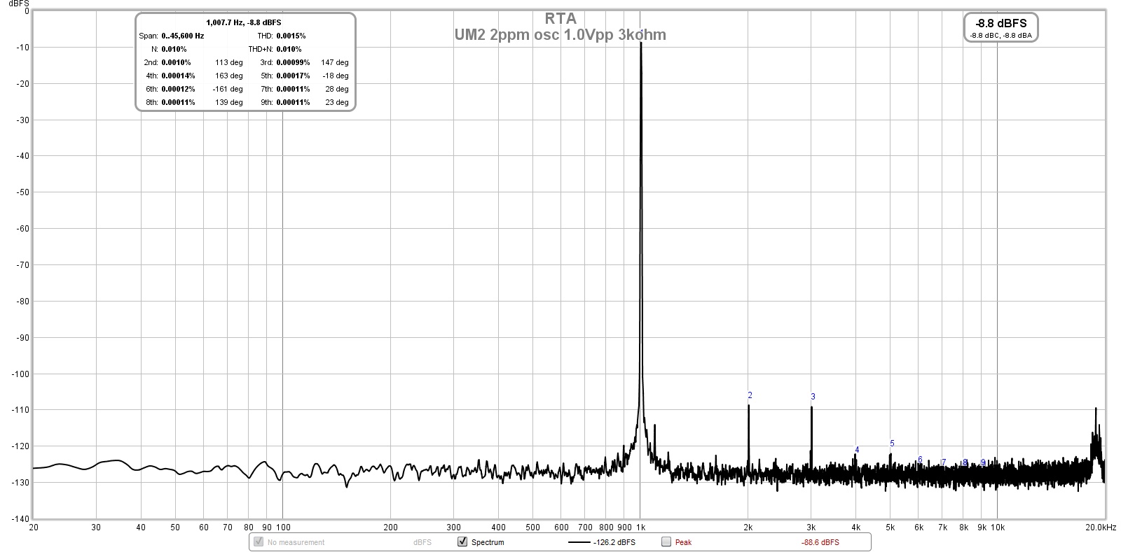

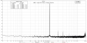

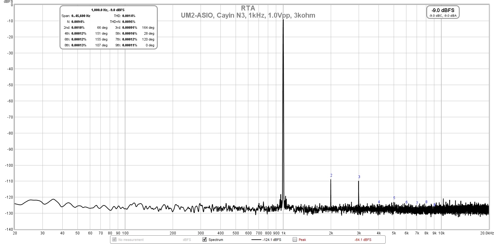

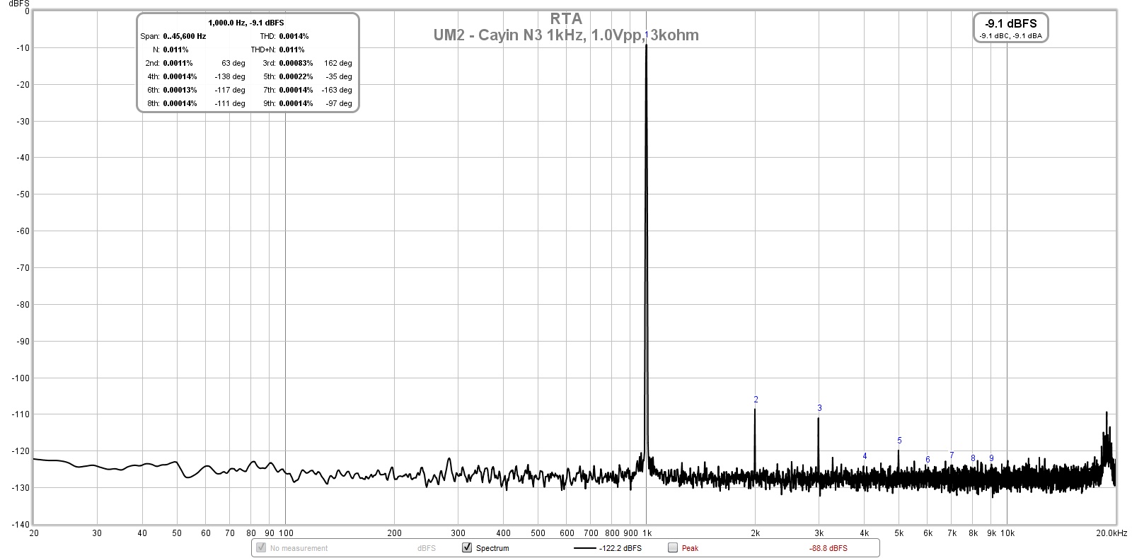

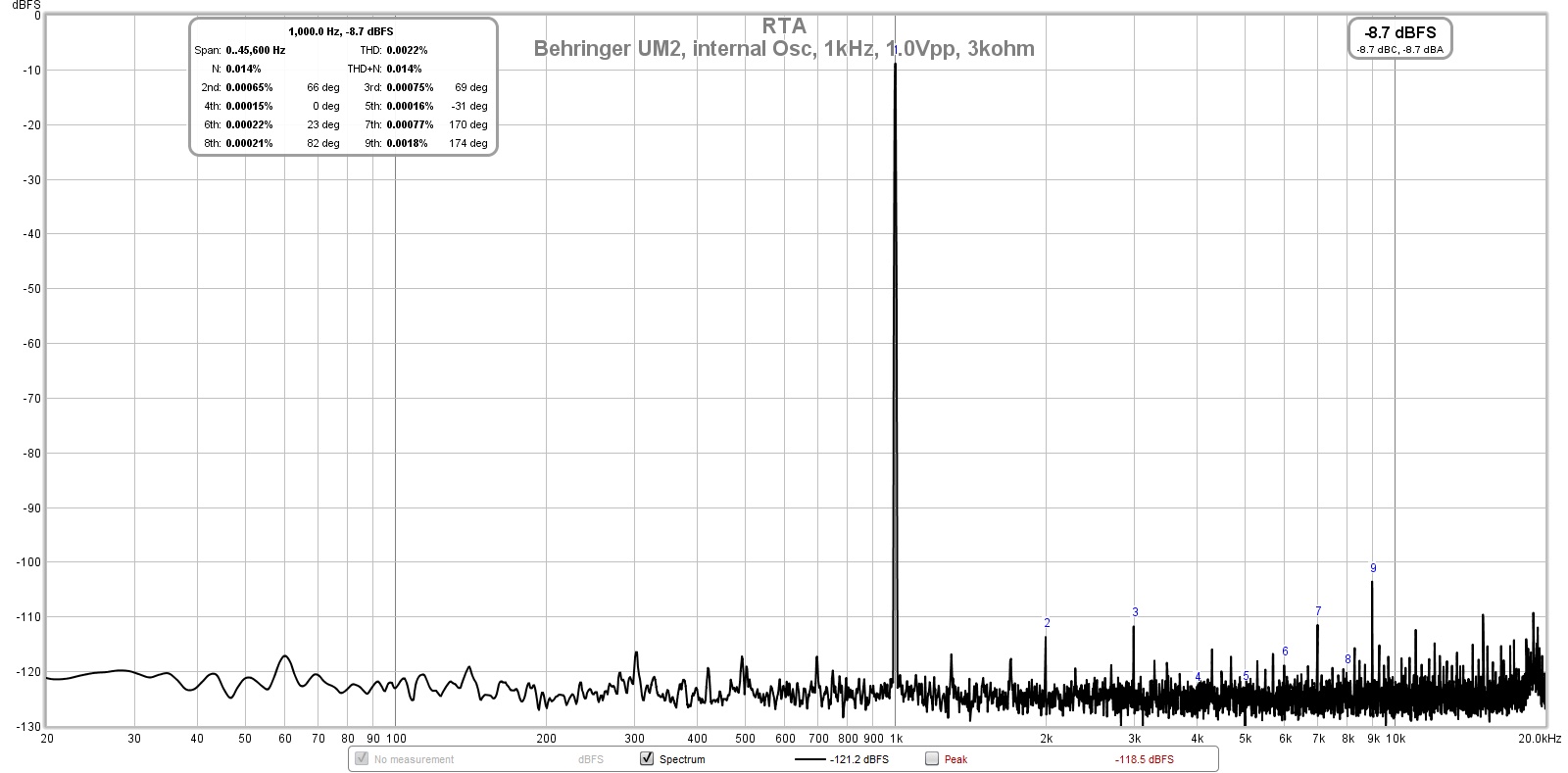

Behringer UM2 interface and REW

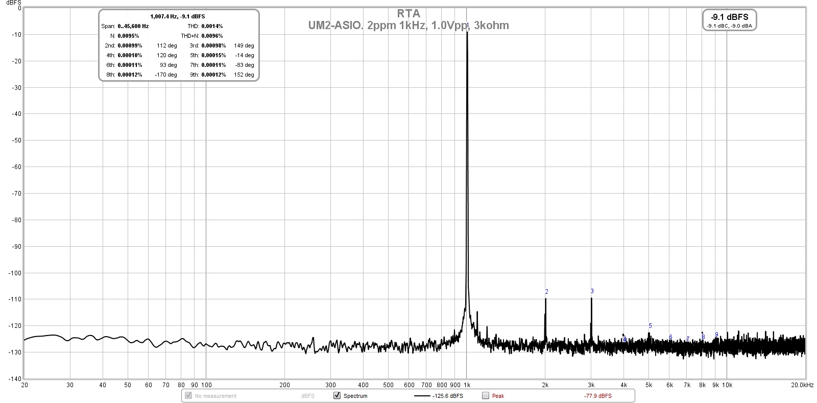

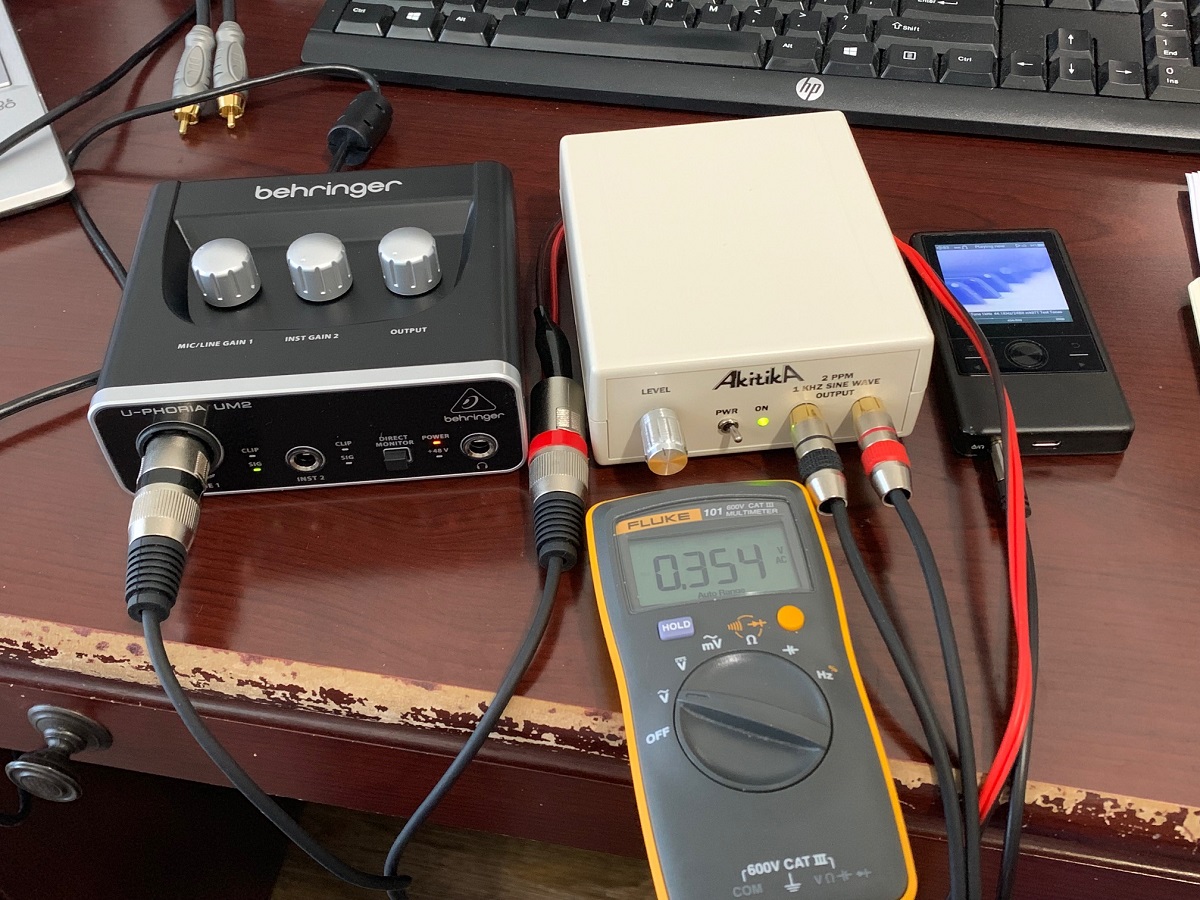

My UM2 arrived today, hooked it up and ran similar tests to the Focusrite Solo. The UM2 is about physically the same size, but uses no metal on the case, and all knobs are plastic rather than a nice metal volume knob. It seems well built though. Connecting it to Win10, it was recognized and worked fine with Java drivers. I also installed the factory ASIO driver. Performance with ASIO is less noisy - so there is an advantage to using ASIO driver here.
Setup:
UM2 with Java driver and internal oscillator loopback 1.0Vpp into 3kohm (internal impedance according to manufacturer). Notice the low level hash and 19kHz feature:
UM2 with Java driver and Akitika 2ppm 1kHz oscillator, 1.0Vpp into 3kohm, less hash but 19khz feature still there:
UM2 with Java driver and Cayin N3 FLAC 1kHz oscillator, 1.0Vpp into 3kohm, 19kHz feature still there:
UM2 with ASIO driver and Akitika 2ppm 1kHz oscillator, 1.0Vpp into 3kohm, able to get 0.0014%THD but 19kHz feature is now gone - looks like Java noise or processing artifact:
UM2 with ASIO driver and Cayin N3 FLAC 1kHz oscillator, 1.0Vpp into 3kohm, same 0.0014%THD with higher THD source so looks like the UM2 instrument limit is 0.0014%THD :
Overall, at $38, it is a very usable instrument for basic spectral measurements of most DIY amps and headphones, but not lower distortion amps. I forgot to measure internal oscillator with ASIO. i wouldn't be surprised if it also was 0.0014%. I think what we may be seeing here is the the Behringer touted 'ZENYX" microphone preamp which seems to have equal amounts of H2 and H3 for a sweet sound yet still have some 'bite' to it. Actually, a similar profile to M2 amp, but with 40x less THD.

When looking at spectra of high purity oscillators like this the specific FFT window chosen is vital - otherwise you risk assuming the shoulders of the fundamental are actual oscillator phase noise (they could just be FFT window shape). In particular you need a high dynamic range flat-top window to see the true phase-noise side band detail. The Hann (aka Hanning) window will not do.
Plots that don't identify the FFT window are alas rather meaningless in this context.

As mentioned in post 1, I always Blackman Harris 7 window function. But will add that to the notes next time.

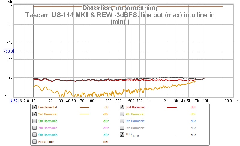

106dB is an A-weighted specification. Tascam rates the distortion of the US-144MKII as 0.0045% (= -86.9dB, through ADC and DAC), but this is with an input of +20dBu. Since the maximum input level is specified as +9dBu, work that out!

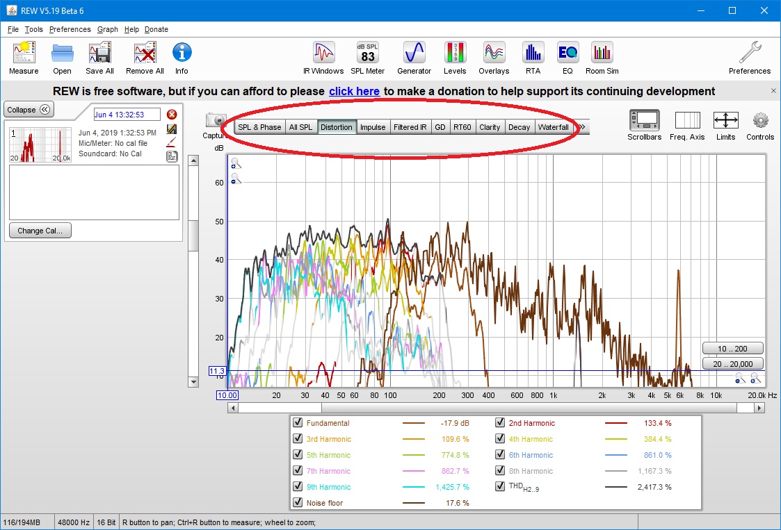

I can achieve an 80dB range in the sine sweep measurement as the attached view shows. Now what does the Focusrite 2i2 (2nd generation, if you will) achieve in PRACTICE in a sine sweep?

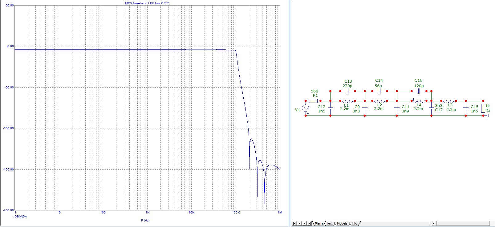

Aridace,
Thanks for the filter design, do these have to be air cores or can I use small ferrite cores?
Off the shelf Toko inductors have a ferrite core and the 100mH shielded version has a limit of 5 mA DC, lower inductors have higher limits so it's unlikely that a signal level of several volts (ADC input) for a low pass filter would pose a problem.
Well, if ferrite cores are ok, I just need to pull out the Coilcraft catalog. They are very good with samples too.

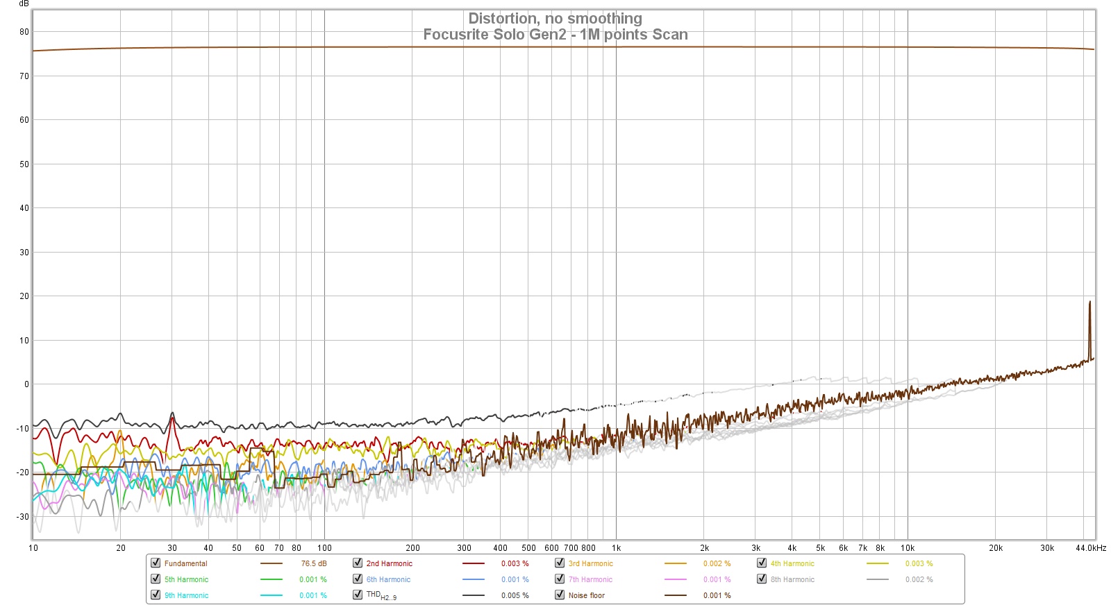

Here is a frequency scan using Focusrite Solo Gen 2. In the "Measurement" dialog, choose the depth of points to get more dynamic range. Default is 256k which gives kind of a low DR. Choose 1M points gives 86dB for fundamental and 96dB for noisefloor at 100Hz. Gets worser at higher frequencies and about 5dB worse at 1kHz. You can even average multiple sweeps to get it higher.
Here is loopback using internal freq generator for distortion orders vs frequency - going all the way out to 44kHz since this is ASIO 96kHz:
Looks like the input preamp filters etc work above 20kHz though - and that's good.

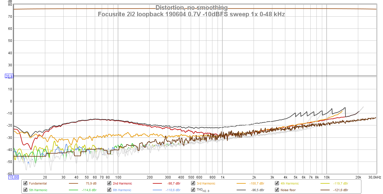

xrk971, thank you !
I always had tried to use the "signal generator" icon, as I did for the sine and stepped sine measurements. That didn't work for the sweeps ... 😛

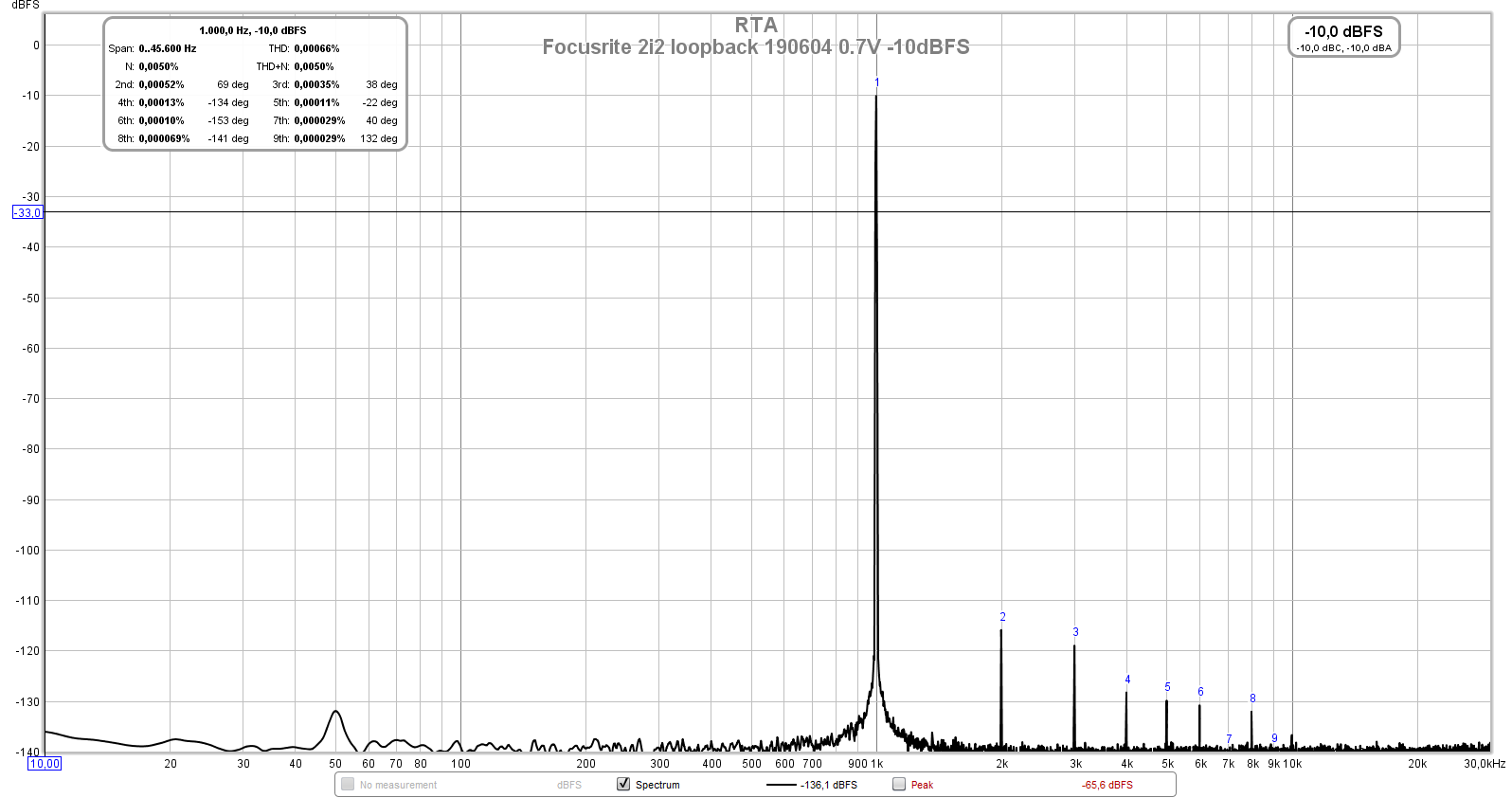

The key was to use the "measure" icon. So here are my results for Focurite 2i2, internal generator, output level digital -3 dBFS, output analog 0.7V, and I set the gain so that I got -10 dBFS at the 1kHz sine peak, as I found that this gives slightly lower THD than setting the gain to -4 dBFS at the peak.
Also, I had s slight 50 Hz signal I got that gets picked through the air, as shown earlier. I found that this gets much lower to non-detectable when I put my hand on the metal case of the Focusrite. Laptop running on battery for all of this ... 🙄

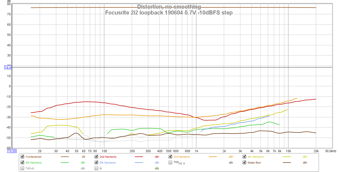

Here is the result again for the 1kHz signal:
And for the sweep:
And again, for comparison, the stepped sine:
I also tried averaging multiple sweeps (8x), but found that it didn't help the THD. The noise floor got lower, but in the high frequency range from 10 kHz up the distortion signatures didn't average out, but instead summed or something similar, rising sharply.
I think the results are not too bad for the Focusrite and its internal generator ... that one is certainly much lower distortion than my (rather oldish) Tektronix CFG250 ... 😉

Nice work Chede,
I wonder why your Focusrite has a broad distortion hump at low frequencies? It should be very similar to the Solo? Maybe there are other settings at play.
Please check to make sure you have all native PC “sound effects” processors turned off. I had to turn off my HP “noise reduction” background plugin and the B&O “audio effects” driver. Leaving things like that on will sometimes generate all sorts of distortion anomalies. I struggled with a an anomalous bass distortion for weeks until I found out it was due to a “bass boost” background audio plugin from factory.
This looks like a 7.5dB 60Hz bass boost with Q=0.5

Hi xrk971,
I did have a close look at the settings of the PC, and didn't find any audio settings that were set away from flat.
Also note that in the graph I posted there is no normalising of the fundamental; the level is almost flat at the whole range, with very slight drops towards 10 Hz and 30 kHz.
I did take a number of sine measurements at different frequencies - 20, 30, 50, 60, 100, 200 Hz, and it really looks like that while the Focusrite 2i2 has constant level, there is the range of higher distortion between 15 and a few 100 Hz that you can see in the sweep. And tonight I didn't have visible 50 Hz / 25 Hz or other noise peaks in my spectra ...
So, it remains a puzzle ... 😕
From my current state of measurements taken, I would have to infer that the Focusrite 2i2 has a range of higher distortion at low frequencies ...

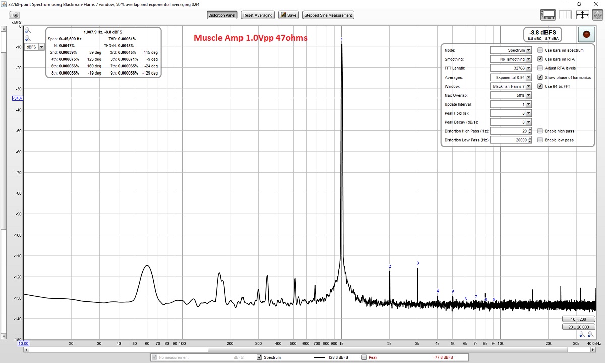

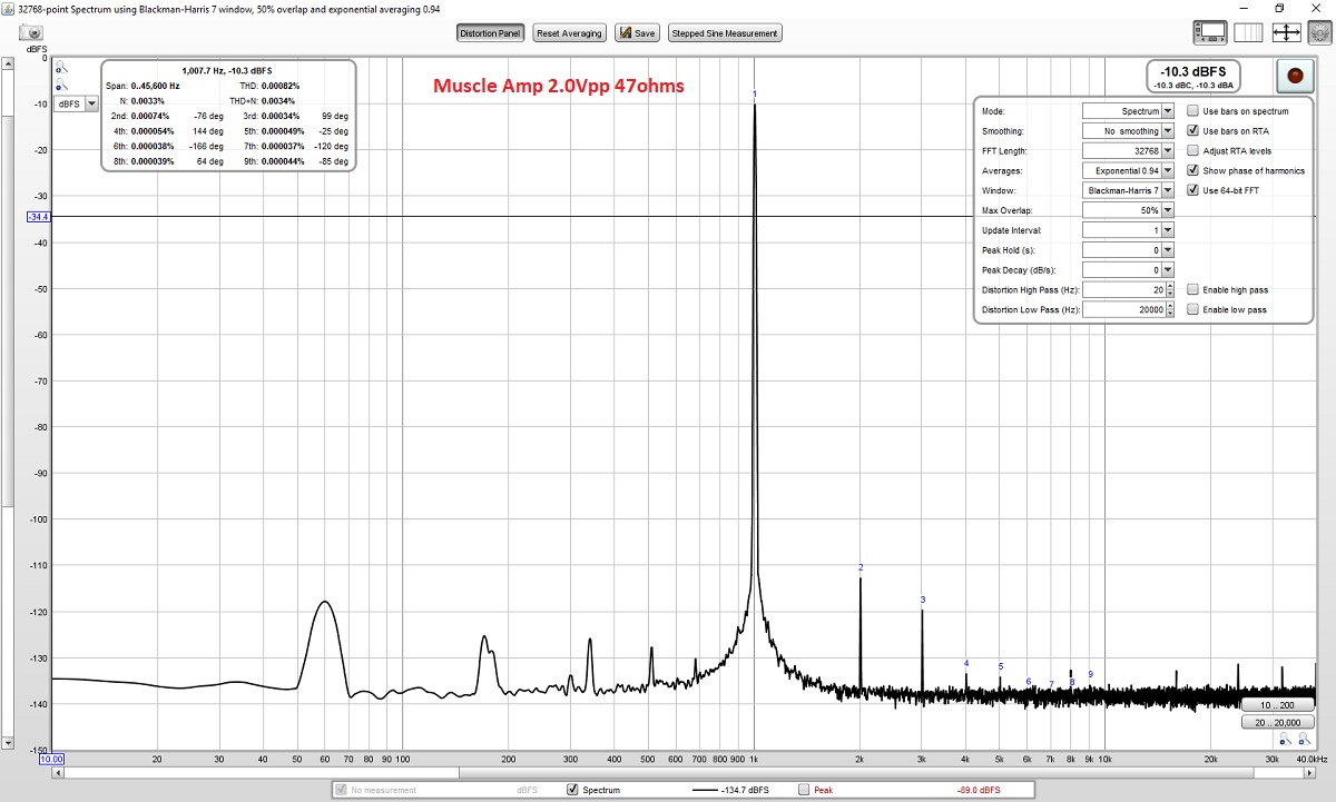

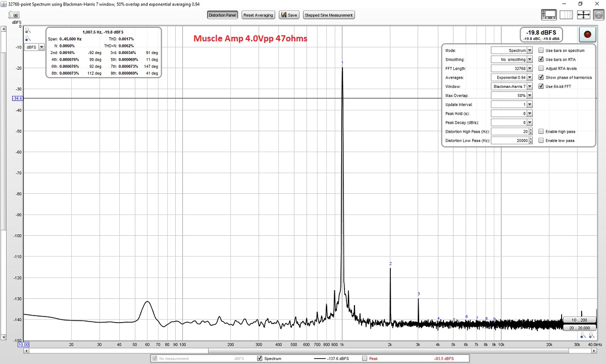

Some recent measurements of my new overkill 8x parallel OPA1622 Muscle Amp headphone amp. This was made using the 2ppm 1kHz source and 2i4 in differential input mode using a TRS input jack with tip and ring wired across 47ohm dummy load. No attenuation divider used. I noticed that the 100Hz comb around the 1kHz shows up when I take my hand away from the plastic case that the 2ppm source housed in. Looks like it could use a metal case that is grounded for better noise performance. I also found that by expanding the setup dialogue sub window and doing a screenshot, all settings are displayed vs using the “camera” screenshot to file button which does not show the settings.
https://www.diyaudio.com/forums/hea...pa1688-low-thd-muscle-amp-22.html#post5817653
1Vpp into 47ohms:
2Vpp:
4Vpp:
This amp seems to have an increasing second order distortion with increasing power - not a bad thing. It is ultra quiet and sounds very neutral, otherwise.
