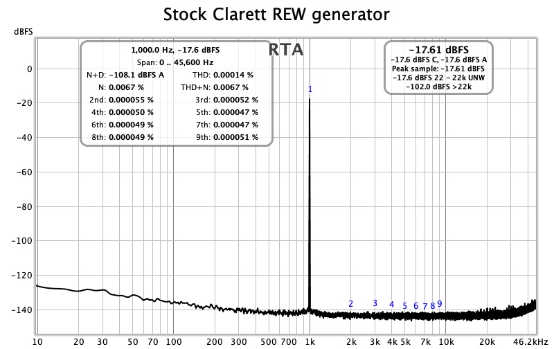

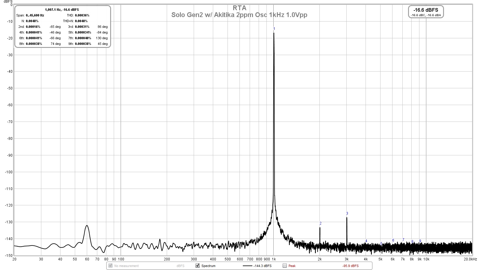

Did some tests
It looks like the Akitka is being routed around and the results are not just the analizer into an analog input and seeing the analysis of just the generator.

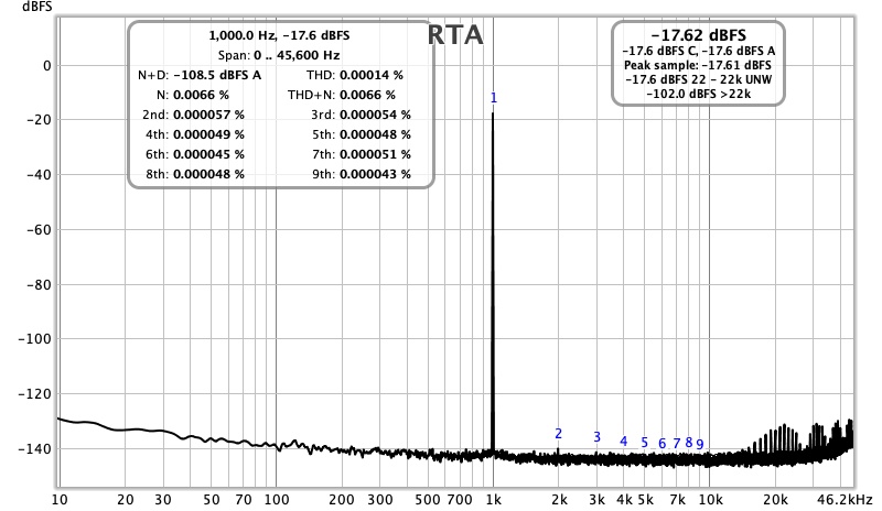

I have witheld some info. The Clarett used has had some decoupling work and all the JRC5532 opamps replaced.
I hooked up the stock unit and see these two. Then todays test with the modified unit
You need to show us a block diagram with connections. I for one, am completely lost with what you are doing with recursive routing of the out to ins. Please post a diagram. Also, what are you trying to do by making repeated loop back measurements- to get the inherent THD as low as possible? It looks like you are already at sub ppm levels - the data shows that although I am not sure what it means until you say what the Vrms is across what resistor load? What is internal impedance of Clarett? 2i2/4/solo are 52k.
This plot is darn impressive but it probably means you need to turn the gain up or the amplitude higher until we can see some peaks. What is 1Vpp (0.355Vrms) into 50kohms?
So for example, what is the Vrms of the 1kHz signal being fed into the input jack for the data below:

I think if gain is turned up the distortion will rise. The solution is to use a larger fft length. It's pretty easy to get -160db of resolution with 256k.You need to show us a block diagram with connections. I for one, am completely lost with what you are doing with recursive routing of the out to ins. Please post a diagram. Also, what are you trying to do by making repeated loop back measurements- to get the inherent THD as low as possible? It looks like you are already at sub ppm levels - the data shows that although I am not sure what it means until you say what the Vrms is across what resistor load? What is internal impedance of Clarett? 2i2/4/solo are 52k.
