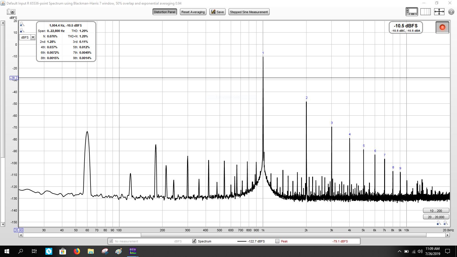

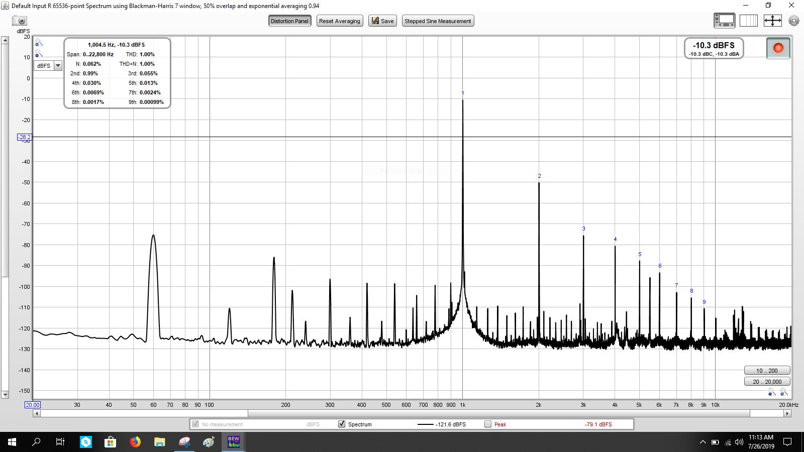

I have the measurements for my B1 Korg Triode preamp using Behringer UM2, Akitika 1K generator and REW software. I was measuring and adjusting 2nd harmonic:
1 - 9.5 vdc at T7/T8 = 1.28%
2 - 10.24 vdc = 1%
3 - 11.56 vdc = 0%
4 - 12.4 vdc = 1%

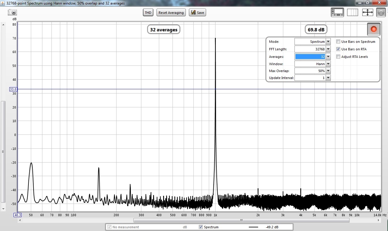

Press the THD button above the graph. May also want to update to the latest V5.20 beta version or the current V5.19 release.Yes. peak search with delta.

There is option in newer version to enable in dB.
RTA window - Gear setting button - Show distortion in dB

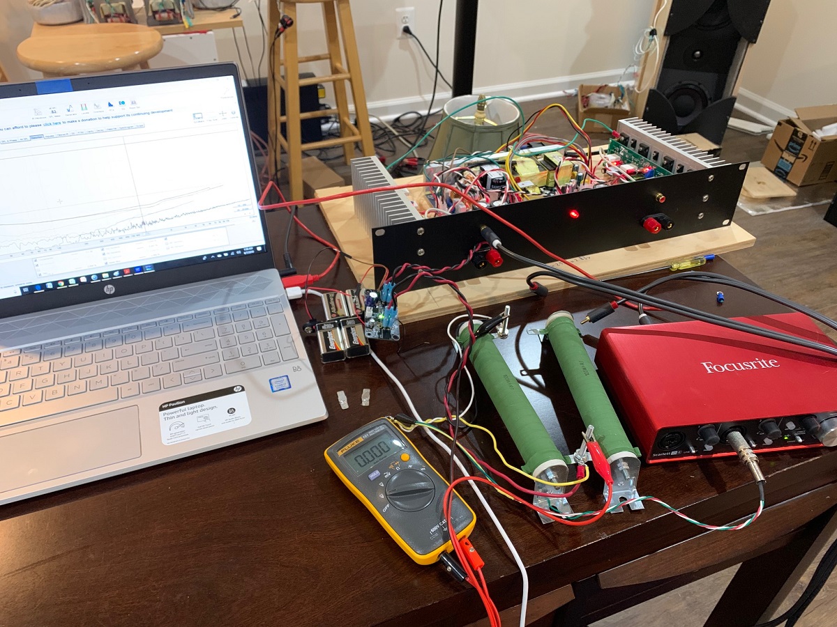

Some recent measurements I made in a VHEX+ Class AB amp. New here (for me) was using the sweep function to see behavior of components of distortion at different excitation frequencies from 10Hz to 20kHz. I also used the Plot Overlay function to compare the THD from two different sweeps on the same plot. I also looked at THD as a function of power into a dummy load. This was interesting as I did it for two cases (with and without a SSR DC protection circuit in place) and recorded the THD data manually into a spreadsheet and used that to plot the resulting graph.

Here is the setup:
Tests conducted for 40Vpp into 8ohms (25wrms) - except for THD vs paper which used 65mW to 32W.

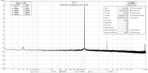

Hi, thanks for the guide XRK.
I think I must be doing something wrong here because my measurements seem way out.
The setup:
Behringer UCA202 connected to laptop with SSD on battery power.

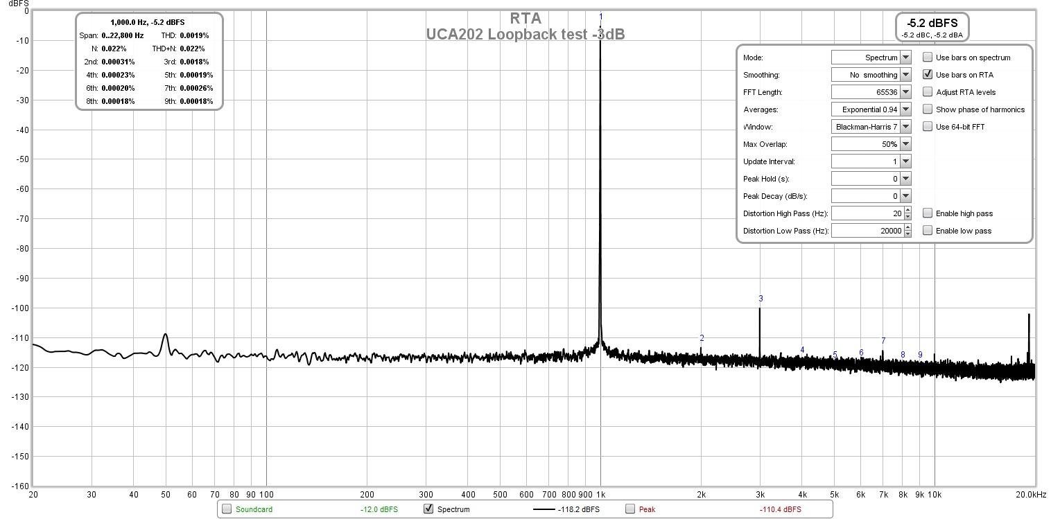

When I check the UCA202 self noise, it looks good.When I do a loopback test using the internal REW generator, again it looks ok:

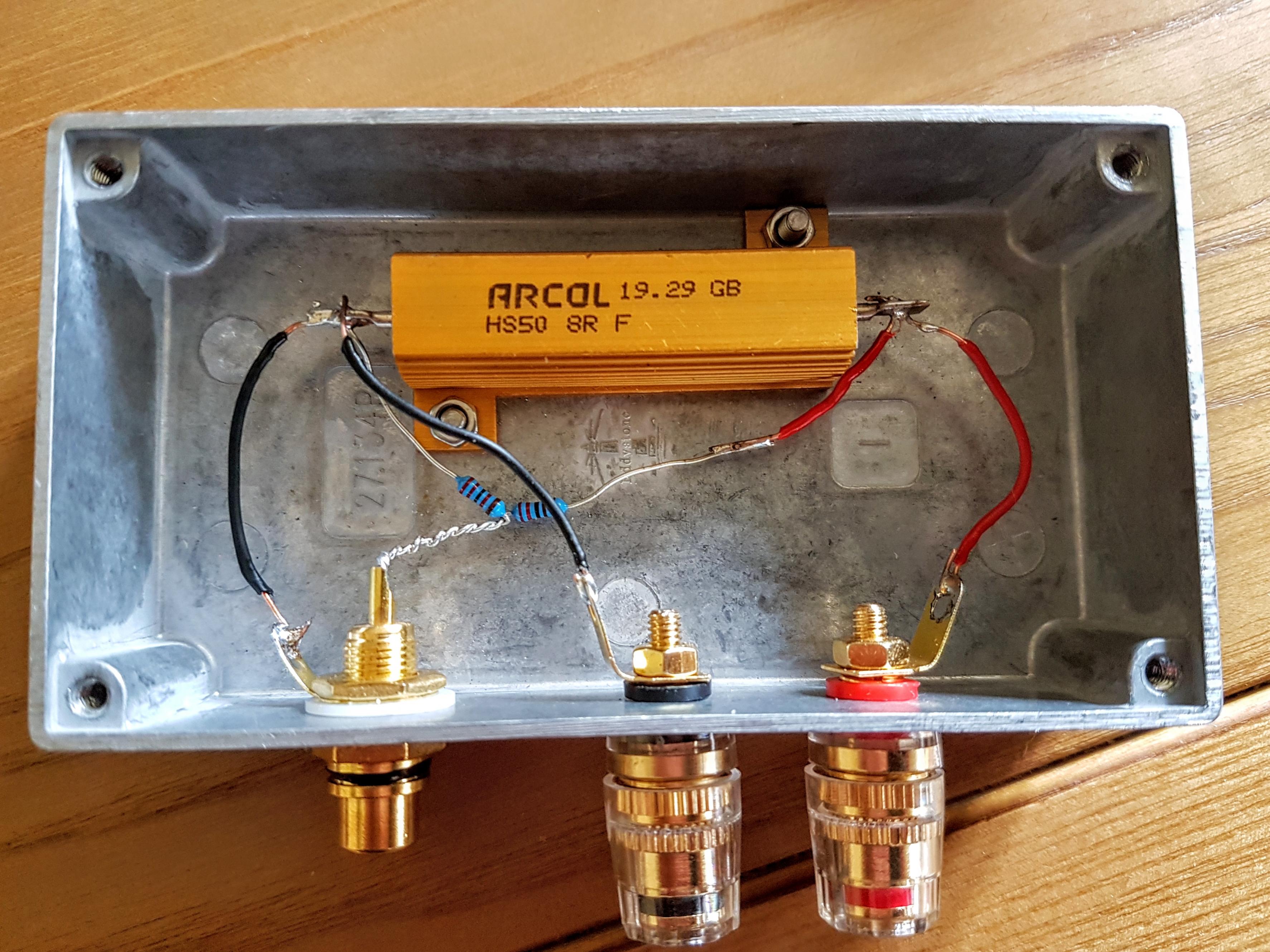

I use this setup for dummy load (8R, 50W power resistor) and attenuator (22K and 2.2K resistors).

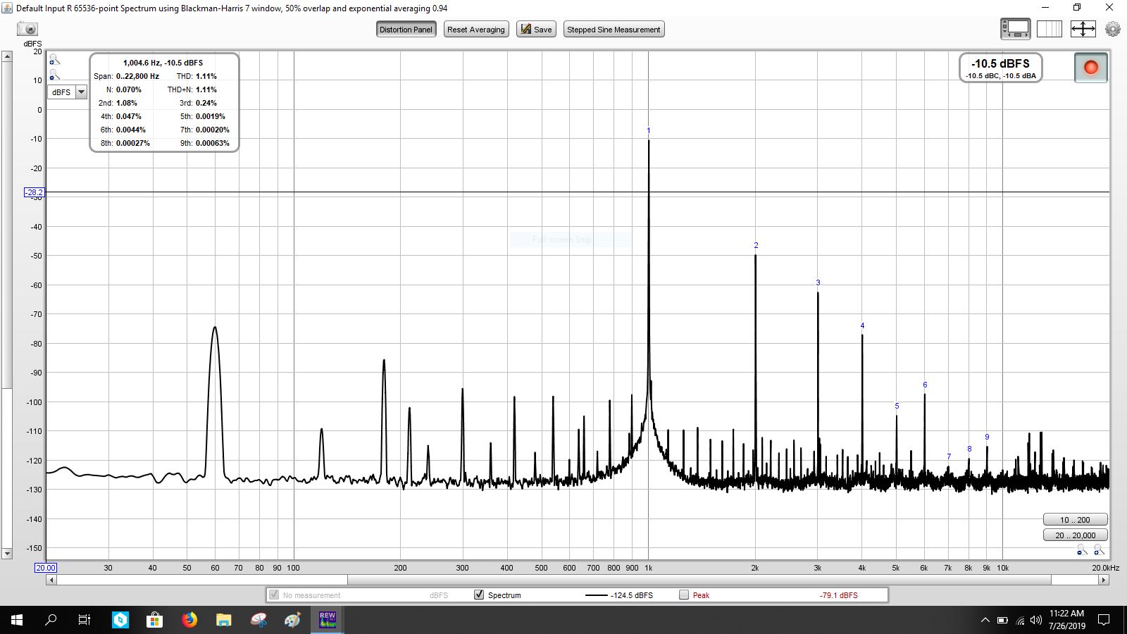

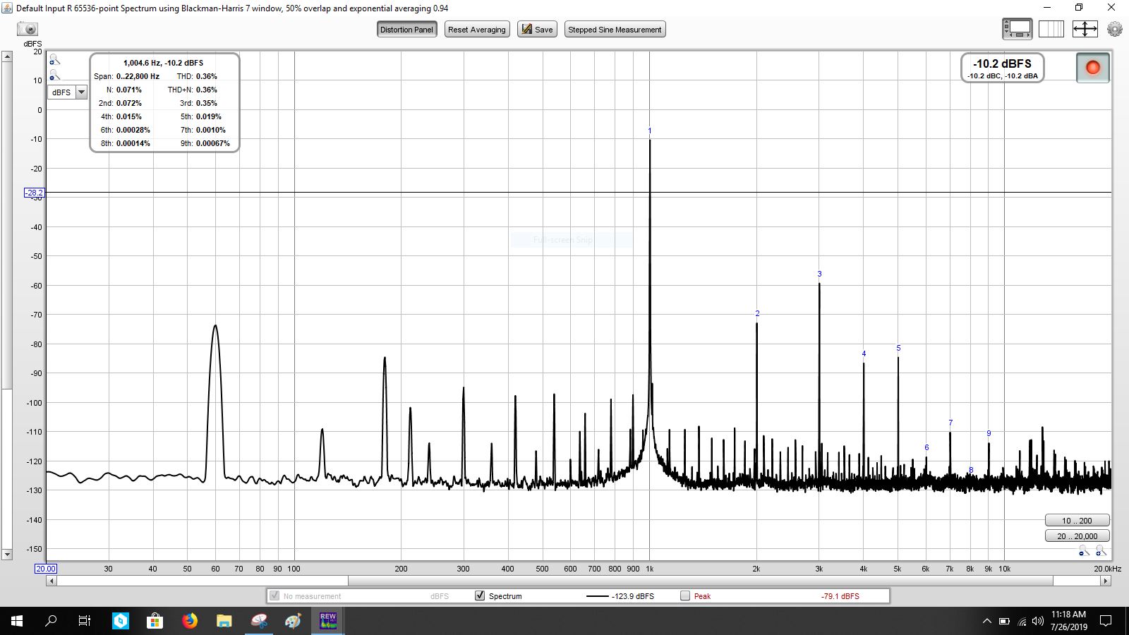

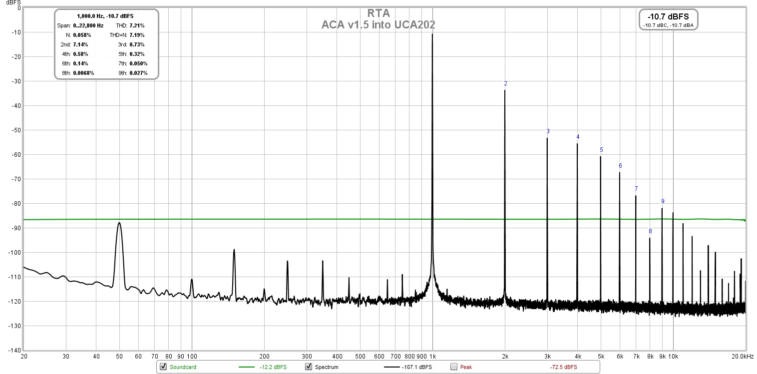

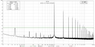

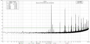

However, when I connect to an amp, I seem to have problems in that the harmonics are way too high. I tried first with the ACA 1.5, then tried it on a Denon RCDM39 which is my kitchen music player.
Voltage across the resistor is 2.730V
Graph controls for the RTA are the same as those in the first post in this thread
Any ideas where I’m going wrong?
