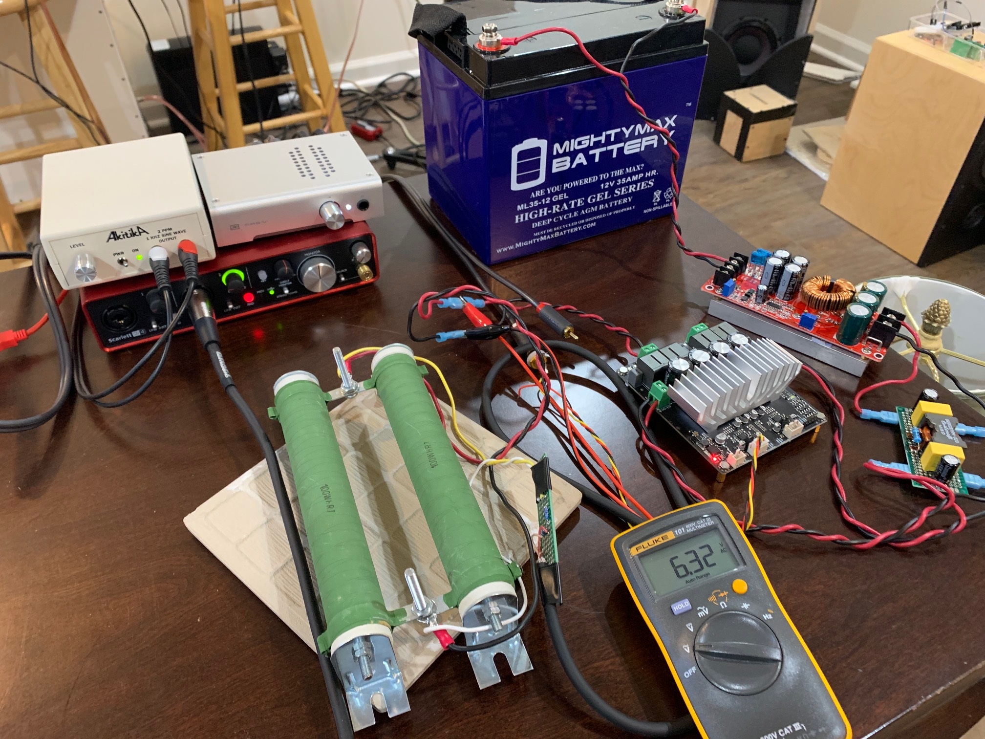

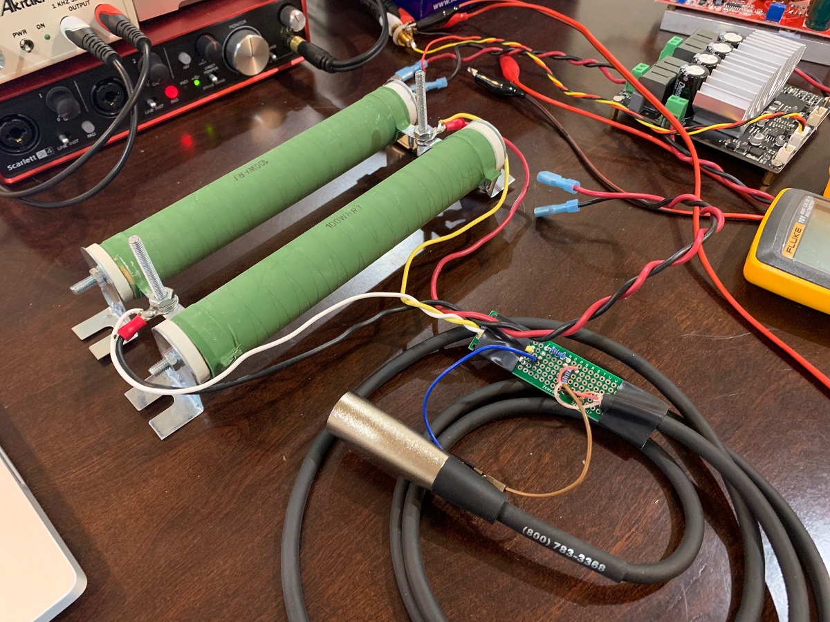

I just measured the distortion in my first Class D amp with REW and this setup. No low-pass filter. Using a 11:1 attenuator with 2k2 and 22k resistors on a small veroboard. I took a 6m XLR male-female cable and cut it in half and used the male end soldered to the veroboard.
Here is a photo of the dummy resistor rig (2x 100w 8ohm resistors for 100w 8ohms or 200w 4ohm load, voltage divider, and female spade connectors for connecting to amp under test, and XLR cable to got to measurement sound card:

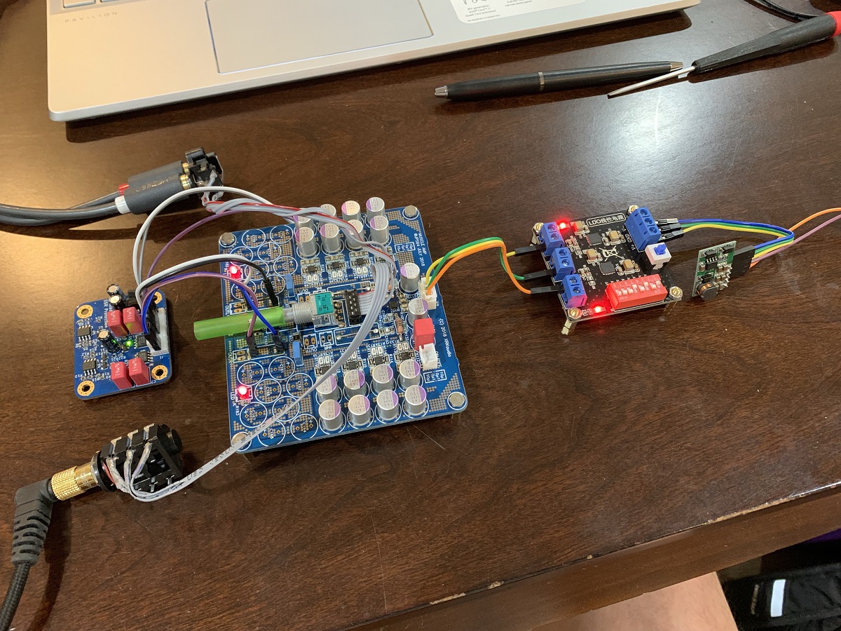

Here is photo of setup underway, I originally thought I needed a wall powered headphone amp for a preamp, but found that the Akitika had no problem driving the 3E amp to clipping since gain is set at 27dB, Without the Schiit M3 preamp, there was no mains 60Hz or harmonics:

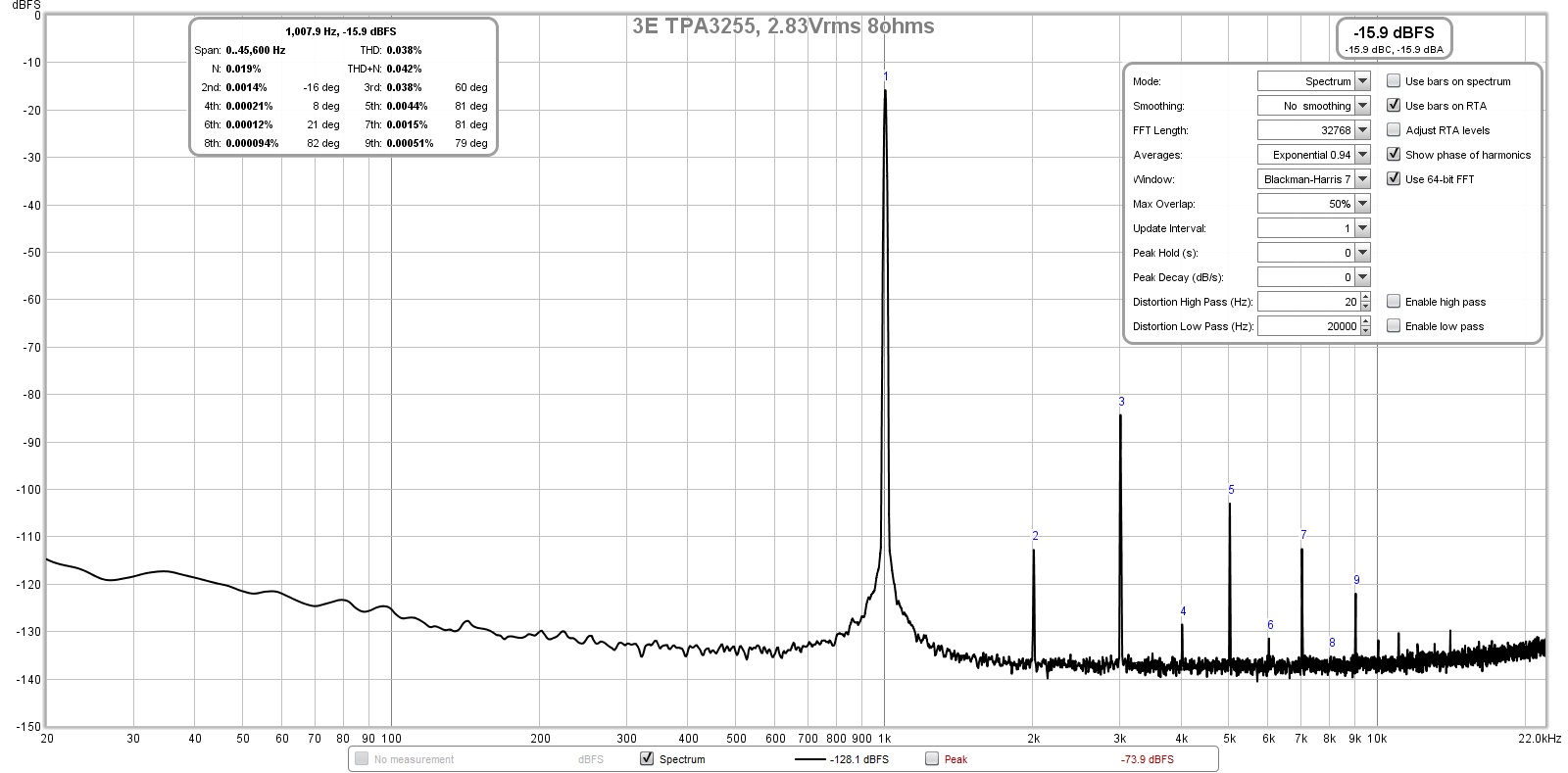

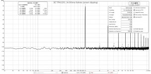

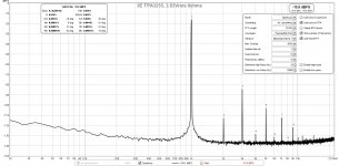

Here is FFT for 2.83vrms into 8ohms (1w):

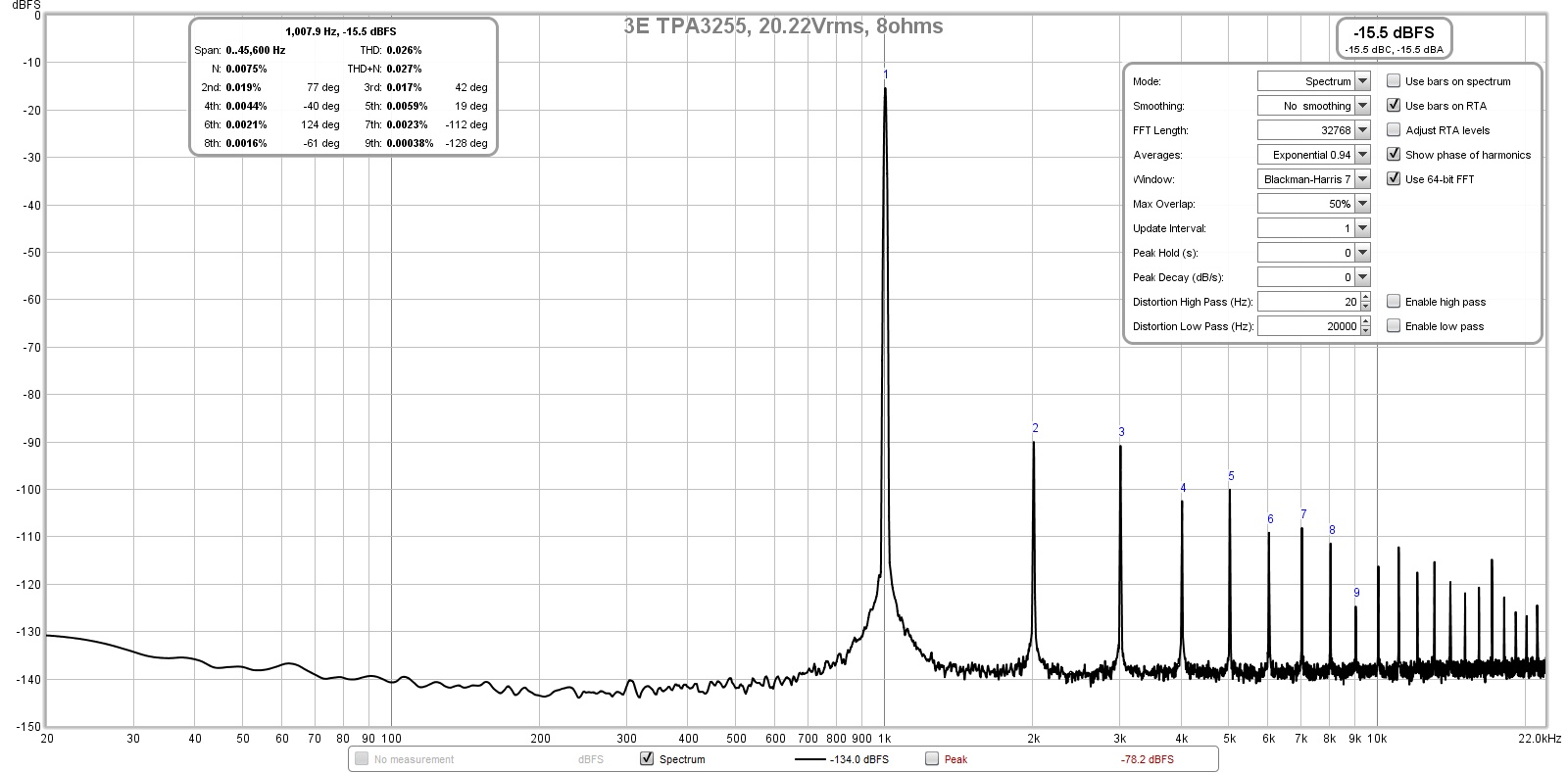

Here is FFT for 20vrms into 8ohms (50w):

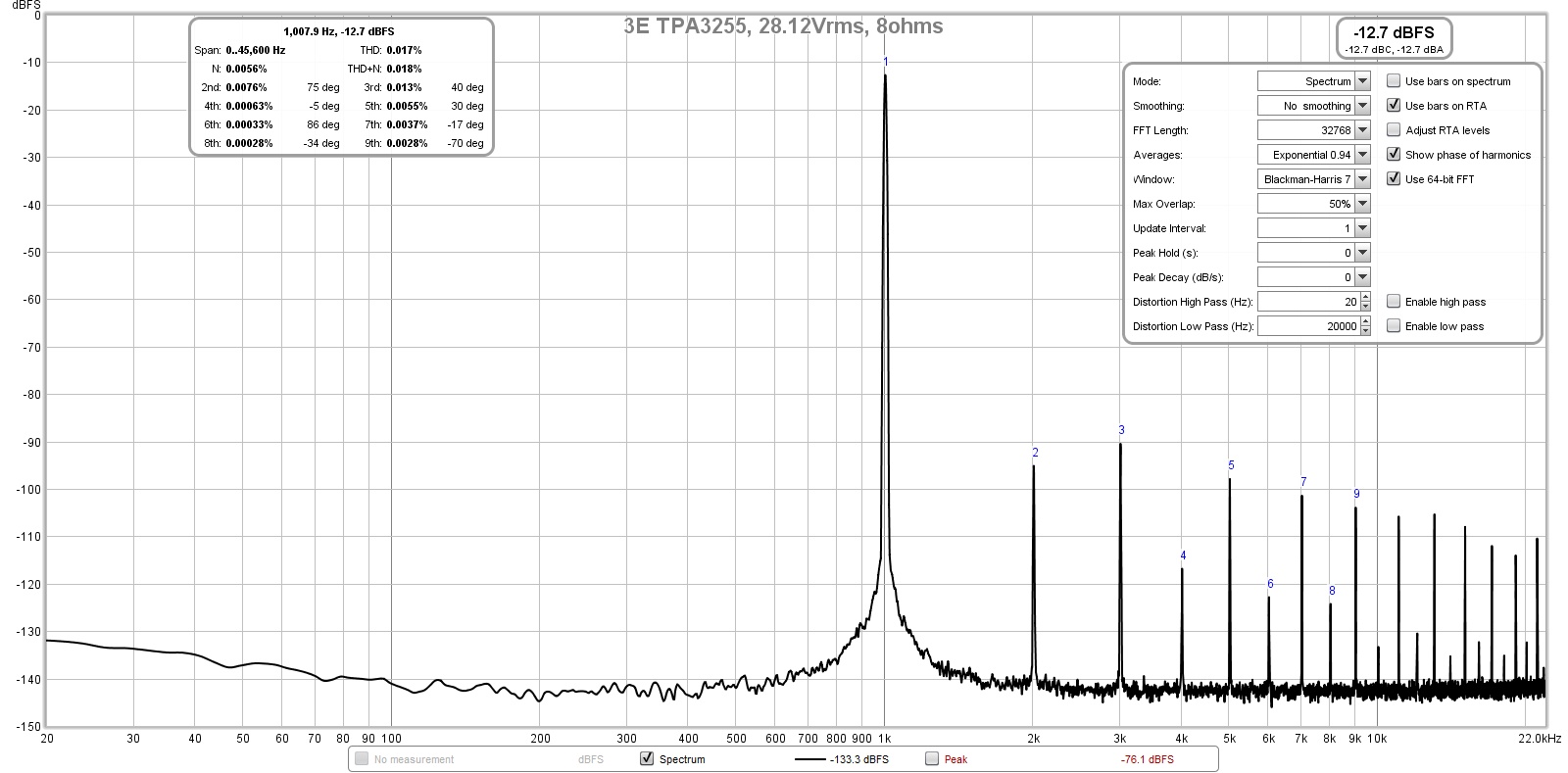

Here is FFT for 28.3vrms into 8ohms (100w)

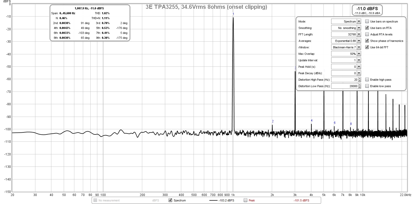

Here is FFT for 34.6vrms into 8ohms (150w) and onset of clipping (note how noise floor rose up):
The TPA3255 is powered by a 1200w DC-DC step up from a 12v 35Ahr lead acid gel cell battery. Note the total absence of mains line hum or harmonics. It is very quiet this way.

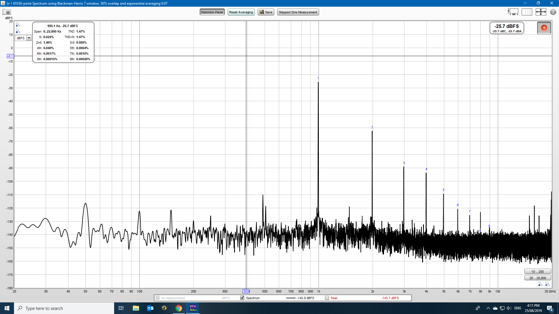

I just stumbled across this chap (quite possibly a member here?) who, inspired by this very thread, decided to dip his toes into the treacherous waters of DIY loopback measurements:
https://enjon.uk/2019/09/01/a-diy-approach-to-distortion-measurements-for-audio-amplifiers/
I thought it would make an interesting illustration of the pitfalls to be encountered by those unfamiliar with the terrain.
1. He decided to use an existing Behringer UCA202 - which unlike the Focusrite used by xrk971 only features an unbalanced input.
Do I hear somebody say Uh-Oh there? That's right, it's ground loop time. The signal is sent round in a loop, and so is the ground. See the mains harmonics at -70..-80 dBFS in his graphs? Dead giveaway.
So how do we fix this? Should be easy enough here - inside the attenuator box, replace the black wire going to output RCA ground by a resistor of somewhere around 1 kOhm (value not critical).
A balanced input would have provided some common-mode rejection, but here there is none.
2. Maximum input level on the UCA202 is ca. 1.25 Vrms. Together with a ca. 12.7 kOhm input impedance, the 22k/2.2k voltage divider just barely covers the nominal 25 Wpc (14.14 Vrms) of the Cambridge Audio A1 used for testing, but would have to be changed for anything beyond 30 Wpc.
3. The Aneng AN8008 used for level calibration is a TrueRMS multimeter with a -3 dB bandwidth of ca. 3 kHz. Assuming that's a 1st order response, this would mean that amplitude reading on a 1 kHz signal would be about 5% or 0.46 dB out. Nothing major, but the displayed 2.830 V may actually be closer to 2.983 V. Cross-checking with a lower frequency like 100 Hz and computing a suitable correction factor may be advisable.
4. The UCA202 ADC actually isn't that much to write home about, with a fair amount of periodic ripple gracing its frequency response and and dynamic range in the 80s of dB. Better than nothing but not exactly "measurement grade".

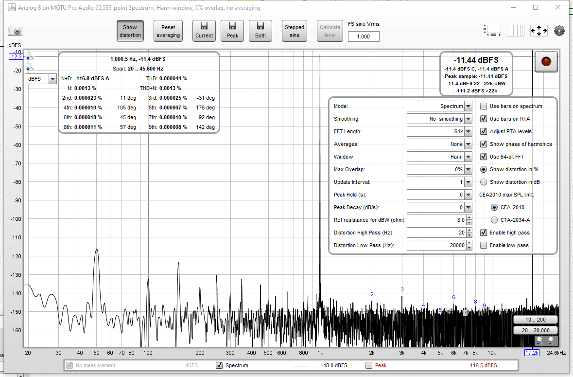

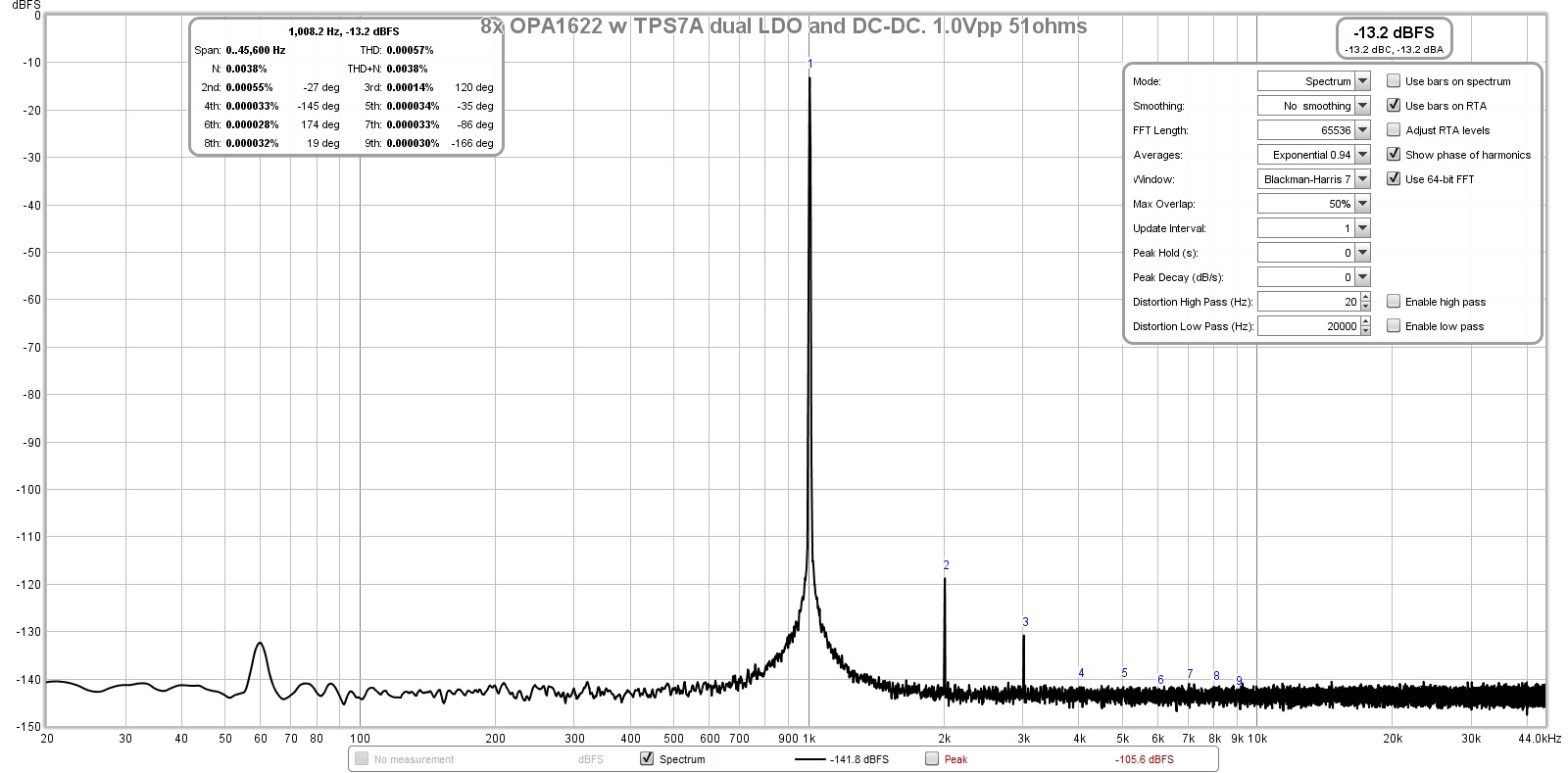

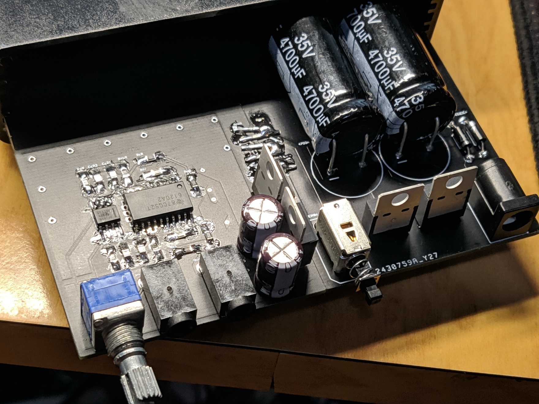

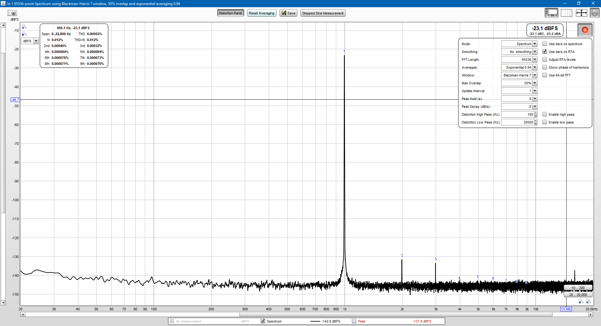

8x OPA1622 Headphone amp powered with eBay TPS7Axxx dual rail +/-18v PSU and +/-24v DC-DC step up from 12v battery.
For 1.0Vpp into 8ohms, getting clean -130dB noise floor and 5.7ppm THD with mostly H2 and H3.
