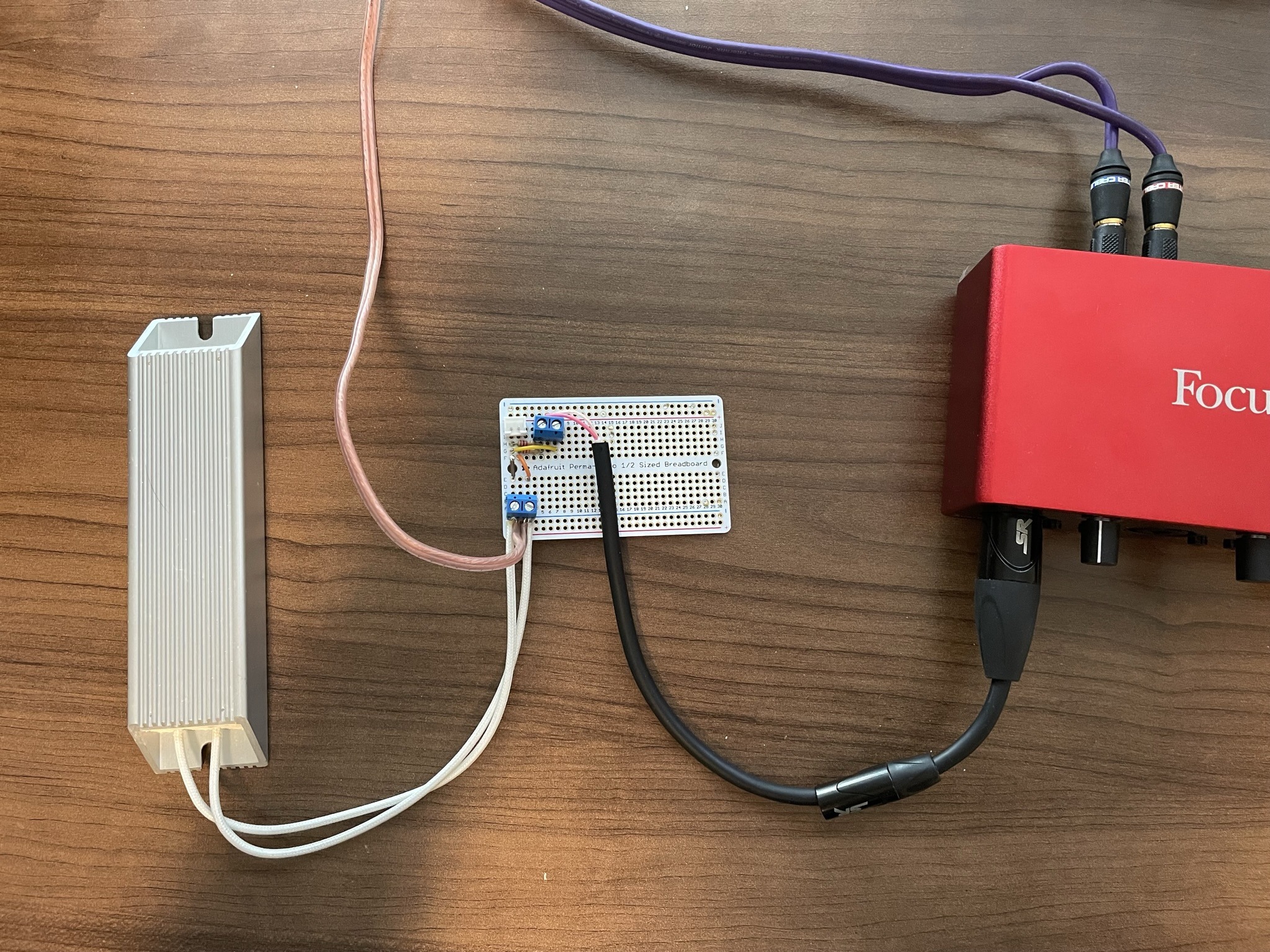

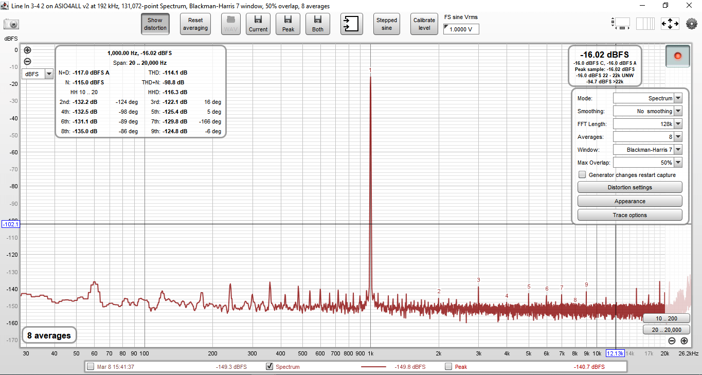

Thanks for this thread, helped me get started with measuring my progress on an old Marantz I'm restoring. I am hoping to get a little "best practices" type advice generally around measurement repeatability/reducing environmental variables. For instance, I noticed with this Marantz hooked up to a Focusrite 2i2 with a TRS-RCA cable (per RANE 10b, tip to RCA center and sleeve to RCA barrel), regardless of 2i2 output knob position I was audibly picking up a couple AM radio stations when Marantz volume knob was maxed out. With an M-Track Solo (RCA outputs) this didn't happen. With a TS-RCA cable on the 2i2, it seems to have been at least partially mitigated.
In any case, things like AM radio being picked up by the amp inputs doesn't instill confidence that I'm going to have repeatable results hour-to-hour or day-to-day. Some maybe some of the questions I have are:
- Best cable setup to use for class-2 non-earth-grounded devices with RCA inputs when the 2i2 is generating the test signals? (desktop PC with earth-grounded USB)
- 2i2 output vs input levels, especially when measuring low output levels from the DUT (e.g. -48dBu)? Seems like 3-oclock on output knob and then adjusting input to get good input resolution is working well to reduce noise.
- Should I use low-pass and high-pass filters for distortion measurements, especially if running 2i2 at 192kHz? (e.g. 10Hz and 22kHz).
- Cable/shielding setup for the 2i2 input to get from speaker terminals, through voltage divider, into the 1/4" TRS or XLR on the 2i2 input? Proximity of my breadboard voltage divider to other electronics (e.g. computer monitors) makes an instantly noticeable difference on the RTA plot.

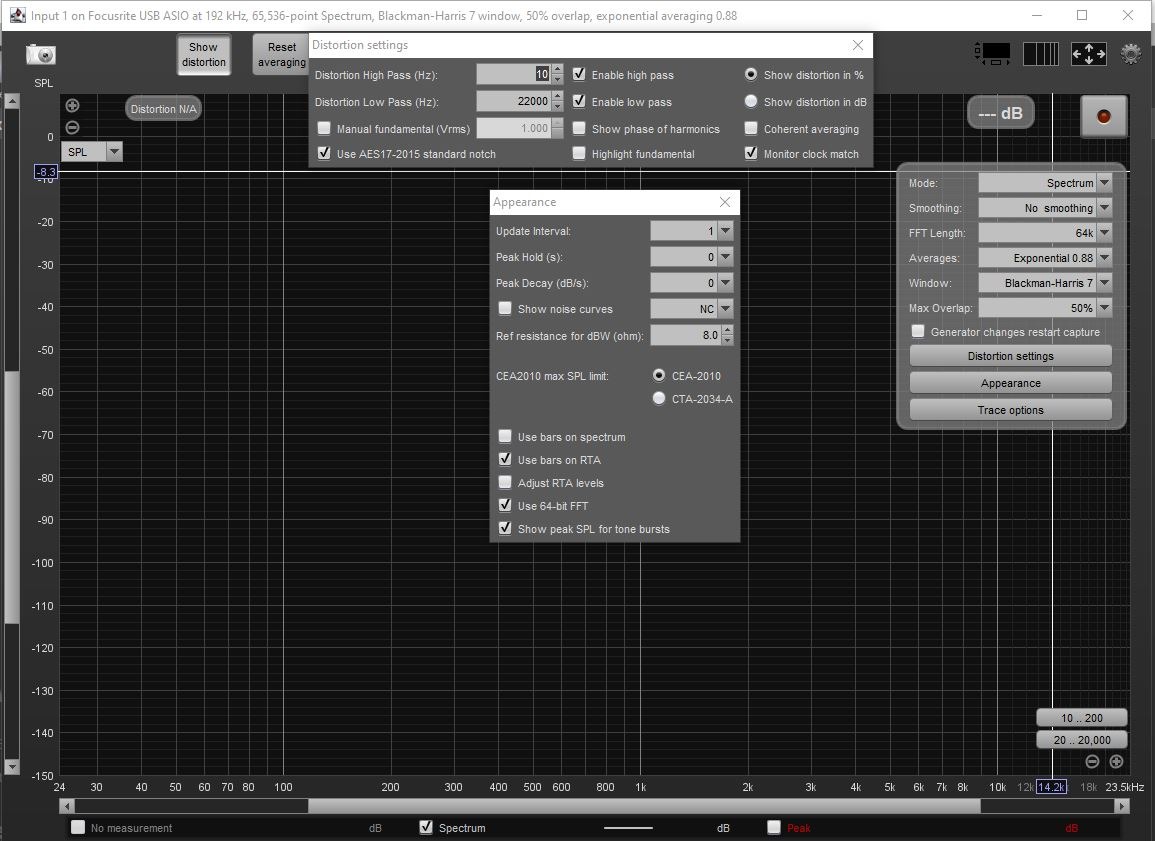

- RTA settings? Currently using the settings shown below.
Sorry, I should have been more specific- it’s a 2220B integrated amp/receiver. It does not seem to be AM leakage in the mode switch, moving the tuner doesn’t change anything, seems to be getting picked up in the RCA cables (I’ve heard this is relatively common in guitar amps for instance).
Will give the pin 1-3 connection a try, I will post a few measurements shortly to show where things are at so far (I don’t think they’re bad, just want to make sure I’m doing what I can to minimize external factors).
Your description suggests that the Marantz has a wide bandwidth which may cause issues when it's connected to your test setup.
When I use my Focusrite for testing, I use a PHONO to TRS adapter at the input, to ensure my grounds are all at the same potential.
You could also try a small series resistor with a parallel capacitor at the input of the Marantz (not in the amp, but in the cable where it plugs into the amp) - 100 ohms with a 220pF cap should do, and won't affect your measurements. I know that some of these older amps used to have a wide bandwidth so that wouldn't be helping if that's the case.
It's also important to keep your interconnects as short as possible, to avoid stray capacitance.
With respect to suppressing measurement quirks (eg. from pickup of external signals, and even from your interconnection scheme), it can be worthwhile noting a few aspects:
- use a large metal tray (or similar metal screen) with the 2i2 and divider and load and as much cabling in the tray, and with any external device like the amp being tested placed nearby, such that cable runs are as short as possible, and screened where possible by the metal tray. The tray may benefit by being linked to the 2i2 ground, or cable screen. Another tray over the top can also help - I use large 'BBQ' trays of aluminium.
- Turn off all nearby lights and equipment to see what affect they may have - I certainly have a noisy LED lamp.
- the 2i2 forms a gnd loop that goes to the amp input and the amp output - if the amp has a long and noisy internal link between its input and output sockets than that noise enters your measurement. Check with a DMM that the 2i2 has its gnds linked between inputs and outputs. You may benefit from not connecting the 2i2 input gnd at say the load divider, or alternatively at the amp input,
- use a laptop to connect to the 2i2 to avoid mains powered earth loops and noise.

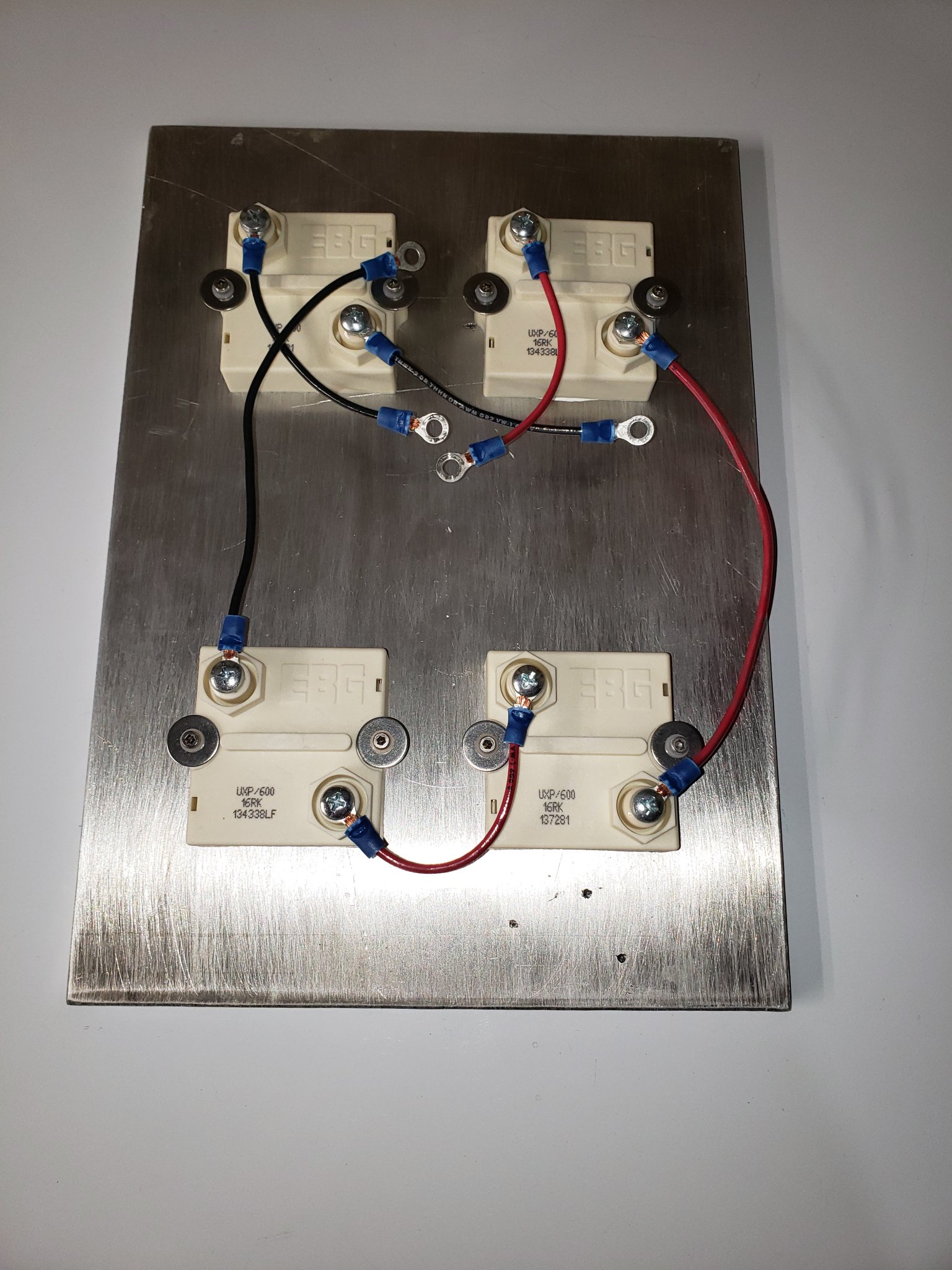

FYI... those cheap Ebay load resistors are extremely inductive they will wreak havoc with your THD measurements especially at high frequency. Please see the attached image for the ideal setupThanks for this thread, helped me get started with measuring my progress on an old Marantz I'm restoring. I am hoping to get a little "best practices" type advice generally around measurement repeatability/reducing environmental variables. For instance, I noticed with this Marantz hooked up to a Focusrite 2i2 with a TRS-RCA cable (per RANE 10b, tip to RCA center and sleeve to RCA barrel), regardless of 2i2 output knob position I was audibly picking up a couple AM radio stations when Marantz volume knob was maxed out. With an M-Track Solo (RCA outputs) this didn't happen. With a TS-RCA cable on the 2i2, it seems to have been at least partially mitigated.

Here's a photo of my test setup, at the moment I'm use a TS-RCA adapter on each output since it seems to have been the most effective at rejecting the AM radio interference (though not rigorously tested!). Speaker negative terminal connected to XLR pin 3, 2.2k/22k voltage divider to XLR pin 2, XLR pin 1 not connected to breadboard.

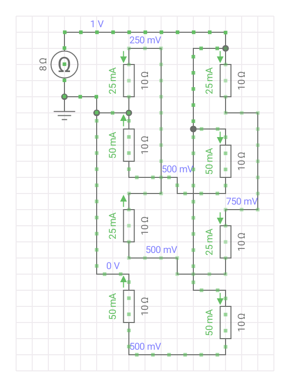

These are 10 ohm resistor wired up a few in series and parallel to achieve 8 ohms.
https://www.ebay.com.au/itm/2541988...kHVuHCkQuC&var=&widget_ver=artemis&media=COPY
REW does a good job of measuring the impedance of test loads over the measurement frequency span and should be able to confirm what frequency span is allowable for a test load resistance. There are many ways to prepare a test load, and even compensate for inductive phase shift (I've done that for a few test loads including a precision manganin decade box) - I recall a thread here on compensating the ubiquitous white ceramic 10W WW resistors.

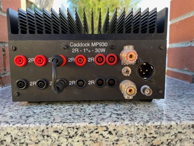

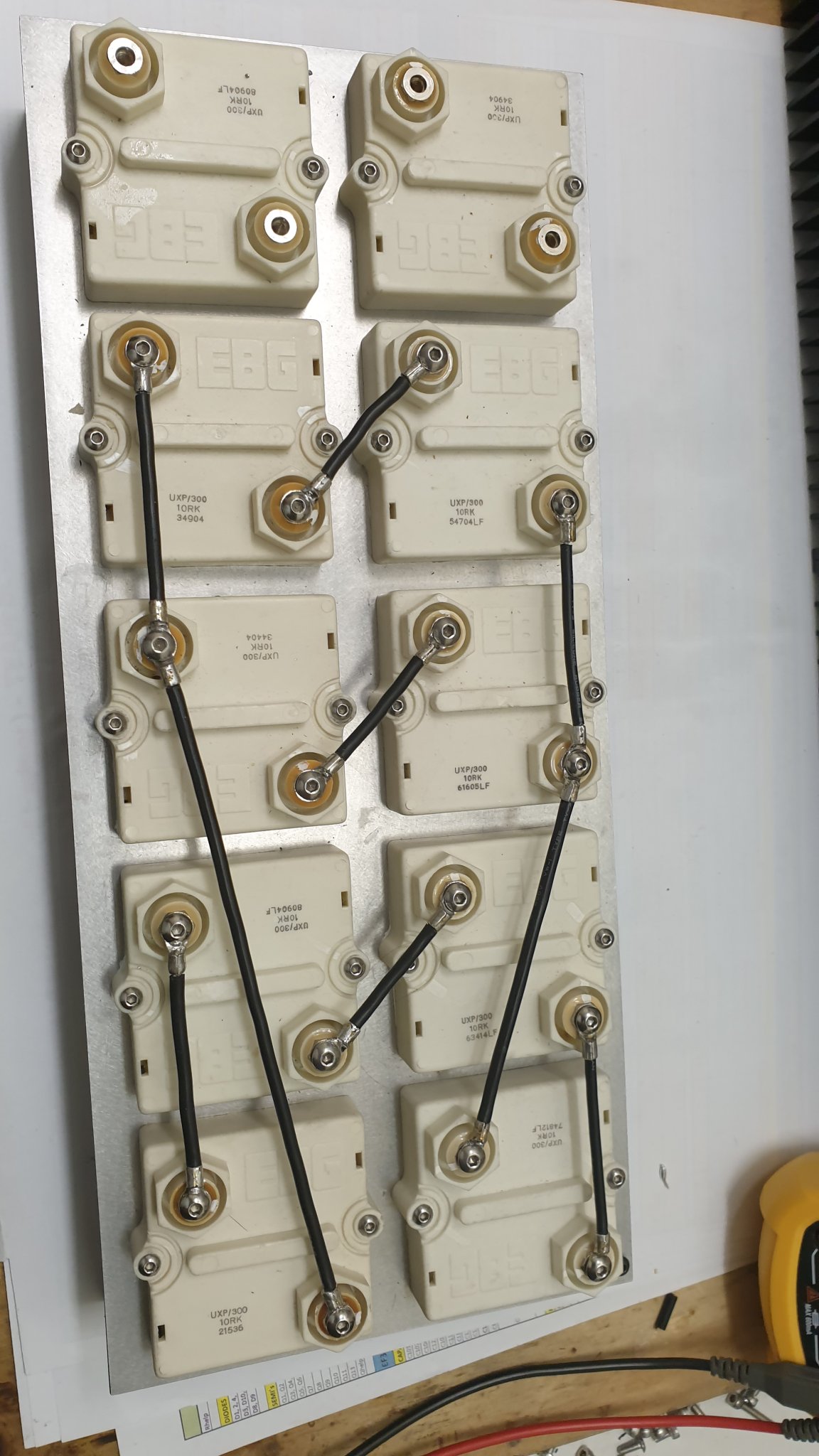

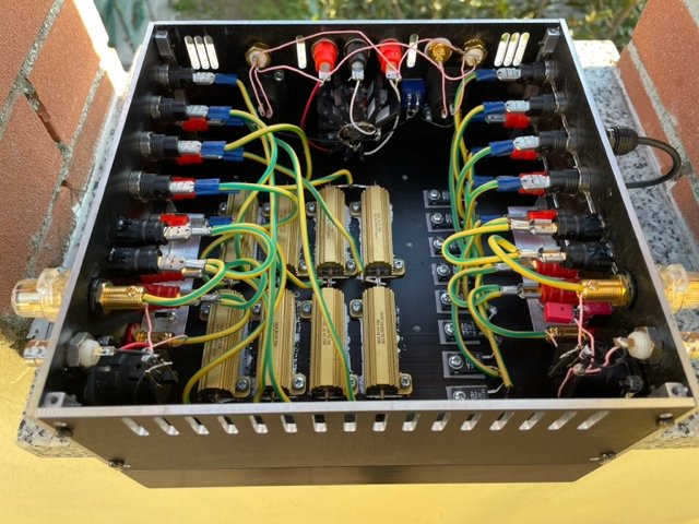

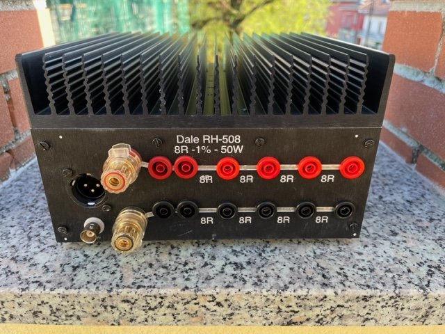

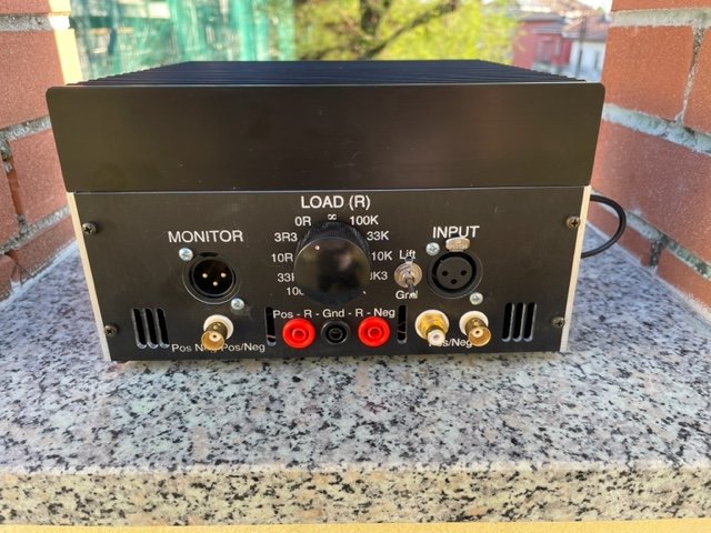

I got tired of having a box of test loads so I pulled myself together and made myself a simple "Load Cube" that takes care of essential all my needs: power supplies and power amps as well as line-level projects. Resistance set using one (or more) external "jumpers". Easy interface with measurement equipment. Shielded.
Non-inductive Caddock MP930 (1%, 30W) for power-amp testing (2-16R range in 2R steps). Switch for parallel 100nF to test for stability with capacitive loads.
Dale RH-508 (1%, 50W) for power supply testing (8-64R range in 8R steps).
Symmetrical load for balanced and SE line level sources. Caddock MP930/915 resistors, Greyhill rotary switch (2 deck). 0R3 to 100k range.
