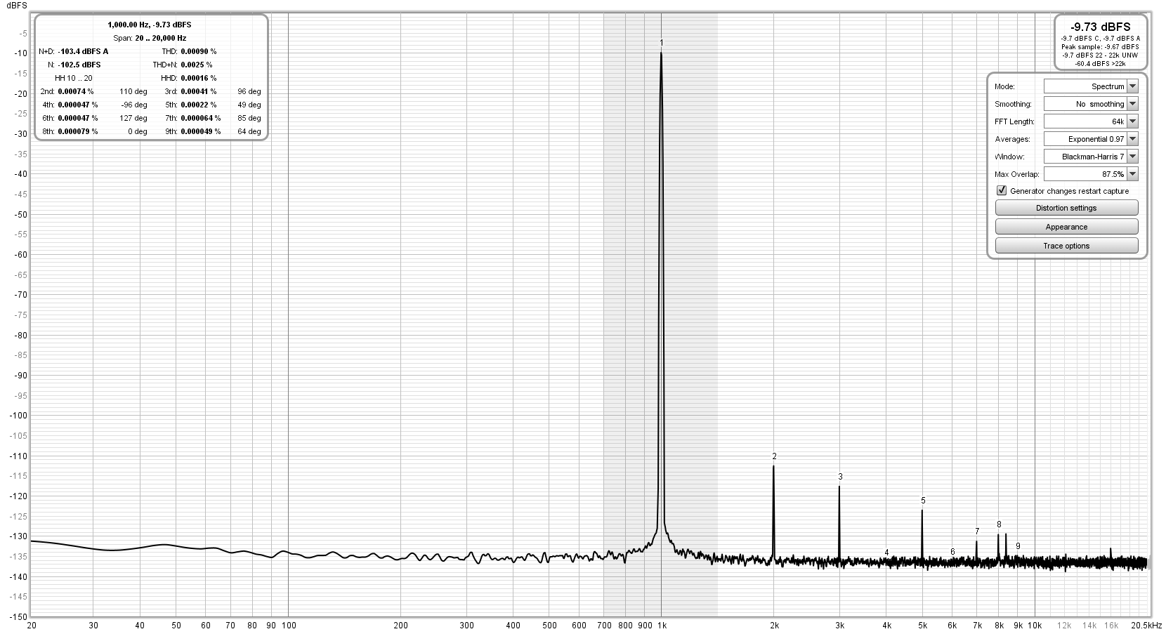

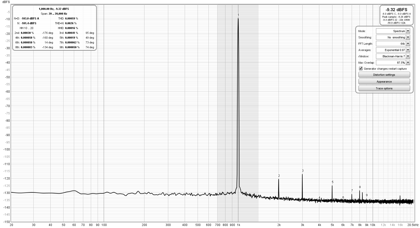

That seems to be a 16-bit measurement. Choose ASIO or WASAPI exclusive drivers for more than 16 bits.
BINGO!
Not sure how I knocked it to JAVA but switched back to ASIO and I get the following both channels .747Vrms input
That seems to be much better aligned with results I have seen on this thread with the 2i2. Thanks for the feedback, I knew it should be able to do better. Now to test it on an amp later today after I get some calibration data collected.

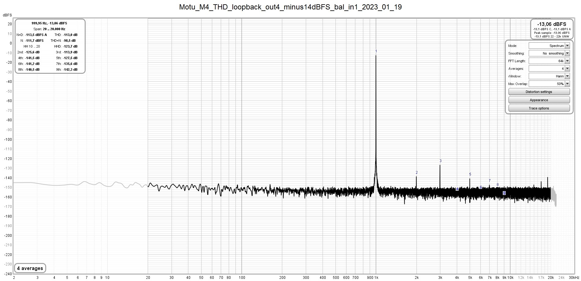

My Motu M4 loopback measurement with inbuild DAC output looks like this, so I do not see a reason to buy a low THD-sine wave generator. This is the THD sweetspot, the THD+N sweet spot is found at higher signal levels around -106dBFS THD+N

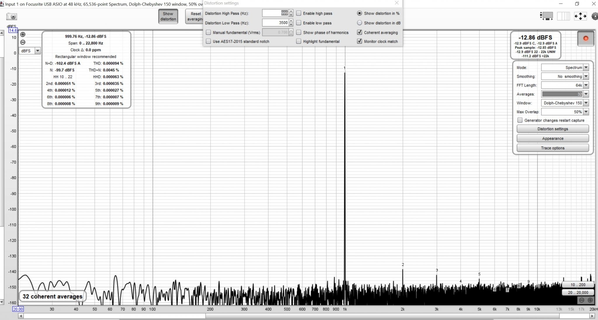

With Focusrite, usual loopback distortion is about 0.0003% or -110 dB, on condition of not using too much line-input gain and maximum generator output level.
There is a sweet spot with < 0.0001% or -120 dB, using settings from the picture below. ‘Lock frequency to RTA FFT’ signal generator setting is important. Position of gain and monitor knobs should be about 11 o’clock for line-in gain and 1 o’clock for monitor. At those settings, measured signal generator output was 0.775 V or 0 dBU. Changing gain or monitor levels, brings distortion to usual 0.0003% or worse.

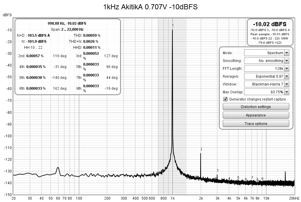

Tombo56 I can confirm similar results with a focusrite solo, although with lower generator levels. A calibration thing no doubt. I do find tho an external osc. such as Victors makes the results are little more stable / repeatable. I like having a known ultra low distortion source to eliminate one variable!

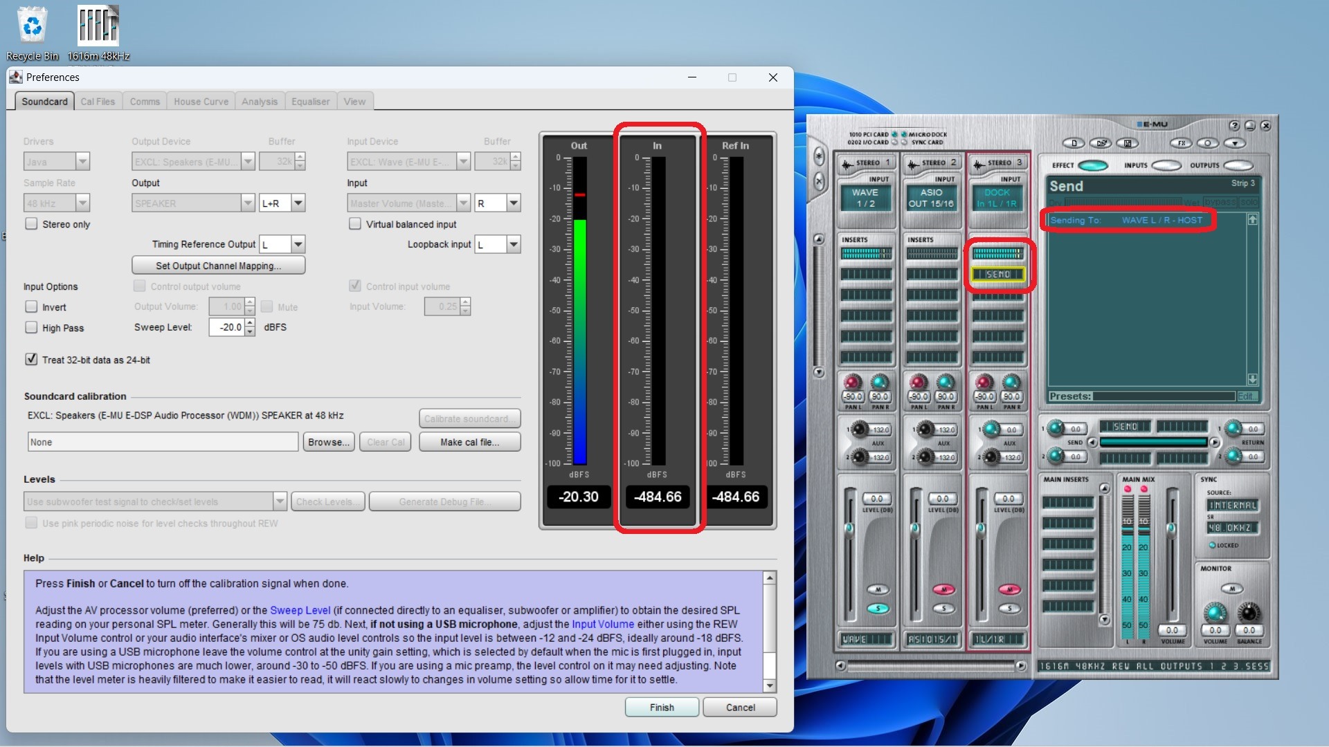

Dropouts seem the likely cause, worth trying the WASAPI exclusive option in the REW Java drivers (device names starting EXCL).
When using the EXCL devices names I can get an output to the E-MU 1616m but no input. See attached screenshot. The output (and loopback input) are visible on the peak meters in E-MU PatchMix but REW does not see the input. Not sure what I am doing wrong or perhaps WASAPI just doesn't work with the old E-MU 1616m. (I can get output but so far no input.)
