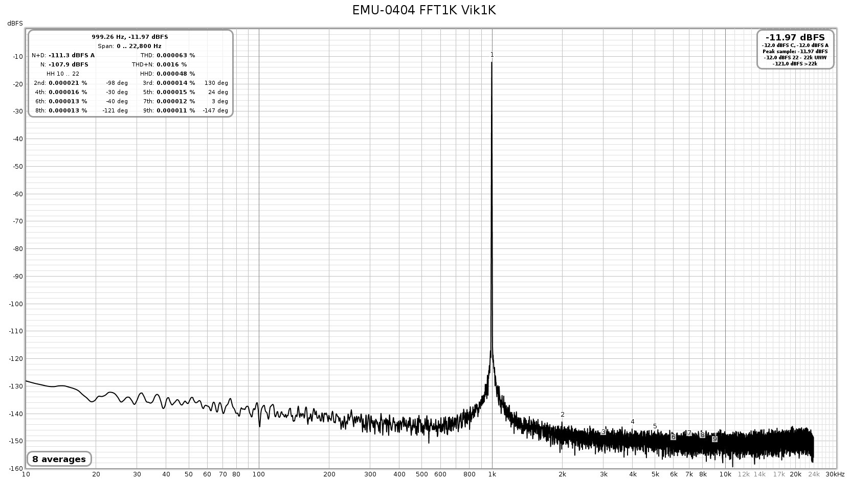

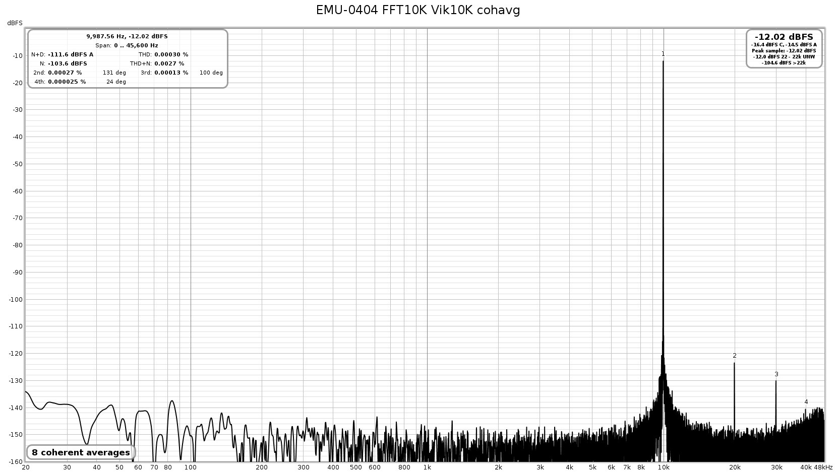

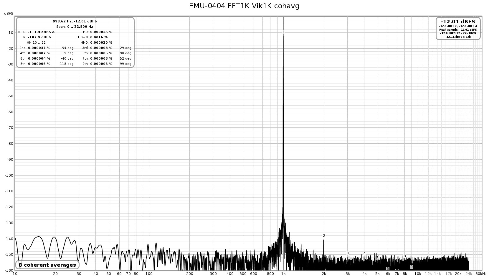

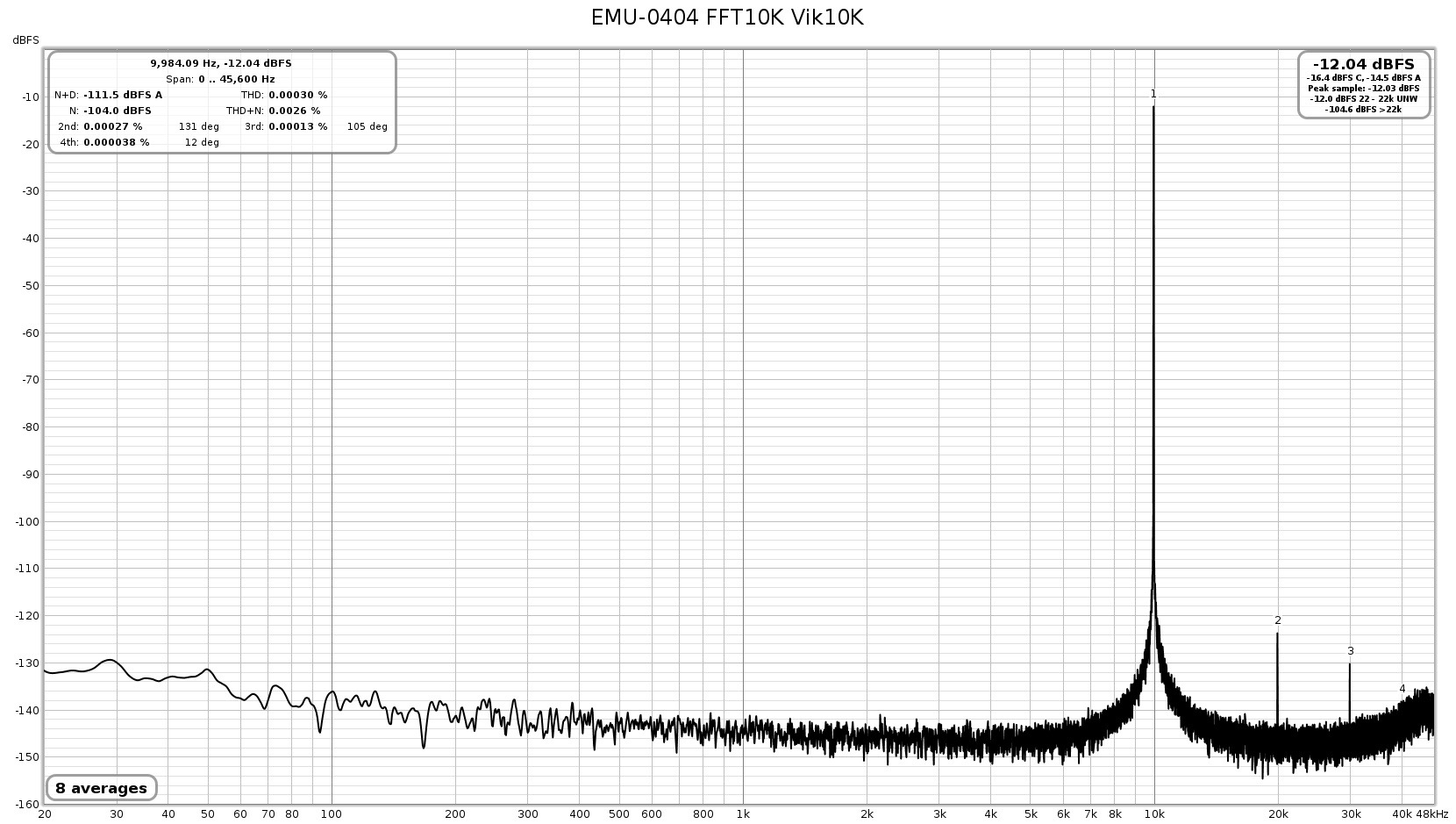

EMU-0404 (unmodified) feeded by 1k and 10k signal from Viktor's oscillator (unbalanced). REW is running on Orange PI 5 sbc (linux), EMU is powered by battery (cheap DC-to-DC converter, 12V to 5V)

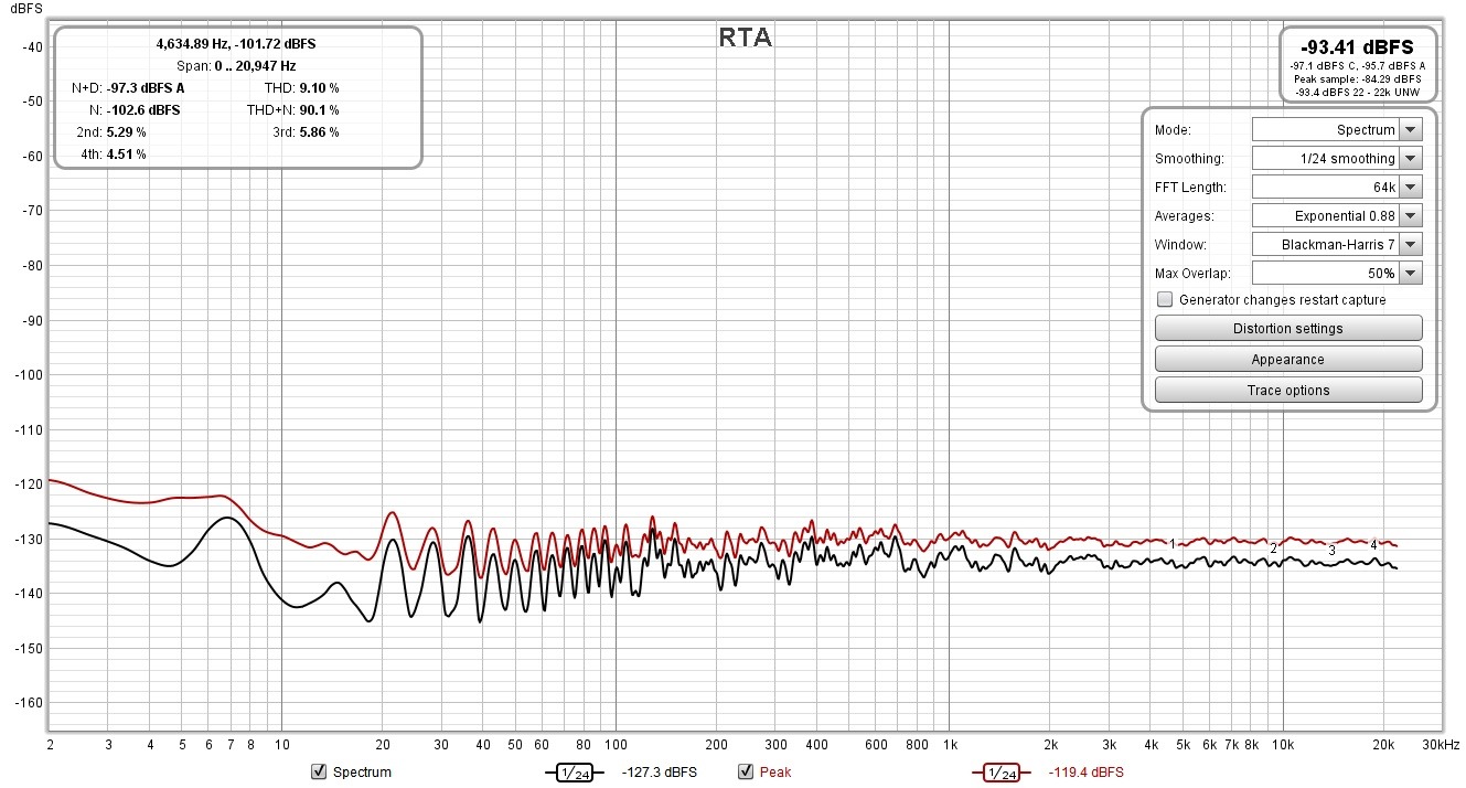

So after several hours (should have been minutes) I managed to get the 1sr gen Focusrite 18i8 to work in REW. This is just my first attempt using java not ASIO in the settings and running at 16 bit 44.1KHz. I couldn't get the Steinberg operating correctly. I will try tweaking the settings tomorrow but for now, does it look like it's sort of working ok?
kHz, its easier for others to assess when the setup (electrical and REW) is adequately detailed, and to try and follow an existing example setup used by others in this thread. Eg. do a simple loopback and use no smoothing, and compare to an existing example, then spend some time changing your settings (including aiming to use an ASIO driver) to get to know the soundcard limits and sweetspots, and prepare a comparison summary.
Reactions: kilohertz
I'd say you're well on your way. Try measuring the output of a signal generator. Play around.
You should also look at building an attenuator so you can scale down the output of your power amplifiers and also protect the input of your soundcard.
Thanks pinholer, I'm right now just trying to establish that baseline and get all the computer settings correct, REW setup correctly and know what the noise floor is. Imagine we are back on page 2 of the thread, that's where I am on the learning curve. 🤣
Thanks for the guidance.

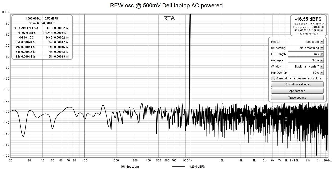

OK I think I am ready to start playing with external tests, amps, preamps etc. having successfully made a good sweep.
This plot is using my Dell laptop, WIN10 on AC power, in loopback using the internal REW osc. @ 1KHz and 500mV. ASIO 192KHz sample rate with my new Focusrite Solo. I haven't experimented with settings to find the sweet spot but for my purposes, mainly working with tube amps currently, this will suffice. Amazingly low distortion, .00082%, how do they do that? 😱
Are we there yet?
Cheers

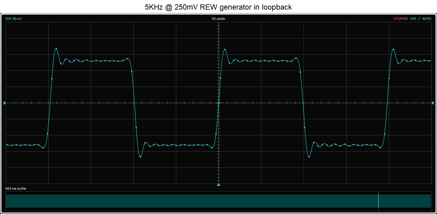

I tried generating a square wave in REW and using the scope to look at the wave. It's 5KHz 192KHz sample rate 250mV, FR Solo. Is this normal? I have tried running the "calibrate function" a few times which is supposed to remove the effects of the Solo itself, doesn't seem to be working.
Maybe best to use external square wave gen for square wave testing?
