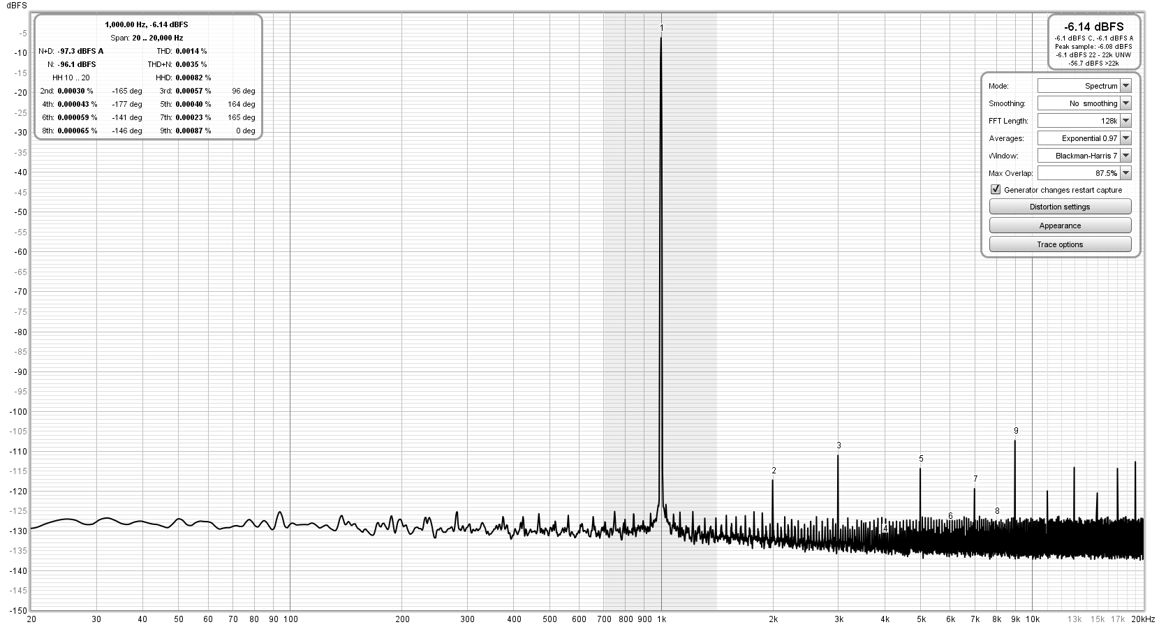

In an RTA window with the 'Show Distortion' button active, and the soundcard generating a sine input (that is FFT locked to the RTA), and the soundcard inputing the amp's output, then the distortion harmonics are numbered and the measurement display box shows the HD levels and the phase can also be displayed (check box in RTA settings for Distortion settings). Example for a loopback RTA display below showing HD's and their phase measurements.
The Scope display only shows the amp's output signal. Likely that you would need a notch filter after the amp, and then to have that as input to the soundcard to display the HD waveform, although I 'see' more in a spectrum plot than I do in waveform.

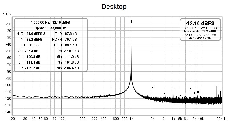

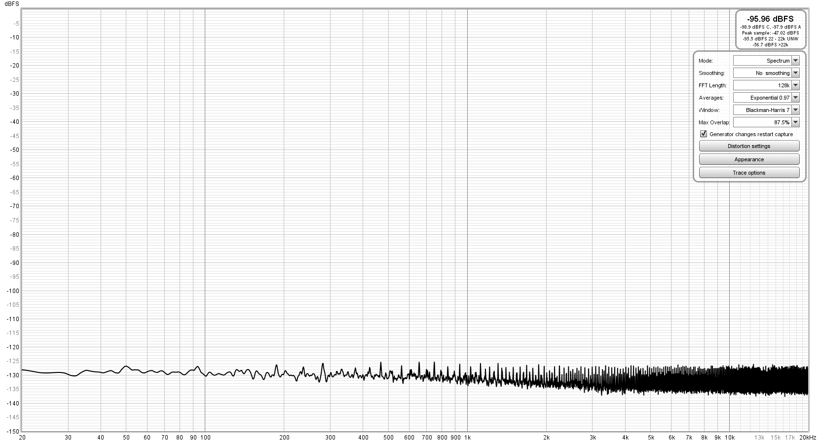

Measurement Set-up
Dell Optiplex i5 Desktop with 2i2 USB Soundcard. Direct Loopback Using REW Signal Generator calibrated.
Self Noise:
and 1kHz
A bit of grass but I am thinking that this isn't too bad considering I am using a desktop PC and not a battery Laptop. Any thoughts?
A laptop has benefit when using the 2i2 to measure a mains powered item of equipment. A self powered setup, like your loopback has no direct earth loop path to cause some hum ingress, however a clean sweep like yours does show the loopback cable and local setup is ok.
Also your harmonics and other artifacts appear to be nominal, so hopefully the other channel is similar. It can be worthwhile measuring the actual Vrms used for the loopback, and vary the signal levels so that you become aware of when distortion levels rise.
I will be checking other channel today. I need to put the Vrms in the notes for the plot(s). In this case it was 0.714 Vrms. Find that the 2i2 has more THD when > 0.74 Vrms, particular increase in the 2nd. Noise floor jumps when gain is increased to accommodate signals < 0.69Vrms and maintain -6 to 10DBFS on RTA.
