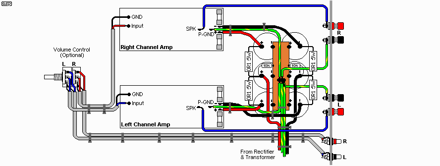

Do you recall modifying the termination points of the wires coming from the rectifier, and the starring of 0V wires to the amp modules and speakers - that are shown in the wiring diagram as going to the mid-point of the capacitor bank 0V bus, and to just the middle capacitor terminal posts? Imho, changing those termination points would mainly account for the before/after spectrum plots, and the insertion of 0.1 ohm resistors would be more the icing on the cake.
Agree with the ground wires not optimum.
The connection of ground from rectifiers to copper ground plane should stay as-is.
The ground from PS to right board should connect to the end of the right side of the copper ground plane. The ground from PS to left board should connect to the end of the left side of the copper ground plane. This places the amplifier ground at the power supply filter outputs instead of the power supply filter input, where the ground is "dirty". The positive, negative, and ground wires for each channel should be twisted together to minimize loop area.
The speaker grounds wires should connect to the ground at their respective channel boards, and twisted with their respective speaker signal out wires to their output jacks. That would minimize loop areas.

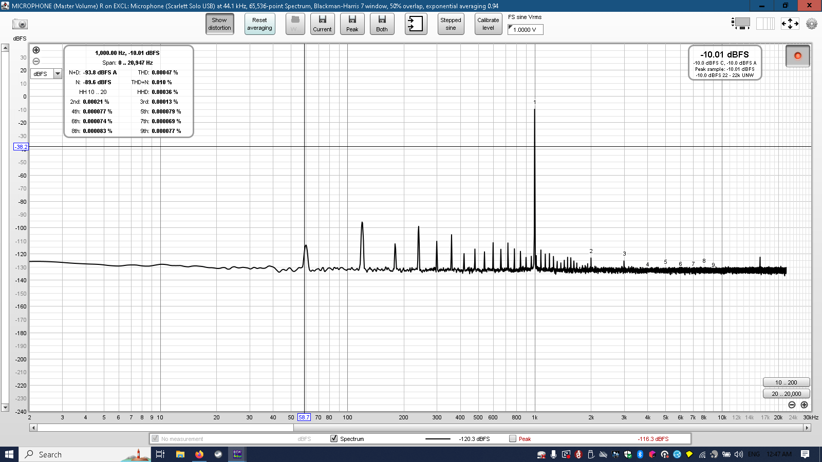

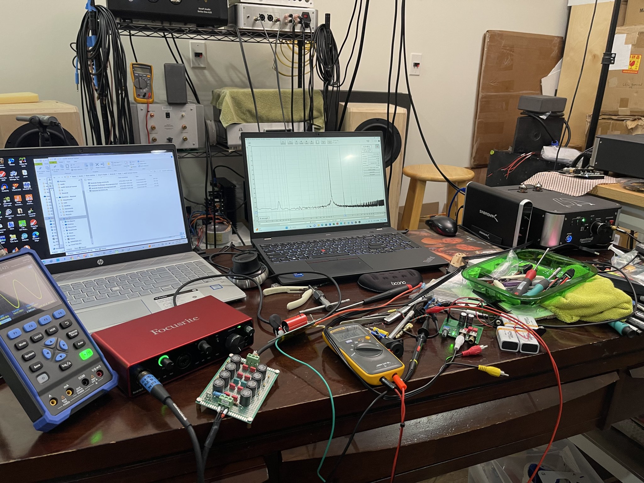

I just tested a hybrid headphone amp with a TPA6120A2 output buffer and E88CC tube buffer stage and used my trusty REW setup with a Focusrite 4i4 3rd gen audio interface, Victor’s 1kHz oscillator, and my usual balanced input signal divider rig. The headphone amp measures nicely and I was pleasantly surprised to find that 293mW into 33ohms produced a rather pleasing harmonic profile. The background noise with inputs shorted also showed a great low baseline noise level.

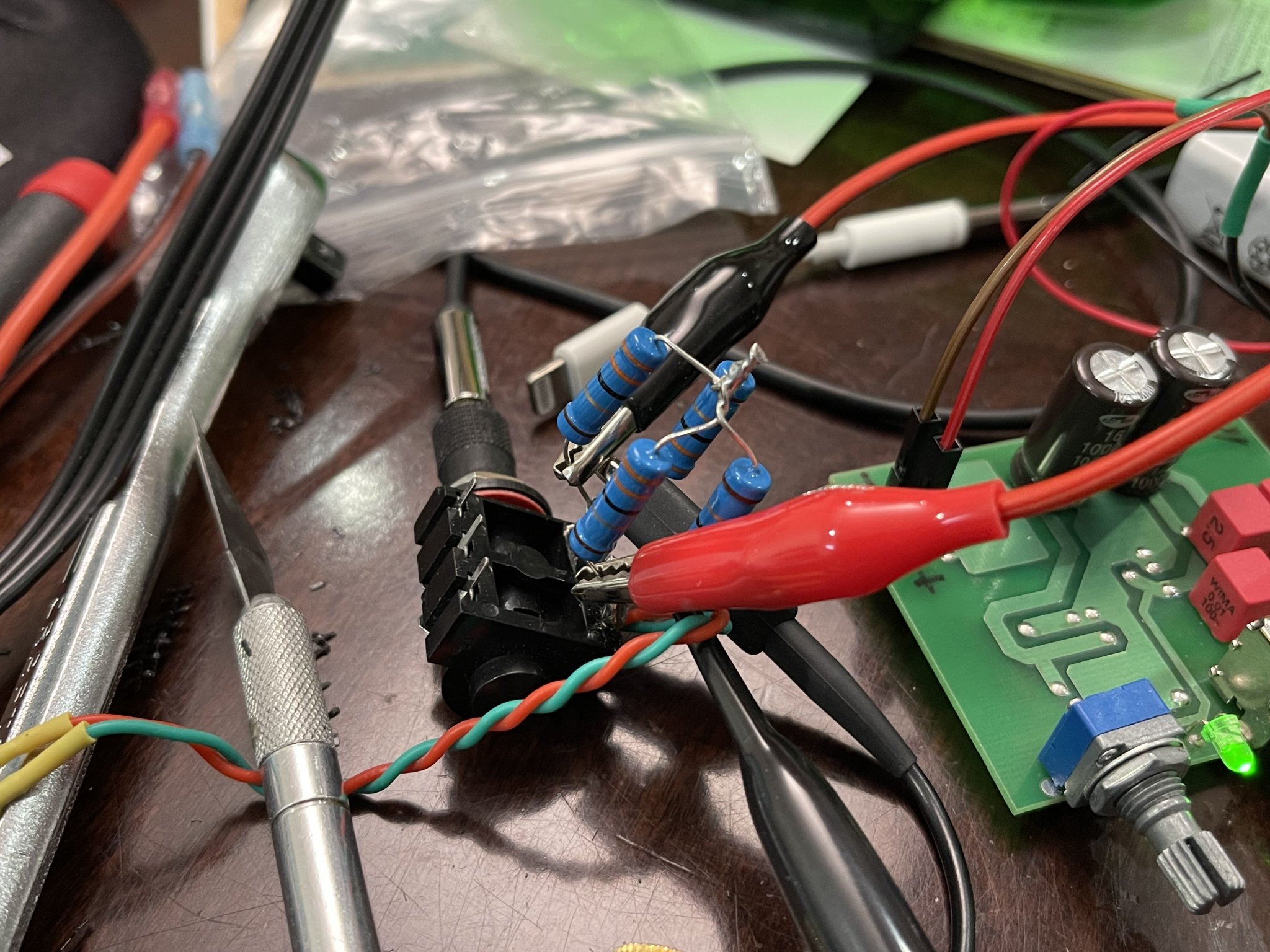

Here’s the setup:
This is the 33ohm dummy load made from 4 series-parallel 33ohm 2W metal thin film resistors:
Here is 293mW into 33ohms:

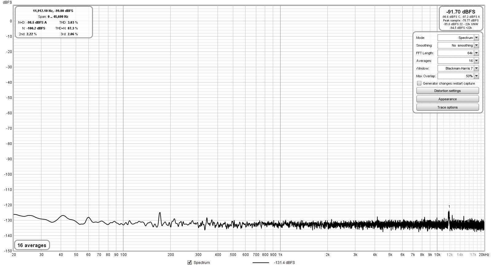

Background noise with inputs shorted. -10dB is 1.0Vrms for reference:
Here’s the setup:
It’s really cool to be able to test the audio equipment you own. It took me some time to build the cables to connect my Focusrite Scarlett solo 3rd gen and the dummy load, but testing was easy and fun.

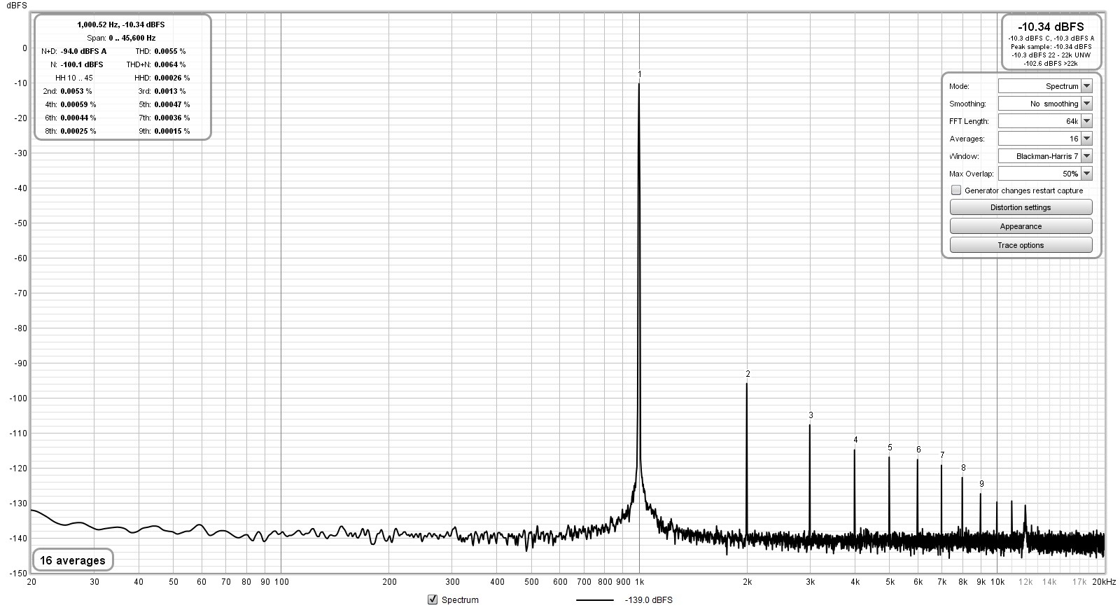

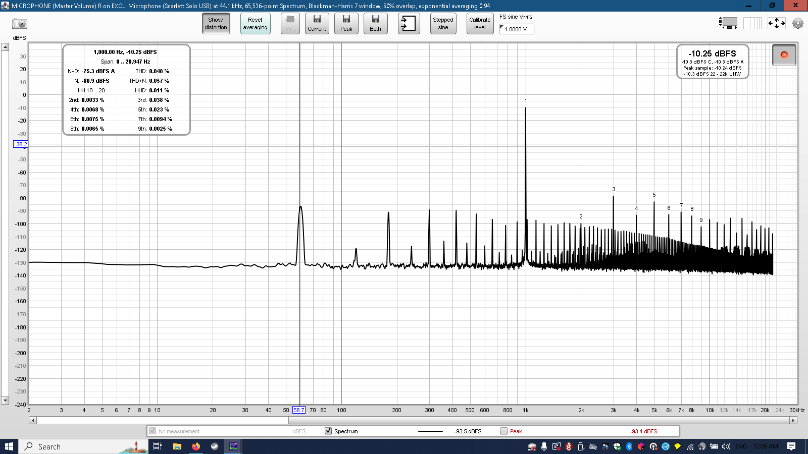

I have an old DAC with a headphone amp that I bought like 10 years ago, Matrix Cube. I tested the headphone amp and I think it measures OK.

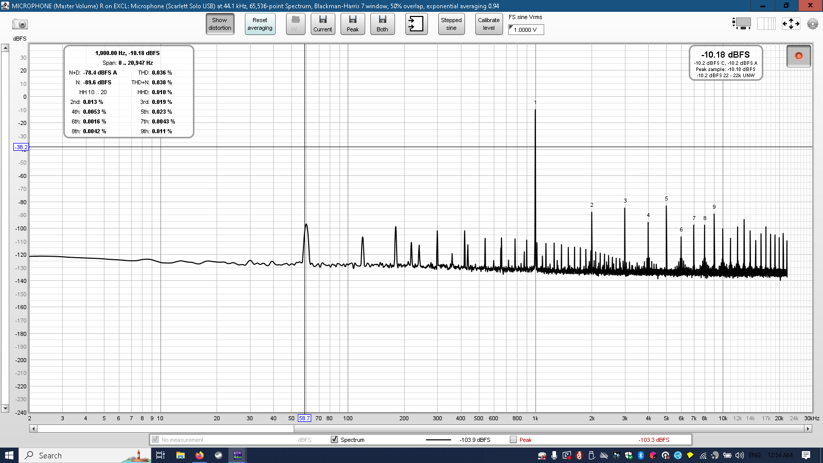

My old Yamaha RX-V650 in pure direct mode measures below specs for 1W into 8 ohms.
I’m a little disappointed by an amp that I build myself using Kaltecs Ultra-Low Distortion 100W Amplifier Kit based on TDA7293 with Low-Noise PSU. It does not measure better than my old Yamaha.
All measurements -10dB, 1.0Vrms

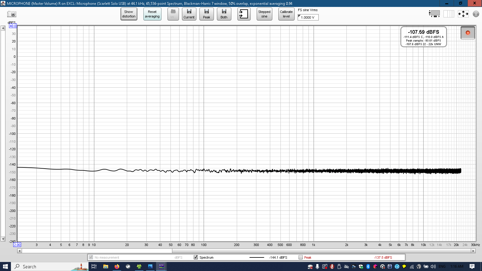

Background noise with no input for reference.

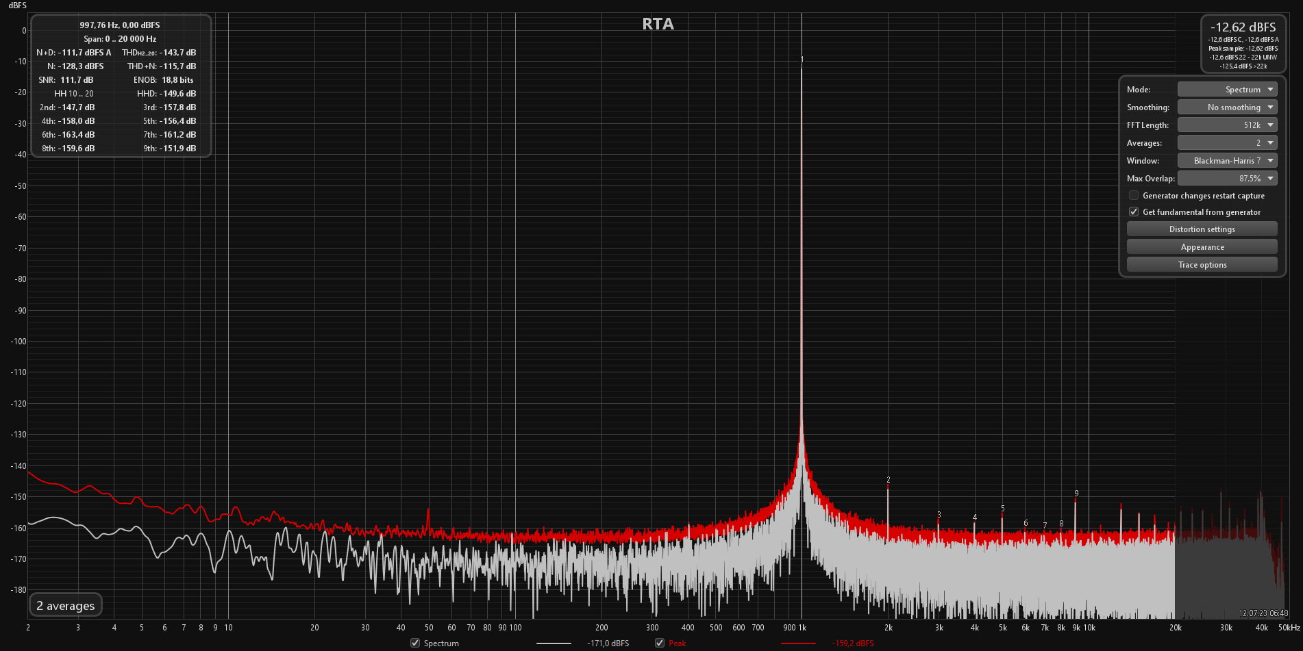

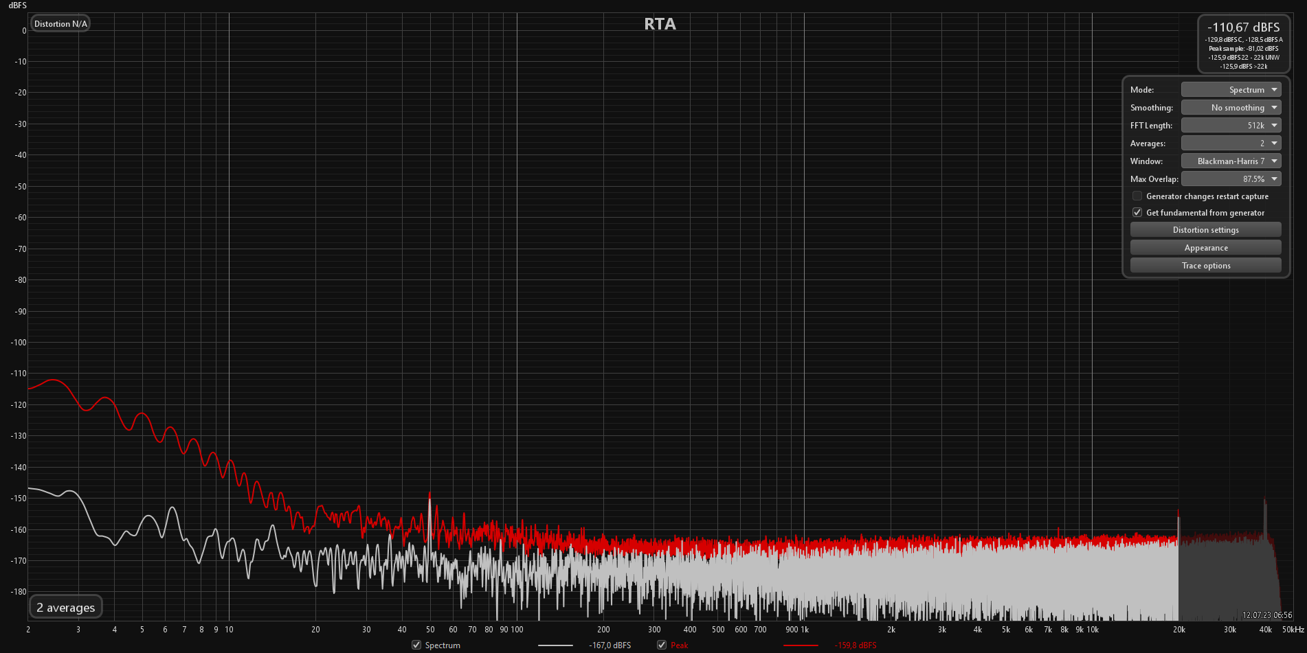

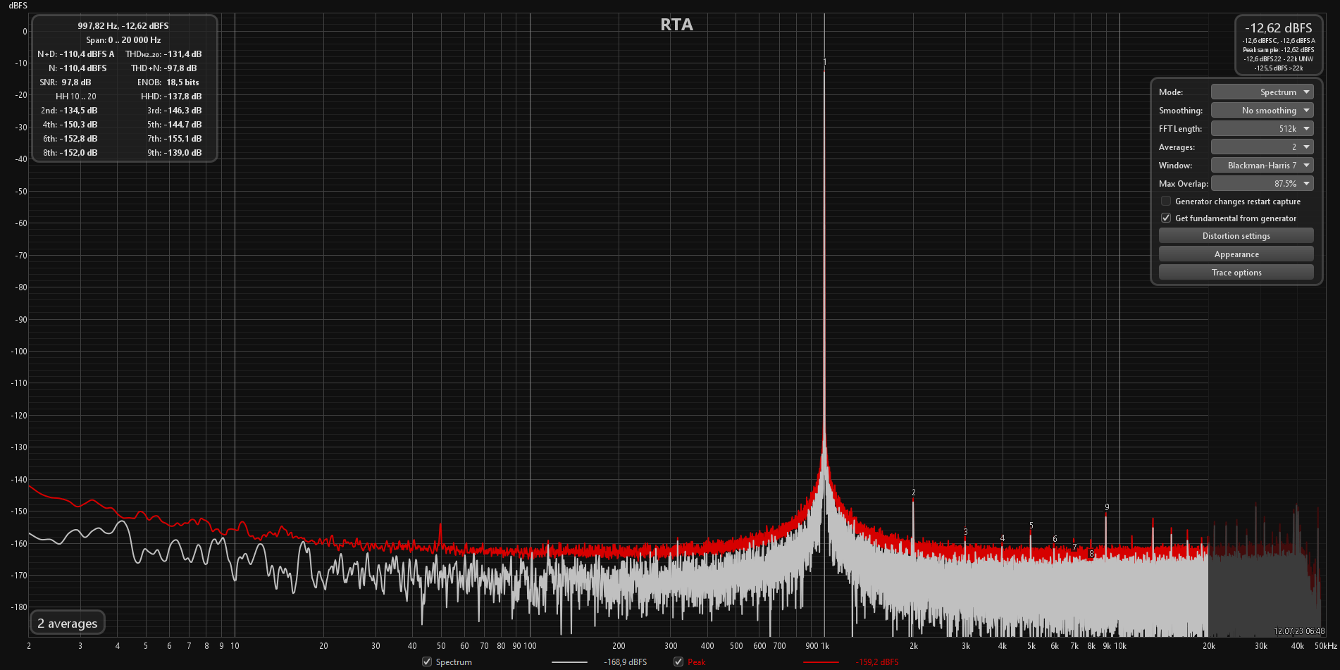

What's the harmonic profile of this oscillator? Is it better than what the Focusrite would output driven by REW? How much additional distortion does the little headphone amp put on top of its input harmonic profile?Victor’s 1kHz oscillator,
I assume anything makes something, then anything chained after adds to it, either on top of or by introducing something new.
It’s so low that you can’t see what its harmonic profile is. That is, what you measure is the loop back of the ADC harmonic profile. Maybe someone has used a high gain low distortion and low noise amp to measure the oscillator?
It’s below -150dB harmonic distortion at 1kHz.

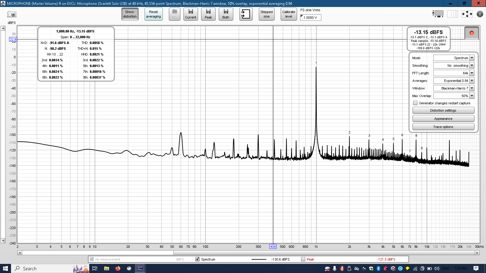

It is possible the create a ground loop generating a lot of noise when using Focusrite only? Using an USB DAC for output and Focusrite for input the measurements of my diy amp are much improved. I wonder if this is a common problem.

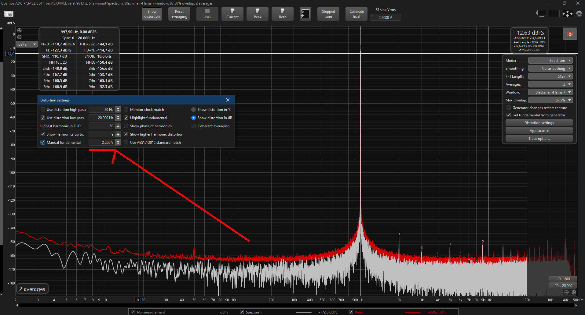

hi - some rough measurements (Cosmos ACD + Victor osc.; cosmos is set for 2.7V sensitivity, Victor's output is 2.2V; RCA to xlr cable, no mono mode)What's the harmonic profile of this oscillator? Is it better than what the Focusrite would output driven by REW? How much additional distortion does the little headphone amp put on top of its input harmonic profile?
i get different noise measurements depending option i chosen. If "manual fundamental" option is clicked then noise is ~128dBfs, if not -> ~110dBfs
Hard to see in above graphs but it seems the fundamental is at -15dB, so the 2nd really isn't much more than 130dB down.
I've measured Viktor's oscillators at -150 below fundamental so it seems the above measurement is test equipment limited and doesn't show what Viktors stuff can do.
It is anyway always a good idea to set the 0dB ref to the fundamental to avoid confusion.
Remember, dB values are always relative, never absolute.

Using the mic input of the soundcard for measurements is no good idea at all. Besides ultra-low noise at high gain - useful for real-life mic amplification - noise and distortion figures at minimum gain never reach the level of a good line-in. A simple loopback measurement will prove that. So I urgently recommend to use line-in instead of mic-in.
Concerning the dB discussion here: I prefer a dBFS scaling, this makes it easy to measure around the sweet spot of the soundcard. Which often is several dB below FS. Next step is set distortion display to dB instead of % - much easier to compare than counting the zeros.
