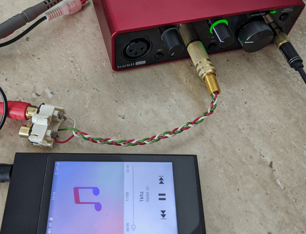

Working with REW using the following:-
- Focusrite Scarlett Solo
- FiiO M7 Audio Media Player
- Mini-itx computer with Linux
- 1khz file copied from Audacity to the M7. The FiiO fixed line output is 2v p-p

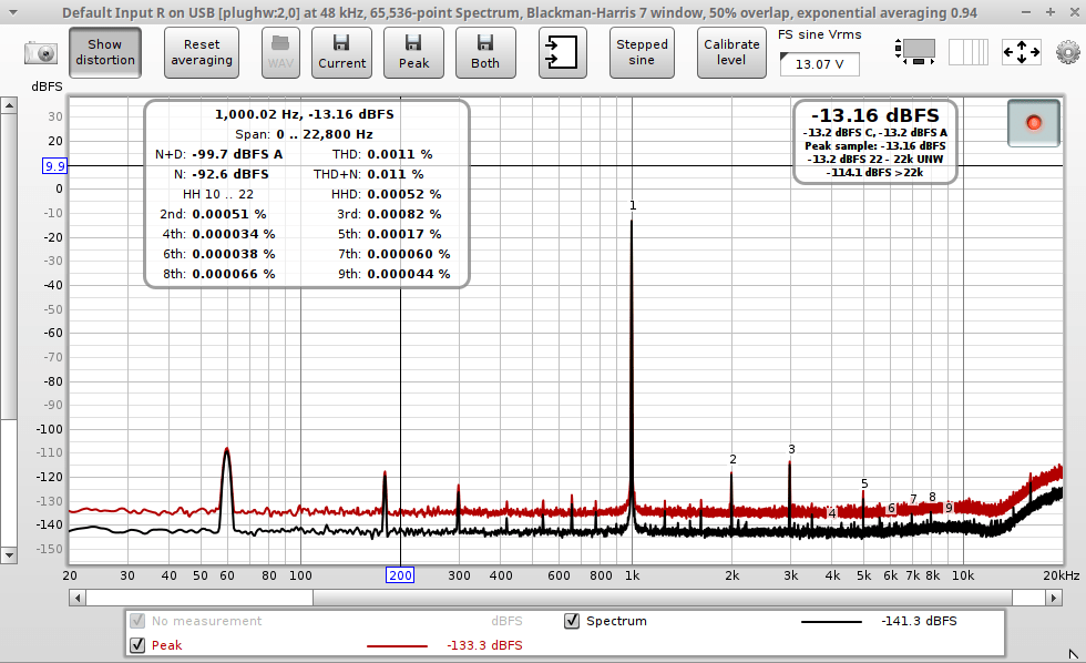

Q1: What can be done about the strong 3rd harmonic from a Wien/Lamp 1khz oscillator. I was thinking about using 1/2 LM4562 as some kind of filter.Working with REW using the following:-

Q2: What connections are needed to loopback the SOLO for calibration.

The Akitika seems to be the best but I am working on an interesting DIY 1Khz. That is why I ask questions here.Have you tried the REW generator? It's very good. I have an Akitika 1KHz generator but hardly ever use it. I have the Scarlett Solo too. Just be sure to calibrate the REW generator before using. I use a 60 Hz sine wave for calibration since that's the most accurate frequency for my DMM.

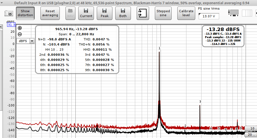

I am currently measuring both a Victor and an Akitika 1 kHz oscillator using REW and a COSMOS APU 1kHz notch with the a calibration file applied in REW under microphone calibrations. I am reading -110dB for a 2nd harmonic with +6dB switch engaged and -104dB with 0dB switch engaged. BTW, I'm using a Focusrite Solo for my ADC. I thought with the compensation file, that REW would read direct. However if I subtract the 30dB of the notch from the reading, I get something closer to what it should be reading. Any ideas what checkbox I've left unchecked?

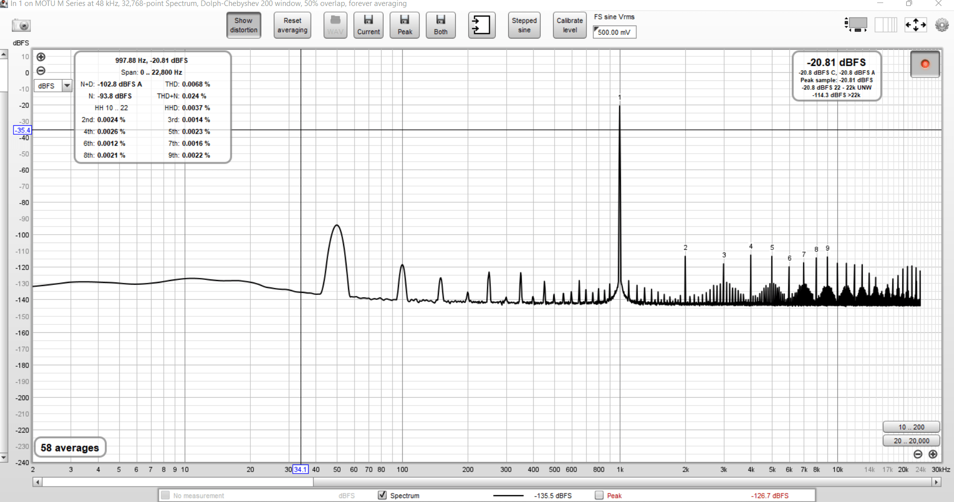

Here's a screen grab of a Nad 3020's distortion at full power before recap. Feeding a Motu M2 via Autoranger outputting 500mv and victors Oscillator. Seems pretty close to spec still. Any thoughts?

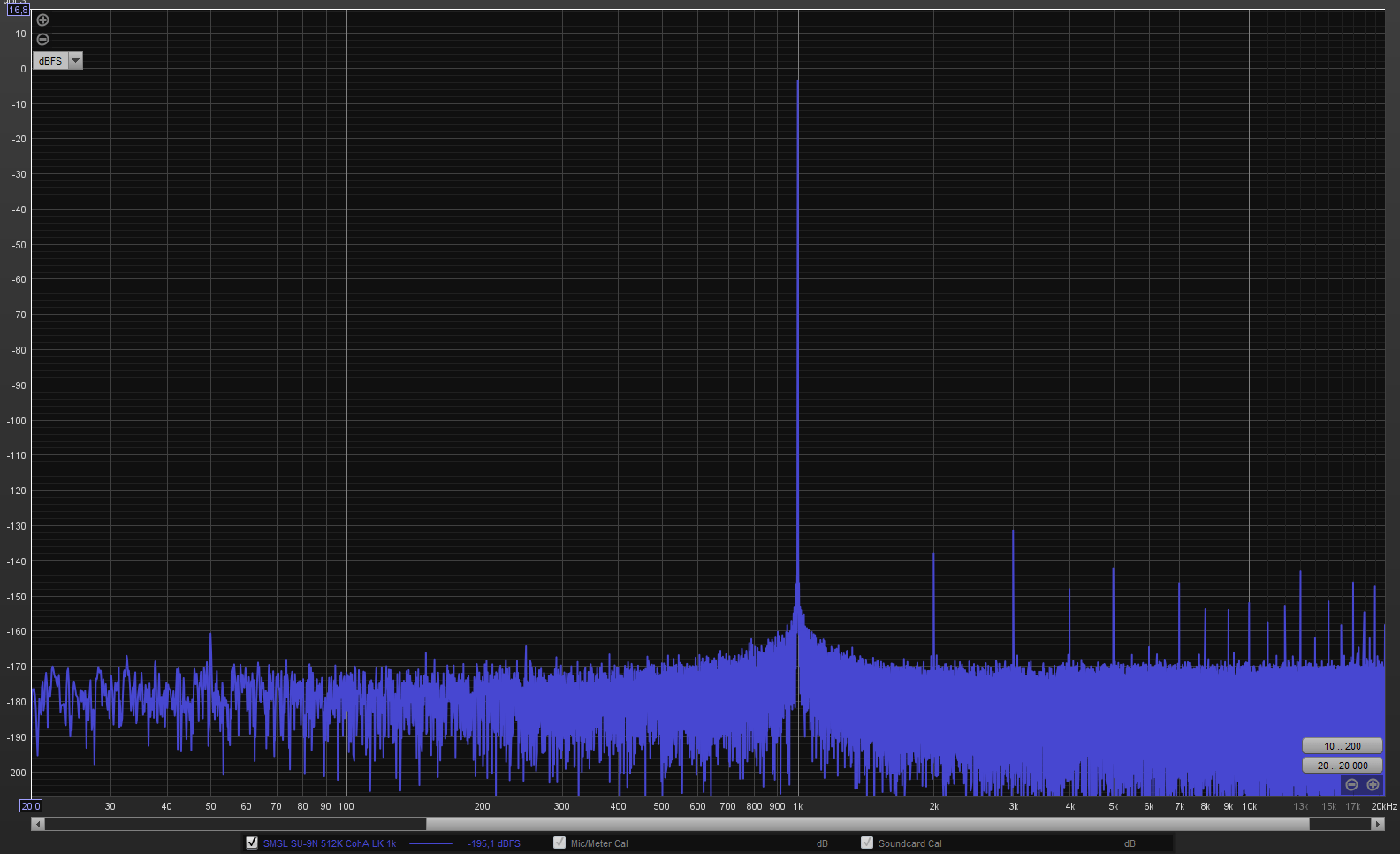

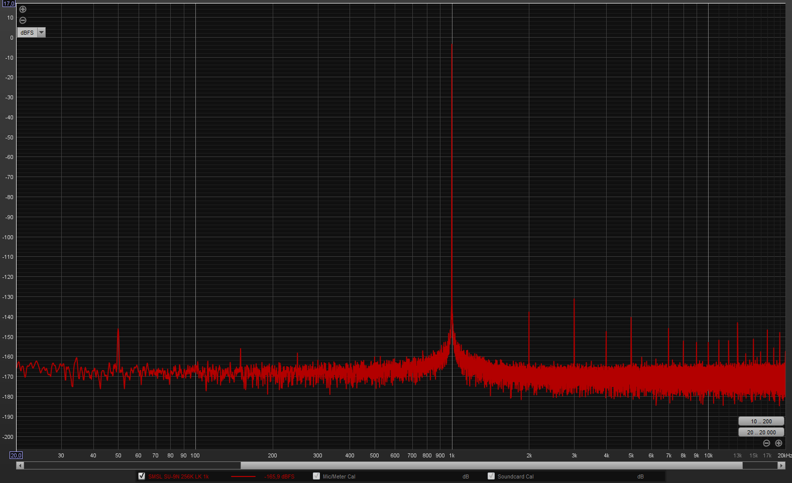

what kind of windowing should be used to get closer to real THD+n distortion numbers?
depending on windowing i get ~123dB THD+N (Blackman-Harris 7; oh wow great... but probably not true 🙂 ) or ~113dB (Hann). probably the latter value is the real one (or closer to).
my setup is SMSL Su-9n + Cosmos ADC in MONO
Cosmos ADC set @4.7Vrms input; input impedance 1.7kOhm (Hot - GND); SMSL output voltage 3.15Vrms between Hot-Cold pin
found an older thread, but ot conclusive
https://www.diyaudio.com/community/threads/fft-and-windowing.241657/

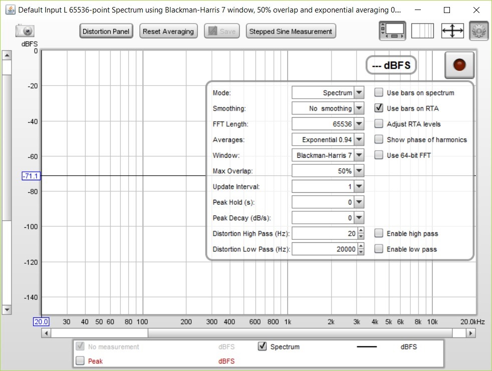

I always use BH7. Just take note of the settings - and a good way is to show the settings dialog box on your screenshots so we know how much averaging, etc. The SU-9n is one of the best DACs out there and should probably best your ADC. You should also use a very low distortion 1kHz oscillator like Viktor’s source. -123dB is not unreasonable from SU-9n.
I have started to show this dialog on the upper right of my FFTs.
