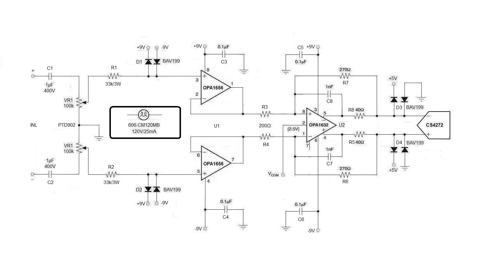

thanks b, yes input level definitely an issue but in my case it was my VTL compact 100 amp that was VERY unhappy.When measuring a tube (or valve) amp with a soundcard some test interface is usually needed to lower the voltages to levels suitable for the soundcard.
E.g. Pete Millett's test & measurement interface:
https://www.diyaudio.com/community/threads/test-measurement-interface-for-soundcard.155405/
Or Jan Didden's Autoranger:
https://www.diyaudio.com/community/threads/autoranger-for-soundcards.299635/

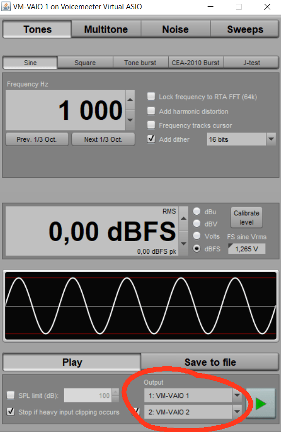

Is there any chance that in REW will be possible to invert one of the two outputs from generator?
It could be useful to make stereo SE output as a "quasi balanced".
Martin
And here it is (I did not try yet):
V5.20.9 25th June 2022
https://www.roomeqwizard.com/changehistory.html#revisionlist
Thank you JohnPM
Thank you JohnPM

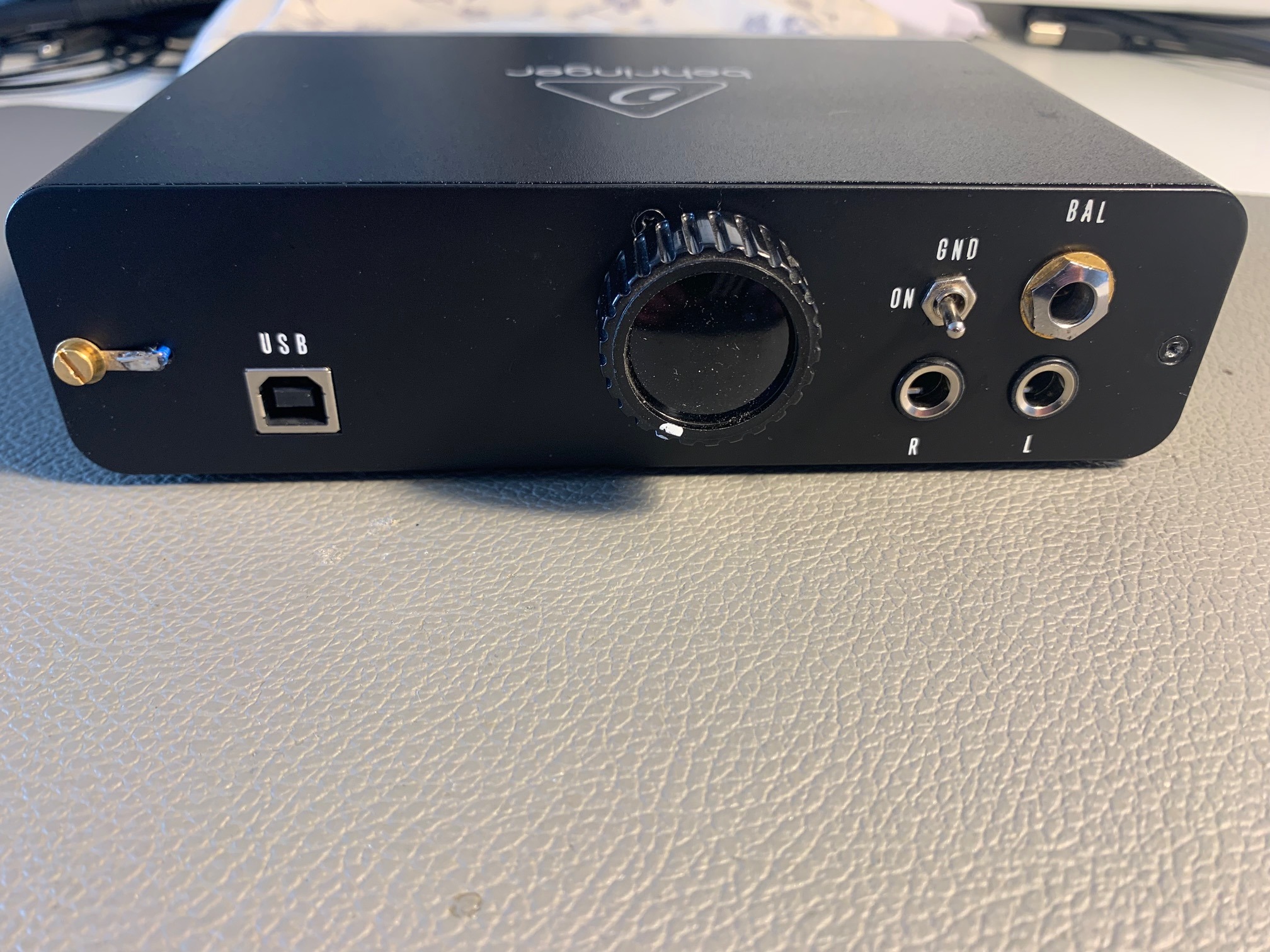

I'am just not sure if i should take special care when connection it to my measurement rig, which is a custom diy balanced Behringer, nothing special through except that it can handle +10vrms input (no voltage dividier needed)
Is it just like any other normal amp. (chipamp. Class A poweramp. etc... ) ? - I just throught i read somewhere that a special setup must be used when measuring such
class D amplifier. -I'am sure the amp. is plain SingleEnded configured (at least the in/out -put's are!)
The documentation is not that easy to understand, but i attached them here for ref. (the sloa068a.pdf is good reading btw...)
Jesper.

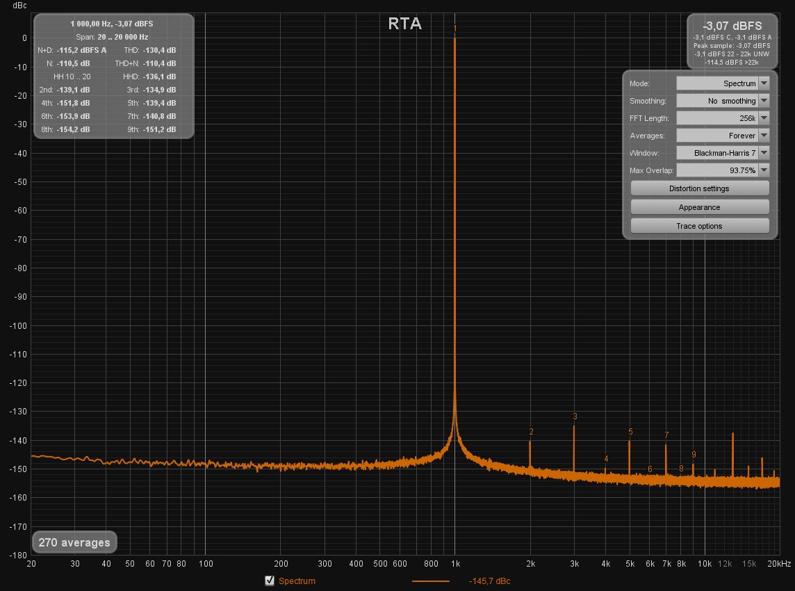

Many class D are BTL output, which has given me more headache when trying to measure. You need an ADC with true differential inputs, which I dont have. (I just ordered a Scarlet solo to solve that one, plus get a better ADC instrument all in one shot).Is it just like any other normal amp. (chipamp. Class A poweramp. etc... ) ?
Unsure if you can just measure one side of the BTL to ground - since the other is just the negative of it - and call it good. Will the spectrum be the same as going across both outputs with load and measurement connections?
Also there's the matter of signal level. Do you use 1 Watt, 8 Watts - what's a reasonable level for seeing the amplifier distortion character that you'd actually listen to, versus ultimate power performance comparitive specmanship?
Then there's the signal level db down from FS of the ADC, such that the ADC is giving its best performance (the level that you'd use in the "loopback performance test" should be about the same from the amplifier through any attenuation, at 1W / 8W / whatever output power)

I have this Behringer which i wrote before, accepting balanced input.
So i guess i'am good... I just need to make some TRS plugs with connection only to T & R (I use T as "+" and R & S as "GND" in the configuation i use now for best performance - having the possibilty to disconnect the GND directly on the Behringer)
Thank's
Jesper.
I will read some more regarding the BTL output.
