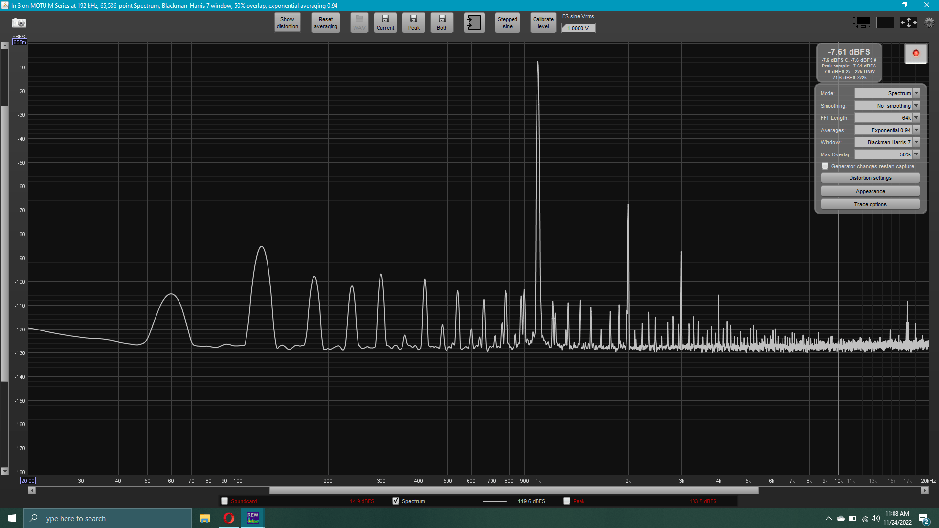

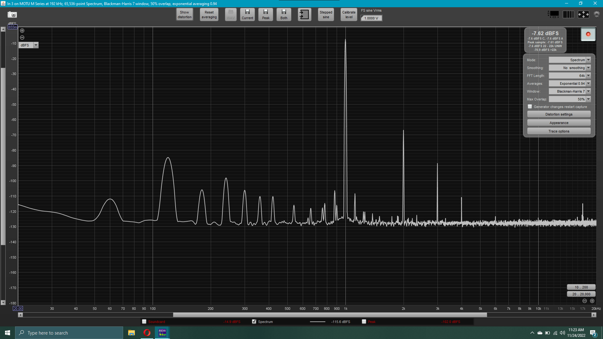

SMSL was tested on ASR forum.
not that it's absolute best measurement that can be found, but it's good enough reference for me. one thing that differs for mine results is higher 2nd and 3rd harmonic (~6dB), but that can be result of ADC's low impedance. i wasn't able to obtain 4Vrms at SMSL output (-0,5dBfs resulted in 3.15Vrms at output). will check 'pre mode' results later.
my mystery with higher that awaited results solved
i've used 'coherent averaging' option -> as per REW's manual: "The noise level drops by about 3 dB for each doubling of the number of averages."
i've used 4 averages for above results and got ~ -123dB THD+n; with 16averages i've landed close to ~ -128dB THD+n
no coherent averaging -> ~ -118dB @-0,5dBfs generator level
Noise remains correct since 5.20.13, REW now uses separate magnitude averaging for those.The THD is accurate with coherent averaging but the noise is not accurate.

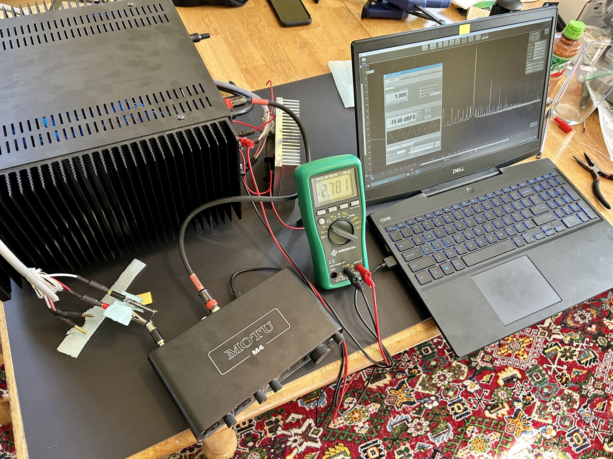

First seemingly reasonable distortion measurement with REW! Looks OK for my F5, though I obviously have some mains hum and associated harmonics to sort out.
I’m excited to test all of my amps!
Nice work. That’s about par for the course mains peaks at 60Hz / 120Hz / 180Hz etc. I see about the same -80dB peak at 60Hz when using linear transformers and CRC PSU for Class A amps. Use of a capacitance multiplier in the PSU can reduce this significantly.

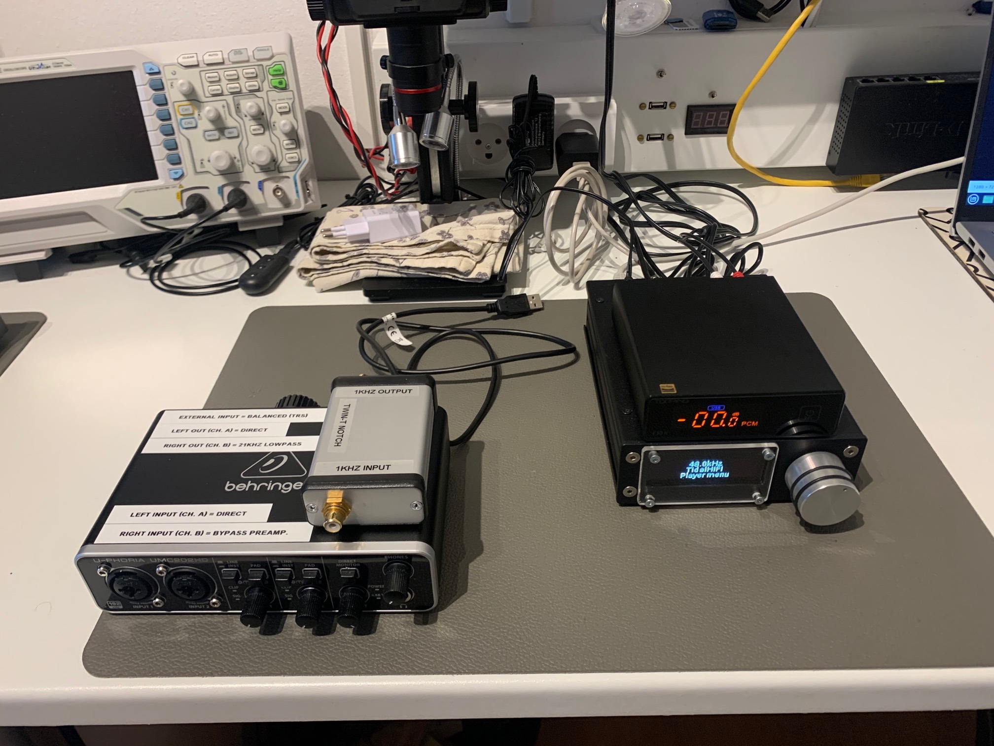

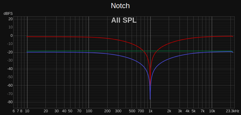

I decided to take some measurement of the Topping, as a reference to my modded Behringer and Twin-T passive notch.

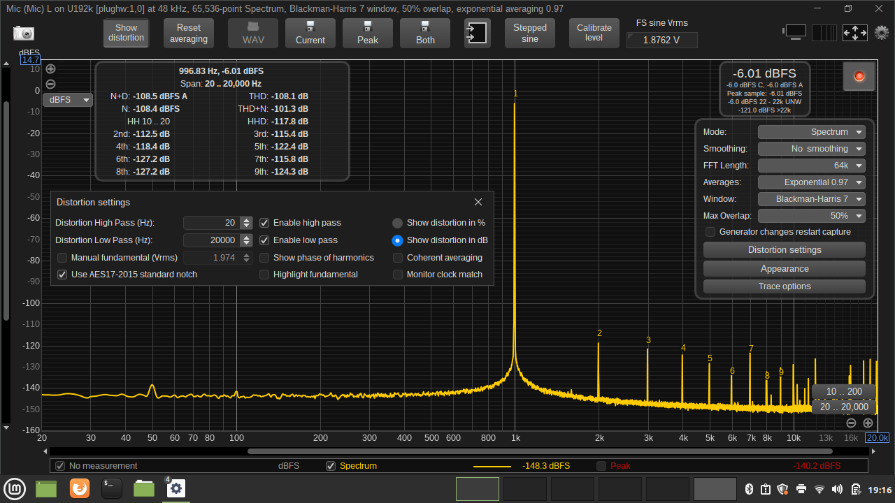

The Audiosciencereview showing sinad (THD+N) of -117dB. @ USB input.
First measurement showing direct from Topping into the balanced input on my modded Behringer.
THD+N is showing -101dB (Which is rather far from Audiosciencereview Amir's -117dB)
- But it's clearly showing some very good result's comming from the Topping.

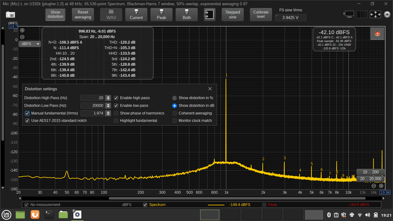

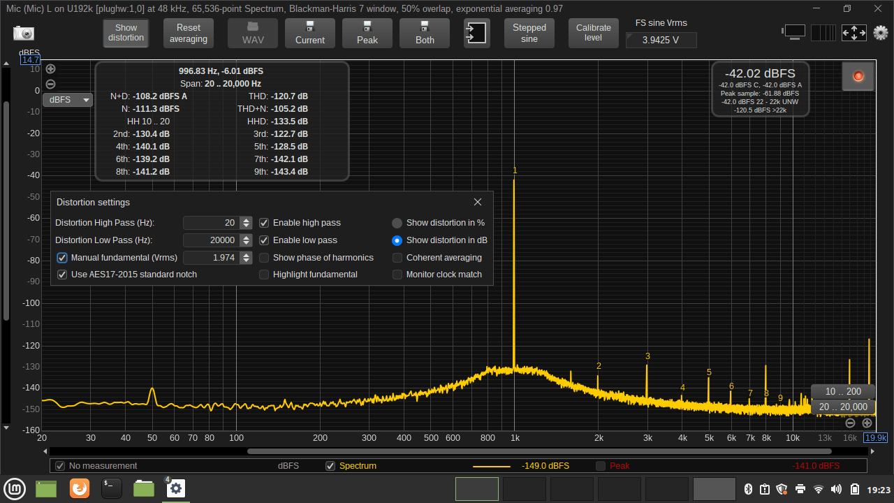

Now with my passive 1KHz notch and calibration file applied. (Red curve is calibration file)
Showing a better THD+N @ -105dB, but still 12dB from Audiosciencereview's.
I'am sure that if i used some very high grade active notch i could end up near -117dB, but due to component shortage and price increasing, i find it to expensive to build one at moment.
LEFT channel notched:
RIGHT Channel notched:

Even with very high grade active notch your ADC will probably be a bottleneck for measuring -117dB THD+N. IME only ES9822PRO is up to the task.Showing a better THD+N @ -105dB, but still 12dB from Audiosciencereview's.
Yes... you are probably right here...Even with very high grade active notch your ADC will probably be a bottleneck for measuring -117dB THD+N. IME only ES9822PRO is up to the task.
But with some shorter cables, lowering the output to -3dB (with corrected fundamental ofcause) and moving stuff a bit around, i'am reaching nearly -110dB now.
