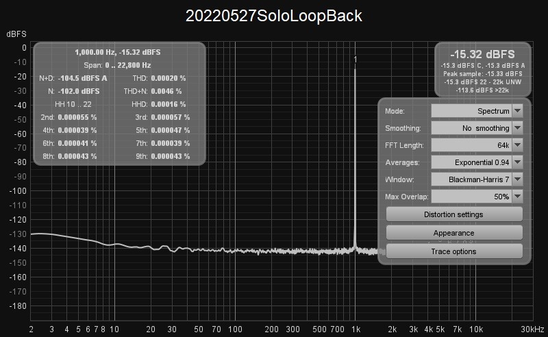

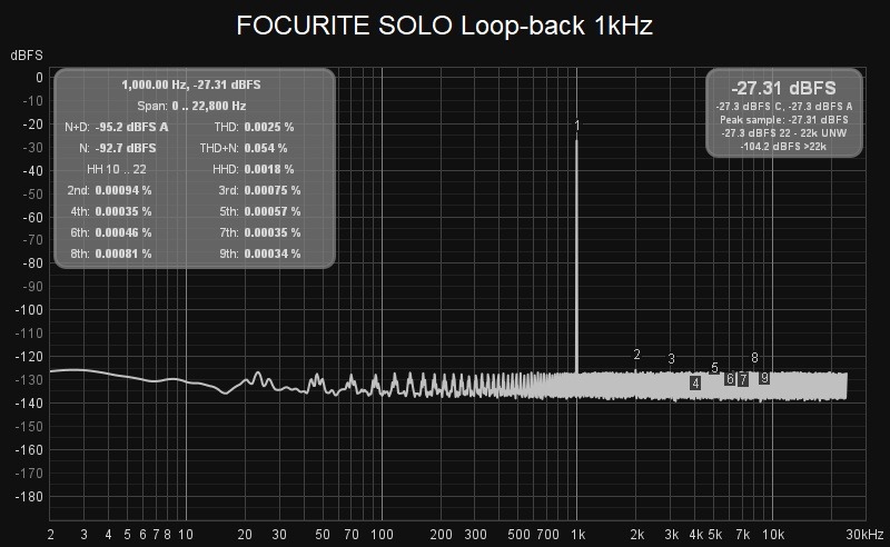

I cant remember doping anything special.What did you change to lower the noise floor by ~15dB between post #1335 and #1337 - was it just the removal of the DUT from the loopback?
So it must be the DUT.
But I know that my load resistors (8ohm) did get really hot! When doping the stepped sina test.
The 'stepped sine' measurement within RTA has two options - you had the 'Step frequency' option selected within the 'Stepped Sine Measurement' settings pop-up box. I suggest you choose the 'Step level' option. That will then generate a plot to identify how HD % changes with level (at just one test frequency such as 1kHz), and when clipping occurs in your DUT.

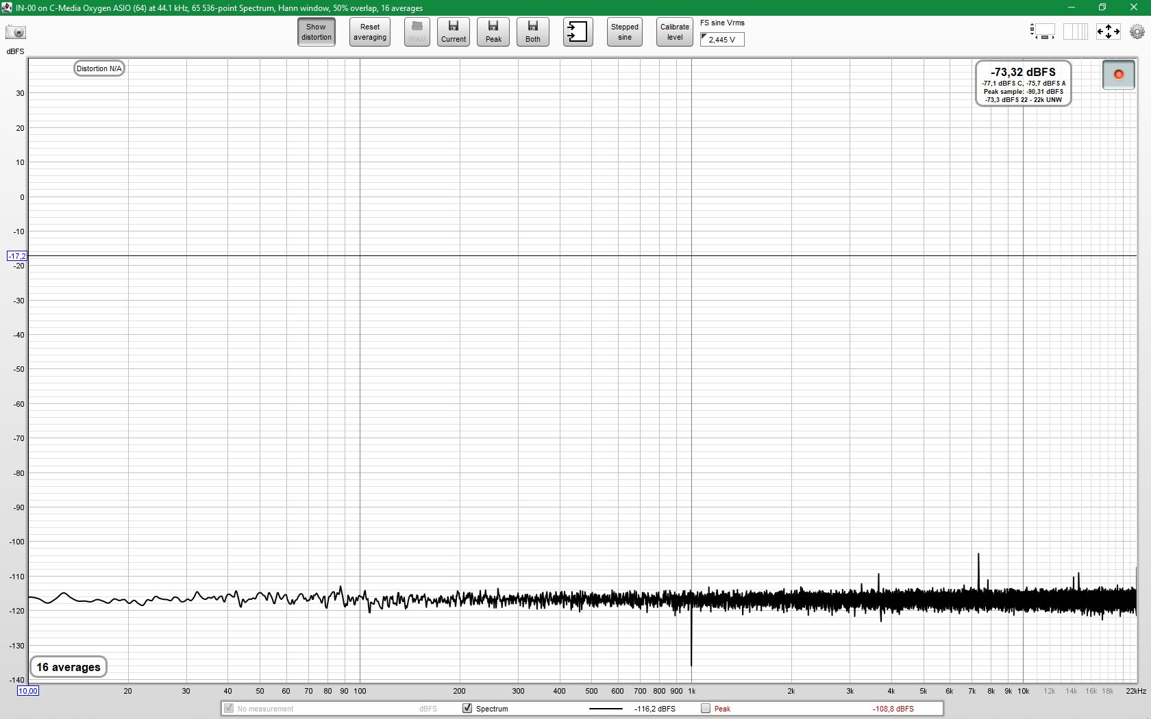

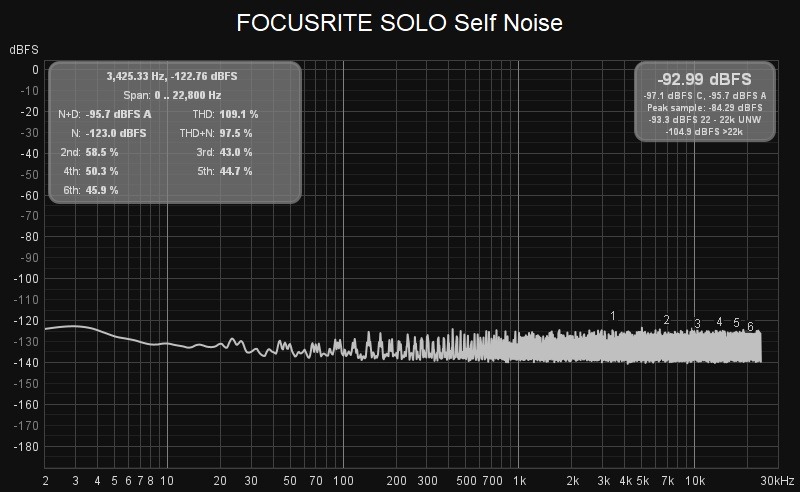

Without any input I get a nice straight "curve".Ryssen, looks to me like you have a ground loop or earthing issue. What does the soundcard look like noise wise with nothing connected to the mic / line input. Some soundcards do not work well with a basic loopback test.
But when I insert the input jack the 50 and 150hz are back......And they wont go away even if I ground the input..
To what? Something that can handle most devices, or just the Focusrite products?Changed the driver
When someone says "It looks like 16 bit Java asio drivers limitation", I dont understand; what else is there?
Looking to learn, here. Thanks!
There's a typo in the quote (asio shouldn't be in there), but the intent is correct. On Windows the JavaSound implementation, which is used when REW's "Java" drivers option is selected, is limited to stereo data at 16-bit resolution. I don't know how that came about, since JavaSound implementations on macOS and Linux are much more complete. Besides the 16-bit limitation Windows also uses a very short dither sequence for the data, which makes things even worse than 16-bit data should be. The solution is to switch to an ASIO driver, either the native ASIO driver for the interface or, if there aren't any native drivers or the input and output devices are different, an ASIO wrapper like FlexASIO.When someone says "It looks like 16 bit Java asio drivers limitation", I dont understand; what else is there?

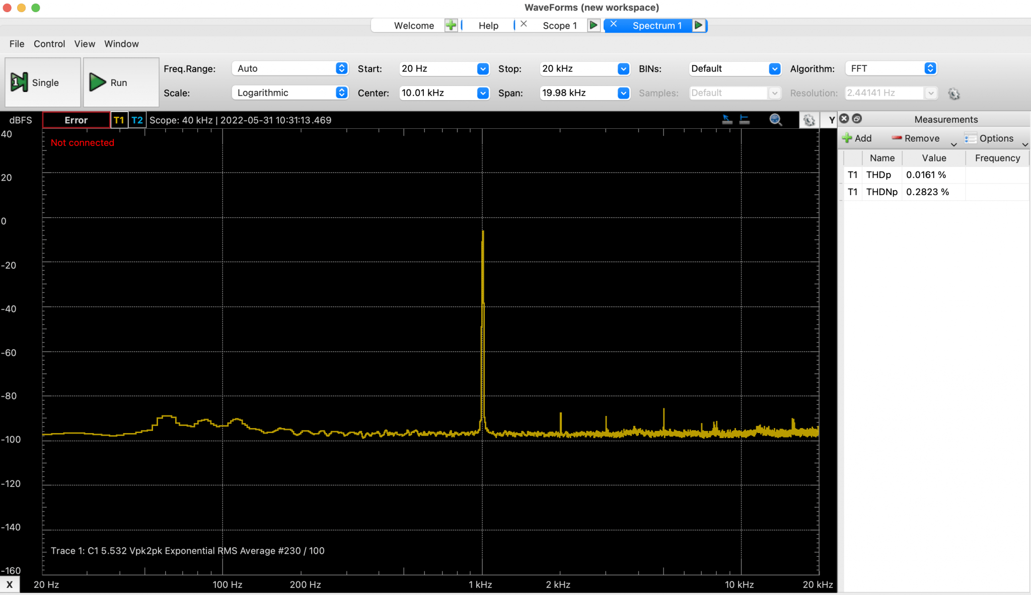

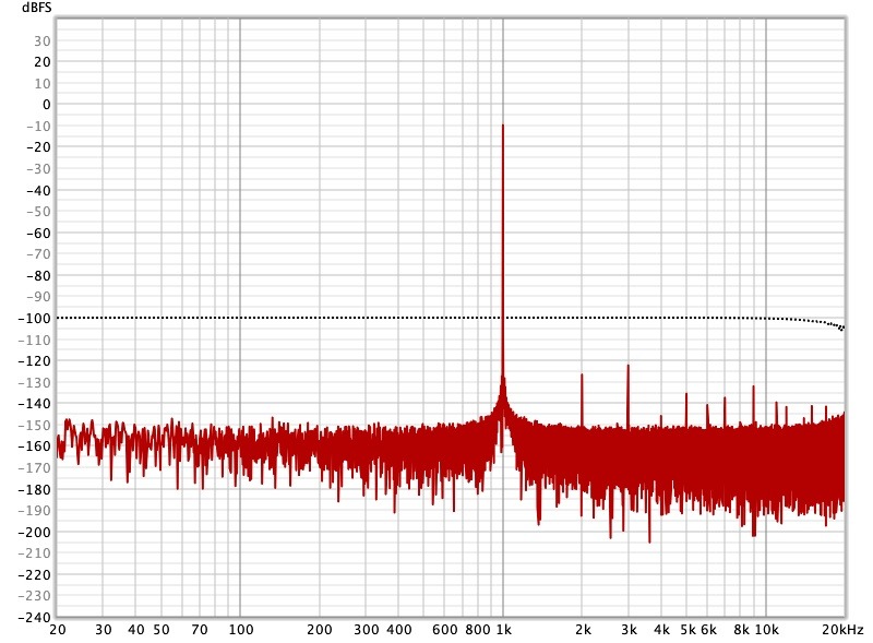

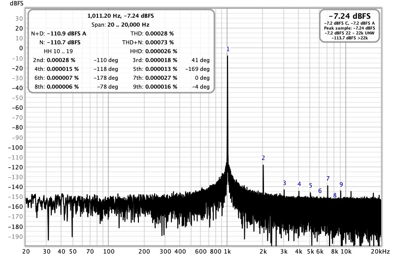

Hi all, I just want to share the results of a Motu M4 (close loop), a Motu M4 with a Akitika 1KHz sine wave generator and Analog Discovery 2
Motu M4 - Close loop, THD 0.00030% and THD+N 0.00092%
Motu M4 and Akitika - THD is 0.00028% and the THD+N is 0.00073%
Analog Discovery2 and Akitika - THD is 0.0161% and the THD+N is 0.02823%
The 'difficulty' with such plots is knowing how much harmonic distortion relates to the signal generator, compared to the signal ADC end. If the HDs are sufficiently above the noise floor, then it can be worthwhile adding in a - 20dB attenuator and checking if HD % stays the same. Another technique is to insert a notch. That type of testing may allow a better level of confidence, if the aim is to use your equipment for making measurements where distortions are down at the measurement equipment level.

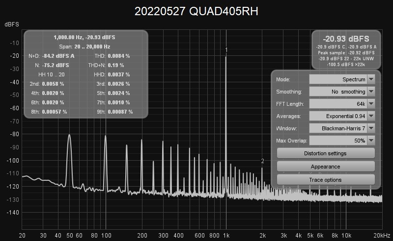

I've been measuring tube amplifiers with REW. No such luck. There's more harmonics on a 1 kHz sine signal than REW can count...where distortions are down at the measurement equipment level.
the only time i tried to test a tube (valve for me ) amp with this type of set-up it oscillated to a point i pulled the mains plug and never tried again!I've been measuring tube amplifiers with REW. No such luck. There's more harmonics on a 1 kHz sine signal than REW can count...
When measuring a tube (or valve) amp with a soundcard some test interface is usually needed to lower the voltages to levels suitable for the soundcard.
