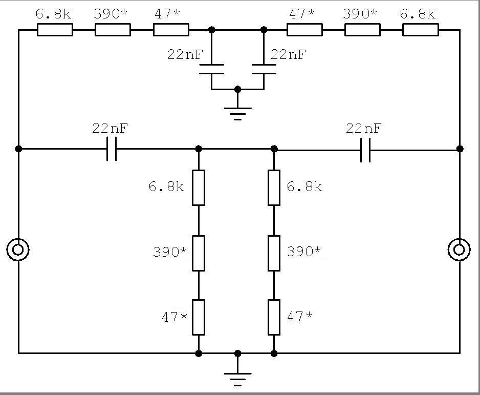

Notch will remove the fundamental. It is Not-Notched combined with Notched via R.E.W.'s trace arithmetic + mic cal. file that gives the final clean FFT.

@YashN

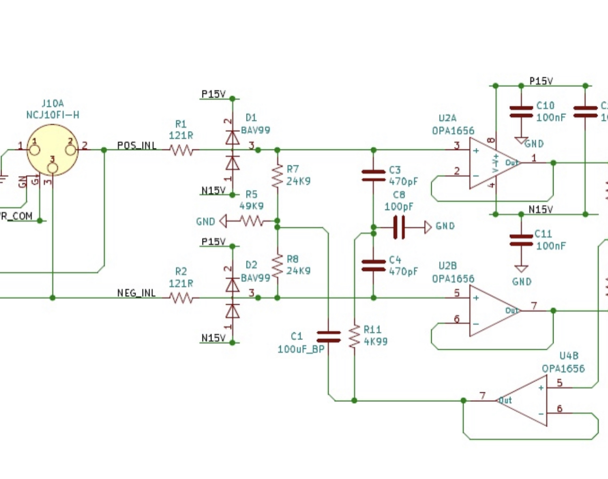

The schematic is this one :
I hope Victor don't mind, but i'am sure he doesen't.
The resistor values marked with * i was told is to compensate if the capacitor's are not excatly 22nF.
Jesper.

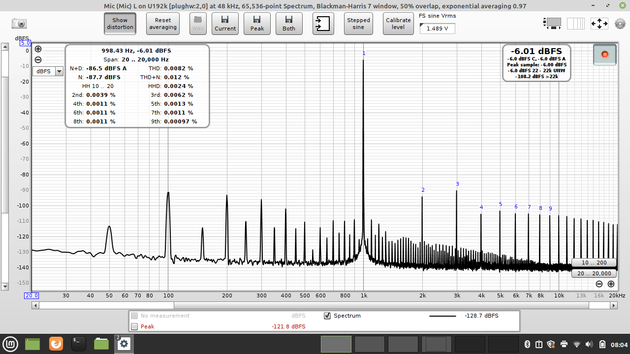

Hey here.
It's an amazing piece of tool such a setup with soundcard, loadresistor's etc... should have build one years ago, but well...
I'am tuning my "shop"-amp. right now (LM4780 cloneamp.), changing the grounding and so, to have much better RTA/FFT cause of that.
Eventhrough i used a lot of hour's reading (sorry if i missed some of it in this thread) i have some quistion's i would kindly ask here.

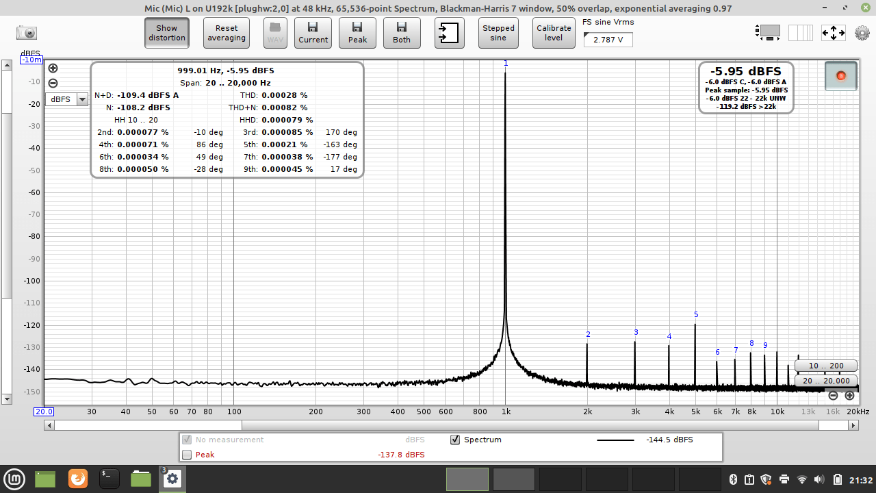

If i look at my typical "loopback" with a 1khz sine from Victors osc. it will look like this one :
I see that the soundcard is "producing" some THD's, not much, but some.
If i then measure an poweramp, it might be that this poweramp's noisefloor are very low, so that the soundcards own THD cannot hide there.
  • Will i then see the sum of both soundcard and poweramp then ?
  • I belive that if measuring an amp with a much higher noisefloor, this does not matter? - is this correct ?
Thank's all 🙂
EDIT :: Soundcard is modded Behringer UMC202hd
Jesper.

Nice numbers, the harmonics you are seeing are certainly from your soundcard input given the specs of Viktor's gen. A poweramp with such specs would be a very, very quiet and distorsion free amp! In reality you're probably going to have much more THD+N at an amplifier output, so these numbers you get in this direct setup will be negligible.
Reactions: lykkedk
Nice FFT overall - very clean baseline devoid of mains 50/60Hz, but I think everything you see there is an artifact of your Behringer if you are using Victors osc. The 5th harmonic is especially bad - even though quite low, is an odd higher order “mechanical” sound and may be slightly audible to some sensitive ears if this were used as the DAC.
Reactions: lykkedk

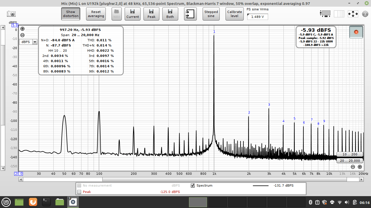

Hey. Thank's for the feedback guy's!
Changing the GND connection's, for improved 50Hz hum in this old CloneAmp.
I was never able to do this before!
Eventhrough THD numbers didn't change a lot, the 50Hz peaking-through the amp. is lower now.
There must be some more modding to do with my other amp's now 🙂
EDIT:: Sometime REW trick's me, and having the 1KhZ off, i therefore replaced the picture, where the mod was shown.
Jesper.
Ryssen, you may find it worthwhile to do some reading of previous thread posts to better understand how the soundcard is the principle generator of distortion when doing distortion testing using REW. For a loopback setup, the soundcard's DAC and related circuitry will include its own distortion, and similarly the ADC and its related circuitry will add to that inherent distortion. Even if you generate a signal externally, REW will show the soundcard's ADC side circuitry contribution to distortion, which may dominate for a very low distortion signal from the likes of Victor's oscillator, or be dominated by the external source like your phone derived signal.
Using REW relies on you providing adequate signal conditions to be confident of what you are trying to measure. Your first plot shows that even the fundamental signal appears to be buried in the noise floor of your measurement. If you read the thread then you can come across ways to suppress the noise floor, especially when trying to identify harmonic levels in a loopback measurement, such as using the coherent averaging feature of REW.

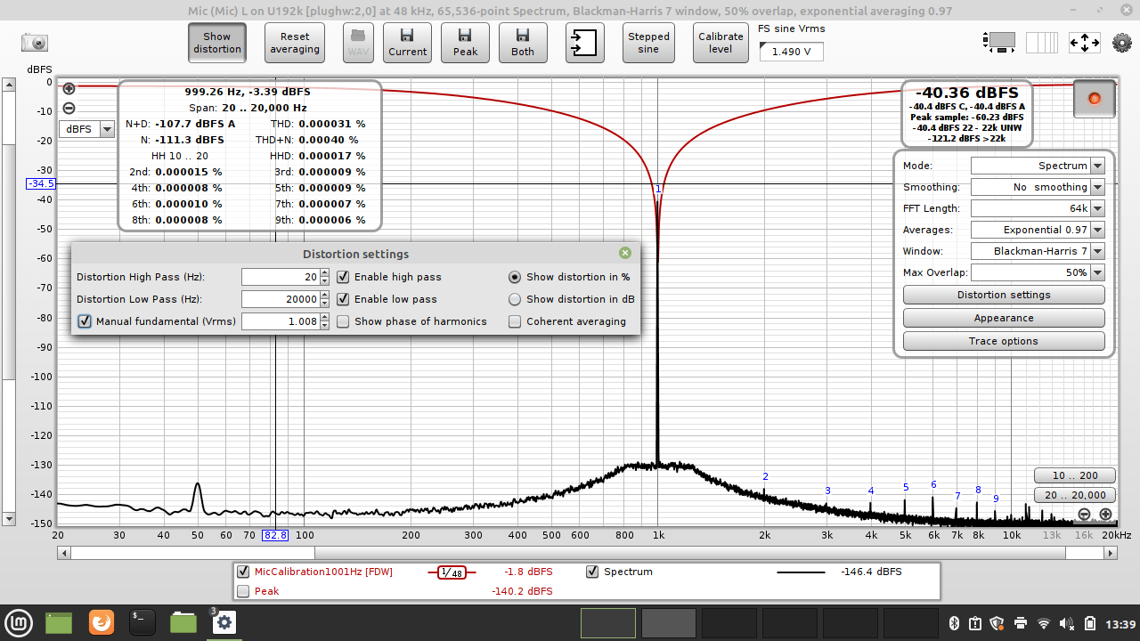

Hi all...

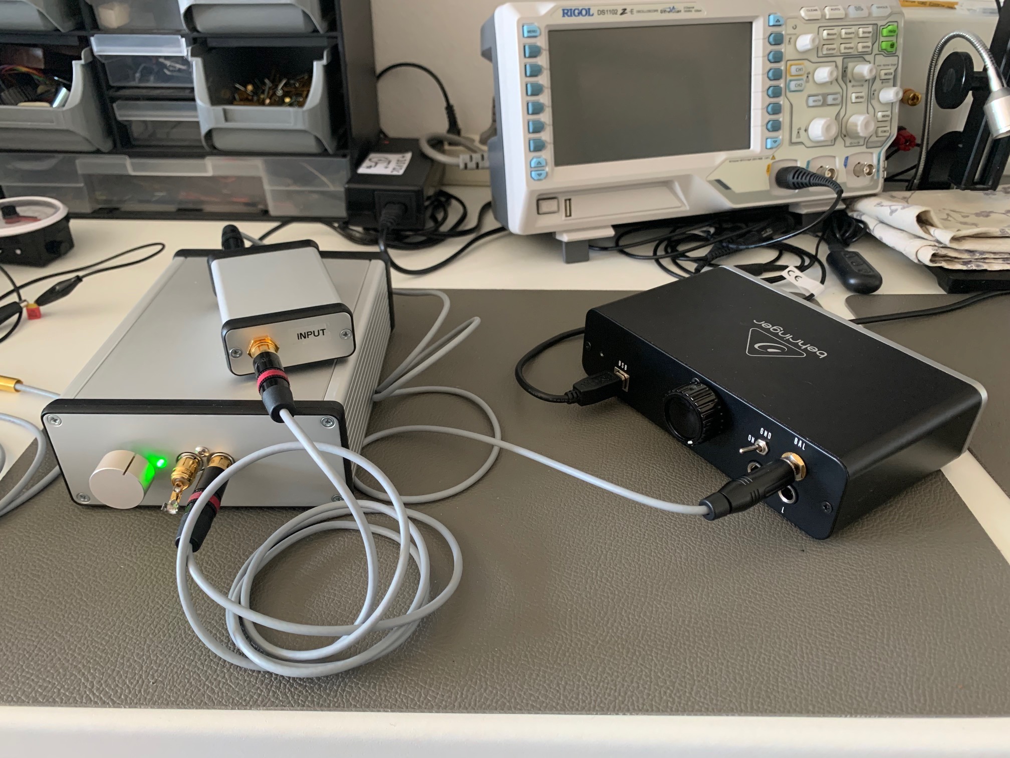

I'am playing with my notch filter, and i think i got it right.
Here is what i did (i know it's also stated at page42) :
Calibrated the voltage at the generator-window (705mV)
Took a sweep with notchfilter
Took a sweep without notchfilter
Trace arethmetic (With-notch / Without-notch) - This file saved and loaded as mic. calibration.
I then adjusted the oscilator for 1008mV and connected it like this : Oscilator ---> Notch ---> Behringer
Then i enter 1.008V in the manual fundamental
But i was told, and also see that the graph looks a little strange
I'am not sure if i missed something?
Another thing. How do i handle the FS sine Vrms dialog on top of RTA window ?
It's because, that when i test a poweramp, i typically load it with 2.8v for having 1w with my 8ohm power resistors.
So i suppose that i should enter 2.8v in the fundamental then ?
But if FS sine Vrms is set to say 1v, the dB will go positive (E.g. 5.35dB) - This is in the window where all the distortions numbers are. (Top left)
Jesper.
