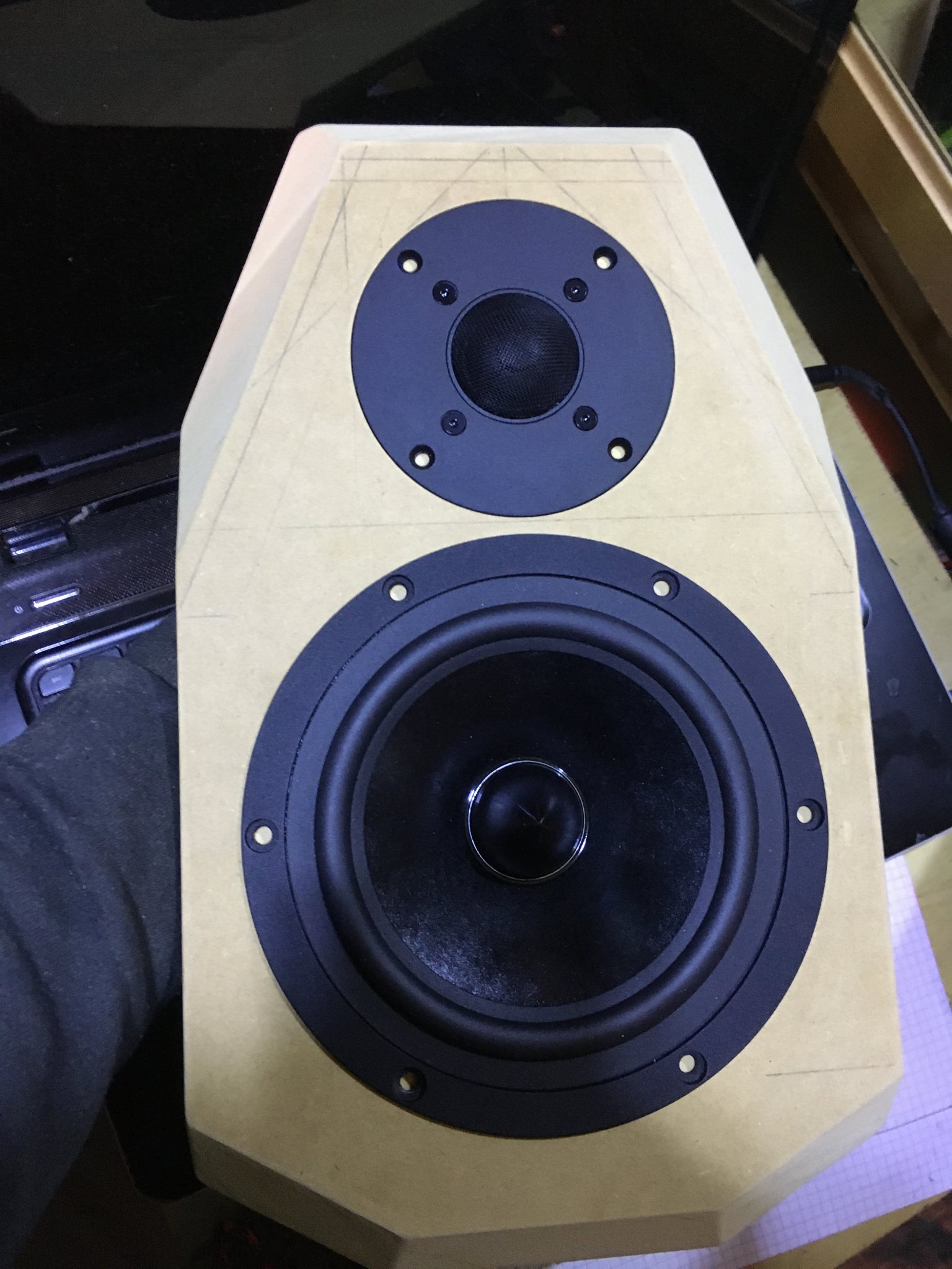

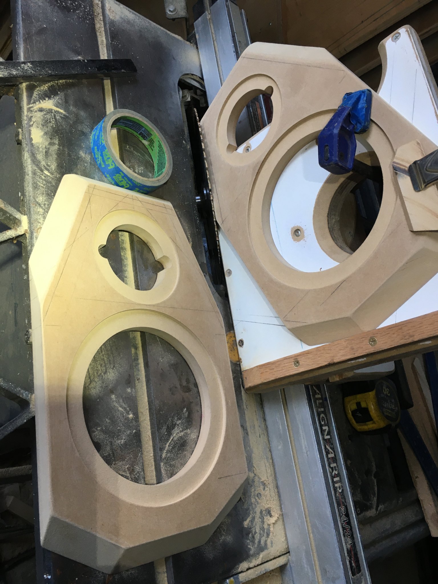

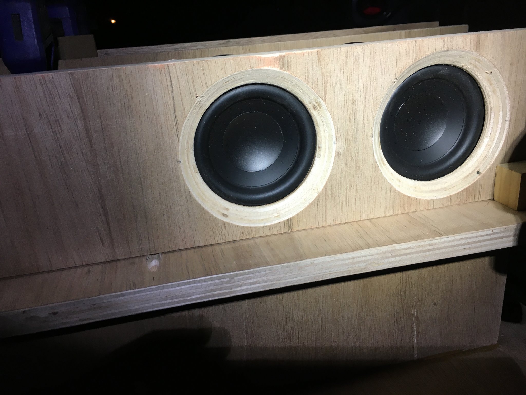

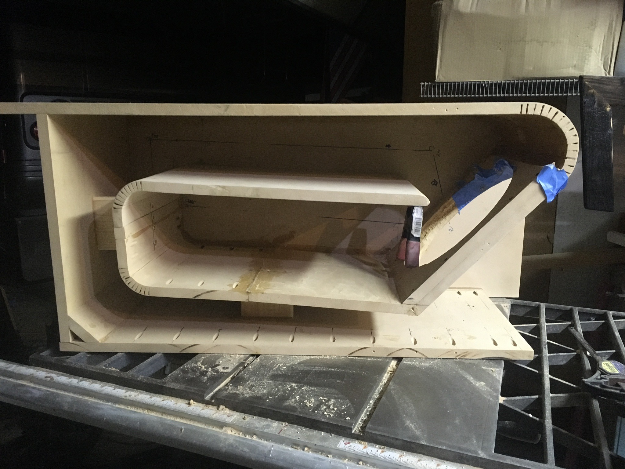

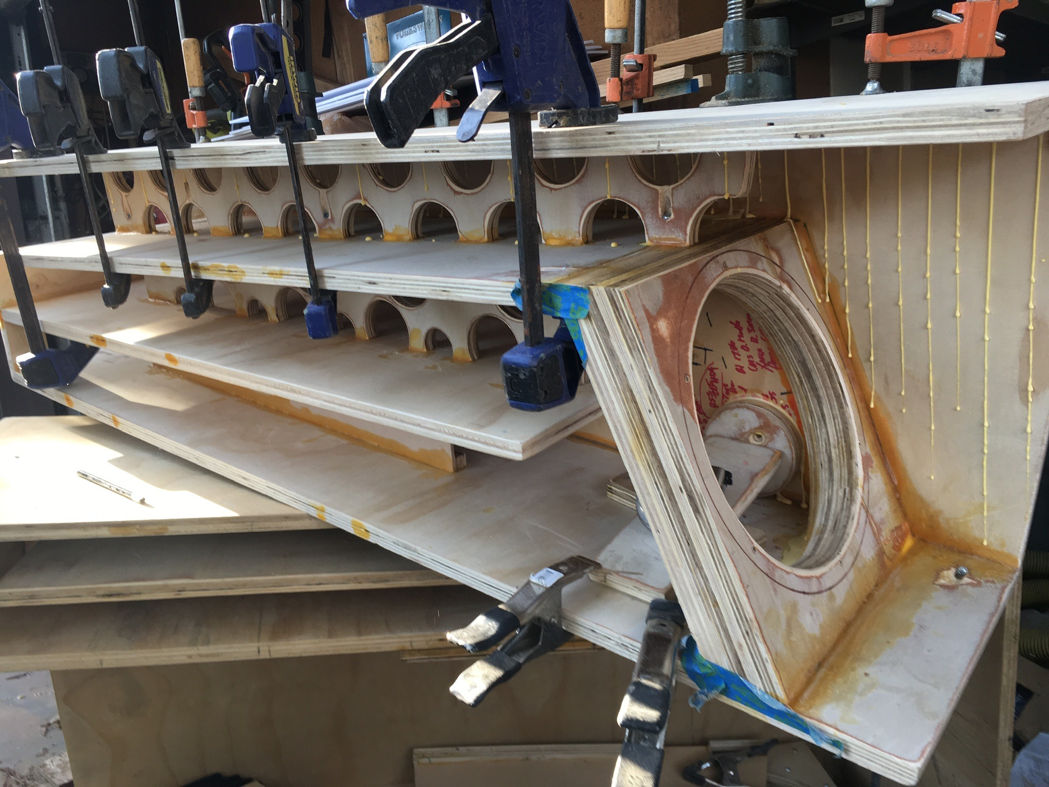

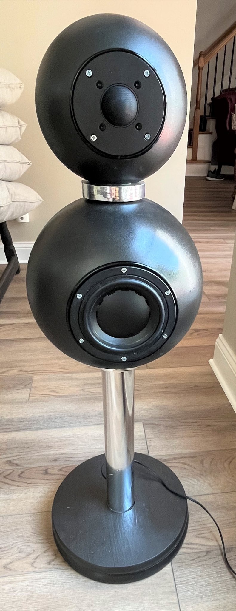

Can you post a couple of pics?
Meanwhile mine are posted at the Ikea Hack site, no one from what I can see has ever done this with 4 spheres:
https://ikeahackers.net/2022/06/spherical-speakers-ikea-bowl-hack.html
No spheres… i suck🤓 but maybe after this thread..Figure something out
The transmission line is impressive wood working indeed! Question, how much incremental advantage do you forsee vs. alternatives such as more traditional ported enclosures, sealed systems with more drivers, and/or with passive radiators or large subwoofers?
The tweeter shown in the smaller speaker, is that a Dayton?
