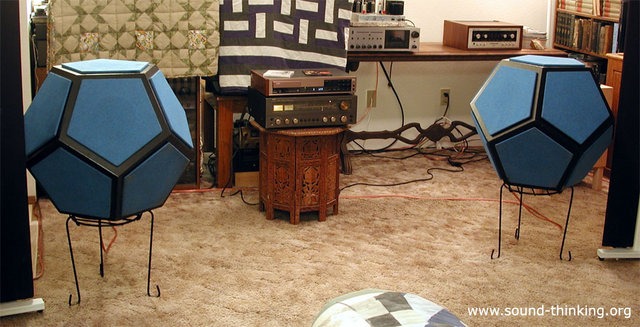

plywood sphere
That is cool. Building a geodesic sphere and then spinning it down. Creates a fantastic looking pattern.
You would need a tool that allows you to precisiely make the 2 triangles, with the appropriate angles on the side. His assembly method is strange (i have built more than a few geodesics).
It should be noted that if you can live with the more polygonal shape, one would usually build the geodesic with pentagons on which one can mount drivers.

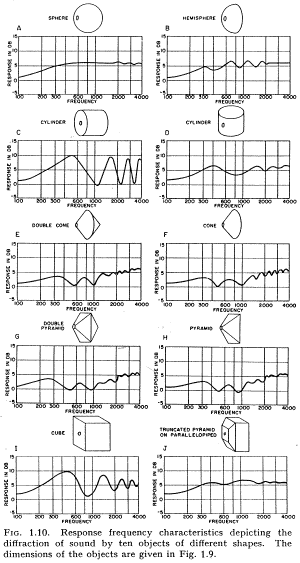

The major manufacturers of spherical enclosures - such as D/B/A, Cabasse, Gallo and Reckhorn - will argue that the sphere does not resonate as it is the strongest possible shape and in order to resonate, it would actually have to "pulse" in and out. See their websites. These engineers appear to be well experienced and well versed. "Standing waves" are not really a factor as there are no parallel sides internally, only infinitely small opposite points which can deflect sound waves in any direction. A ball or pole or similar object can be put into the center very easily to keep waves from traveling from one side to the either if desired.
Meanwhile all speakers made from panels are separate pieces and although they have joints, panels can certainly vibrate.

This is from the Demand Better Audio (dba) site relative to their line of spherical speakers:
"The dba Sphere; Pioneering research from Dr.H.Olson during the 1950’s exposed the properties that make the most ideal speaker enclosure and the elements that hinder any design, work that is still referenced by experts to this day.
In any design of speaker enclosure designers strive to eliminate internal resonance and external diffraction. Dr.Olson found that when using a spherical enclosure these two main causes of loudspeaker distortion and colouration were neutralised more than any other possible design."
http://demandbetteraudio.co.uk/works/envy1-2/

Olson certainly showed that. of the shapes he tested, it had the lowest diffraction effect sat the 2π yo 4π transition.
But it, effectively has an inifinite number of parallel walls ALL of the same length. This leads to a very strong single frequency internal air resonance, with a very big node dead centre.
B&W took the research further and cam up with, essentially, a teardrop, which has even better 2π to 4π transition and dramatically less internal resonance issues.

If any concern, any internal "standing" sound waves in the sphere can easily be mitigated by introducing a smaller ball in the center, and this can even be slightly offset. For a 12" internal diameter of a sphere, the frequency at that length is about 1,125 Hz. This won't cause the sphere to resonate especially with the singular strength of the enclosure, let alone any damping used. The ellipse shape is hard to manufacture and also the front end of it is pretty spherical anyway.
There are DIYers that have made these. Others have made single spheres with a "full range" driver, with IKEA bowls and other methods (such as creating a fiberglass ball by spreading liquid fg over an inflatable ball). Many are shown on YouTube and Pinterest. Many sphere speaker manufacturers use two or more enclosures joined together by a pole or other means. The problem with many small drivers in one sphere can be the interference and overlapping of sound waves, as opposed to using one driver per sphere.
