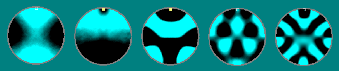

This amount of strength only applies if the modes are concentric.especially with the singular strength of the enclosure
...is about 1,125 Hz. This won't cause the sphere to resonate especially with the singular strength of the enclosure, let alone any damping used.
It won’t move the sphere so it all comes out thru the driver cone. 1k cab be fairly easily damped.

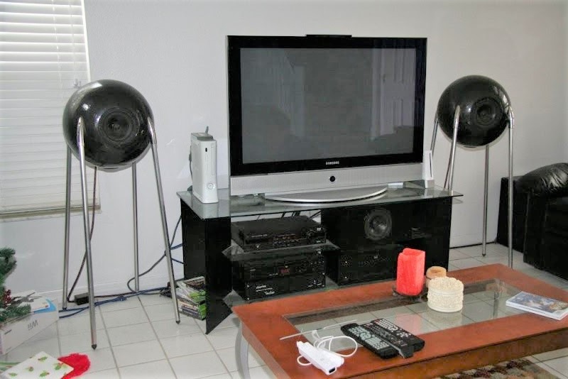

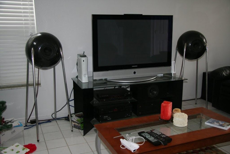

I made these 25 years ago:
https://www.diyaudio.com/community/...ish-on-a-round-enclosure.239978/#post-3577951
Ultimately they have near-zero WAF and only work in sci-fi themed man caves!
These have high WAF here because of using the bamboo look and the sound (very little to no diffraction and wide soundstage). Unfortunately most of the time they are playing merely the TV (although once in while a good bass track on a show). The other second pic is the newer more "industrial" version that goes with a separate sub. Similar to Envy 2 in design. I took the liberty to lighten the Sputnik pic to show the driver, what was used? The design is very cool! Looks like the Cabasse La Sphere in size.

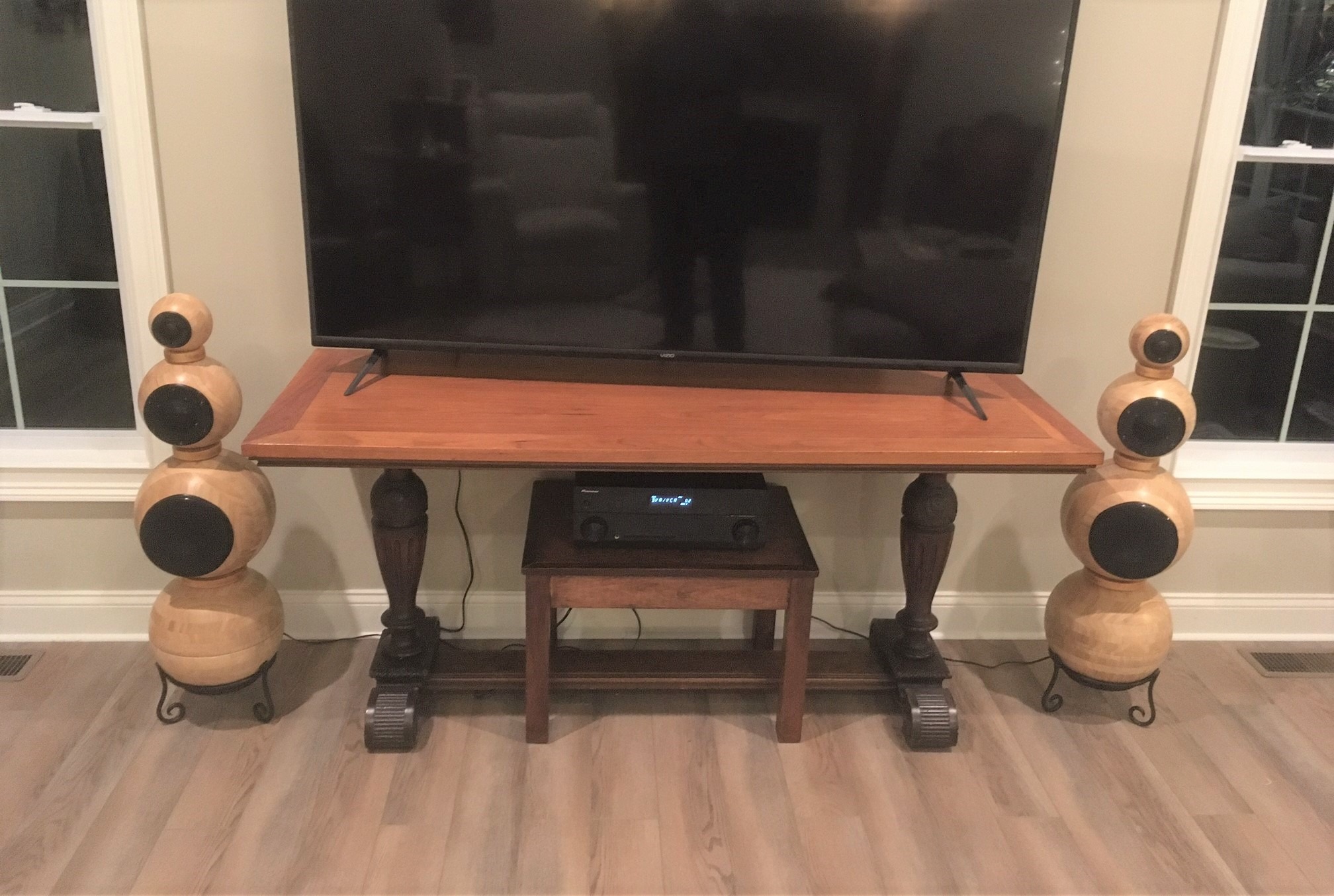

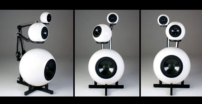

The ones shown look like they are adjustable? So could allow on axis and off axis in the mid and highs, plus vertically aligned or mirror pairs? Cool concept IMO. One thing a sphere can do is rotate in its placement without looking cockeyed relative to a nearby wall.
Piling little lumps on top of each other
Hard to get the asthetics to work, and all of these dramatically increase centre-to-centre’s which is, AFAIC, is a fatal flaw.
A coax or a FR in a solitary sphere, yes.

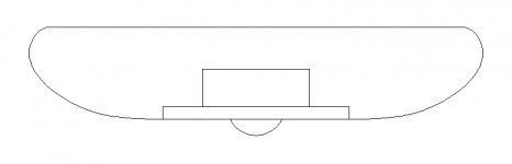

If you are repurposing something the shape is nice (ie IKEA bowls), but something closer to the B&W/Eclipse kind of thing would be a better target if you are fabricating.

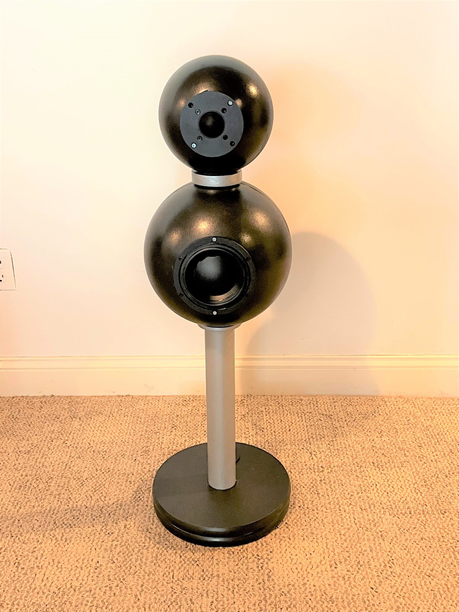

You can certainly make a spherical sub. In my 4-sphere system, the bottom is a 6.5" down-firing sub.
