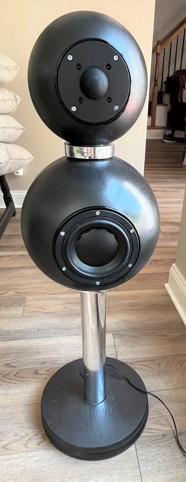

Can you post a photo?Hi first time responder,great forum,as to the sphere which has been a theory around for a long time,I wasted a decade on this puppy,but looking at a sphere in my opinion is broken into 2 parts a megaphone and a diffuser,its a very fragile animal as a bad bass will send lots of uglys to it and it becomes a harmonic animal,I made a better choice.The antephase of the speaker is a very integral part of a great sound,so I made a short horn for rear of speaker prior to a box and then a diffuser worked way better than any sphere,quite surprised no open baffle guys never used a backward horn certainly cleans the plate for a smooth sound,maybe its a launch for all frequencies heading forward ?

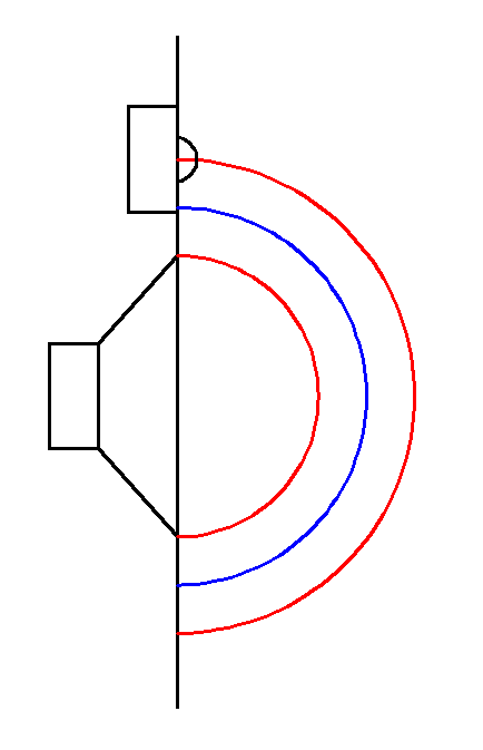

To me the Pluto is just minimal diffraction construction, and omni to quite a high frequency, no diffraction until very high frequency. If you had the drivers on a flat baffle the response would narrow lower in frequency and then diffract all the way up to where the fullranger beams.
Minimal, Pluto has lot less diffraction than a shoe box simply because it has less length of baffle edge.
The woofer is probably crossed over to the "tweeter" before the tweeter structure in front of it is acoustically big so not much diffraction happens on the woofer.
About only diffraction that happens is with the "tweeter" and this is at very high frequency because the tweeter baffle is small, practically non existent, and only main diffraction hump is there but not much else from "baffle". There would be some from the woofer structure as it is nearby and the tweeter is pretty much omni directional up to high frequency but I'm not sure how much this would be, I'd suspect not too much.

I would disagree that this is how it works, and in any case it isn't that simple.Minimal, Pluto has lot less diffraction than a shoe box simply because it has less length of baffle edge.
If you take a transducer and put it to various sized baffles you will notice this is precisely how it works, no matter how you define diffraction being more or less, its relative and inspecting it from a frequency response is quite easy. Its easy to see when there is more or less ripple on the response. The bigger the baffle in comparison to the transducer the more ripple. More flat area, longer edge, which ever feels handy.
We are mostly interested what happens in the listening window but the similar thing happens to any angle you inspect at, sound propagates to all directions, you could inspect frequency response to back, or to side, or a polar map, what ever you'll see less ripple, which means less interference which means secondary soundsource(s) have less effect, narrower bandwidth and/or amplitude.
Frequency response shows response over time, this means that if you have two ideal flat amplitude response sources playing at the same time but delayed slightly this will show a combfilter. Exact same thing happens with diffraction except the second sound source is more compex as you say. Still on a frequency response just a ripple due to delayed sound, the whole edge becomes a secondary sound source. When the edge is about the same size as the transducer itself there is no difference, except the diffraction making opposite polarity source, the diffraction is minimized. Only way to get even less is to put the transducer on a sphere, or approximation of one.
If you play with this in a simulator its very easy to come up with these simple observations and draw conclusions. I cannot imagine exactly what the output response would look like but its not too hard to imagine when there would be more or less diffraction.

You can't judge diffraction by response. Your simulator does not show diffraction, it shows response.
For sure can estimate when there is more or less. Axial response shows the most effect and polar data shows more complete picture. It is enough to know when there is more or less, to minimize the ill effects of it. In addition to looking at the response one needs to consider it in the whole speaker concept as there are crossovers that can split the band to another transducer to reduce problems.
What I cannot tell from these is how audible the stuff is but here again its relative, if there is ripple in response its more likely be audible than when there is not.More over the diffraction effects appear in the response right where one needs crossover and judge how to make the filters, the response is very much affecting the outcome of any given system.

I addressed diffraction in my latest diy using 2 spheres, one for the mid woofer and one for the tweeter, the mid woofer a 3 in coil and a dome comprising more of the diaphragm, crossed at 100 Hz low (it's pretty flat to 100 Hz) and 2,000 Hz high (12 db) and the tweeter an 1 1/8" dome which goes low and handles high power. So sphere enclosures and avoidance of cones, conventional upper - lower set-up. Low base is via an 8" subwoofer.
