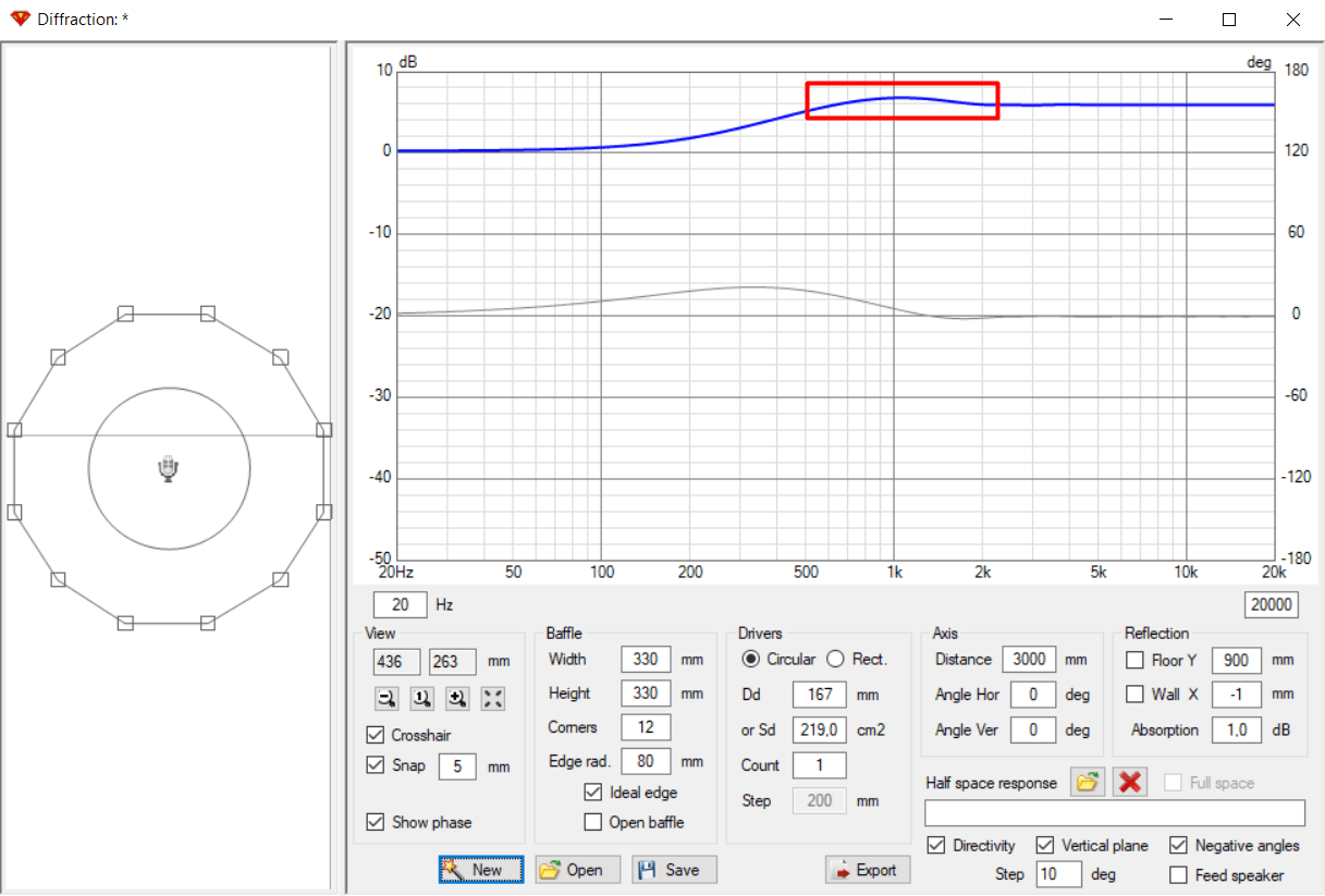

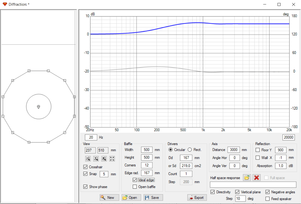

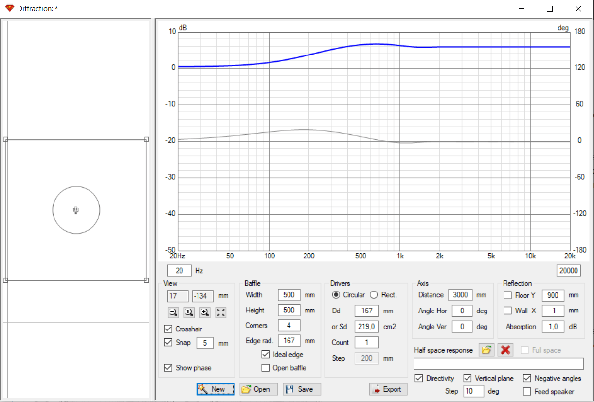

Here is quickie, driver radius is 80mm and if add round baffle with 80mm roundover for it diffraction is almost gone, only mild hump seen.
Or the other way around, when edge round over radius is same as baffle radius then the diffraction is gone in simulator, a sphere, but as soon as the "flat part" driver is introduced on it some mild hump appears until the sphere is quite large. There is still mild hump even if the sphere diameter is about 3x the driver diameter.
And one can make it square to have similar performance as long as the round over is big enough, as big as possible = starts immediately at the driver edge, and diffraction is minimized.
And from this there is rule of thumb that the structure needs to approximate a sphere as well as possible for the wavelength to get rid of diffraction.

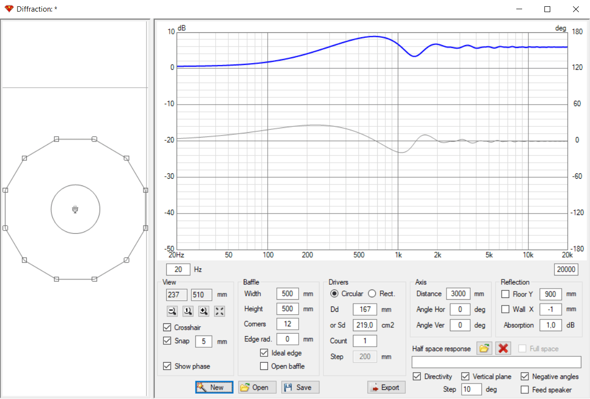

Wiggle in the frequency response plot is due to secondary sound source forming at the baffle edge. Part of sound from the driver goes around the edge and part reflects backwards opposite phase. As wavelength gets longer all of the sound goes around the edge and no backwave emits, no secondary sound source. Baffle step. There is the "main diffraction hump" at top of the bafflestep, roughly at and below baffle dimension wavelength but soon below that there is less and less until at some point there is none. Frequency response plot is good way to evaluate "amount of diffraction", get the wiggle +/-1db and you have ~-20db off edge diffraction in comparison to direct sound which equals ~10% of linear distortion.

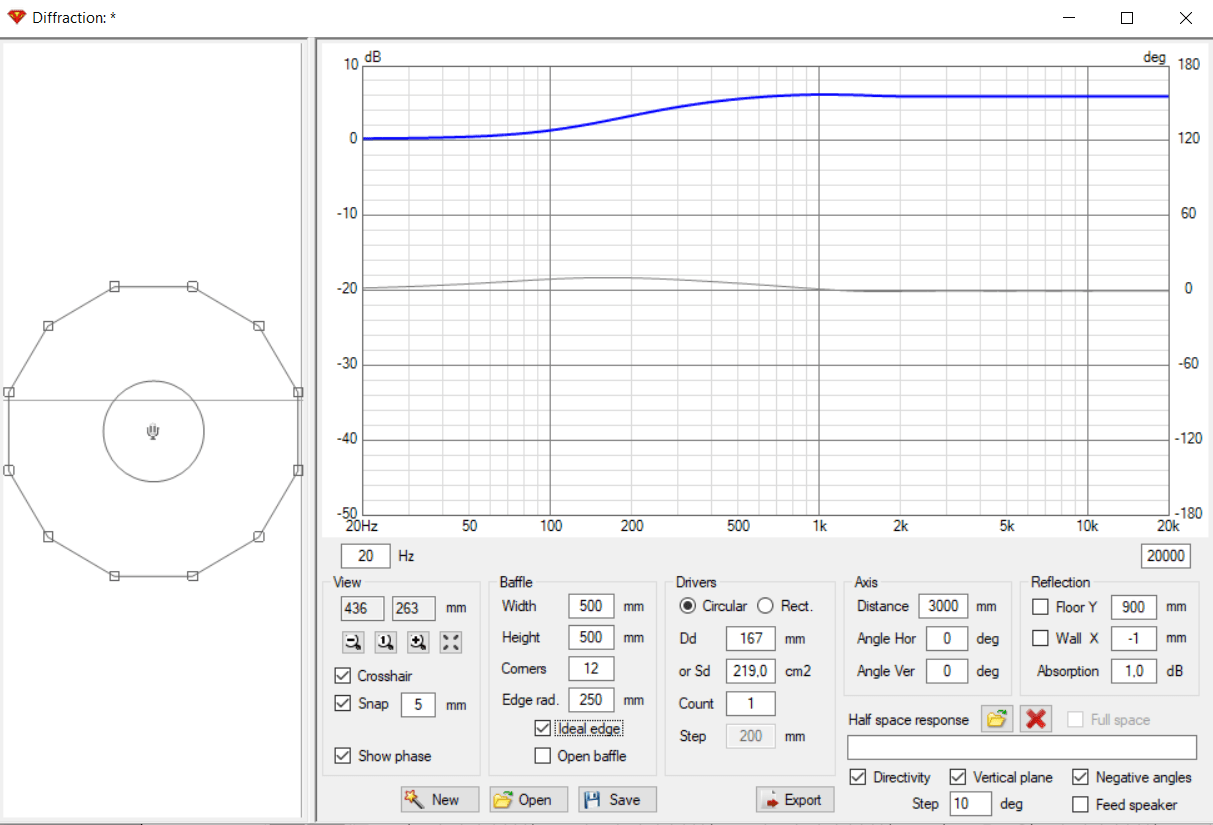

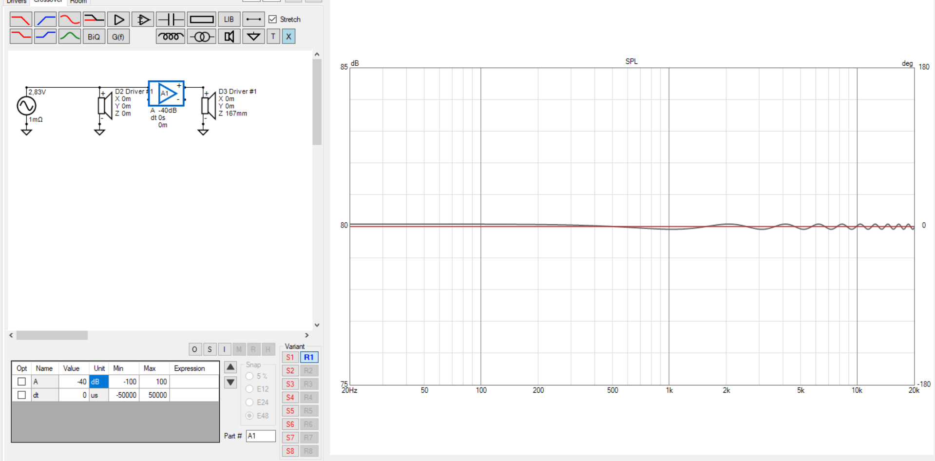

Here the above example again, 50cm baffle with and without roundover, about worst possible diffraction happens on such baffle as distance from the source to edge is constant all around. 50cm is ~700Hz and two octaves below ~150Hz there is still some boost from diffraction (or baffle support, what ever) but not much anymore.

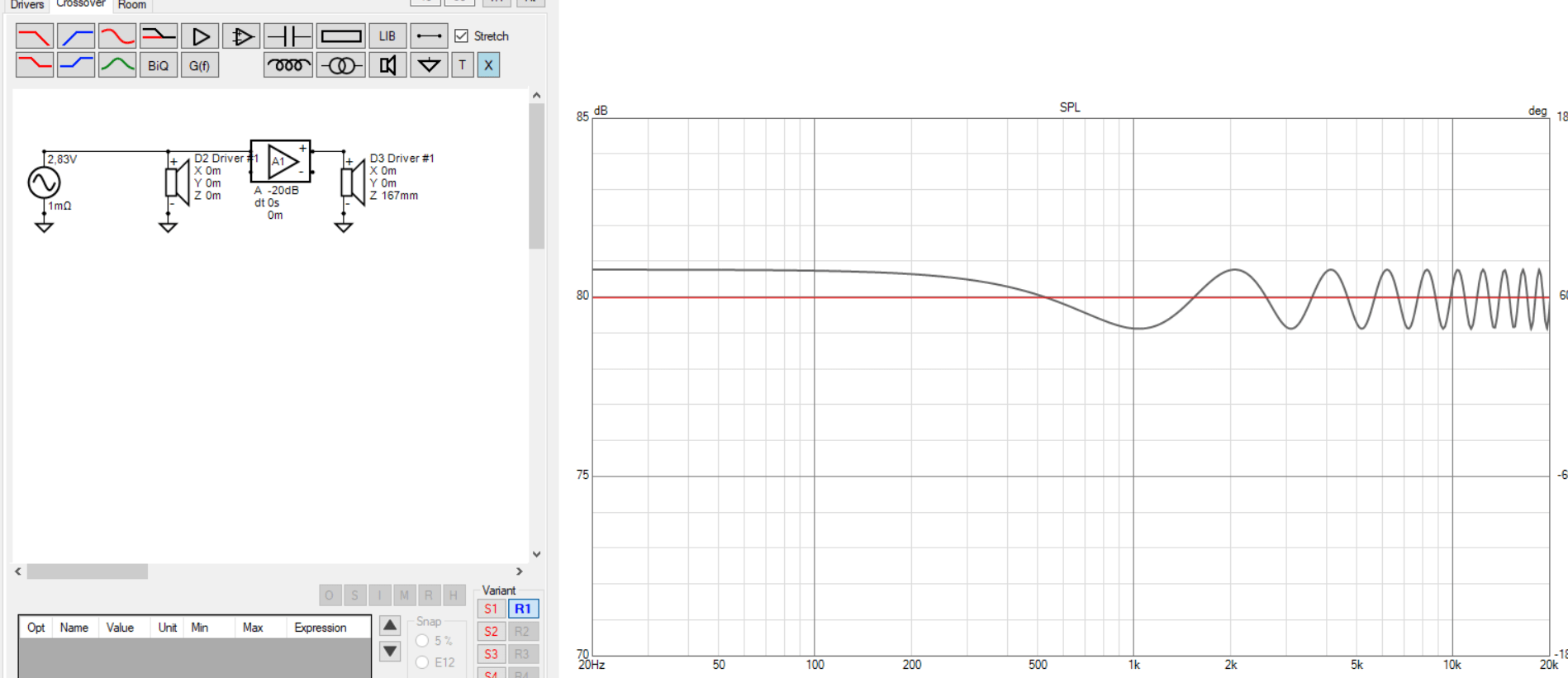

Here, quick test shows that signal attenuated 20db makes +/-1db interference.
To get to 1% relative level the interference needs to disappear, a sphere.

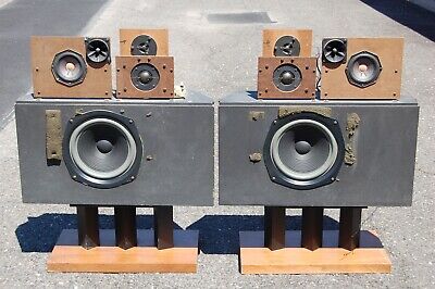

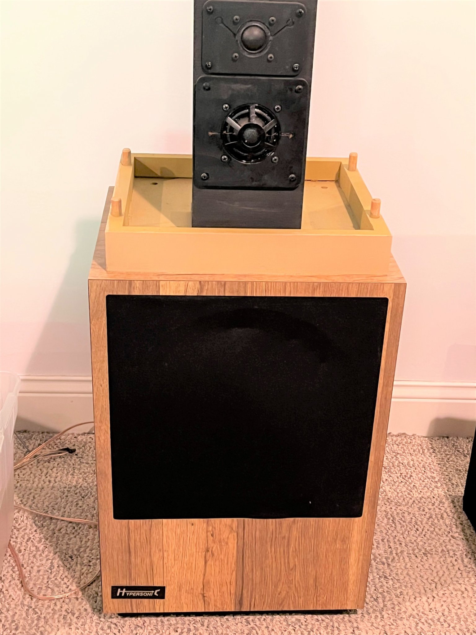

One of the ways to hear what diffraction does is to build two enclosures with the same internal volume for the woofers, same drivers and xovers, one - a more traditional box - and the other a sphere (or 2 more more spheres like the Envy 3). You can make sure all the "ingredients" are what you like (including any phase corrections et al). Then blind A-B them at the same db and in the same room and positional location. What you hear will be quite enlightening. The openness and soundstage are very noticeable. I won't call diffraction "distortion" per se as it is a perceived change in tonality and sound space, falling into psycho-acoustic territory as well.
I first did this back in the late 70s when building box speakers with larger woofers, and dome mids and tweeters. The Dahlquist DQ 10s were introduced in the 70s and had smaller baffles on their mids and tweeters than typical for the day (although they are more than you'd want today). There were 4 of them so it's a complex design. But the sales guy at the high end audio store made the comment on how they sounded more open than other speakers, and to me they sure did. For me it was "wow". So I bought more of the same woofers, mids and tweeters I had used in my boxes, and simply enclosed the woofer in the second test speaker and put a small rack on top to mount the mid and tweeter on each (see photo), They were sealed domes so basically I wanted to "suspend" them in "free air" as much as possible. A Peerless K010DT 1" fabic dome (used in Polk speakers) and a 2" midrange fabric dome (used by KLH at the time). There are of course better drivers today. But the sound was remarkably different, same everything else except the mid and tweeter mounted out in the open (except today I might perhaps place the rack farther forward and maybe a bit higher up). Then covered the top with a screen for aesthetics.

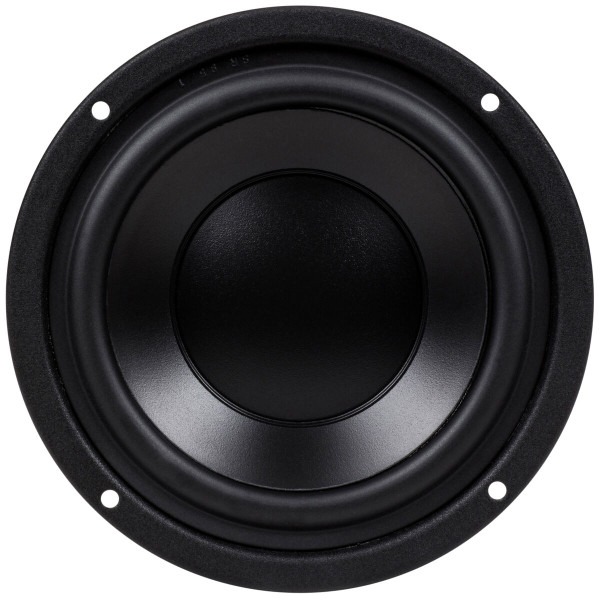

One of these was on sale just the other day maybe the 6.5 version..? Parts express

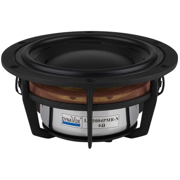

You can get these at Newark for $42, less than Parts Express! (I am not on commission 🙂. There seem to be few other drivers like it, even though it's not as expensive as many other midwoofers that are available from other manufacturers. They also make one in yellow if you like color.
https://www.newark.com/dynavox/lw5004pmr-nm01/5-25-pp-mica-woofer-80-watt-6/dp/78Y7663
The Dynavox 1 1/8" dome tweeter D-2801XL-M01 looks nice also with smooth FR graph and decent power handling, but have used a Dayton version with a built in screen.

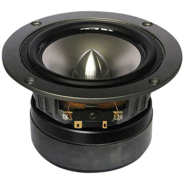

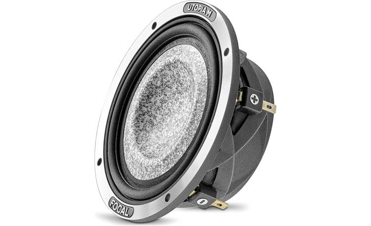

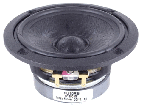

My thinking has been that deeper cones (and larger ones) produce more of the diffraction effect than shallower ones. There are big differences in cone depth among 3"-4" cones for example that are designed as mids. Also the role of the dust cap size (which also produces sound) vs. having a pole plug and no dust cap. Attached pics show several examples of shapes for 3 1/2" to 4" from traditional cone with small dustcap (Seas), to larger cap (Morel), to coil plug (Tang Band - but deeper cone) to slightly concave (Utopia - real expensive) to domed (Peerless - budget range). Diffraction of course is not in the specs. So if you're concerned about these effects do you want the Seas vs. say the Morel or Utopia (get your wallet out for the latter)? How much do designers factor in coil size to cone ratio and/or the dustcap size to cone ratio?
Domes of course get mostly around that issue. Traditional mid domes need to be crossed between 500 - 800 Hz so the woofer is picking up the lower mids from 150 up. Do you want say an 8" deeper cone producing 500 Hz? This is in the middle of the vocal range. Also many orchestral instruments in their lower ranges.
