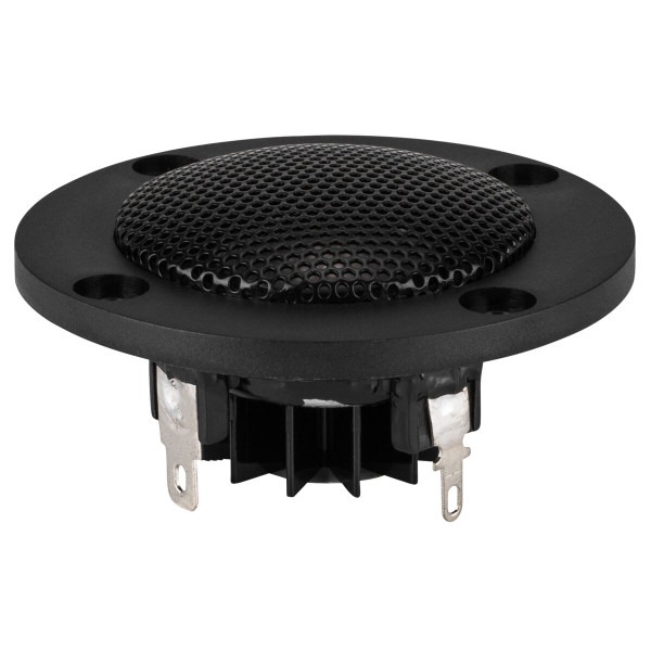

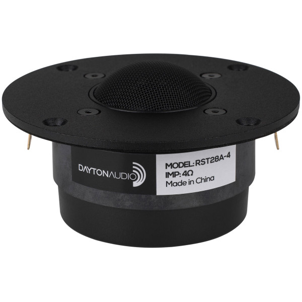

Yes some drivers have large mounting plates. The Dayton 1" dome tweeter ND25TA-4 with nd motor is pretty small vs. the Dayton 1-1/8" RST28A-4 with a traditional ferrite magnet. The type of motor makes a difference.There are more reasons than raised output alone why horns can be an interesting choice. Should be easy to find those reasons too 😉.

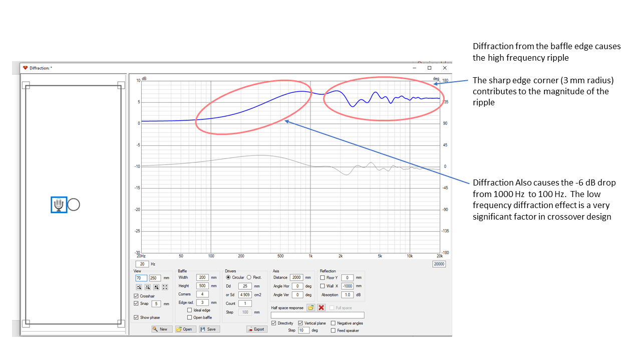

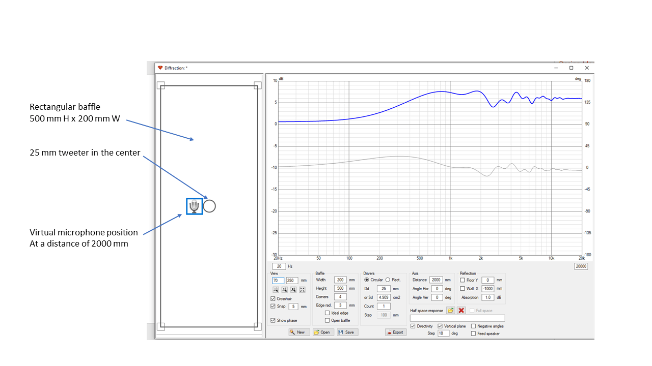

Skfisher, I think we might have a problem with terminology.

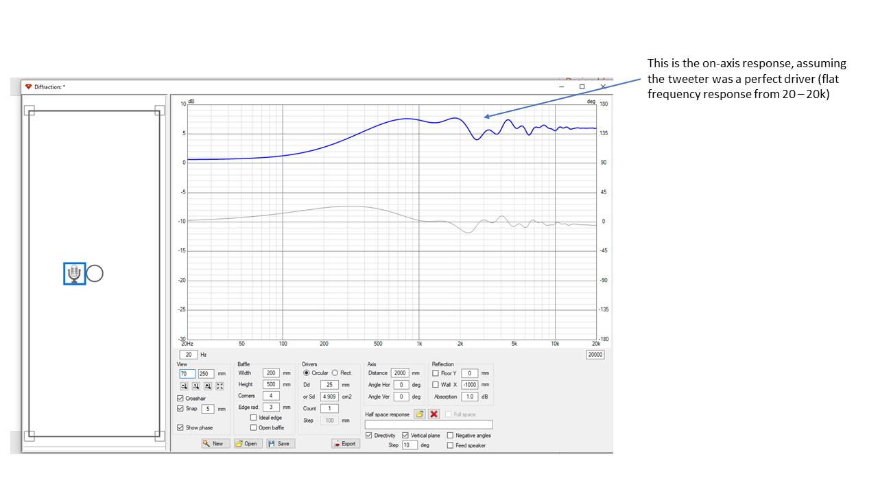

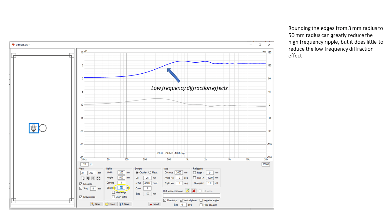

I put together some graphics to explain it. This is a simulation of a simple 500 mm x 200 mm box, with a standard 25mm tweeter in the middle. This simulation assumes the tweeter is an ideal perfect driver, so it has a flat frequency response from 20 Hz to 20 kHz.
So this is what is meant when we say that
J.
That lower output below 300 Hz is the result of diffraction. Diffraction is not just the high frequency ripple. It is also the drop in SPL as the frequency decreases. The driver transitions from 2-pi to 4-pi radiation. The shape and frequency of the transition from 2-pi to 4-pi is actually more important to crossover design than the high frequency ripple is... even though the high frequency ripple looks quite alarming.Yes these are Olson's charts, all of the charts show a lower output below 300 Hz,
The sphere still has the transition from 2-pi to 4-pi radiation, and with it comes a -6 dB drop in SPL.A sphere diffracts. Smoothly, but it does.

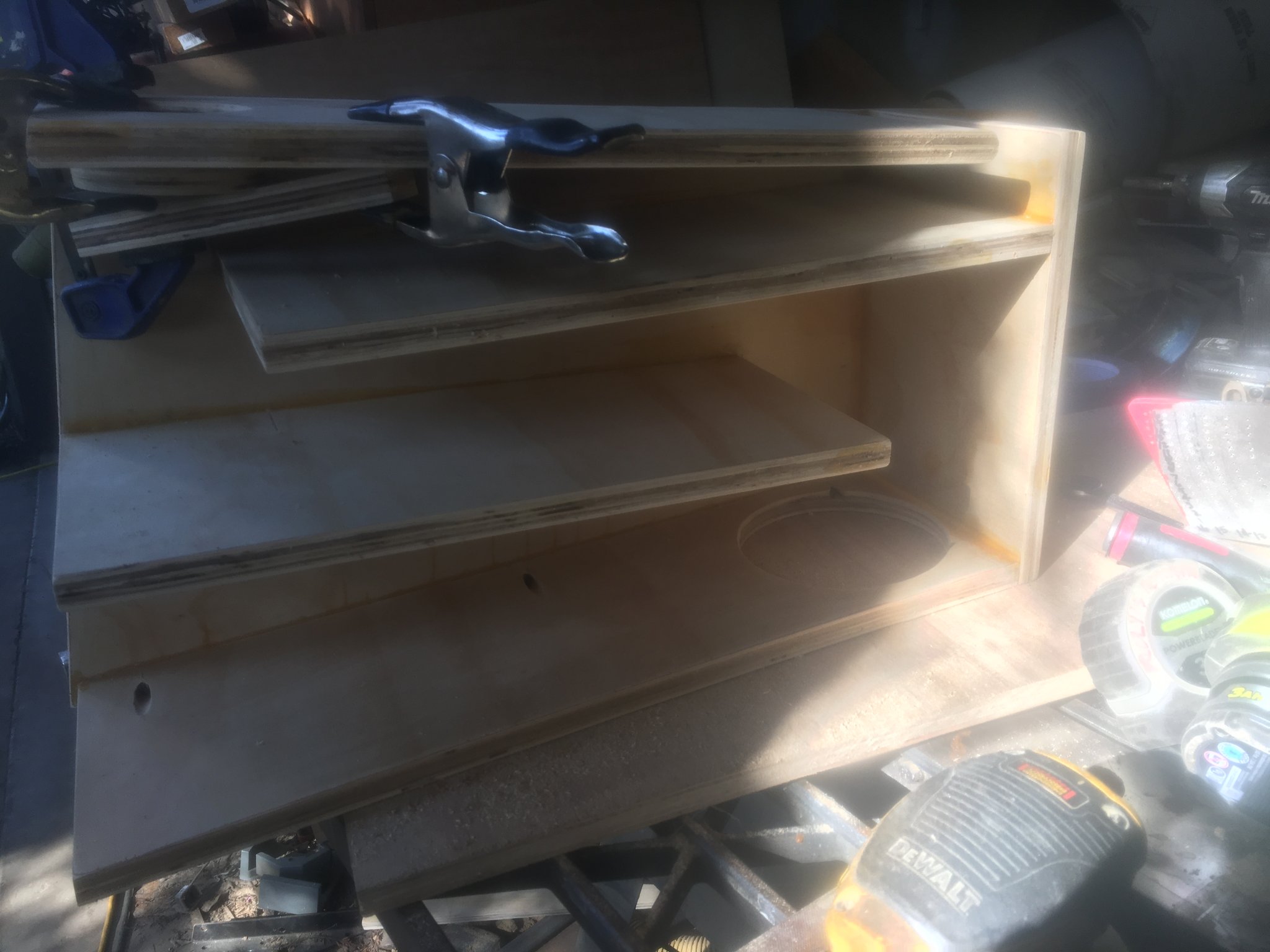

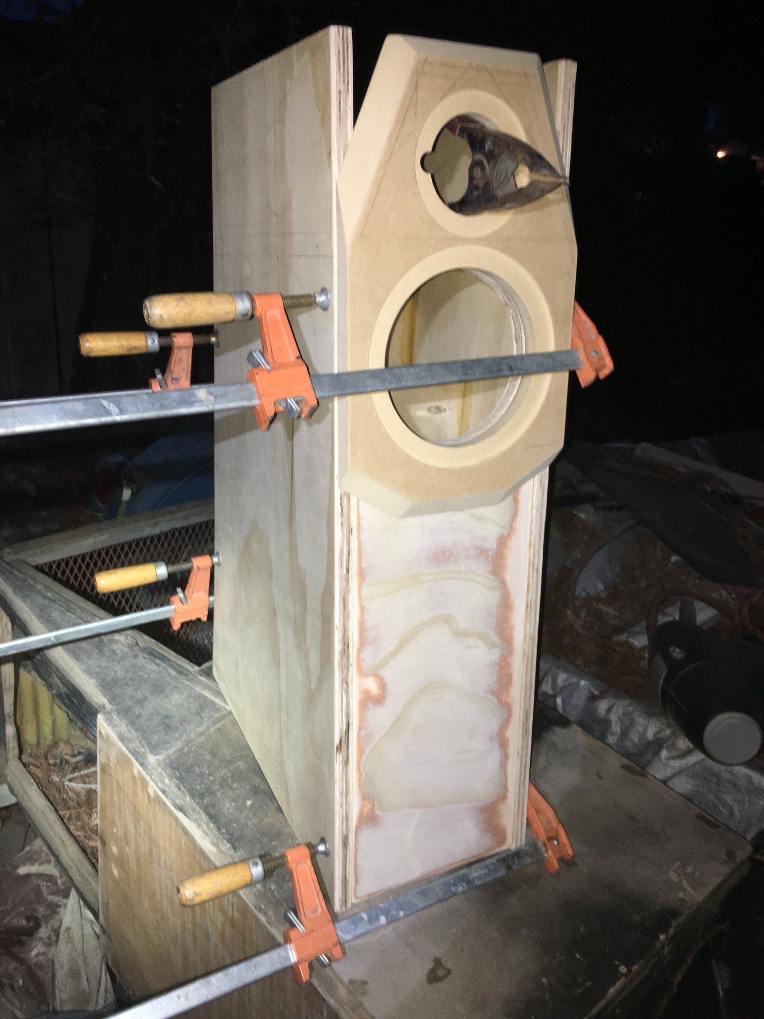

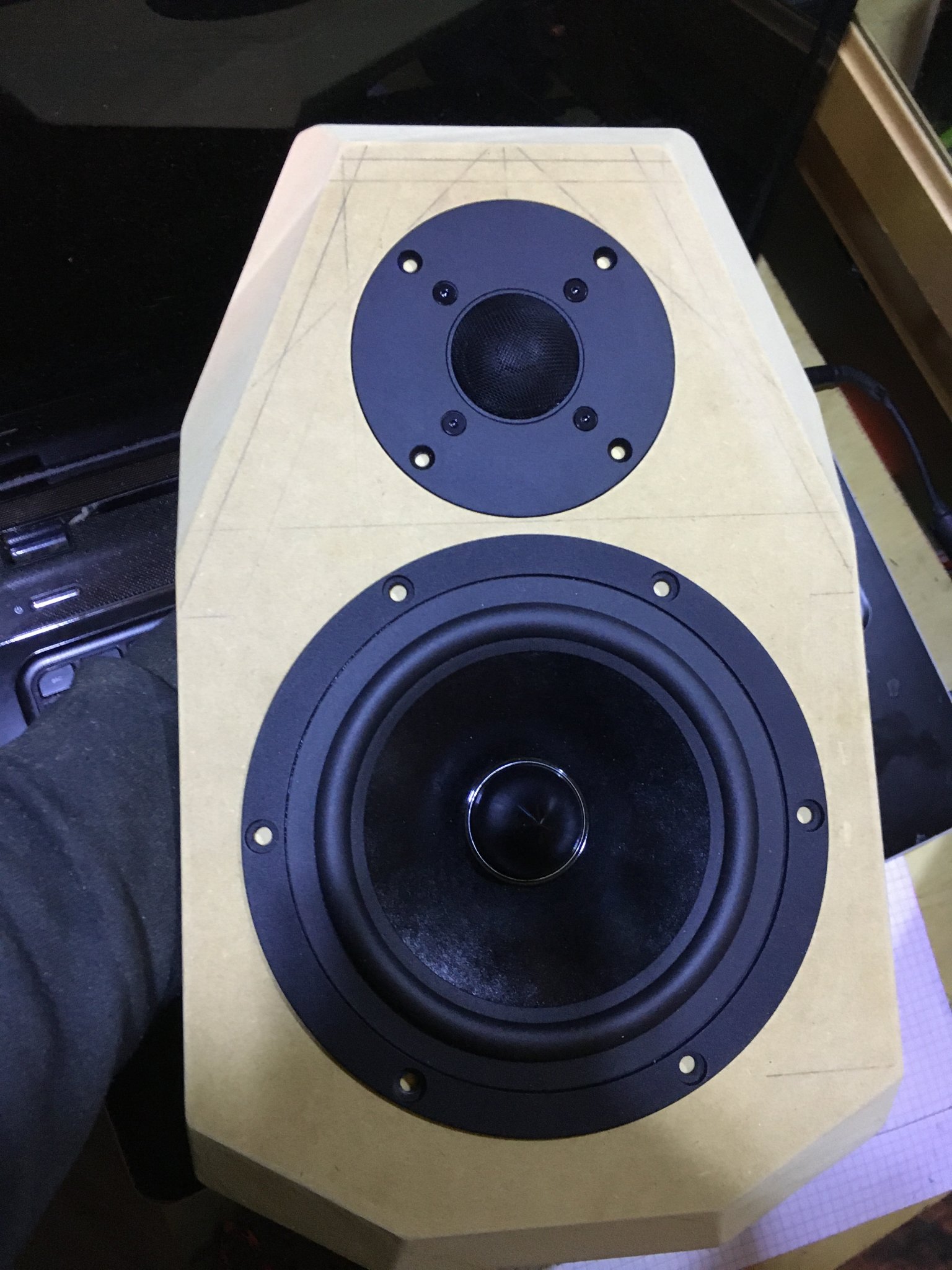

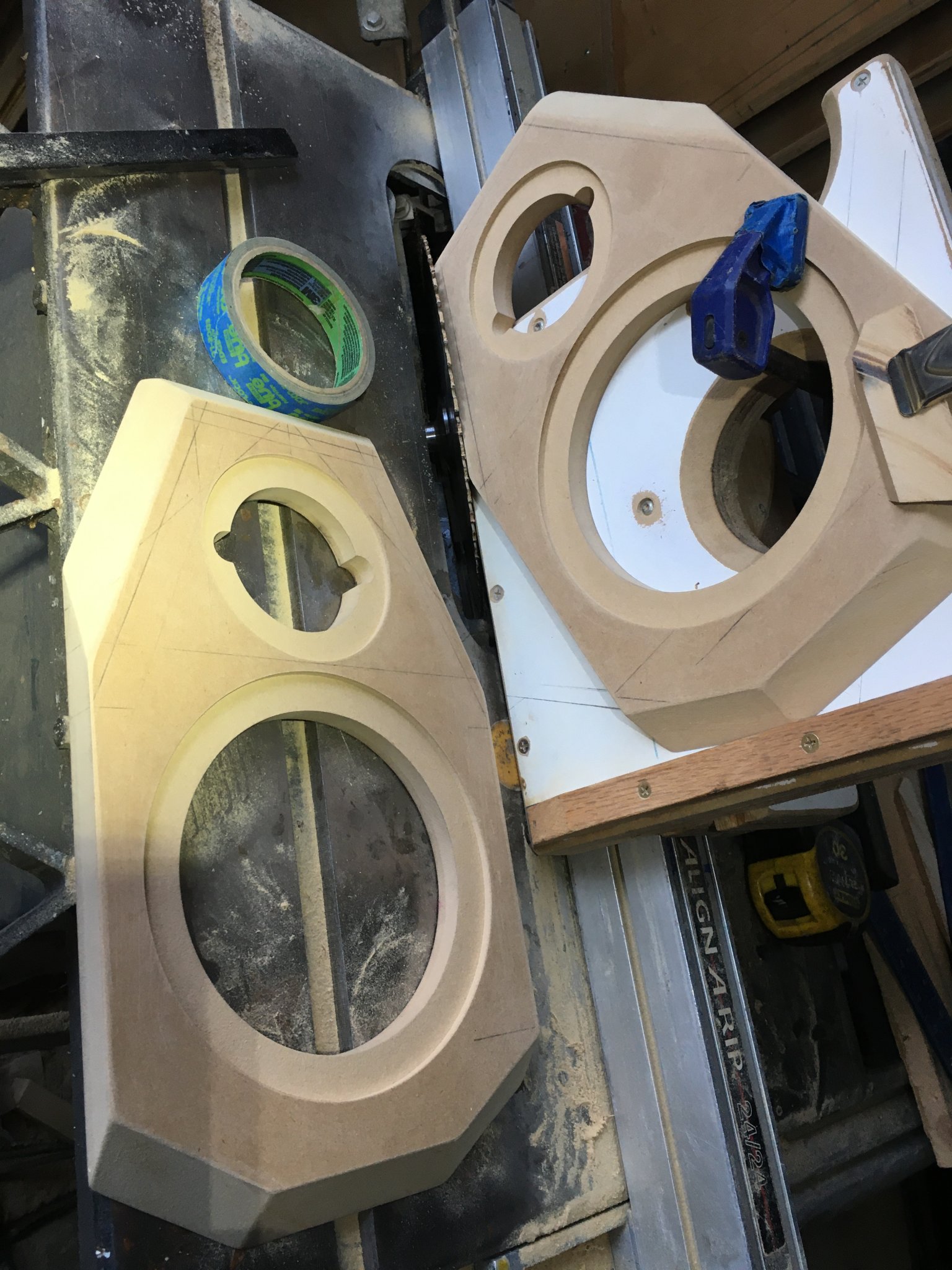

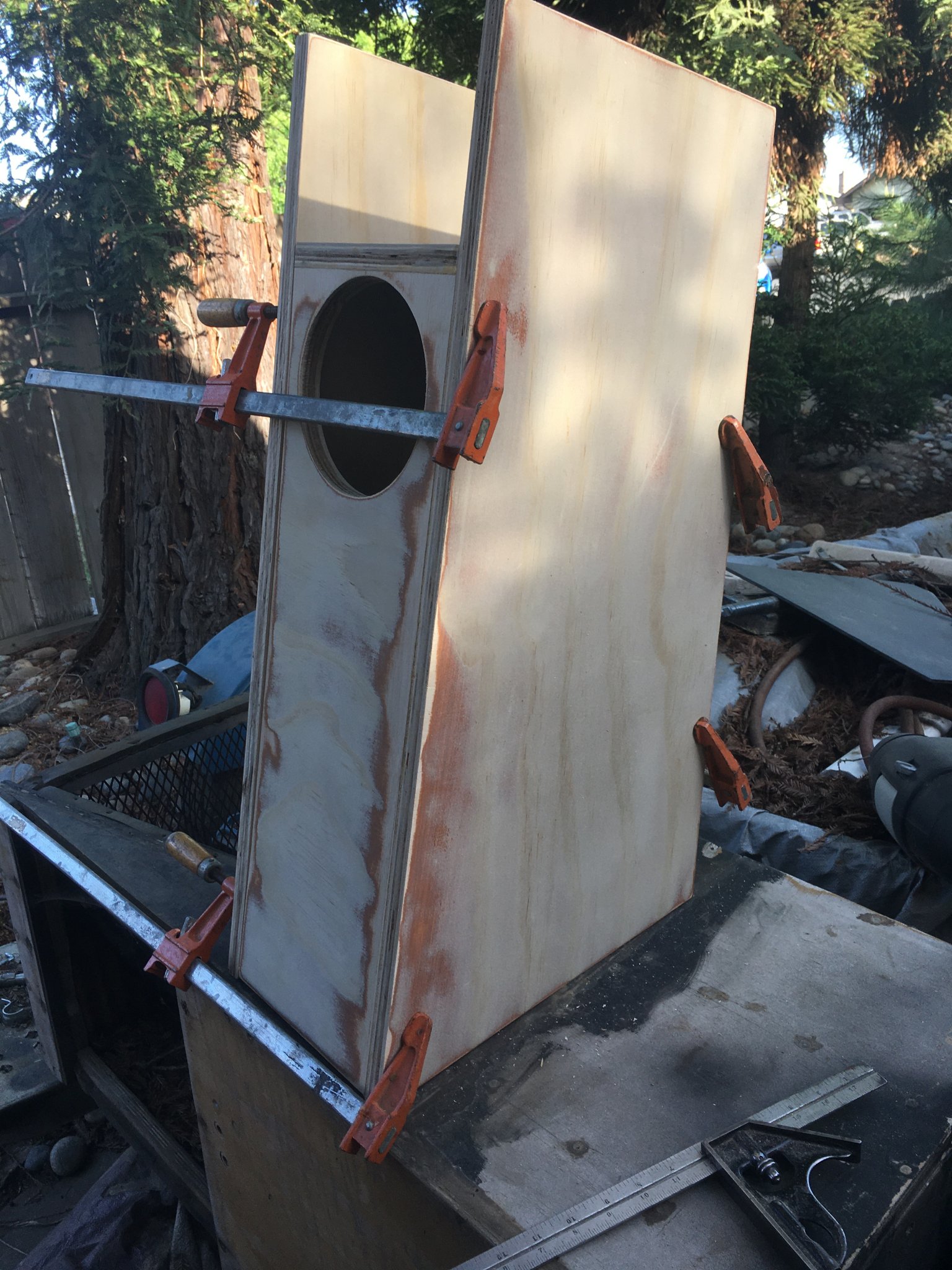

Best i (not saying much) could do with the dayton rs series
