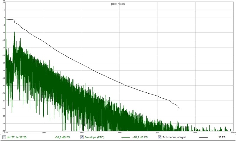

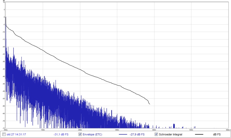

IR as measured at the listening spot, far left is the IR peak, then about ~17 to 20 ms of a reflection reduced zone (-20 dB), followed by the Haas kicker.
Without the Haas kicker:
Recorded at the same spot, just without the Haas kicker. The reduced early reflections allow me to listen to room queues as recorded
instead of listening primarily to my own room. A studio would drop down about 30 dB though after the initial peak, no contest there.
It still is a relatively normal living room.

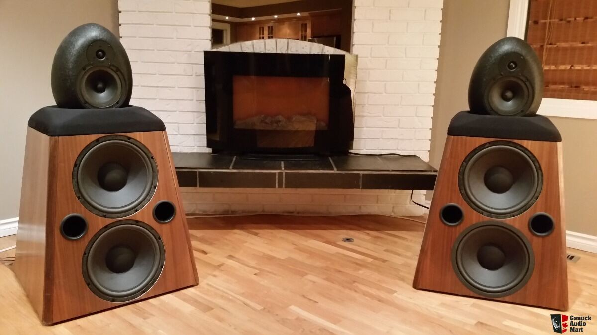

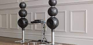

Since spheres are a viable alternative to "boxes" to reduce diffraction, and aren't hard for manufacturers to make (using say injection molds rather than wood), and you can easily insert an offset object inside if there is a standing wave concern, why don't more companies make these? Is it just tradition or marketing people figure most consumers won't like a round speaker enclosure? The pic shows the Demand Better Audio Envy 3 (ok I did take a peak at it as a model for my recent 2-sphere DIY), I think this looks REALLY COOL. But maybe most people don't?
Well, that particular loudspeaker looks to me like if would have very low WAF. I woundn’t want them in my living room.

I agree that the bass enclosure integration could be better aesthetically. I like the way this was done better in the B&W801. I don’t like their current ones.
You could always do it like Vivid, 4 TLs in these:

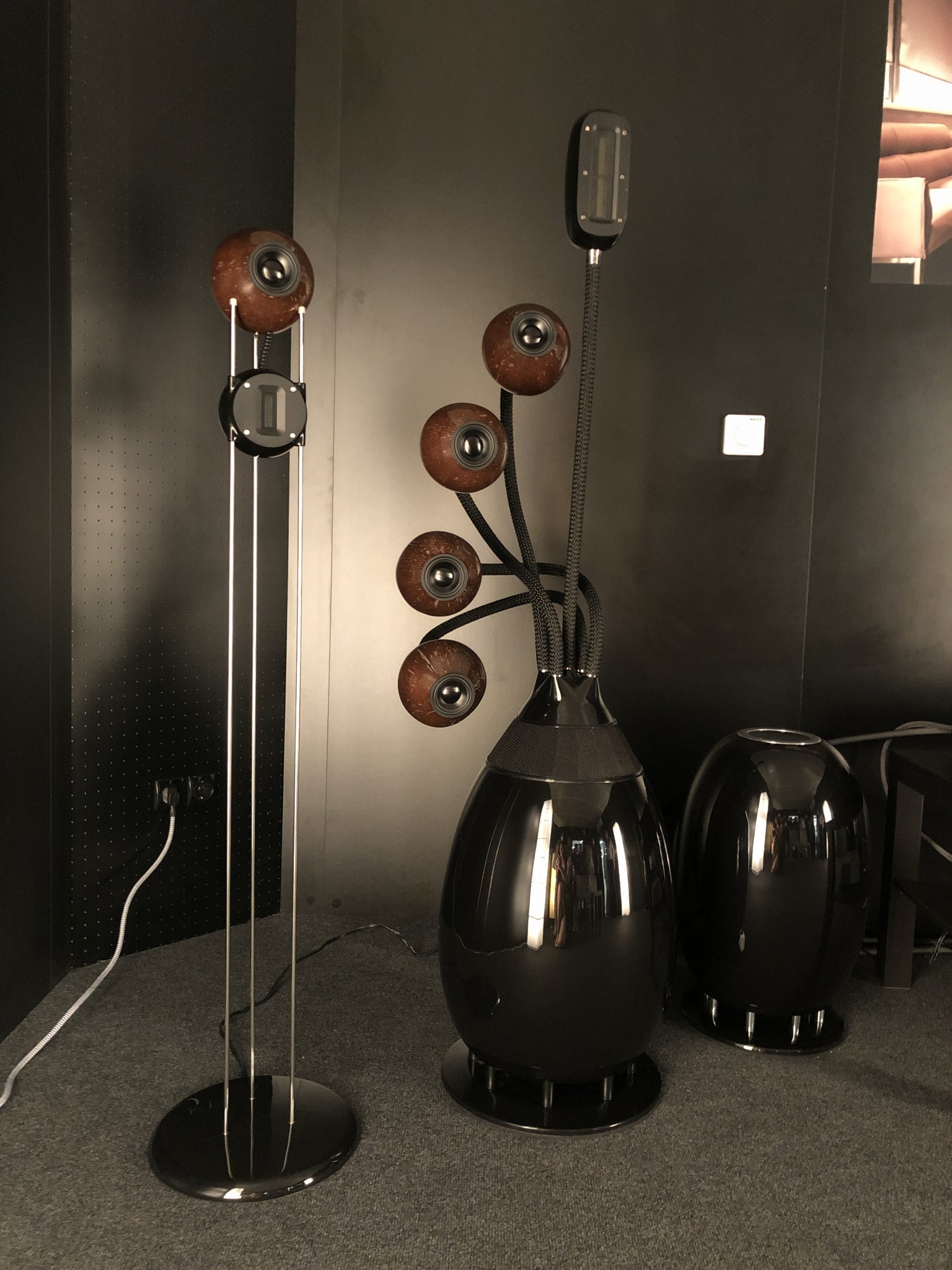

Now you want to see some truly unique speakers, the Copras from a guy in Odessa Ukraine. He says spent 10 years designing these and the articulated spheres can be positioned how you like. Truly cool and innovative. These are truly a statement in art as well as sound. I hope he is ok still with what's going on over there. https://copra.ua/enI think you don't know how the LX Mini looks like.... the sphere is positioned on top of the cylinder. But of course since you are not using open baffle, you can cross at a much lower frequency... Maybe more accurately it will look closer to a Pluto with a sphere at the end.

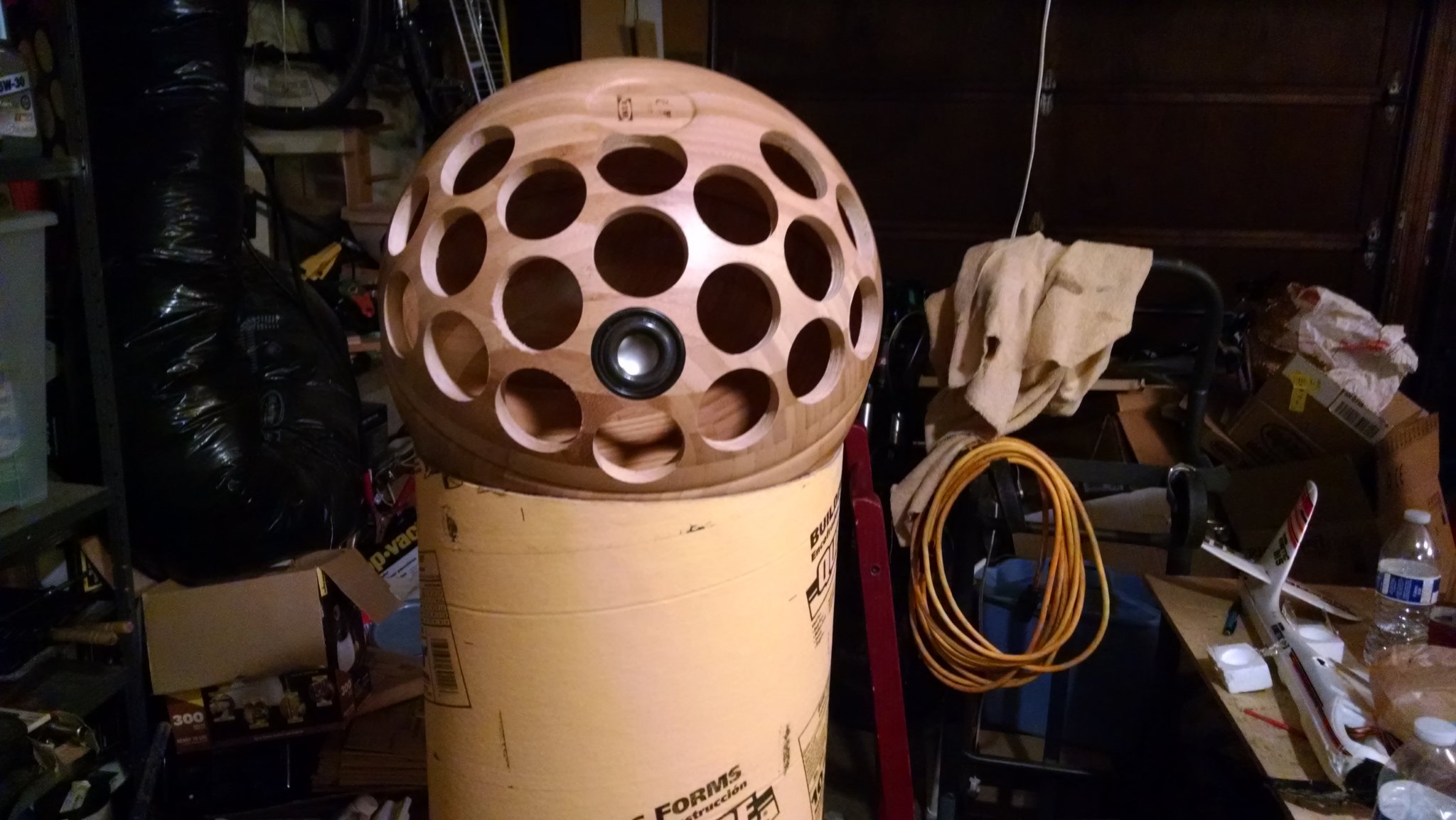

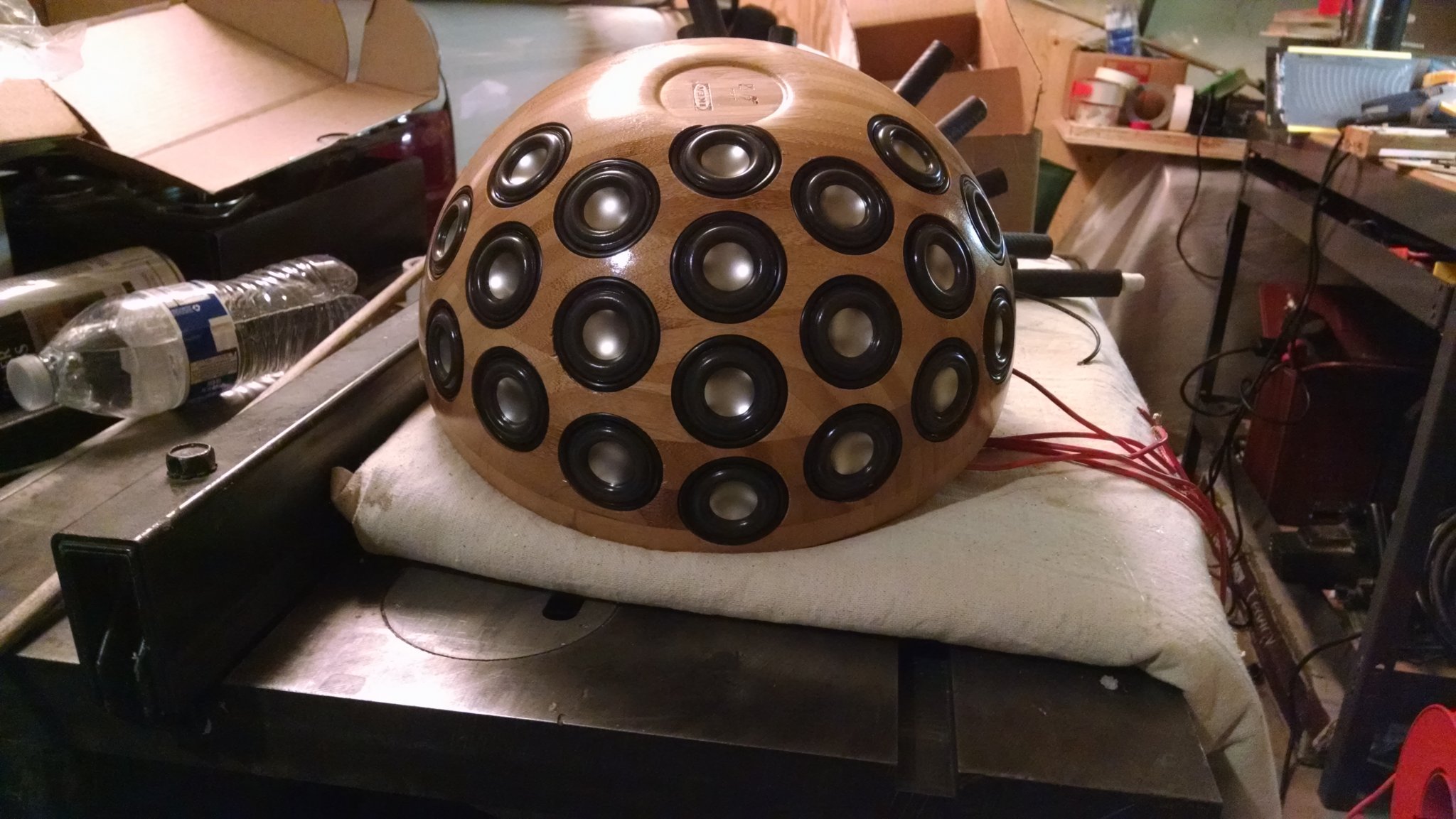

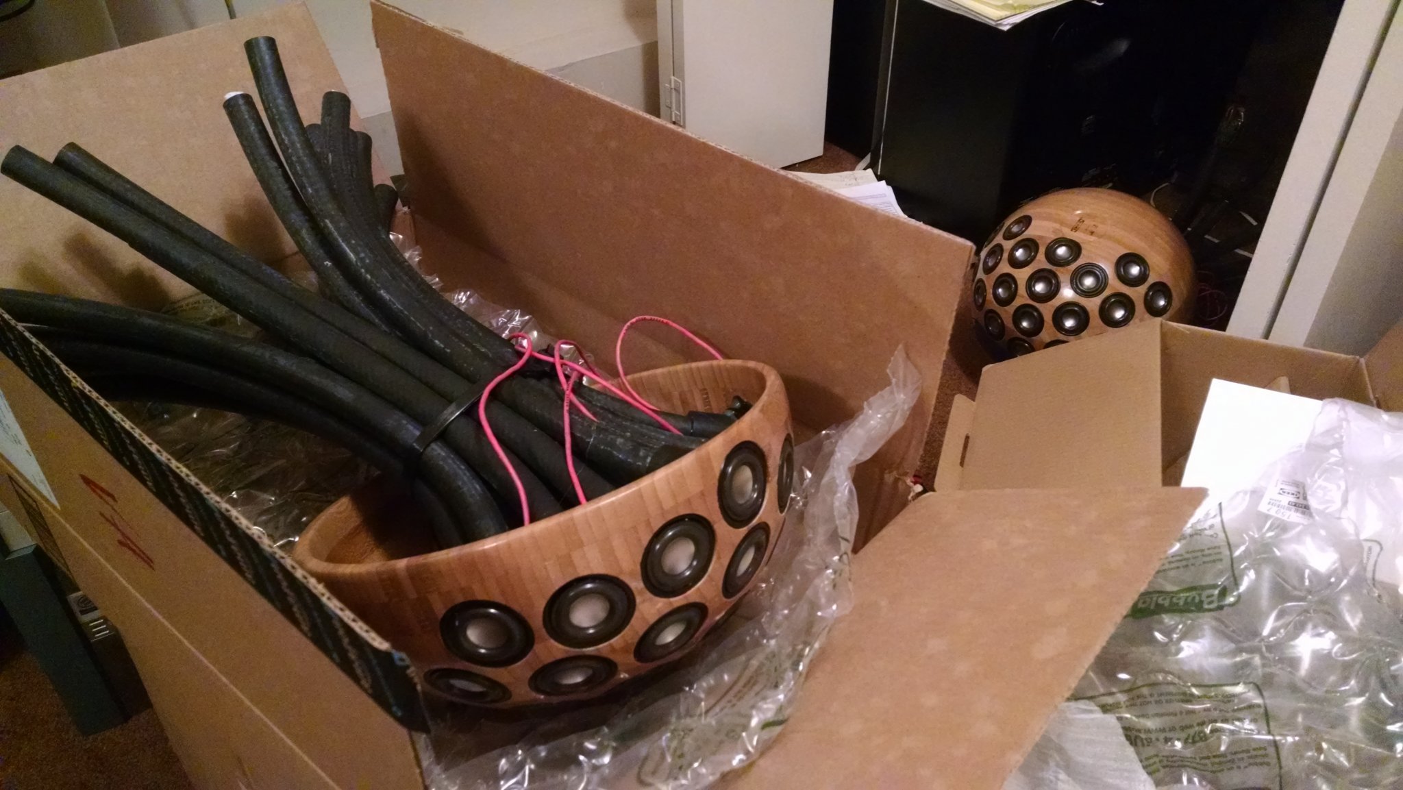

How to build a spherical speaker? Drill lots of holes in an Ikea bowl and mount 1" Aurasound drivers. To get the optimal impulse response from each driver I mounted a segment of car heater hose stuffed with acoustic foam to each one to terminate the back wave. Results? So these drivers individually have a very flat frequency response. Grouped around the sphere together there is cancelation of the upper frequencies due to the proximity of the drivers, so that the response rolls off a lot. So high frequency boost is required to get a flat response again. The other thing I learned was that when you punch that many holes in a spherical shell it gets a bit flexible. So this resulted in a lot of sound coming out of the back of this bowl. Weird as all these are sealed on the back. So the cabinet is flexing. So I expect if I filled the bowl with wax or expanding foam or something to stiffen it and kill the resonance that would help. I stuffed some foam in there and it helped some. I'm currently thinking of pulling out the drivers and using the 3D printer to make geodesic dome segments to mount the drivers in. I may try to sell these rather than destroy them if anyone is interested. If I could recover the cost of the drivers I could just buy more for the next project.
This is pretty amazing
so I might be the only 4-sphere diy guy but this has to be the most drivers ever 🙂
Question how is base ? Or needs a sub
And why not less holes and say 2 in or 3 in drivers ?
