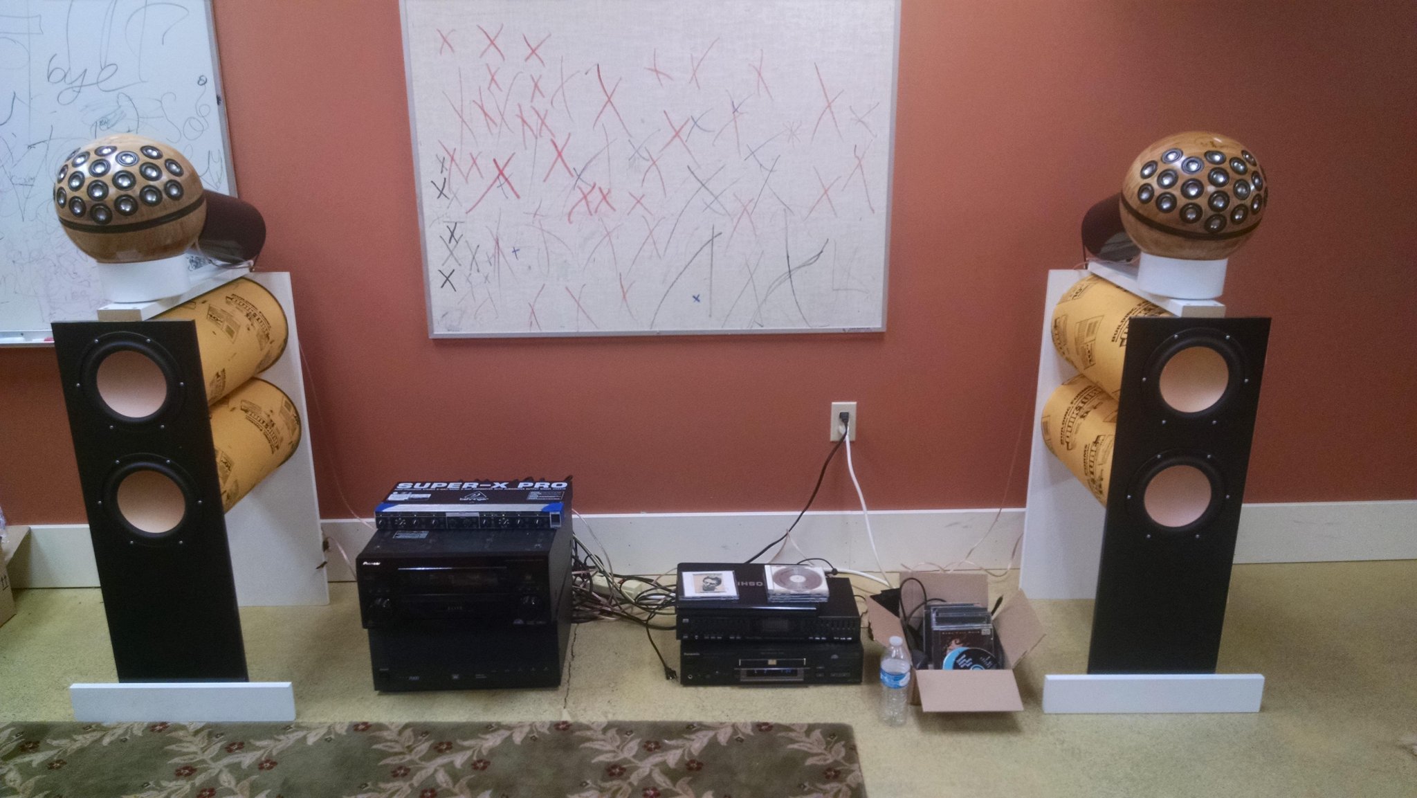

so I might be the only 4-sphere diy guy but this has to be the most drivers ever 🙂
Question how is base ? Or needs a sub
And why not less holes and say 2 in or 3 in drivers ?

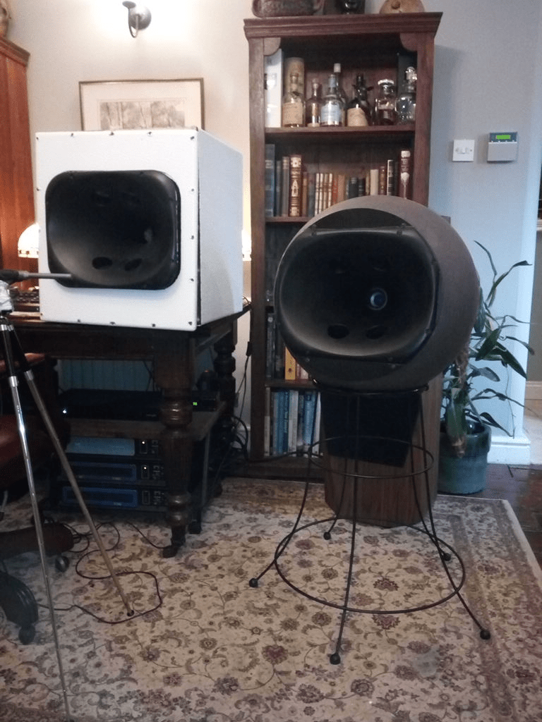

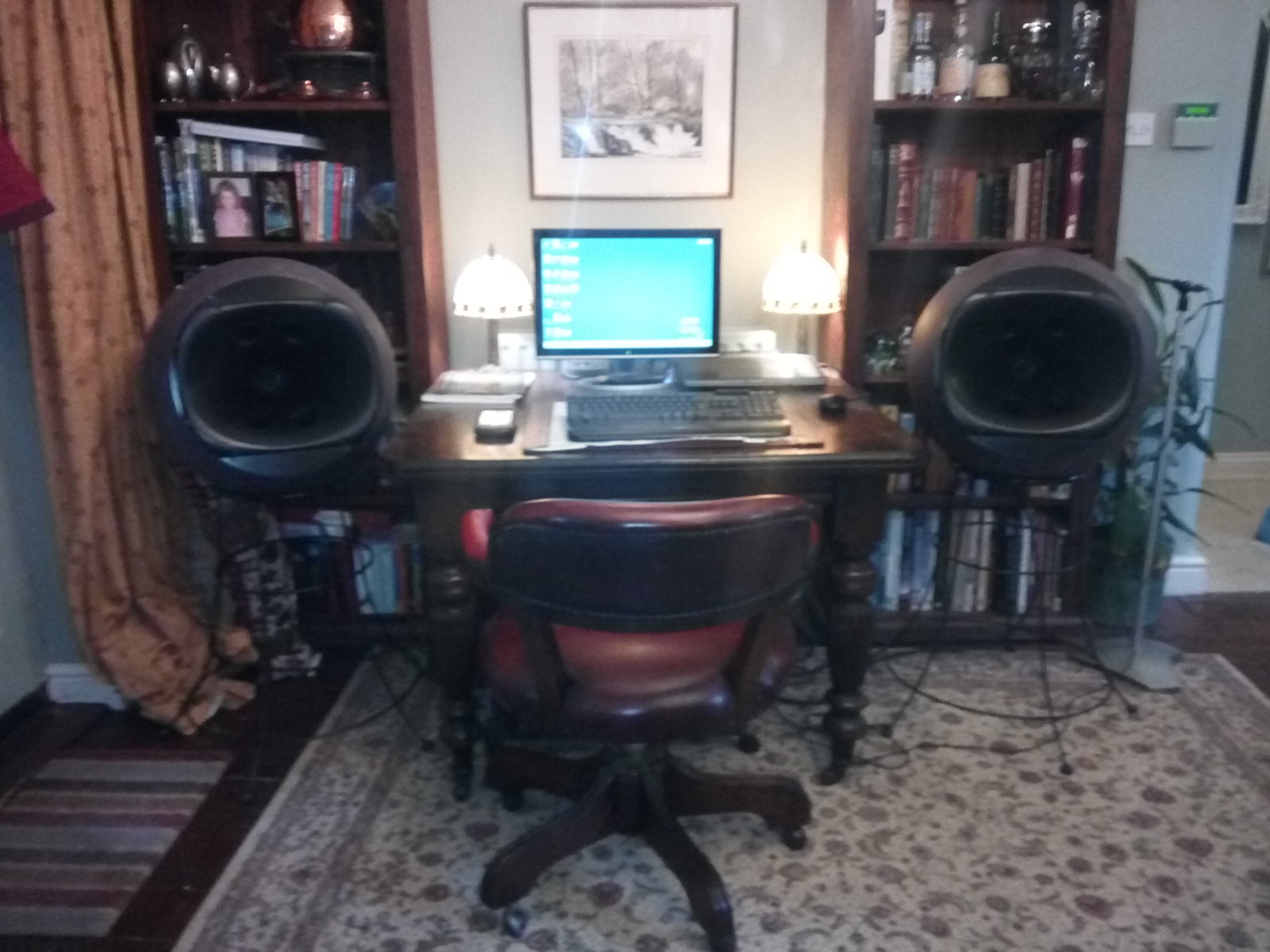

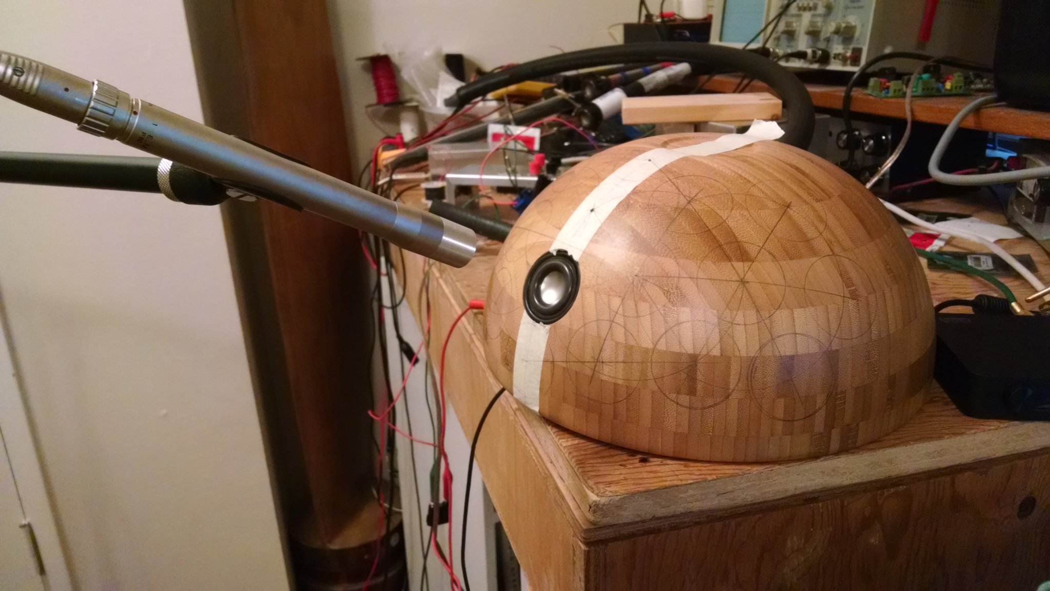

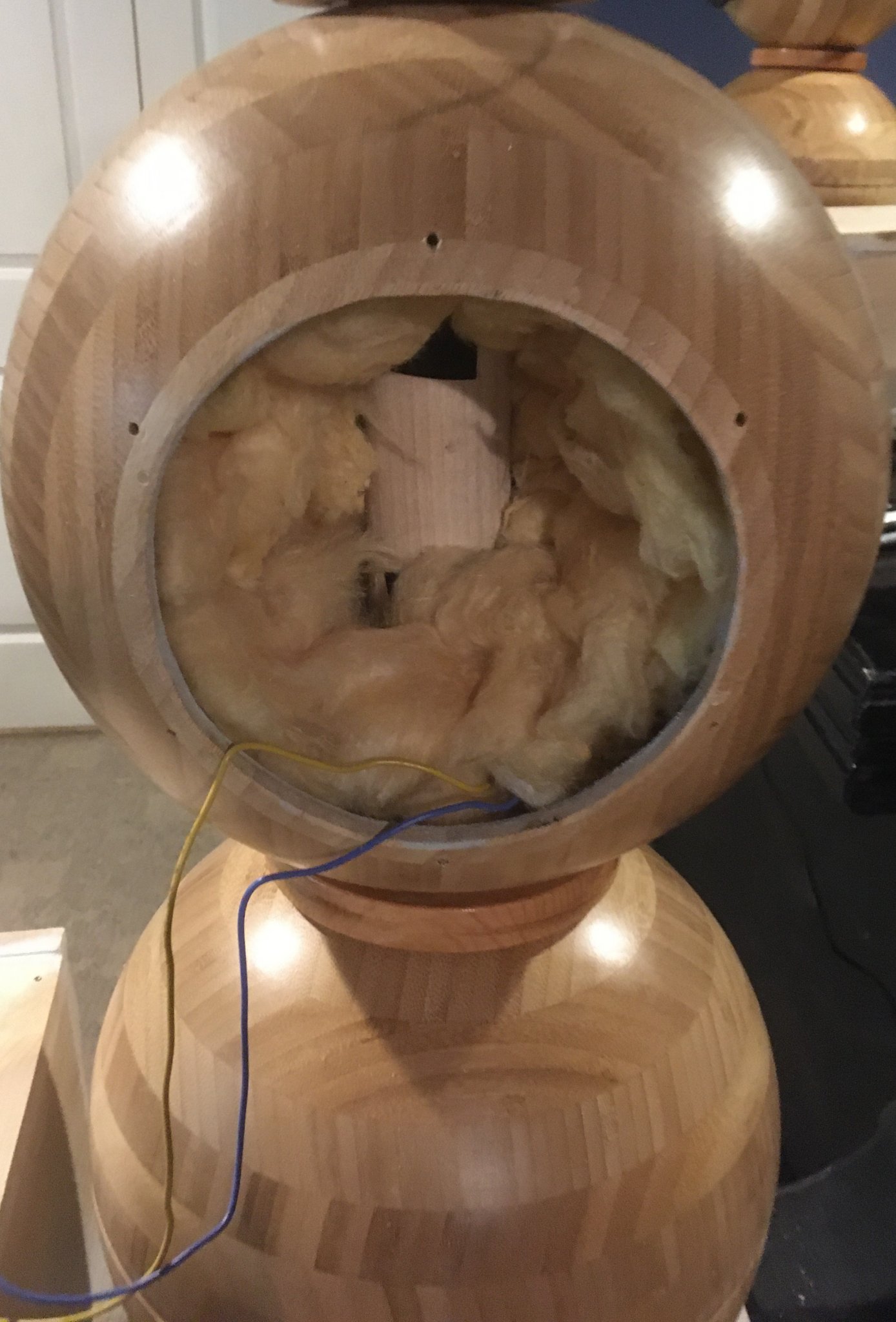

I have made many sphere based enclosures, it is child's play to put an internal brace/braces which essentially creates two hemispheres or more subdivisions each with constantly variable diameter (no flat surfaces).
Also stuffing well with glass fibre or similar really does absorb a huge amount of any internal mess if you can't place internal subdivisions.
Failing that, if you have no stuffing to hand, no wood to make a brace, then simply ensure the constant diameter is outside the passband of the driver - just like sensible subwoofer construction.
The 'internal mess' you talk about is not a problem with sensible engineering, and the diffraction implications are on my measurements, much more than a novelty.

View attachment 1074893View attachment 1074894View attachment 1074895

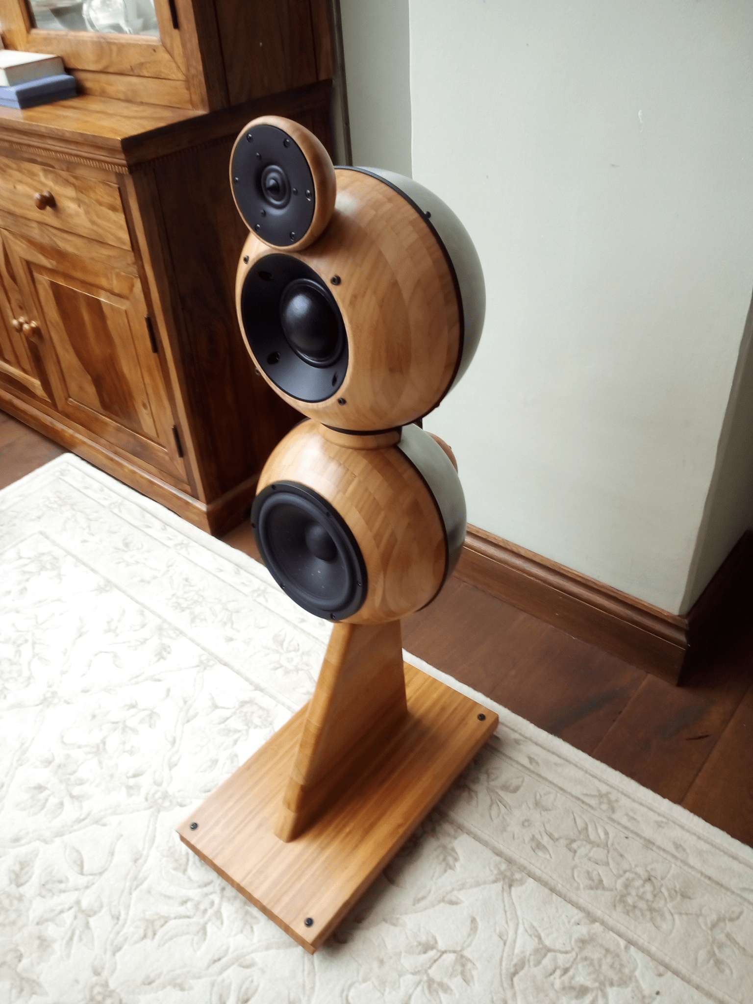

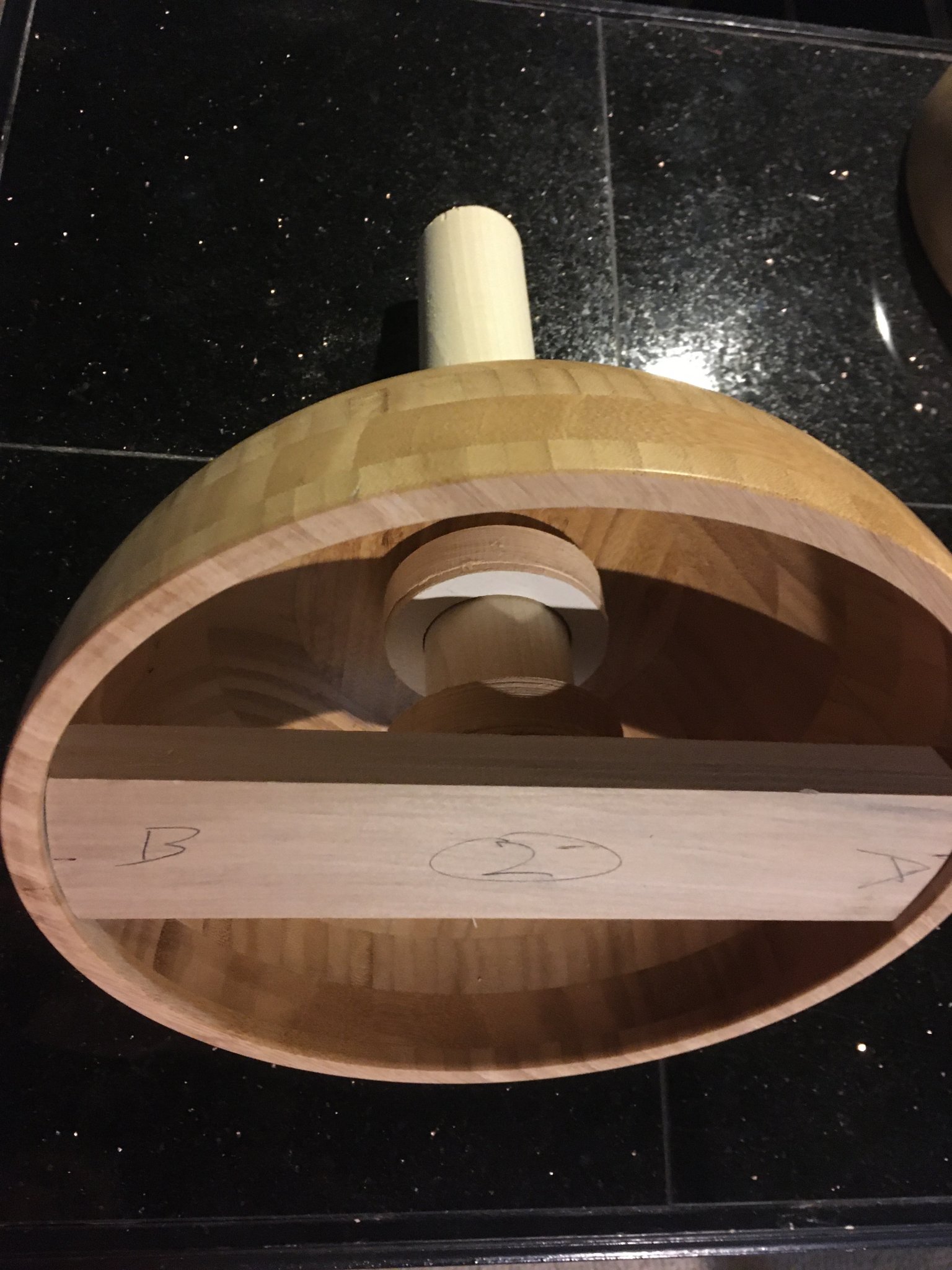

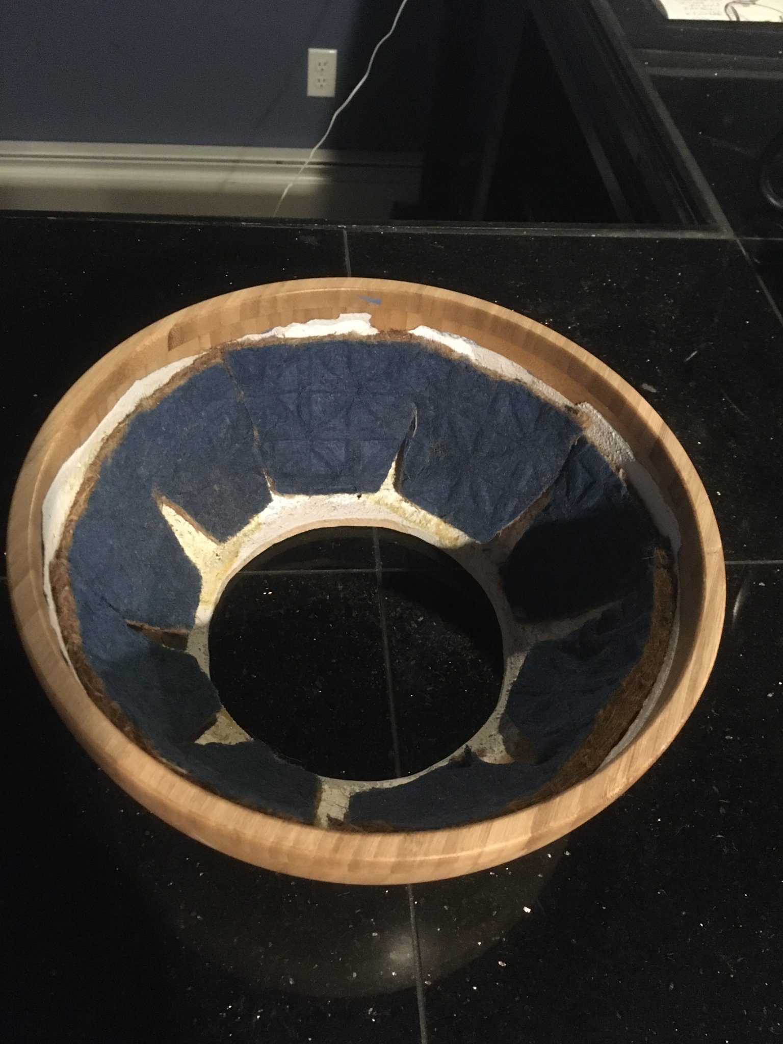

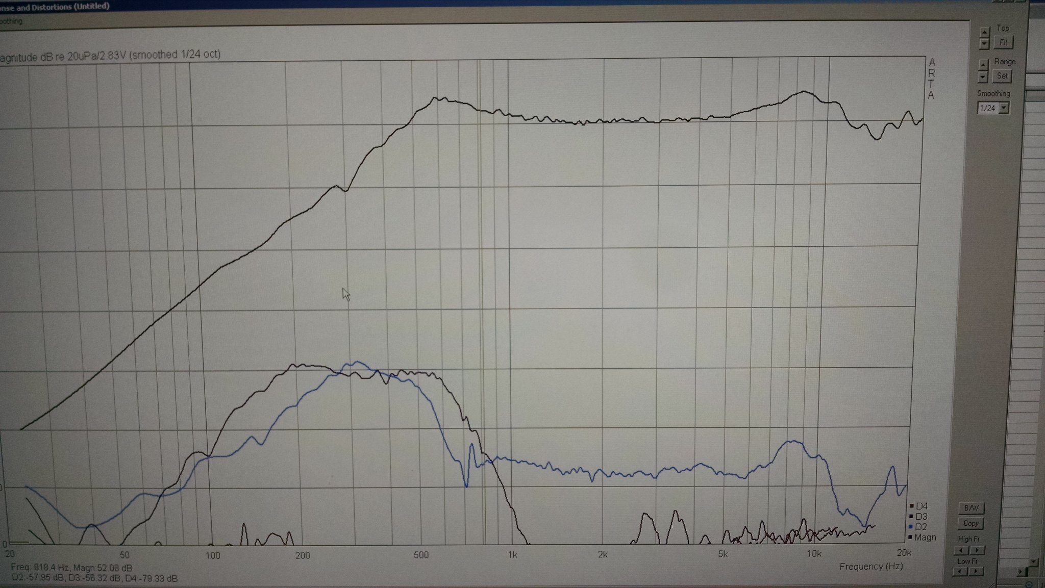

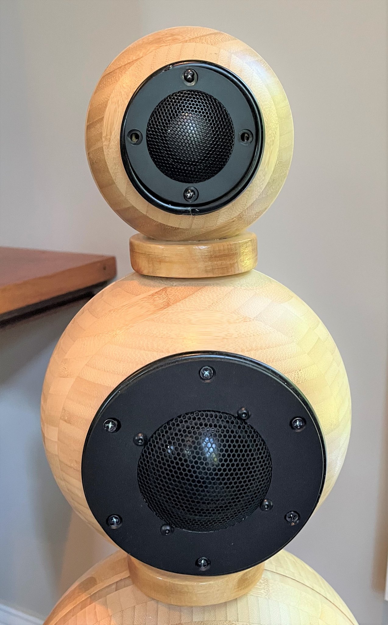

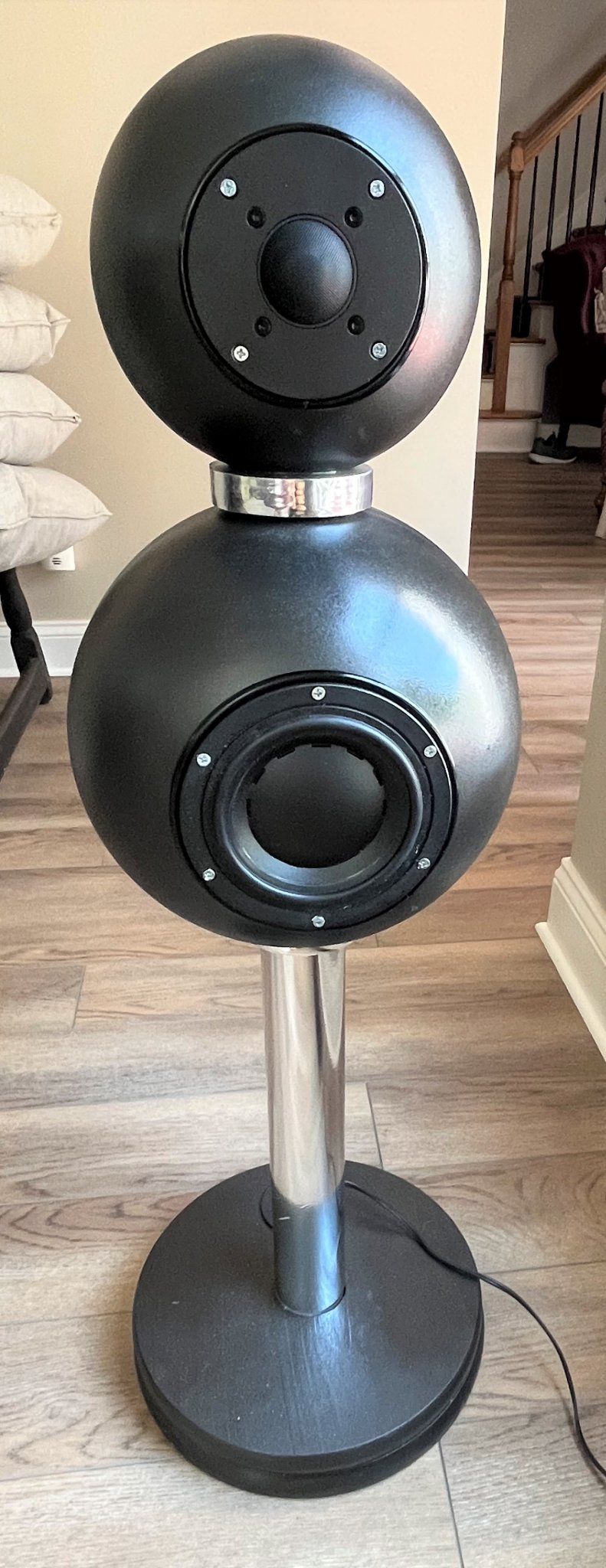

Can you post a couple pics of these spheres you built? Always cool to see other's stuff. I attached 3 pics, A) one that shows two damping approaches to tame any resonance - 1) use of thick latex paint with some cement powder mixed in to make it like cement board, and 2) gluing in rug underlay on that. Then fiberglass was also used before drivers installed (pic B). I don't like any bass reflex stuff, just the sound that comes out the front. Then the other pic C shows the bottom subwoofer sphere under construction, where the sub is down firing (I like shaking the floor a bit for the psycho acoustics even though some don't like stray waves bouncing out - but sub is low bass), and used a cross brace that also holds the center pole onto which other spheres were mounted (woofer, mid and tweeter). I did get a feature on the Ikea Hack website, even though they don't look for audio purity rather design and construction. These do get high WAF and she likes the Ikea wood finish.I strongly disagree.

The second pair I built since are simpler, with two spheres painted black and 5-1/2" mid-woofer and 1-1/8" tweeter plus accompany 8" sub front firing. Crossed to sub at 100Hz, 12db slopes. Pic D. Sorry this pic is a bit distorted.
The standing waves being concentrated or aligned to one frequency group (harmonics?) due to a constant diameter of the enclosure can be a large benefit if you plan for it. To have them totally aligned you would mount a driver on a flat panel with a half sphere enclosure mounted on the back. This way the path length from the rear of the driver to the spherical enclosure is equal in all directions. Watch closely. For a given desired volume the sphere will produce the shortest path length for that reflection as opposed to using the typical monkey coffin with the driver offset and magical "golden" ratios for the different lengths of the sides. The half sphere will have a first resonant frequency that is much higher than the lowest internal mode of the monkey coffin. As the effectiveness of damping material improves with increasing frequency it is much more likely that the lowest mode of the half sphere can be absorbed below audibility by sufficiently dense stuffing, where as the lowest mode of the monkey, maybe 1/3 the frequency, can't be sufficiently damped and that coffin will produce that box sound that we are all too familiar with. Most people enhance the problem by restricting the damping to an inch thick pad on just a wall or two. You may not have noticed that mounting a driver on a spherical shell does not produce the same path length for reflections in all directions from the back of the driver. So what is the problem? In fact the driver is not mounted at the focal point for the wall behind the driver, it is not in a position to effectively pump energy into the uniform length mode of the sphere. That would require venting the back of the driver at the center of the sphere so that the energy would then have an equal path length to the shell in all directions. Until you accurately model or build and test these configurations it is easy to hold strong to these cautionary tales repeated around camp fires across the land. It wasn't until I built and tested my first cube shaped box that I realized the error made by the box software I was using when computing box modes. I intentionally built the cube to align all the modes. It didn't work. Of course when I built a half cube and mounted the driver centered on the square side, all the modes aligned as I had desired and the damping was able to make them inaudible. I found that the hornresp software models these cabinet internal modes correctly. I haven't seen the measurement from the Bell Labs that are referenced. Perhaps the folks that quote them could produce them here to support their hypothesis.As Planet 10 stated many posts ago - with a spherical enclosure one substitutes minimal diffraction on the outside for a mess on the inside unless you make it large enough to allow baffling to cut down on the standing waves generated by the constant diameter of the enclosure.

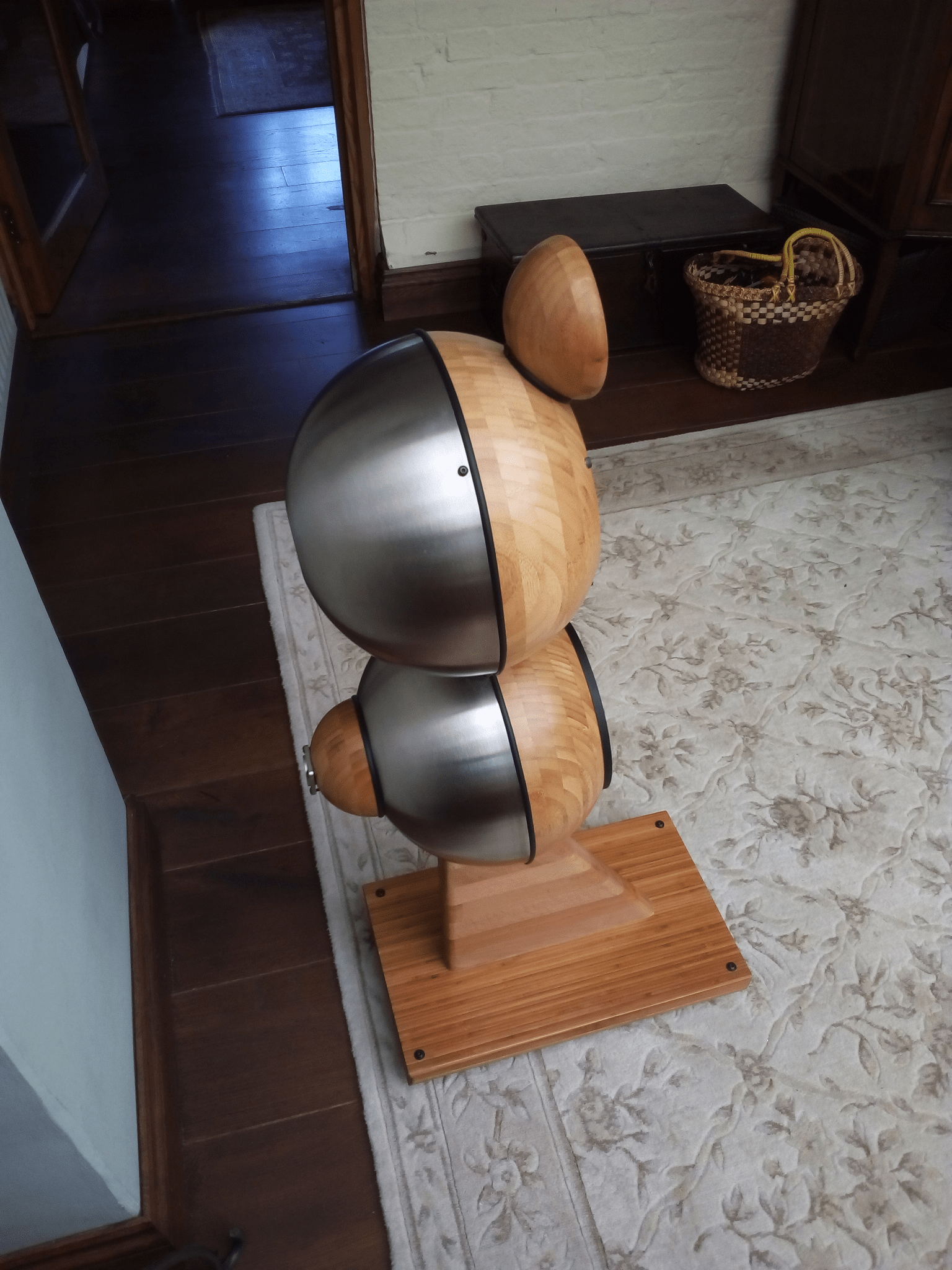

Wow love the first example. That's a 3-sphere Ikea with a very cool base. Is there a pole inside joining the two larger spheres? Are the backs painted or stainless? The driver in the center looks interesting, what type? The tweeter has a larger faceplate but so does the 1 1/8" Dayton I used for my second build, whereas I used what is technically a car tweeter on the first and that has a reduced the plate area. Then again the 2" dome Dayton mid has a large plate also.View attachment 1075635

Your other ones are huge!
Looks like that nearly 20 pound Volt midrange. You don't want to drop one of those on your foot. After getting a pair I decided I was too old and weak to put drivers that heavy in my builds. Those things are very pretty. If anyone decides to buy these drivers, ask for extra packing. Mine were double boxed, and had managed to destroy the inner box and had started to tear a whole in the outbox. They are beasts and they want to come out and play.View attachment 1075635
