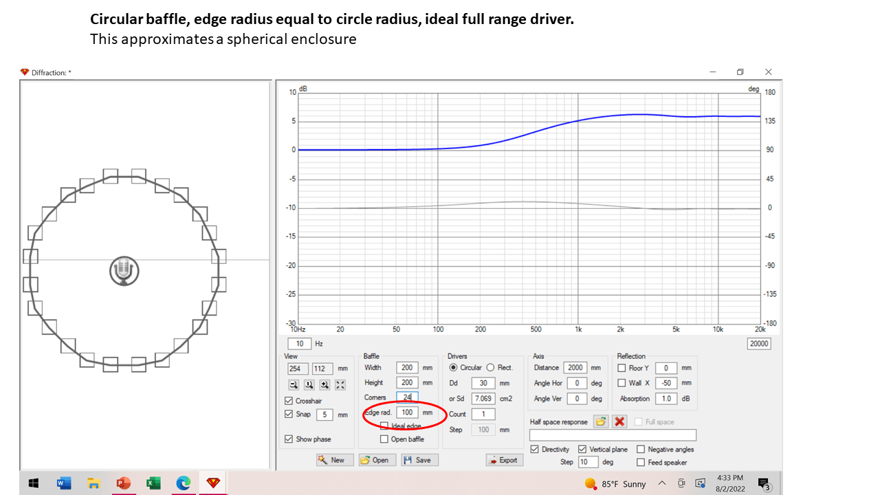

VituixCad will not perfectly model a sphere, but it can get a close approximation.
In Vcad, we can model a 200 mm diameter circular baffle, then give it an edge radius of 100 mm. This effectively makes it a hemispherical shape.
This will give the Olson results?
It seems to, yes.

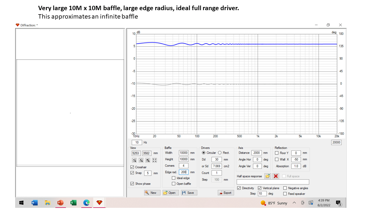

The first graphic shows the VituixCad approximation of an ideal full range driver in a 10 m x 10 m baffle with a very gentle 200 mm edge radius. This approximates an infinite baffle, but even here the simulation predicts some low level diffraction ripple.

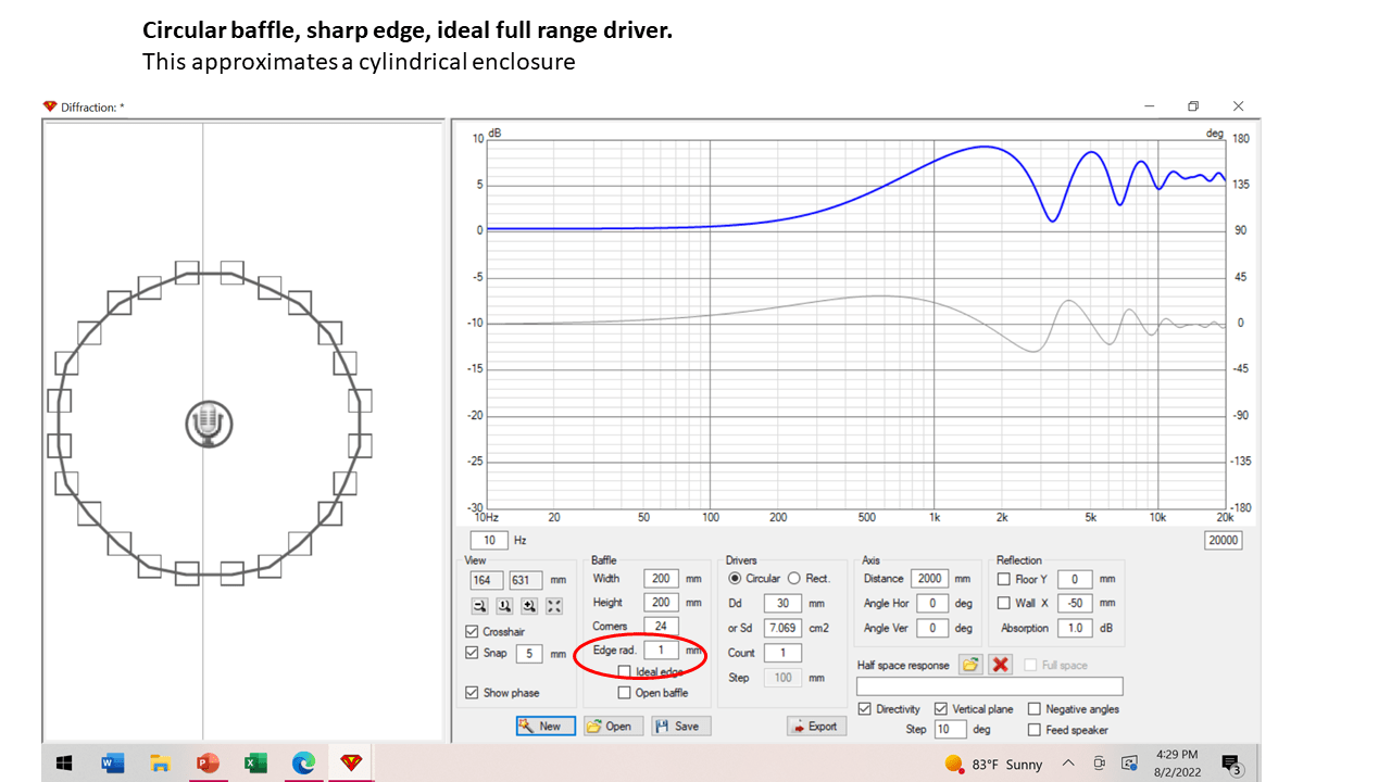

The second graphic shows an approximation of a circular baffle with a sharp edge. This approximates a cylinder of diameter 200 mm, with the driver mounted on the circular face.
The third graphic shows an approximation of a circular baffle with an edge radius equal to the circle radius. This is the Vcad approximation of a sphere.
In the second and third graphic, we clearly see that diffraction is causing a 6 dB loss as the frequency falls from 1000 to 100 Hz. However, in the sharp edge circle, there are other diffraction effects which are disruptive.

To me the second and third graphs show baffle step with and without diffraction. Baffle step is a 2pi - 4pi transition and involves the entire baffle. Diffraction is edge scattering when the baffle is significantly larger than the wavelength and only occurs at the baffle boundaries. I don't the benefit of conflating the two.
