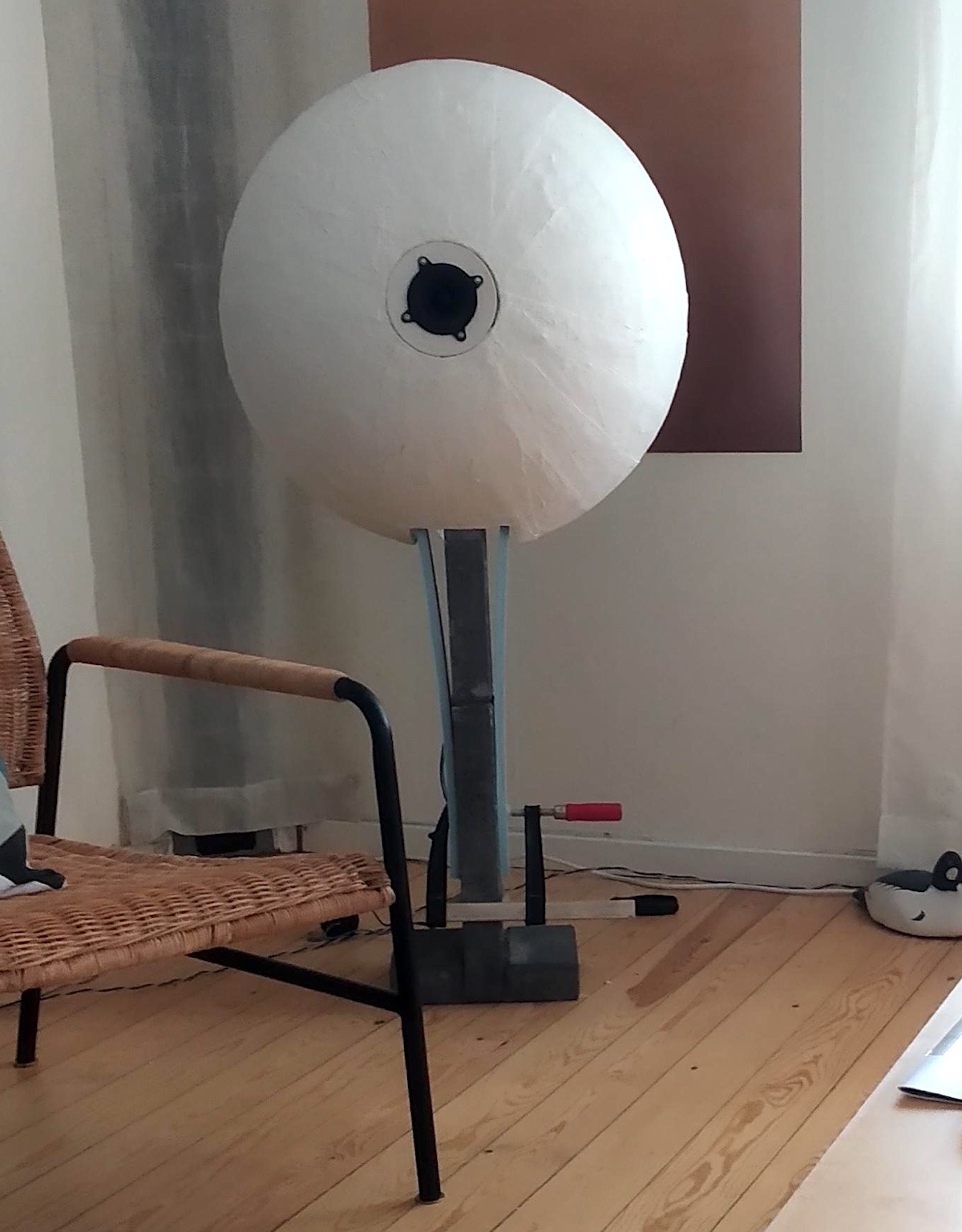

Edge rounding helps but sphere betterYeah diffraction happens when wavelength is about the size of the object and its on all waves like water, light, gravitation etc 😉 but the effects can be changed, round the edge to reduce the secondary sound source and enjoy problem free diffraction.
Yes, edge rounding makes poor sphere, I mean a relatively small one. The bigger the roundover radius the more sphere you get.
Think 20cm cube for example, 10cm radius roundovers would make it a sphere. Thats big enough of a radius roundover not to show diffraction related interference anymore for 20cm wavelength. Quarter of that would have some effect, 1" radius, but 1/10th or 1cm radius is probably not going to make much of a difference for 20cm wavelength. However even the 1cm radius roundover would be very effective for 2cm wavelength and show as little diffraction interference as a 2cm radius sphere. Or 1" radius roundover to 2" wavelength, etc. For 200Hz wide baffle one would need 400Hz radius roundovers 😀 Effects appear the same as long as ratio between wavelength and object/feature size stays the same.
In practice wavelength varies, a lot, but our physical speakers stay the same size, as they are inanimate objects so better plan the size (and shape) so it works for most of the bandwidth, especially where hearing system notices diffraction. I have no idea where it would be so it makes sense just to minimize it. If sphere is not practical, then as big roundovers as fits. If you are lazy like me make a box so small no roundover fits so you don't have to make one 🙂 Then crossover to a 3D/CNC manufactured waveguide that has them and let it handle the issue.

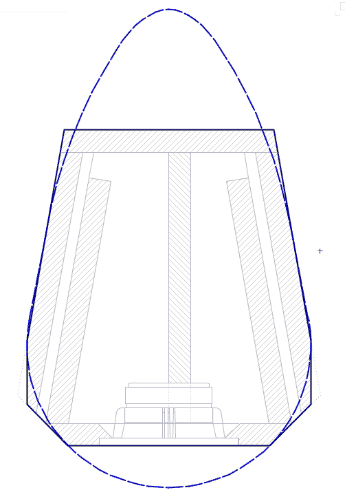

There are 3 basic versions of the miniOnken, and as each improves the minimization of external diffraction, the box build becomes a more difficult challenge.
Making roundish things with sheet material.

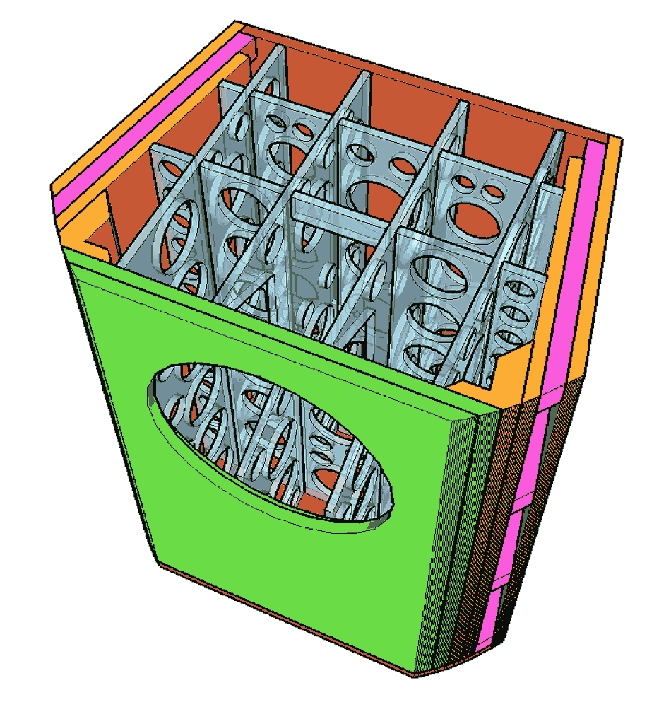

To reduce standing waves one needs significantly varying distances inside the enclosure, the greater the distribution of internal enclosure distances the more one supresses standing waves. A sphere has one distance and one giant internal standing wave, one can largely deal with that with an obstruction, heavy damping dead-centre.
A middle size trapezoidal miniOnken has a spread of about 0.6 of an octave (relative delta gets larger as boxes get smaller). The height could have a standing wave.
The holey brace has a greater impact on side-to-side distances, the holes allowing full width, the solid parts a bit less than half. This is taken to extremes in this larger version — note that the holes in the braces do not line up to create significantly large distribution of distances in the horizontal directions.
When we talk about diffraction we are typically taking about the cabinet’s shape on the sound front. The expression of this changes with frequency. At high frequencies we get edge diffraction at a sharp boundary, at lower frequencies we get baffle dtep diffraction, which on the face of it is a 6dB loss of on-axis response as the wavefronts transition from 2π 4π transition as the size of the baffle decreases relative to the wavelength under consideration, But this roll-off has a shape which is dependent on the enclosure shape and this is where we see the classic Olson chart.
B&W took this research further and we end up with this shape:
Eclipse speakersare similar, an egg or ellipsoid is the simple shape. Teardrop a bit more complex.

- How to build a spherical speaker?
